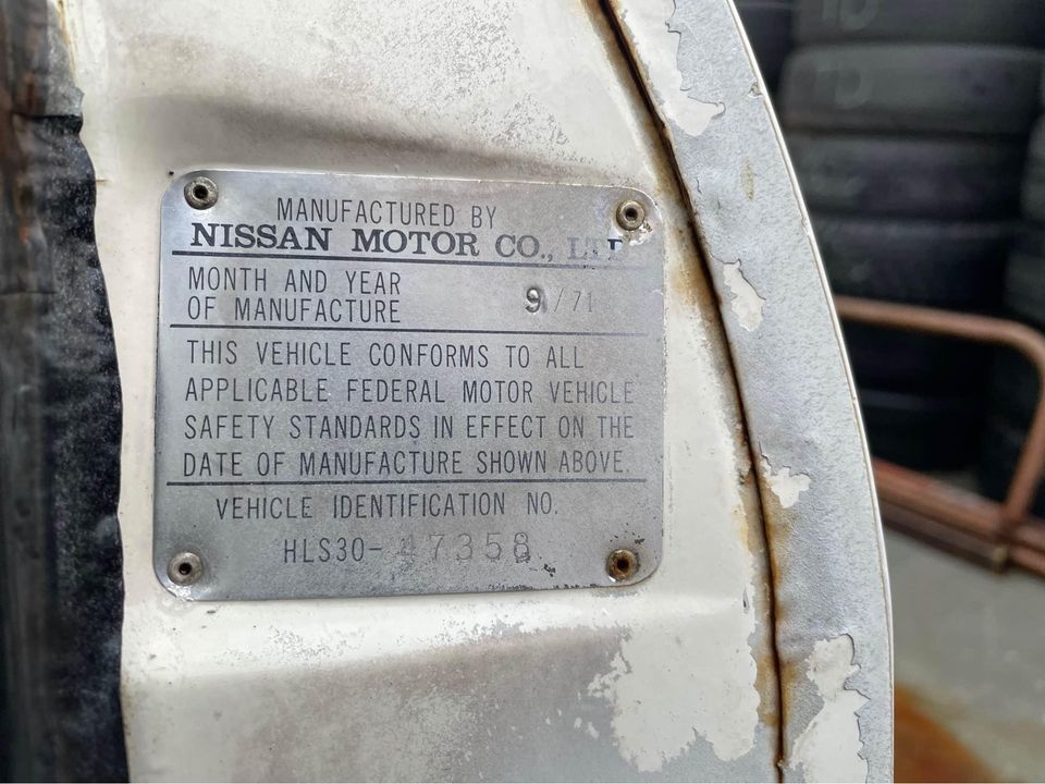

19 minutes ago, GoldAir said:
I saw September '71 on the door jam plate. Does the year of manufacture run a year in advance of the model year?
Since the mid 50's the "New" models for the Coming Calendar Year have been introduced a few months before 1 January of the coming year. In the mid to late 1950's "New Models" were put on display and open to the Public - at the local Authorized Dealership on Nov 1 of the current year. As competition got more serious, Manufacturers tried to bet the completion to the show room floor - so they started introducing new models Oct 1 - by the mid 60's new models were being introduced by Sept. 1.   As I recall Ford introduced the New 1965 Mustang in April of 1964.   Now the funny thing is NISSAN said they will introduce the New 2023 Z Car in the Spring of 2022.
By the way - the VIN #47358 on that car is the Key - - The 1972 Model Year Datsun 240Z's started with VIN HLS30 46001.

I believe that the Mustang you reference was sold as a 1964.5.  https://en.wikipedia.org/wiki/Ford_Mustang_(first_generation)
