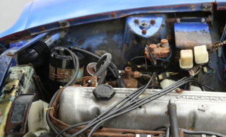

December 5, 20204 yr comment_611872 The VIN is consistent with a 72. The rear quarter panels, bumpers, and grill are consistent with a 72. The interior (notice the voltmeter), the tail panel, the engine bay, and radiator support are consistent with a 76. (A friend tried to use a 280Z airbox on a fuel injection conversion of a 260Z and found that the intake piping couldn't pass through the radiator support on the earlier cars.) My guess is that it was a wreck and rebuild at some point. Link to comment https://www.classiczcars.com/forums/topic/64671-zs-on-bat-and-other-places-collection/?&page=9#findComment-611872 Share on other sites More sharing options...
December 5, 20204 yr Author comment_611886 1 hour ago, SteveJ said: The VIN is consistent with a 72. The VIN of the BAT listing 76 I showed is lower than the VIN of the blue car in question. So the blue eBay Beverly Hills turd should have been created after the nice BAT 76. Therefore, a 76 or later. Are we all looking at the same numbers and posts (things get squirrelly here at times)? Edit - actually I see that the VINs don't seem to accumulate over the years. Looks like they reset each year? Why? So, the VIN is not actually helpful in determining year. But the rest of the car looks 76 to me. Who moves the fusible link terminals over with an engine swap? And the AC solenoids (magnet valves). Here's a 72 - HLS3051114 https://bringatrailer.com/listing/1972-datsun-240z-152/ Edited December 5, 20204 yr by Zed Head Link to comment https://www.classiczcars.com/forums/topic/64671-zs-on-bat-and-other-places-collection/?&page=9#findComment-611886 Share on other sites More sharing options...

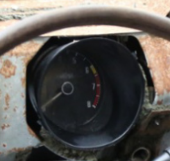

December 5, 20204 yr Author comment_611889 It does have the 6400 RPM redline tachometer also. A 280Z part. It's a messy car. Link to comment https://www.classiczcars.com/forums/topic/64671-zs-on-bat-and-other-places-collection/?&page=9#findComment-611889 Share on other sites More sharing options...

December 5, 20204 yr comment_611930 24 minutes ago, Zed Head said: If it has the indents I'd guess that they were smashed in there when the car was dragged through the field. And the front end might just be smashed and rusty 76 parts. JUST SAYING!! (Why am I even writing about this turd...) I think you're right, there is not a relief on the rear quarter. I just checked the rear strut tower differences, 240 to 280. The tower is 42 millimeters (1.65") higher on the 280. In the shots looking in from the back they do look taller. This car is looking more like a 280 that has been given the 240 look with the bumper makeover. Another odd thing is I can't see the park/turn signals in the grille. Maybe the brackets rusted away and they fell off. Link to comment https://www.classiczcars.com/forums/topic/64671-zs-on-bat-and-other-places-collection/?&page=9#findComment-611930 Share on other sites More sharing options...
