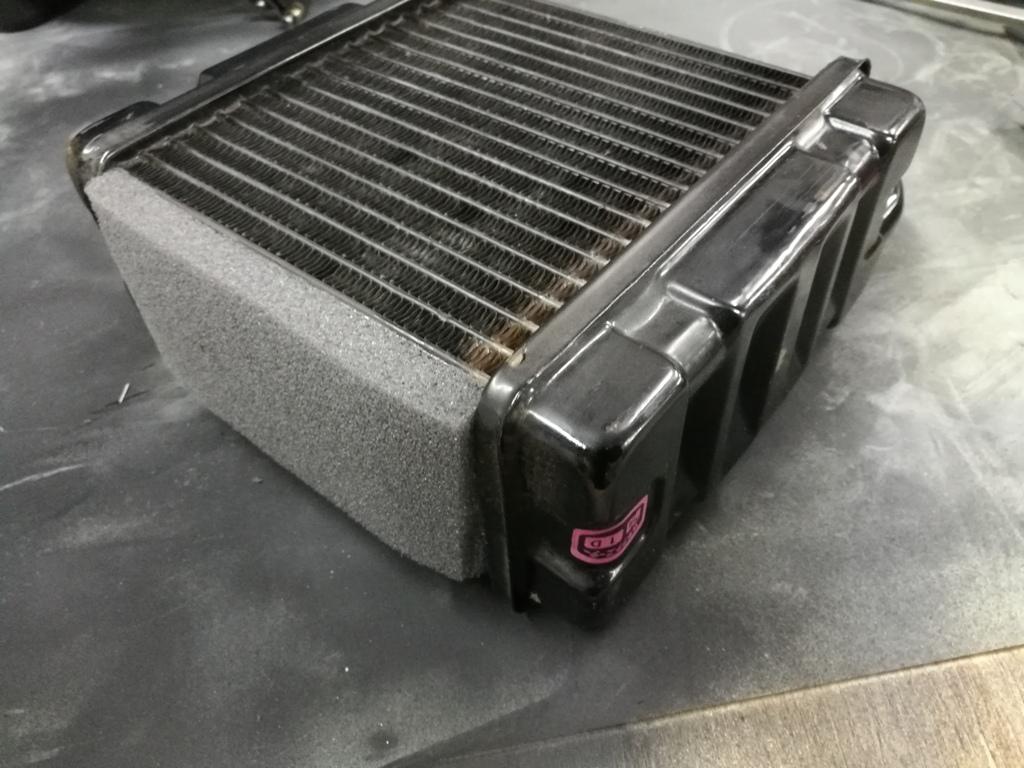

March 17, 20214 yr Author comment_617953 While waiting to get the flywheel back from resurfacing, the heater core was next to reassemble. The core itself was sent off and rebuilt, the housing media blasted and painted, new seals, foam, OEM valve, and the blower motor updated to a Kia Sportage unit for improved air flow. I’ll follow up with the completed assembly. Link to comment https://www.classiczcars.com/forums/topic/64674-restoration-of-hls30-12070/?&page=10#findComment-617953 Share on other sites More sharing options...

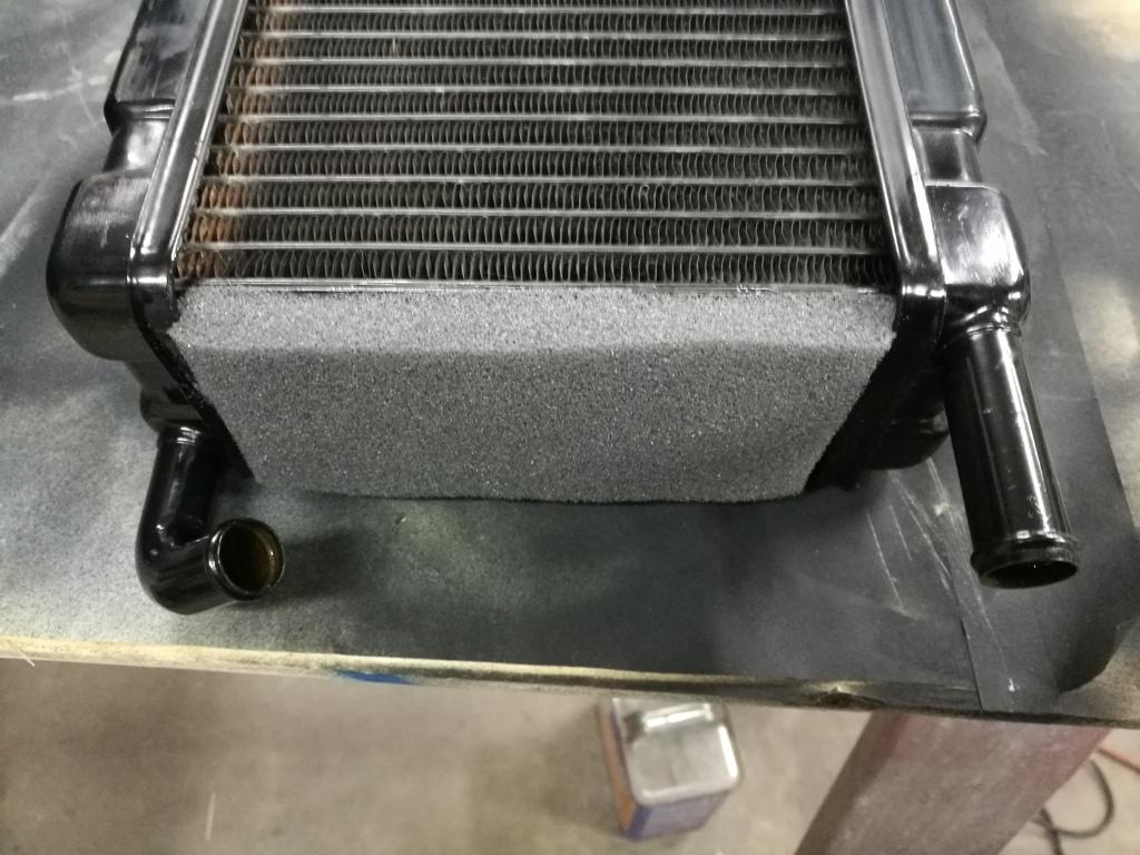

March 18, 20214 yr Author comment_618032 Update on the heater core. Unit has been reassembled and just about ready for install. Blower unit is lacking the heating element to complete the rebuild. Link to comment https://www.classiczcars.com/forums/topic/64674-restoration-of-hls30-12070/?&page=10#findComment-618032 Share on other sites More sharing options...
March 18, 20214 yr comment_618037 That is a job very well done. Couple of questions if you don't mind? What is the 24271-2P010? Does that part number correspond to the dark piece of thin foam? Did you reuse the original vinyl on the flap door? The hardware... is original and re-plated? Did you lose any when you had them re-plated? I am concerned about losing smaller stuff like those sheet metal screws when I send mine off to get re-plated. When I took my heater core assembly apart, I saw evidence of some foam which was originally glued to the sides of the heater core. It was only about half as tall as my replacements in these pics, but you might want to add that to block off the air gap between the core and the sides of the box, if you didn't already do that. Link to comment https://www.classiczcars.com/forums/topic/64674-restoration-of-hls30-12070/?&page=10#findComment-618037 Share on other sites More sharing options...
March 18, 20214 yr Author comment_618038 5 minutes ago, inline6 said: That is a job very well done. Couple of questions if you don't mind? What is the 24271-2P010? Does that part number correspond to the dark piece of thin foam? Did you reuse the original vinyl on the flap door? The hardware... is original and re-plated? Did you lose any when you had them re-plated? I am concerned about losing smaller stuff like those sheet metal screws when I send mine off to get re-plated. When I took my heater core assembly apart, I saw evidence of some foam which was originally glued to the sides of the heater core. It was only about half as tall as my replacements in these pics, but you might want to add that to block off the air gap between the core and the sides of the box, if you didn't already do that. Thanks! 24271-2P010 were adhesive foam pads I had purchased in a big bulk of OEM parts few years ago. They just so happened to work perfectly as replacement pads on the flap doors. All the hardware was stripped down and replated. Yes, when you send out as much as I did there will be a few pieces that never make it back home. I inventoried everything removed on a spreadsheet I could reference. Most of the standard bolts and screws can be purchased in bulk to restock missing pieces. On the foam around the heater core, I had a piece similar to what you’re showing, but on the backside of the unit, the face opposite of the inlet/outlet tubes. On the front side were only two foam squares around the tubes. I like how you did that. I might pop the side off again and add more to further restrain the core from movement. Link to comment https://www.classiczcars.com/forums/topic/64674-restoration-of-hls30-12070/?&page=10#findComment-618038 Share on other sites More sharing options...

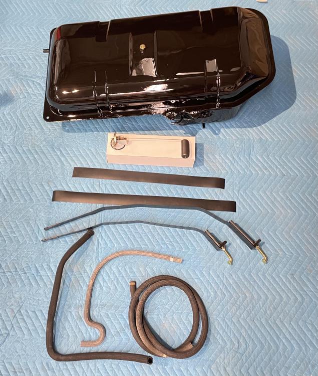

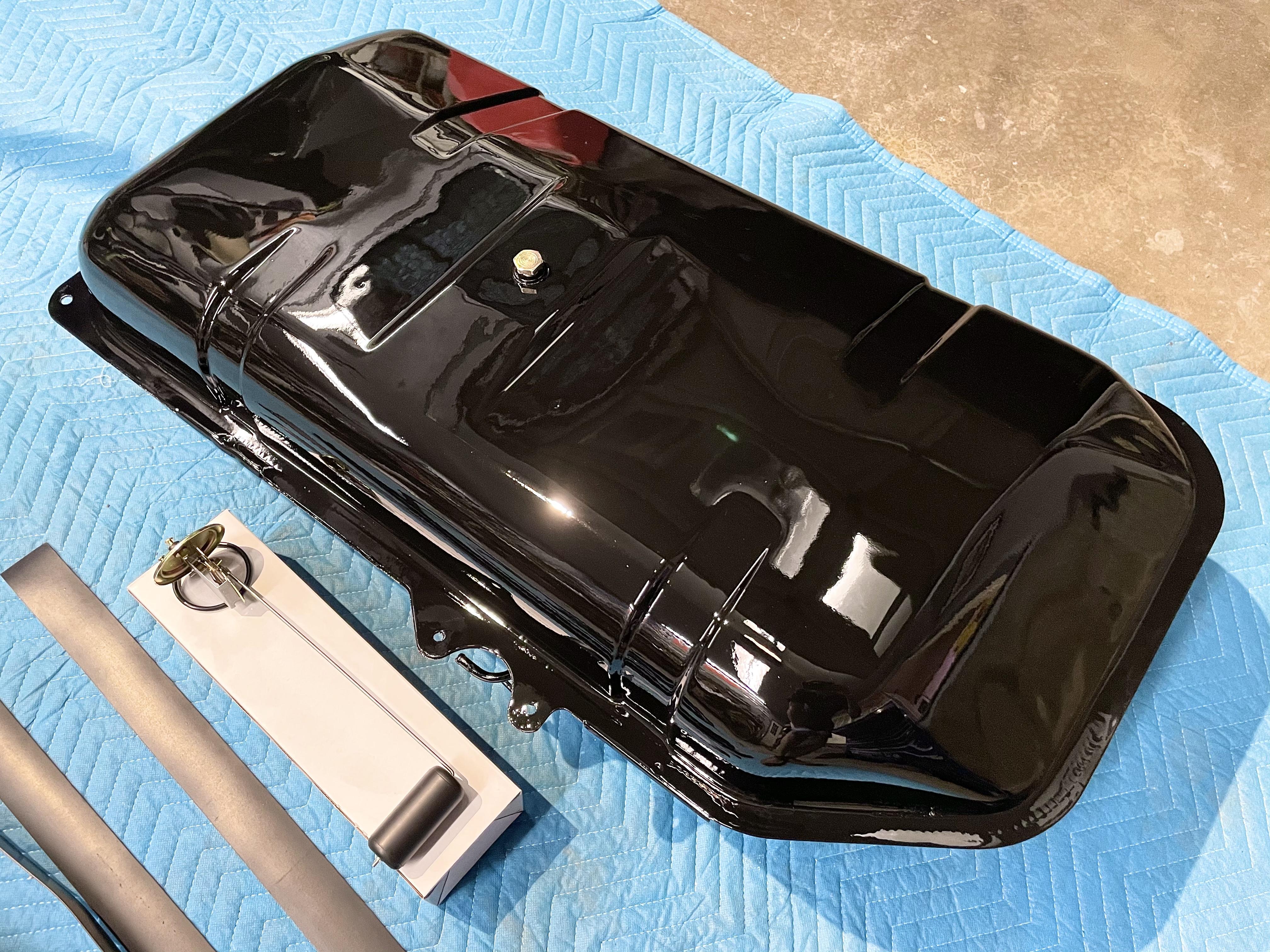

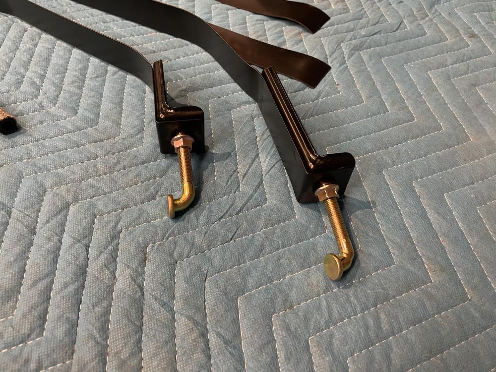

March 28, 20214 yr Author comment_618709 Lot of not so glamours work has been done on the Z lately. One task just about complete some might appreciate, restoring the fuel tank. Tank was boiled out and sealed, followed by many hours of body work to get the underside as smooth as possible. Finished out with a new sending unit, powder coated straps, new rubber liners, hoses, and replated hardware. Link to comment https://www.classiczcars.com/forums/topic/64674-restoration-of-hls30-12070/?&page=10#findComment-618709 Share on other sites More sharing options...
