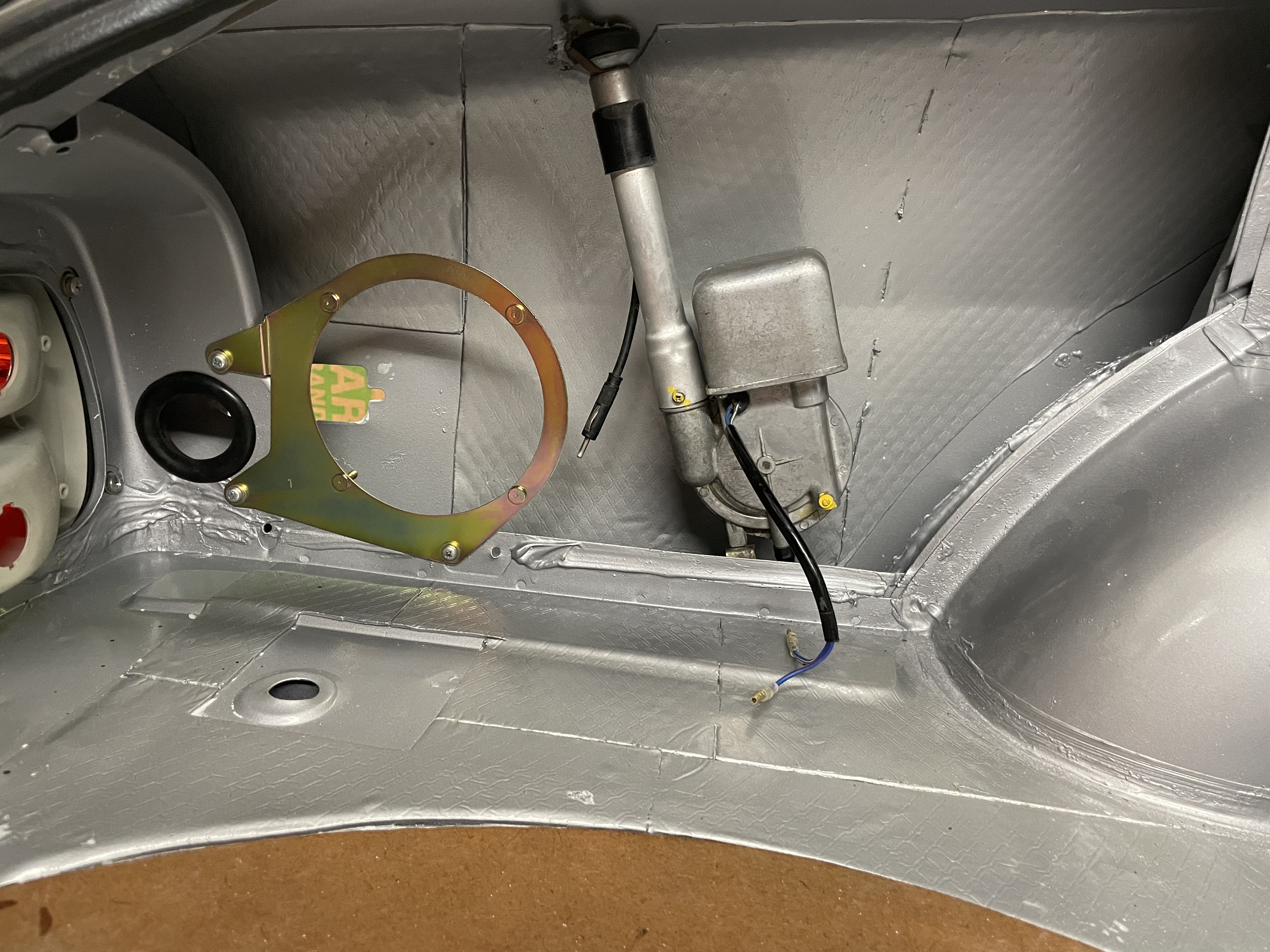

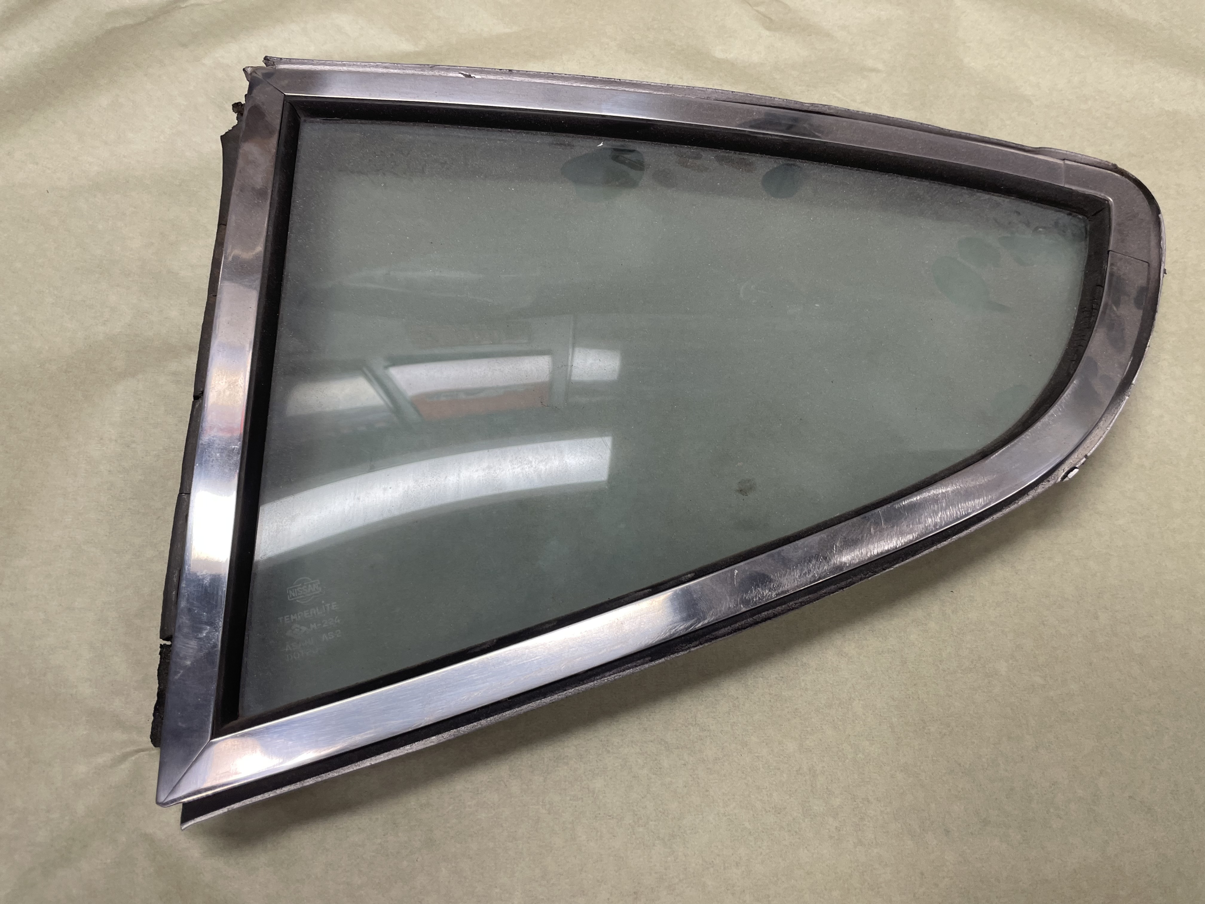

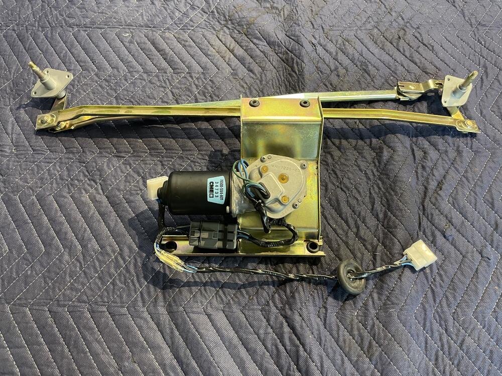

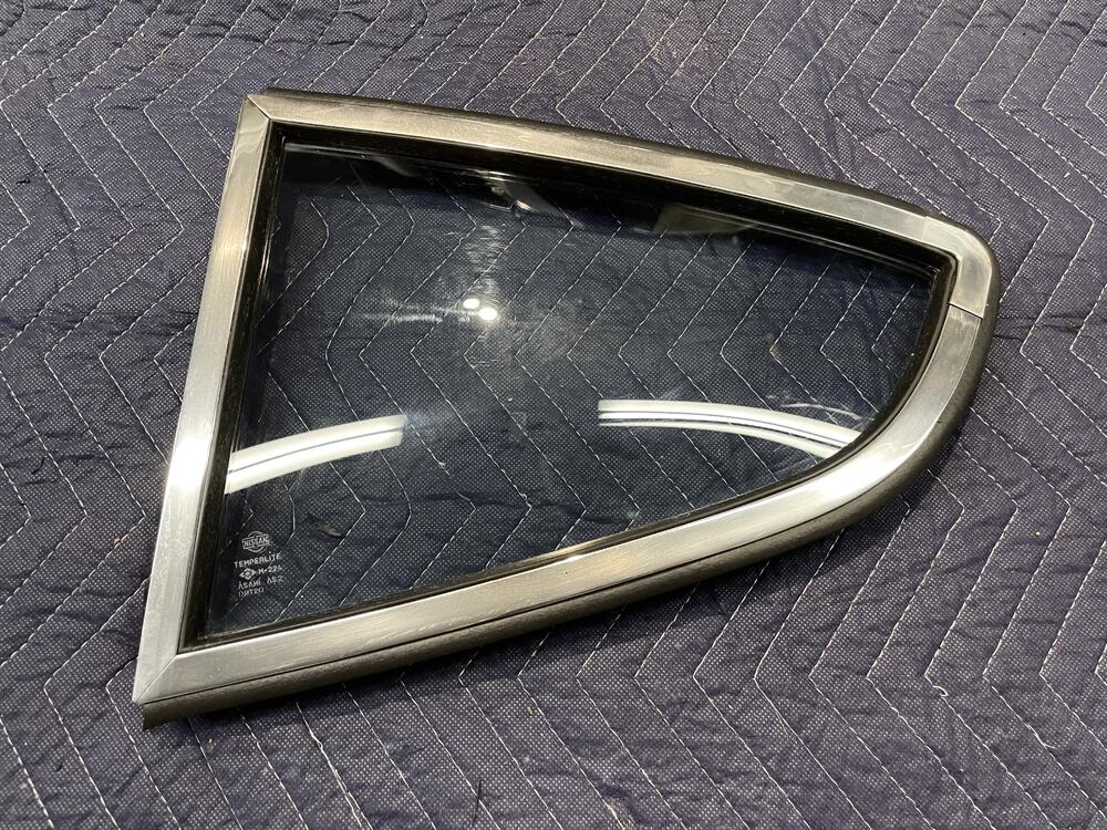

July 28, 20213 yr Author comment_625867 Few more updates on the Z. Worked on rebuilding the quarter windows, finished up the vapor canister install, and got the antenna/speaker bracket in. Next I’ll get the wiring harness routed and have the hatch area just about done. Edited July 28, 20213 yr by CW240Z72 Link to comment https://www.classiczcars.com/forums/topic/64674-restoration-of-hls30-12070/?&page=14#findComment-625867 Share on other sites More sharing options...

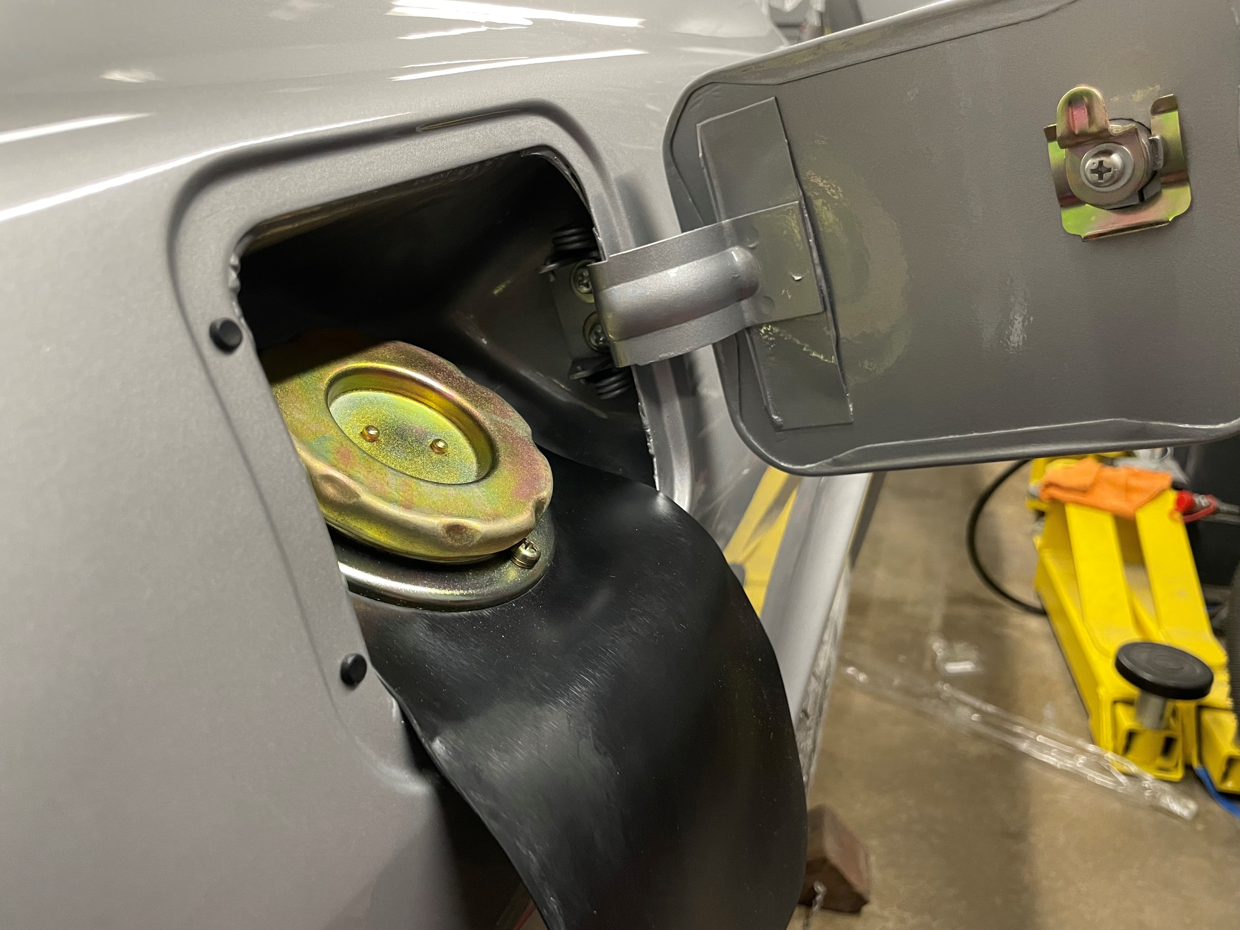

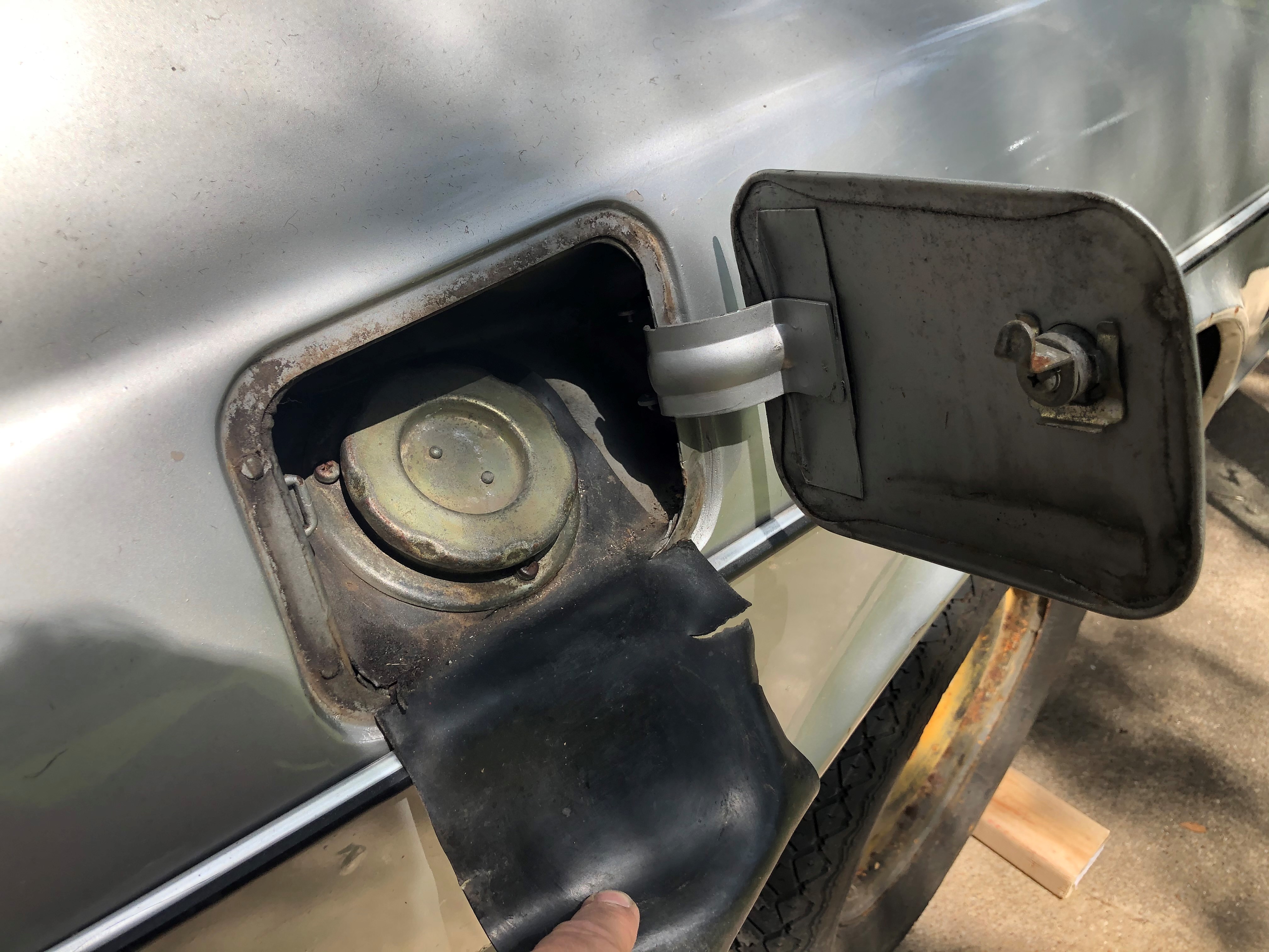

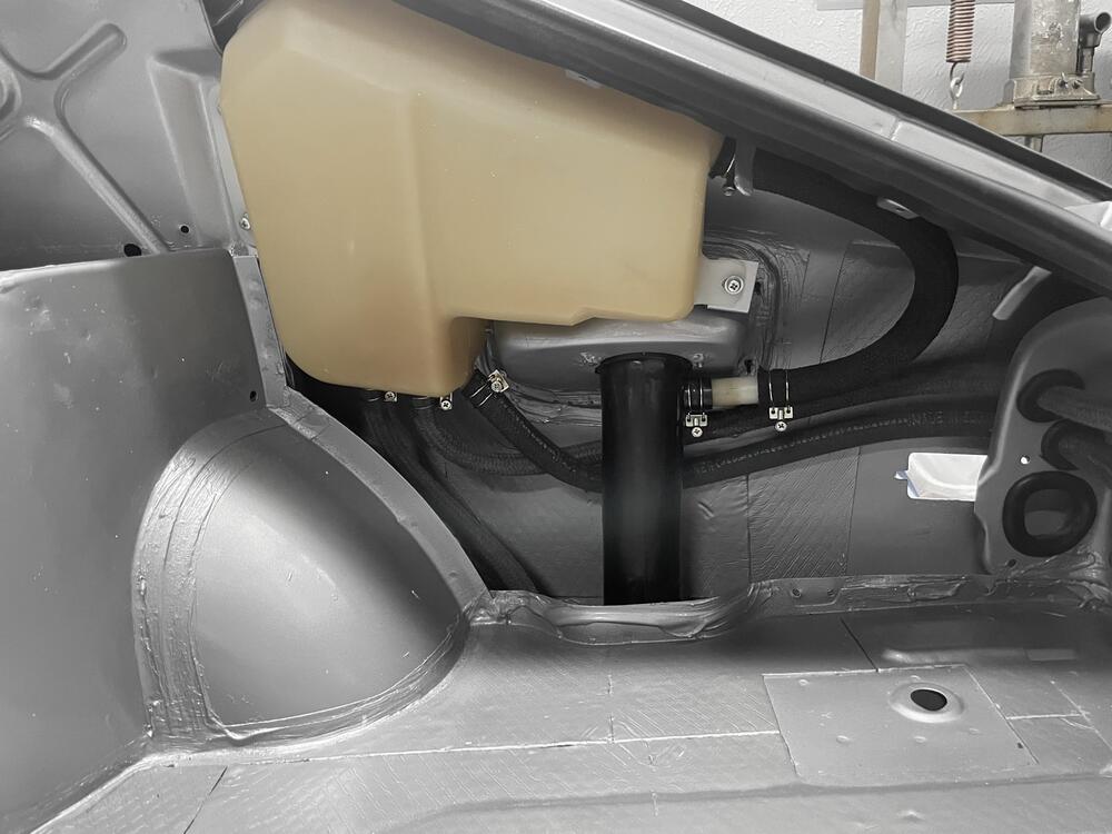

July 29, 20213 yr Author comment_625894 Before and after for the gas fill area on the Z. Everything replated with new rubber bits to finish it off. Link to comment https://www.classiczcars.com/forums/topic/64674-restoration-of-hls30-12070/?&page=14#findComment-625894 Share on other sites More sharing options...
July 29, 20213 yr comment_625896 Amazing attention to detail. Very inspiring. Link to comment https://www.classiczcars.com/forums/topic/64674-restoration-of-hls30-12070/?&page=14#findComment-625896 Share on other sites More sharing options...

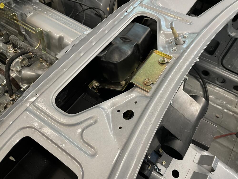

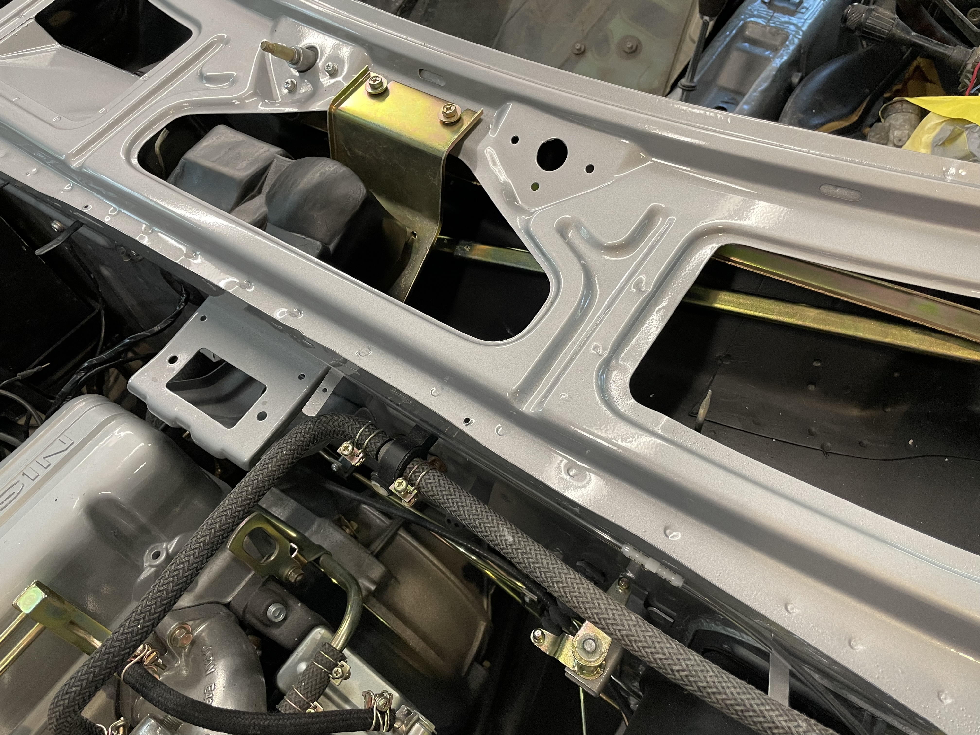

August 1, 20213 yr Author Popular Post comment_626109 Restored wiper linkage and motor mounting bracket, along with the Honda wiper motor upgrade. A jumper harness was made so that from the firewall forward the wiring would appear stock. Harness also allows for easy replacement of motor if it should ever fail. Link to comment https://www.classiczcars.com/forums/topic/64674-restoration-of-hls30-12070/?&page=14#findComment-626109 Share on other sites More sharing options...
August 1, 20213 yr comment_626115 When i look at the pic above.... i would make a cable from the white connector straight into the motor.. all those connectors.. it's like modern cars.. to much connectors..to much failing! Link to comment https://www.classiczcars.com/forums/topic/64674-restoration-of-hls30-12070/?&page=14#findComment-626115 Share on other sites More sharing options...
August 1, 20213 yr Author comment_626120 2 hours ago, dutchzcarguy said: When i look at the pic above.... i would make a cable from the white connector straight into the motor.. all those connectors.. it's like modern cars.. to much connectors..to much failing! The idea for the amount of connections was to allow the motor to be unplugged and swapped out without splicing into the harness. There’s also a 30 amp relay in the system that’s needed for proper function. It’s not a simple wire to wire connection for this upgrade unfortunately. Link to comment https://www.classiczcars.com/forums/topic/64674-restoration-of-hls30-12070/?&page=14#findComment-626120 Share on other sites More sharing options...

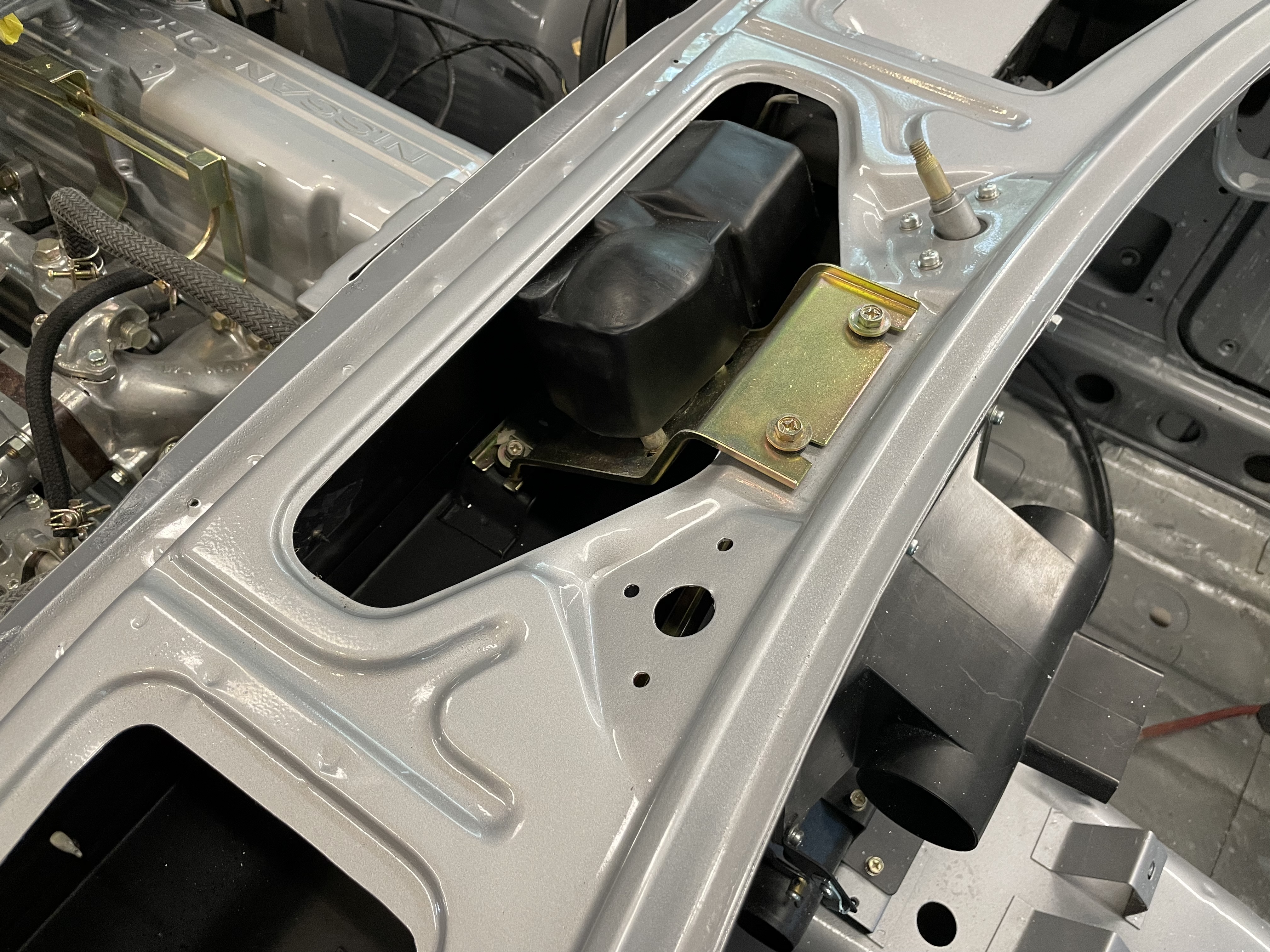

August 10, 20213 yr Author comment_626637 Wiper motor and linkage installed for good. Was happy to see that the original wiper motor cover fit on the Honda unit nicely for a very “original” look. Link to comment https://www.classiczcars.com/forums/topic/64674-restoration-of-hls30-12070/?&page=14#findComment-626637 Share on other sites More sharing options...
August 10, 20213 yr comment_626643 I don't think I've ever seen a wiper motor cover like that before, only the vinyl bag type cover and that's on 240z's through to 280z's. Link to comment https://www.classiczcars.com/forums/topic/64674-restoration-of-hls30-12070/?&page=14#findComment-626643 Share on other sites More sharing options...
August 10, 20213 yr comment_626646 @grannyknot My 7/70 has one. Edited August 10, 20213 yr by CanTechZ Link to comment https://www.classiczcars.com/forums/topic/64674-restoration-of-hls30-12070/?&page=14#findComment-626646 Share on other sites More sharing options...
August 10, 20213 yr comment_626652 1 hour ago, CanTechZ said: @grannyknot My 7/70 has one. Ditto. Honda upgrade hiding inside, Dave Irwin's relay in the wiring. Link to comment https://www.classiczcars.com/forums/topic/64674-restoration-of-hls30-12070/?&page=14#findComment-626652 Share on other sites More sharing options...
August 11, 20213 yr comment_626680 9 hours ago, grannyknot said: I don't think I've ever seen a wiper motor cover like that before, I agree, maybe those plastic caps are honda? As far i've seen Datsun had the plastic bag.. Link to comment https://www.classiczcars.com/forums/topic/64674-restoration-of-hls30-12070/?&page=14#findComment-626680 Share on other sites More sharing options...
August 11, 20213 yr Author comment_626683 3 hours ago, dutchzcarguy said: I agree, maybe those plastic caps are honda? As far i've seen Datsun had the plastic bag.. Plastic cover is 100% original to the car. Second Z I’ve had with one, as it was for both CanTechZ and jfa.series1 above. Link to comment https://www.classiczcars.com/forums/topic/64674-restoration-of-hls30-12070/?&page=14#findComment-626683 Share on other sites More sharing options...
