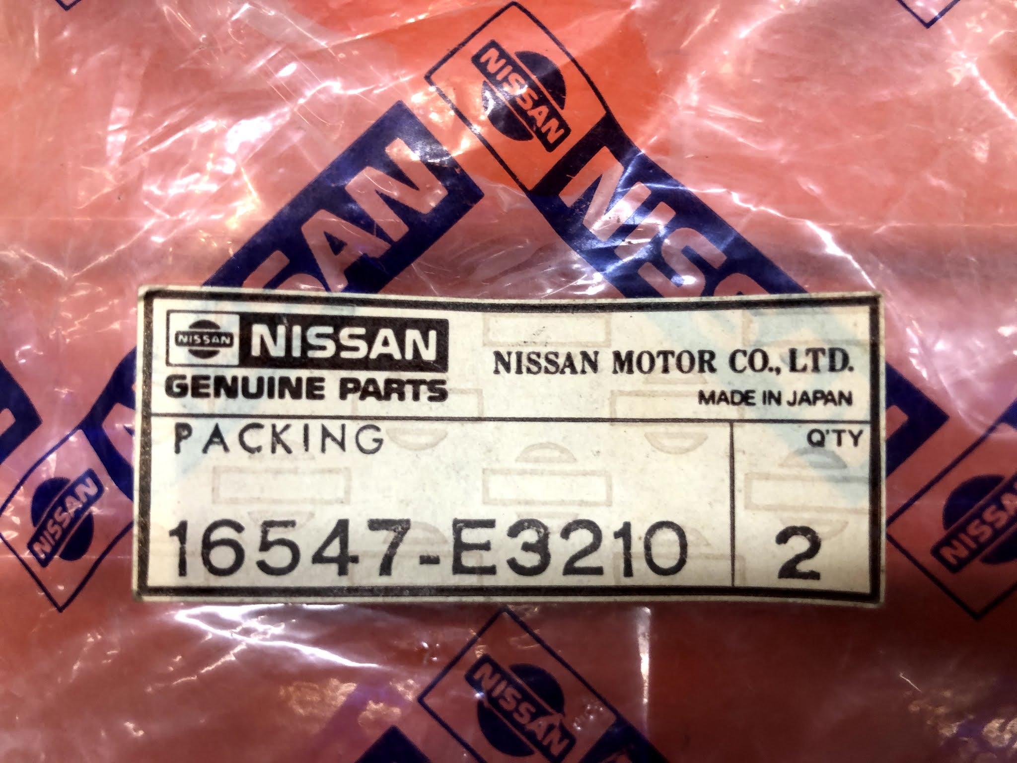

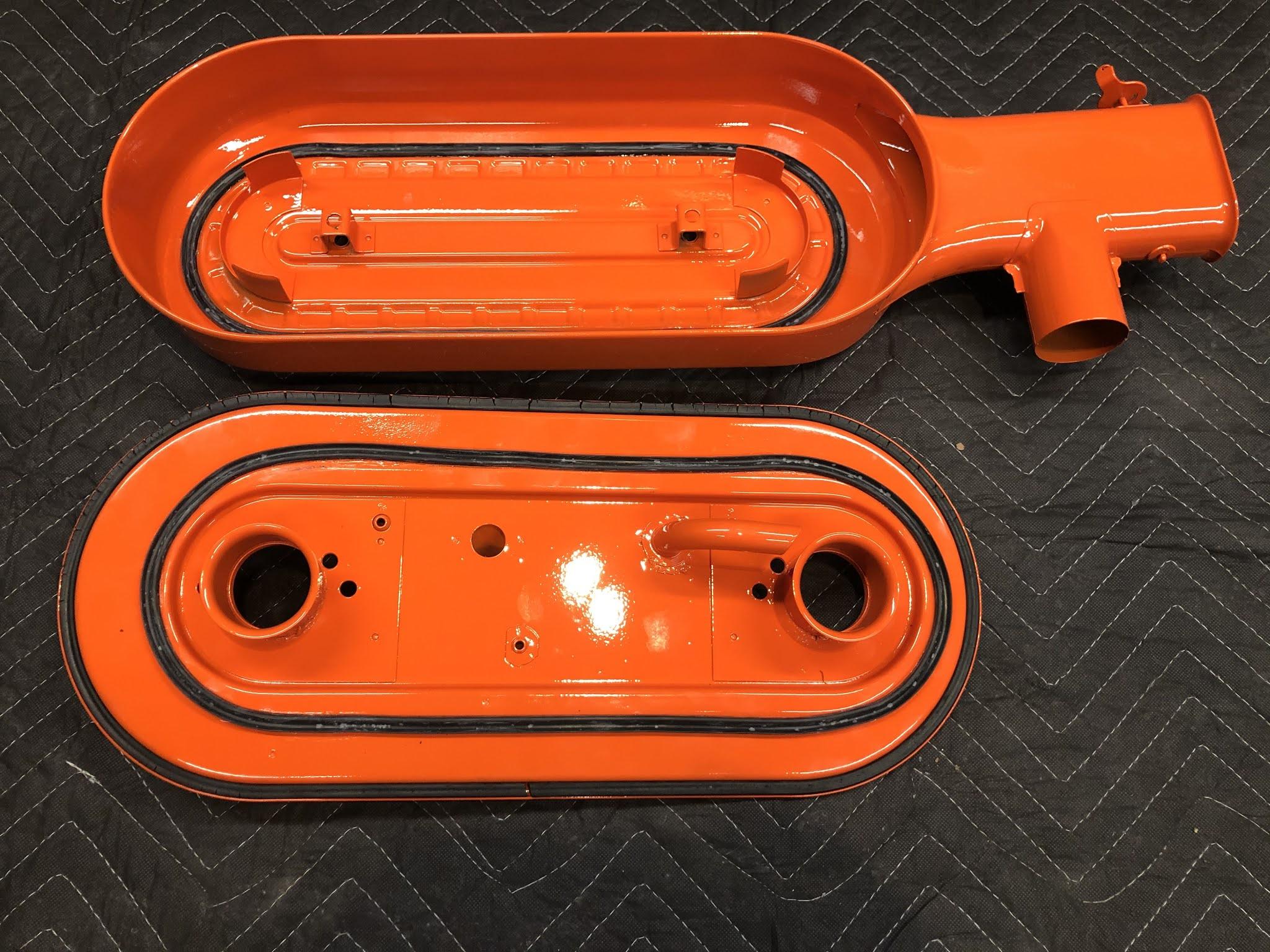

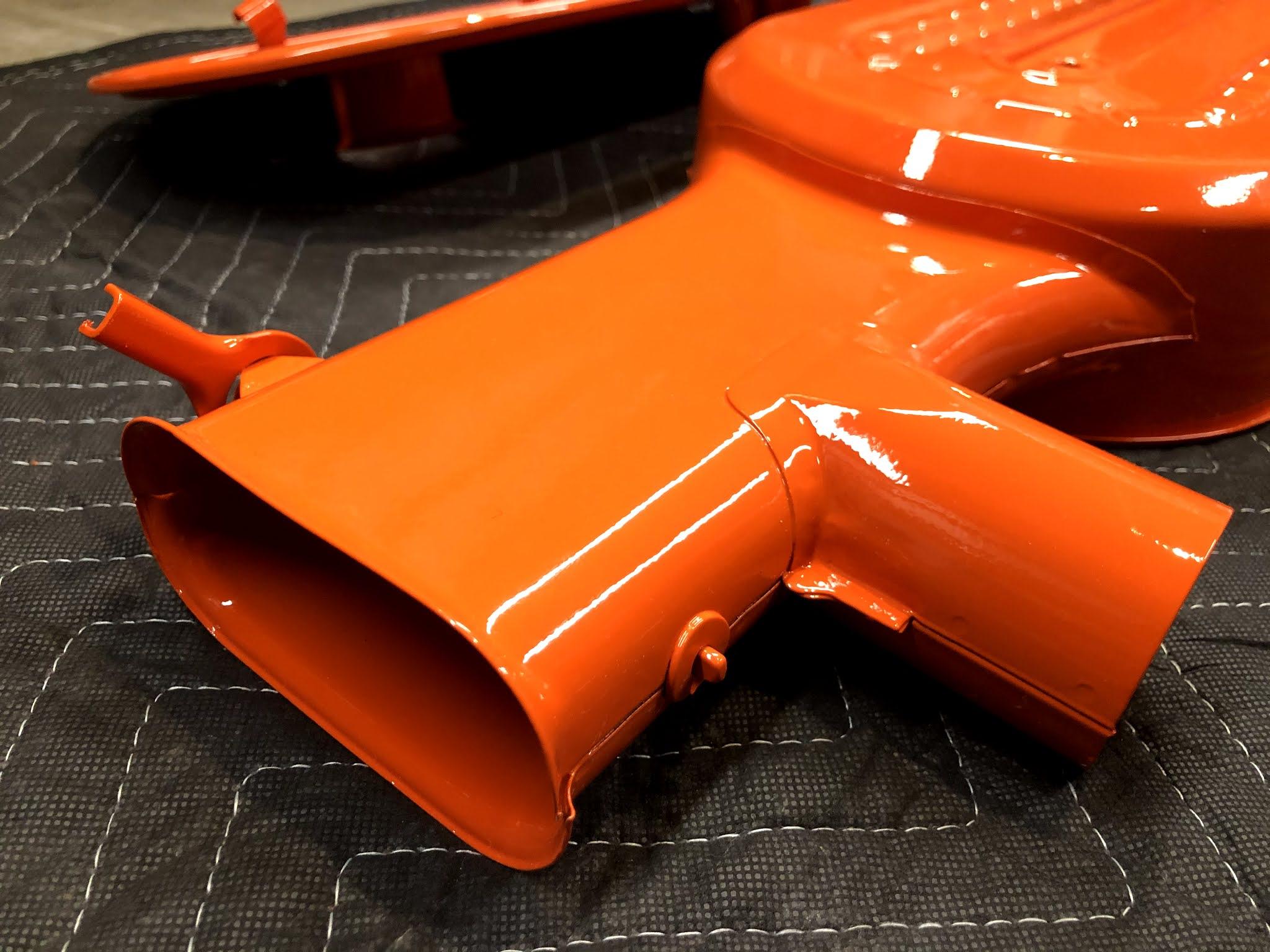

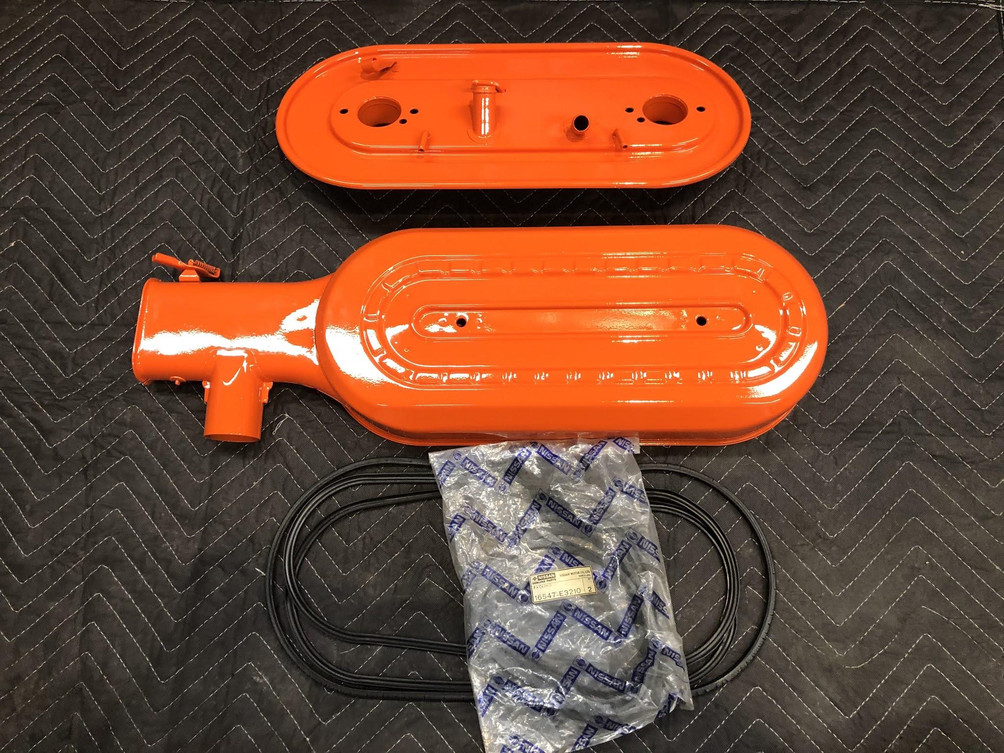

November 10, 20204 yr Author comment_610062 Another small restoration project, cleaning up the original air cleaner. During the dustless blasting process we had both pieces of the air clean blasted, coated with a DTM, and then finished in the correct shade of orange. In my stash of parts was a set of NOS air cleaner gaskets. Once the correct stickers arrive this assembly will be ready for install. Link to comment https://www.classiczcars.com/forums/topic/64674-restoration-of-hls30-12070/?&page=3#findComment-610062 Share on other sites More sharing options...

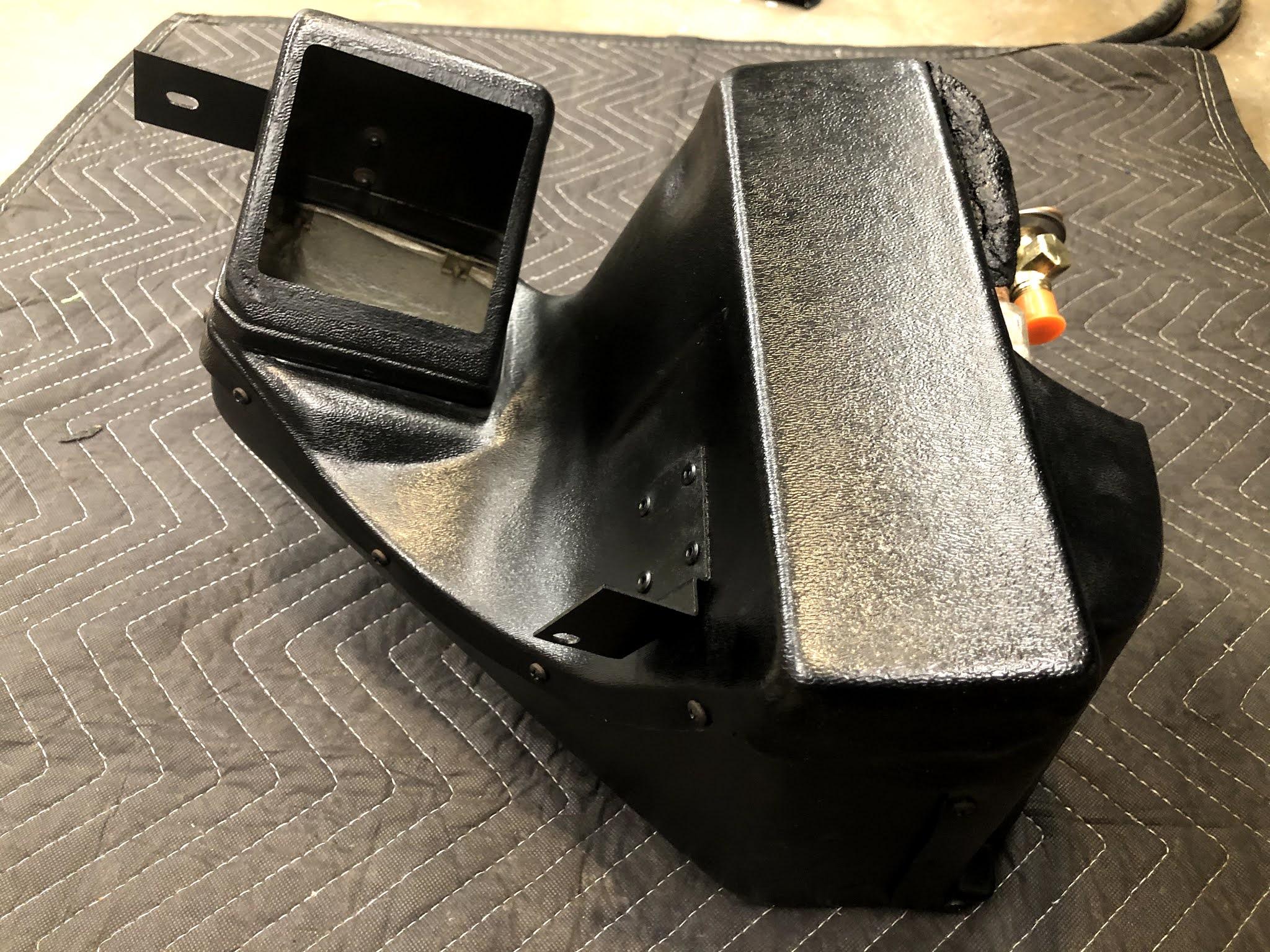

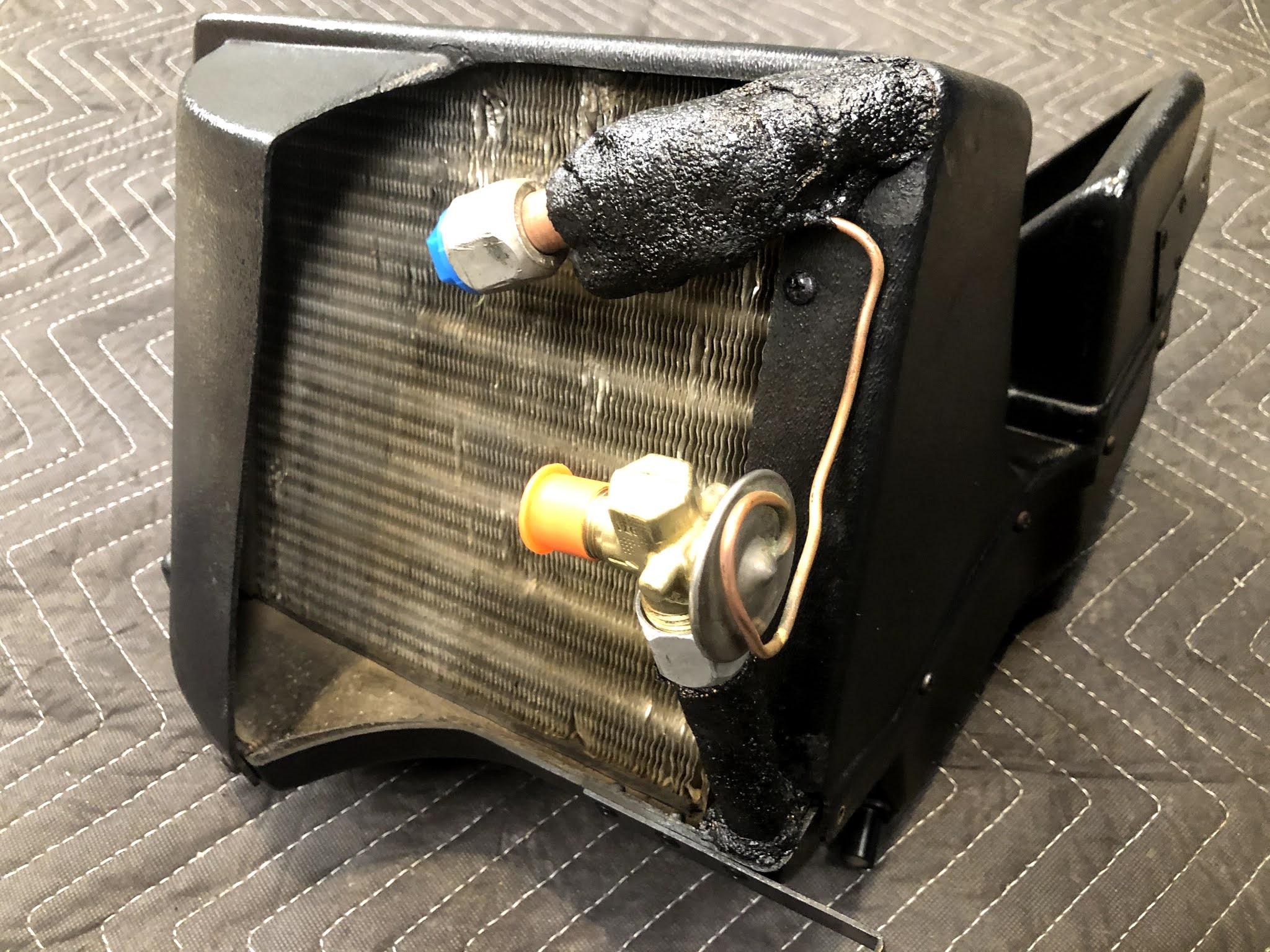

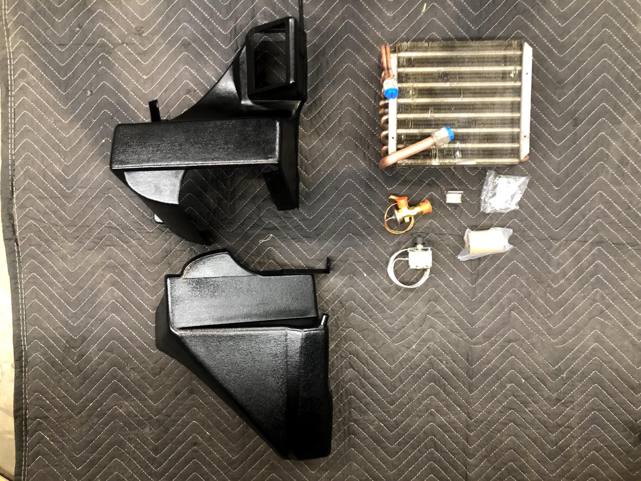

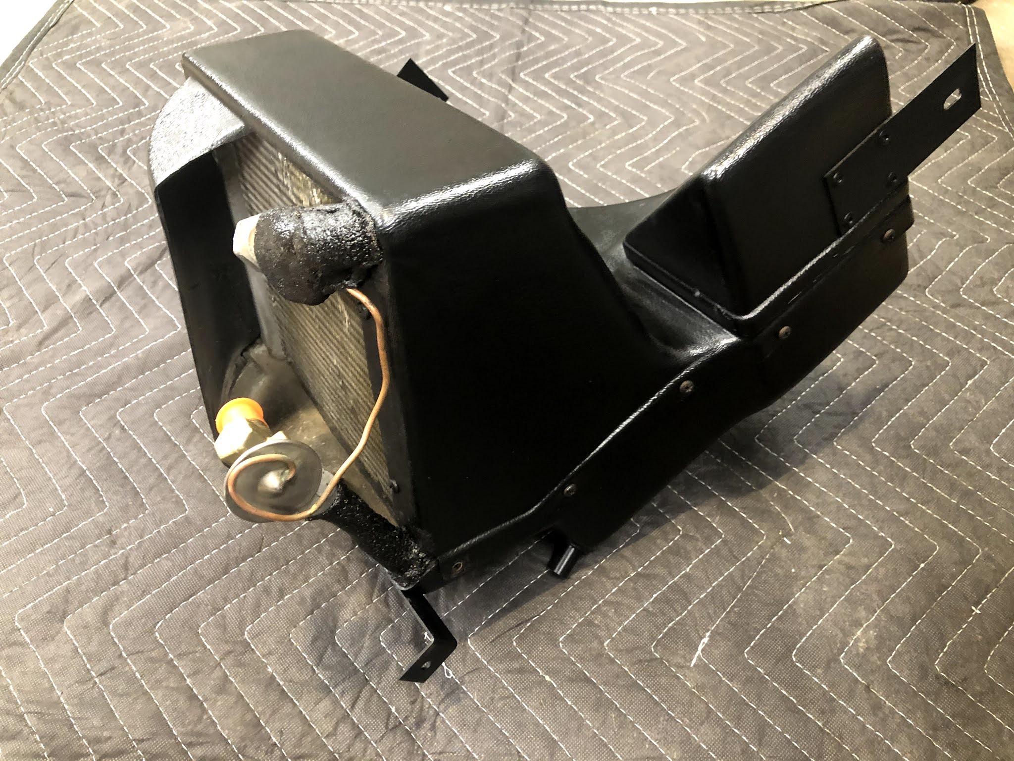

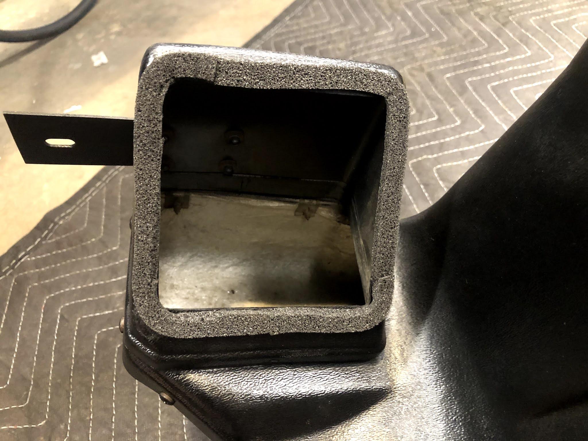

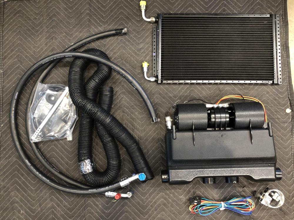

November 10, 20204 yr Author comment_610070 Received the AC kit from Auto AC solutions last week and decided to mock it up in the car. Link to the kit we got as reference: Z AC Kit Initially I had high hopes for this kit. From the description on the website it sounded like it was designed specifically for the Z. I wanted a system that was much cleaner than the dealer unit originally installed in the car that had the massive York compressor. This is what came in the kit (AC compressor and mounting brackets not shown - mounted those before snapping this picture) As you can see, the evaporator unit is a massive assembly. I could not figure out how to package it cleanly behind the dash and with the existing HVAC system. Perhaps I was looking at it wrong, but it didn't seem as integrated of a unit as the one removed. The compressor mounting brackets seemed fine, but the hardware provided was useless. Looked like M10X1.5 hardware for the most part, but with mix matched bolt head sizes and thread pitches. Definitely not very well thought out. I will replace all of this will better quality hardware. With the York compressor, all the AC lines and fittings remain on the RH side of the car. With this new system, the compressor is mounted down on the LH side of the engine, similar to the ZX. Now this aspect of the kit I liked, as I didn't want to look at the compressor when I opened the hood. However, the condenser seemed to be setup for the York style of system, with both inlet and outlet ports on the same side of the unit. Again, I don't think this was very well thought out. We'll be able to make it work, but with more effort than I was anticipating. Another feature of this kit is the ability to maintain the smog pump as the AC compressor bracket has holes to relocate it slightly higher up. With all that said, I am pretty disappointed in this kit. Looks like a quality Sanden compressor and some cobbled together off the shelf pieces to make a "kit". With that said, we decided to rebuild the evaporator originally on the car and utilize the new valving, hardware, and fittings so that the under dash appearance was as clean as possible. For someone who is looking to install AC in a Z but retain the factory heater and look, I'd suggest picking up only the engine mounting bracket and compressor. You could easily build the rest of the system yourself, if you can locate an original style evaporator. Pulling the evaporator a part, it was amazingly clean and needed very little to recondition. The plastic housing was split open, cleaned, new seals installed, and painted. The evaporator core itself was thoroughly cleaned externally, checked for leaks, flushed, and vacuumed to ensure no containments were left. We'll leave it plugged until final install. Link to comment https://www.classiczcars.com/forums/topic/64674-restoration-of-hls30-12070/?&page=3#findComment-610070 Share on other sites More sharing options...

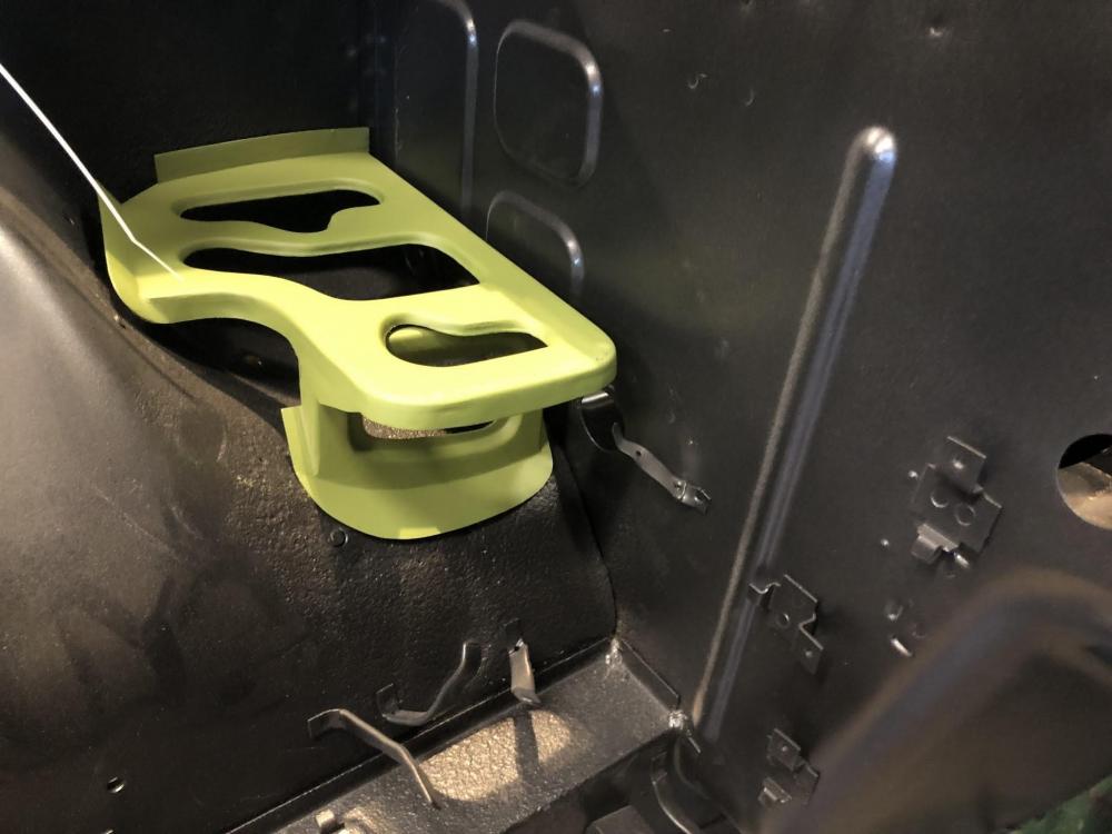

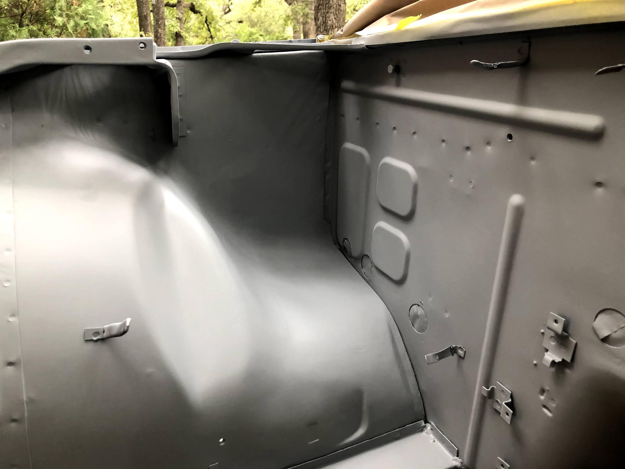

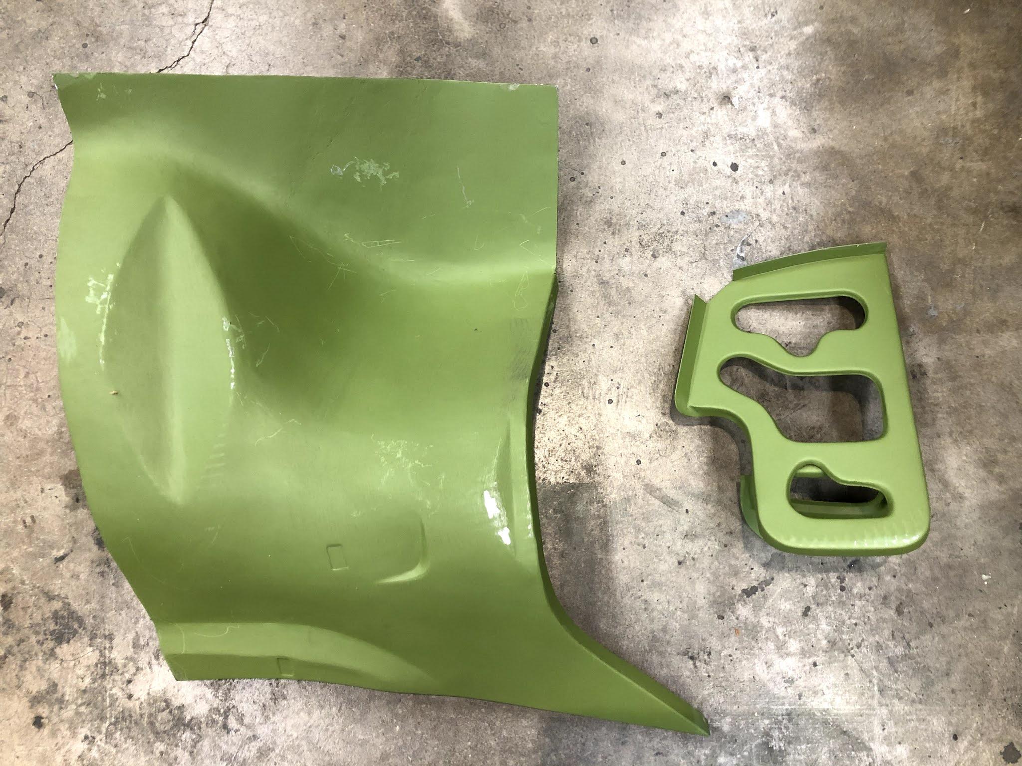

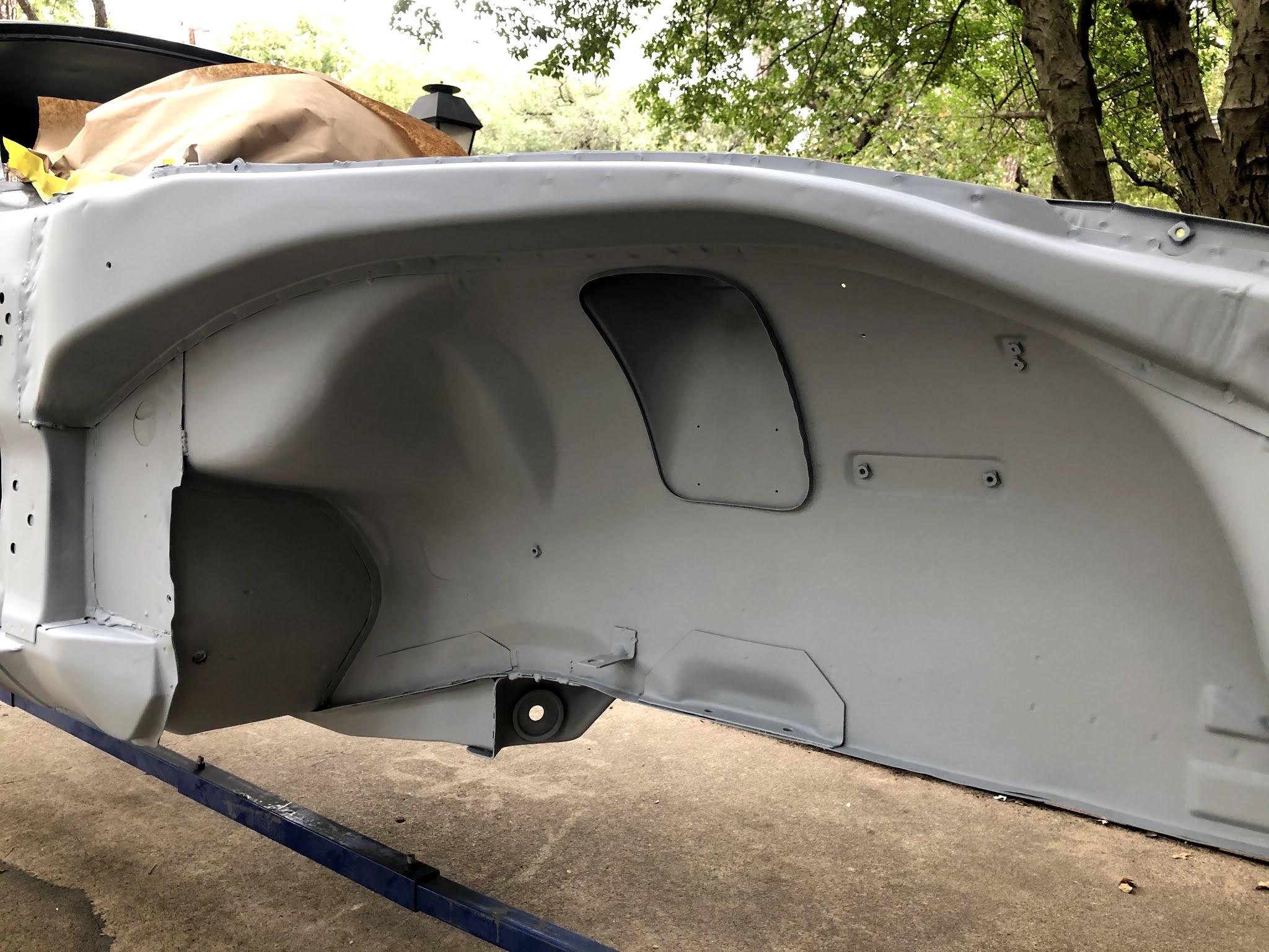

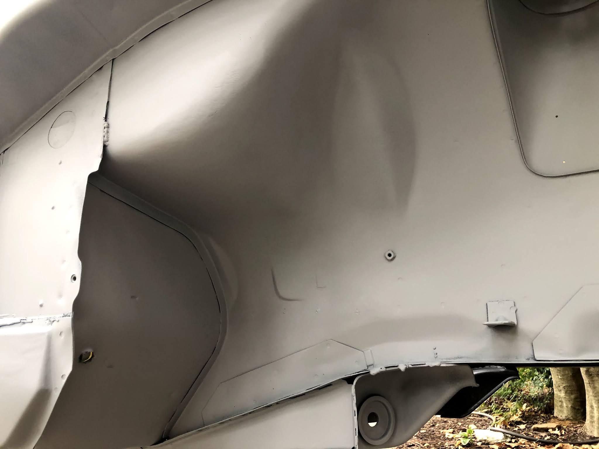

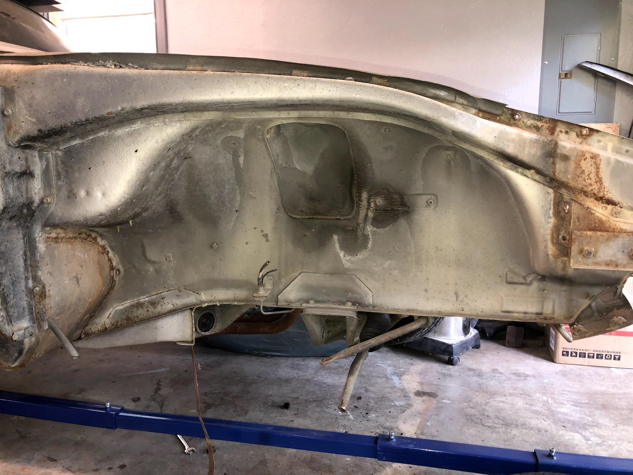

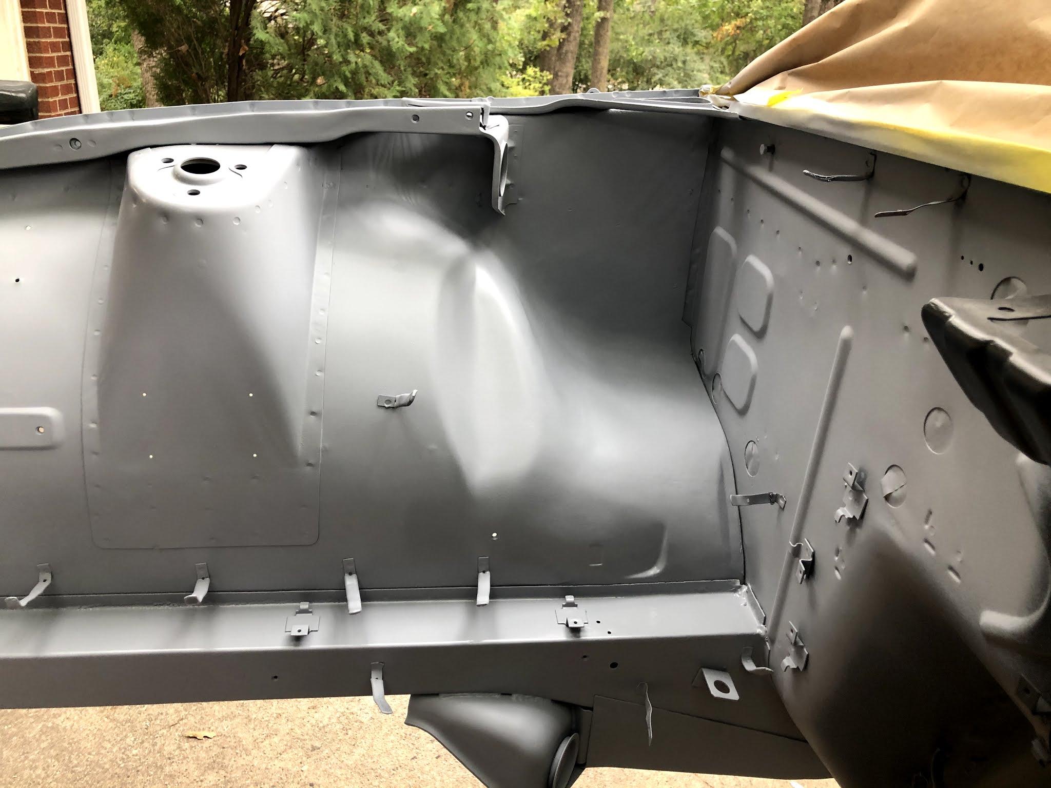

November 11, 20204 yr Author comment_610113 Huge improvement was made to the Z body. Before blasting the car, we removed the battery tray so that the area around it and underneath could be cleaned up and any rust removed. The battery tray itself was salvageable, but corrosion on the mounting flanges would make welding it back to the body very difficult. As a solution, we order one of the stamped trays from Klassic Fab JDM. Link to their website: Klassic Fab JDM Here's what the area under the battery tray looked like before blasting. You can seem some corrosion between the firewall and under tray area. A part from that this section of the Z was relatively clean all things considered. This tray was a very close copy of the original in size, shape, and appearance. I was very happy with the quality of the piece. The owners were kind and experienced with Z cars which is a bonus. Once the car was blasted, the area around the battery tray had not rusted through, but did show signs of pitting from corrosion. Mocking the new tray into the box showed that the areas which we would weld were thin and would again be difficult to work with without burning through. Fortunately, Klassic Fab also sells a replacement panel for the under battery tray area. This stamped also copied the factory sheet metal very well, even with the stamped locating pads to weld the wiring tabs to. While again not entirely necessary to replace both the tray and area underneath it on this car, we wanted to ensure that this rust-prone area of the Z would be good for another 50 years. The patch panel was trimmed down to the appropriate size, stich welded in, and body worked for a seamless transition from patch to original steel. I was very pleased with how well the panel matched the factory area. We only needed around 50% of the patch panel to remove all the corroded steel. If your Z is in need of a battery tray and/or the area underneath it, I would highly recommend Klassic Fab and the panels they offer. Next we'll burn in the tray for good and weld in the electrical wiring tabs. Link to comment https://www.classiczcars.com/forums/topic/64674-restoration-of-hls30-12070/?&page=3#findComment-610113 Share on other sites More sharing options...
