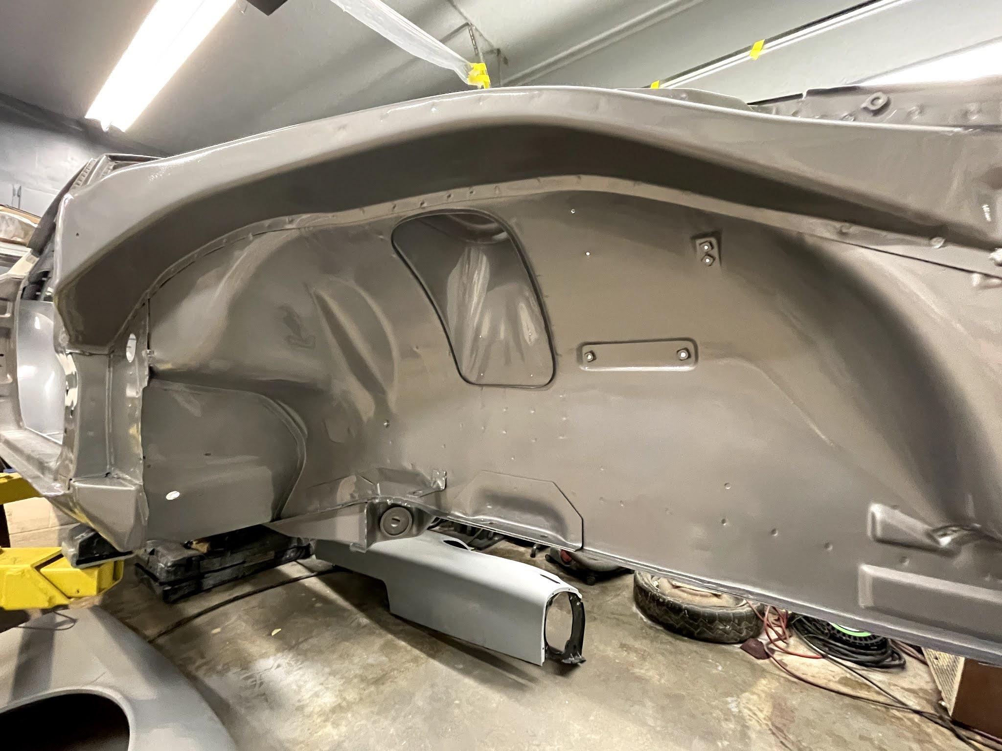

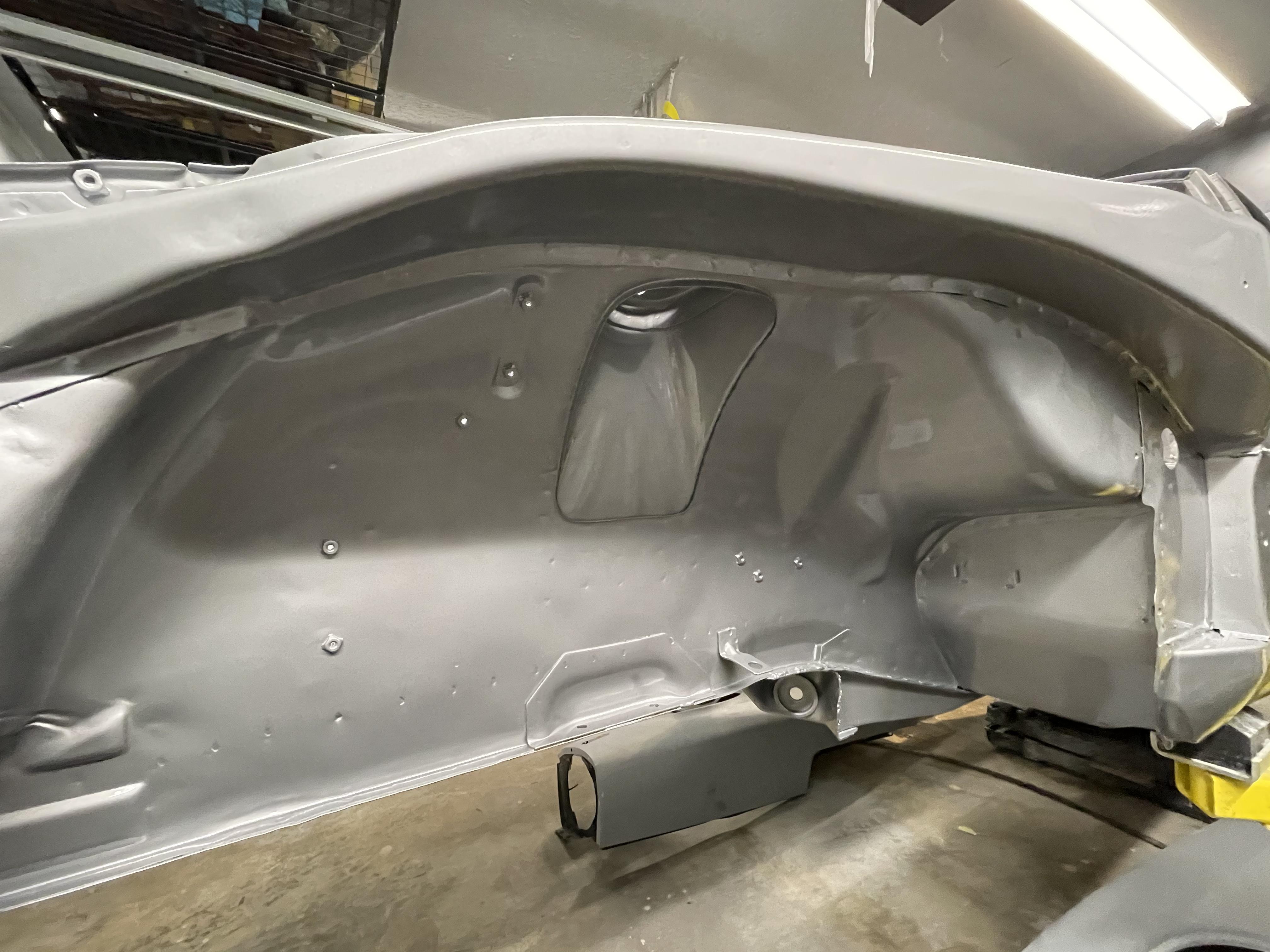

3 hours ago, CW240Z72 said:

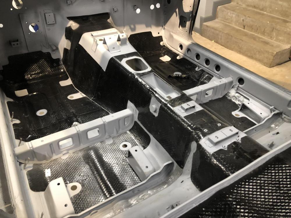

Sound mat was installed in all the factory places prior to paint (including the floor pans). Firewall will get the fiber backed pad installed on it
Floors before paint
Just beautiful. I take it this will be a restoration to bone stock?

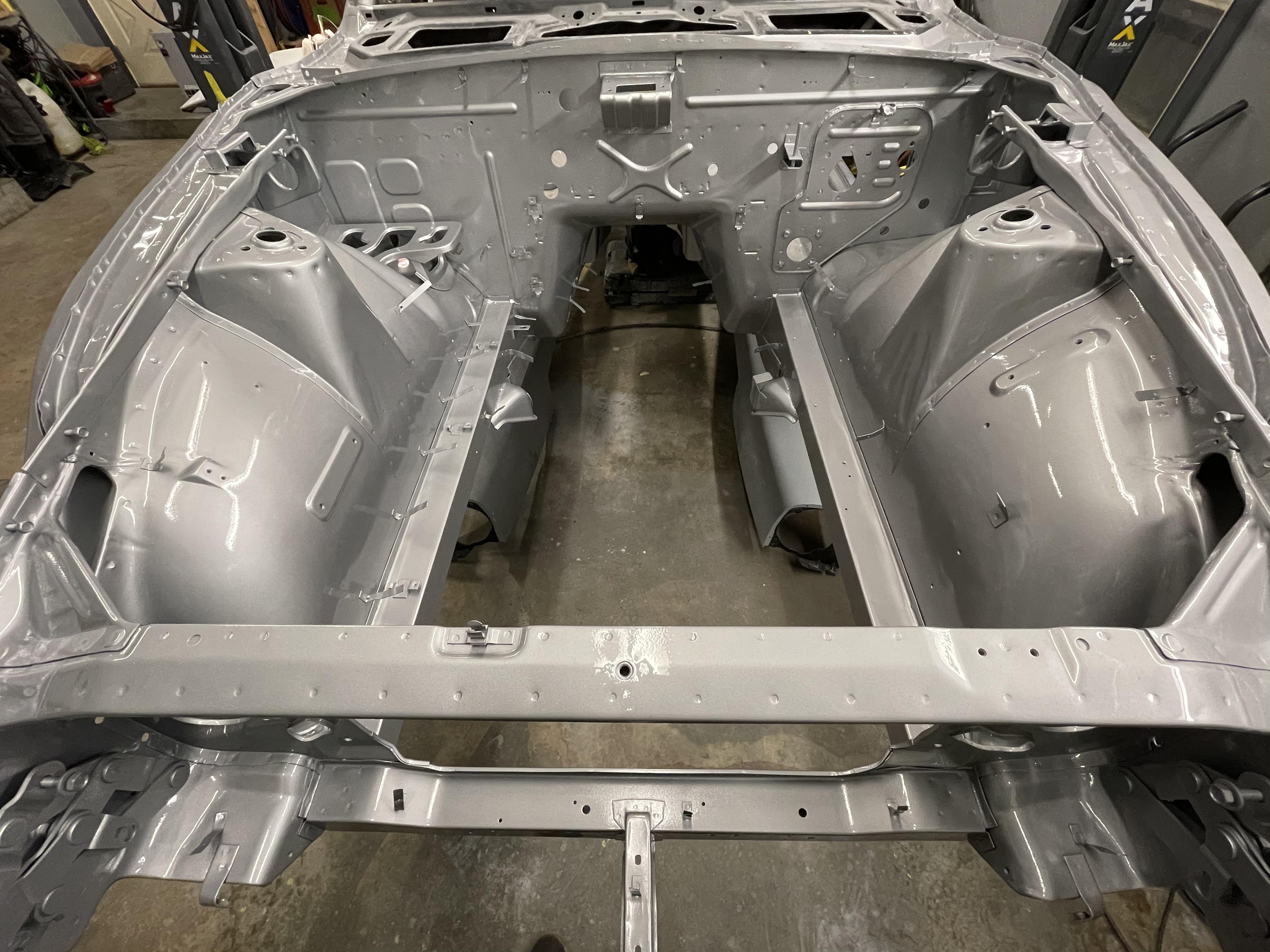

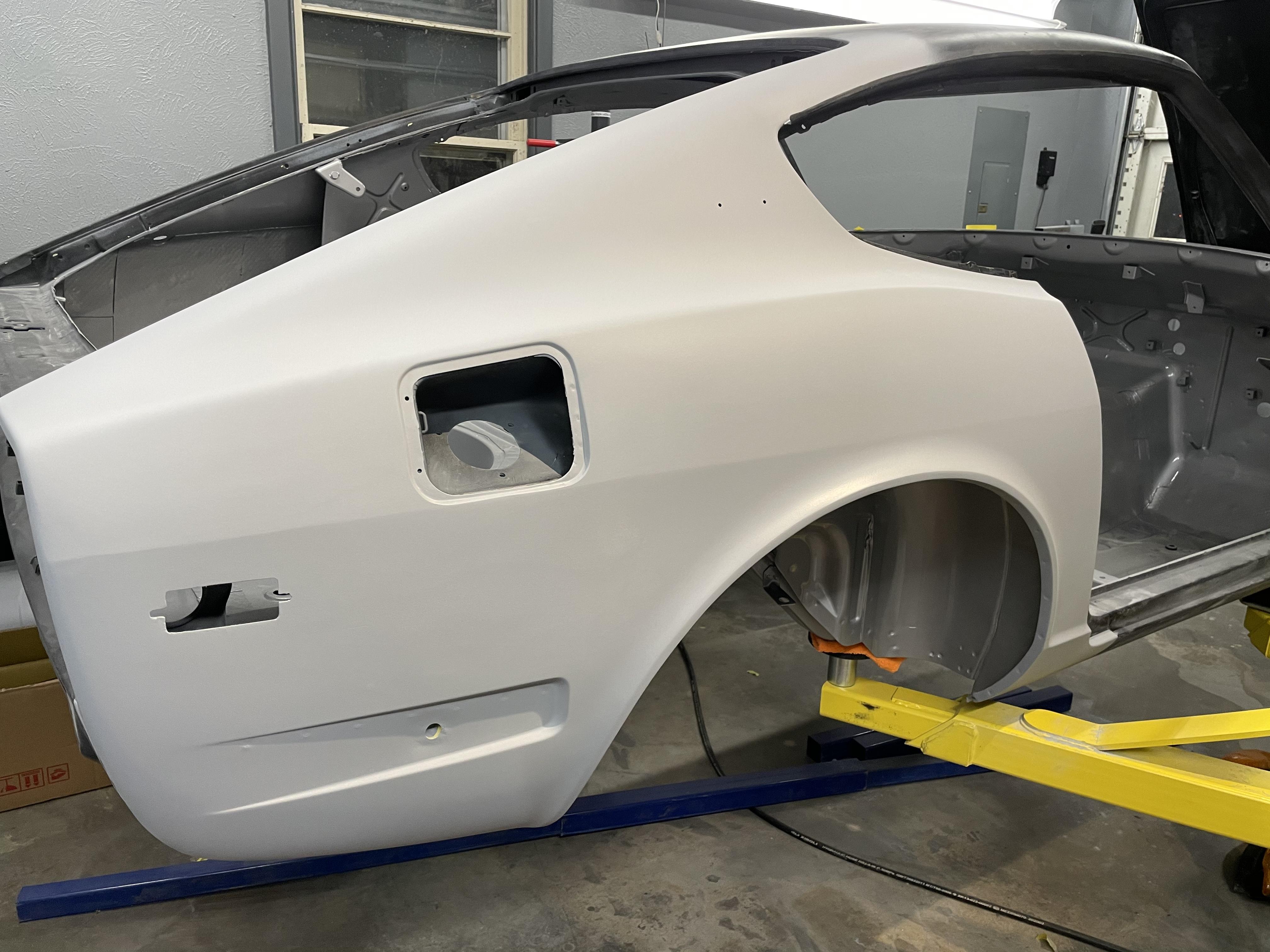

I hope everyone had a nice and safe holiday break these past few days. During that time we worked on the body in preparation for paint. Passenger quarter and fender received the first round of body work and primer. Driver’s side soon to follow.

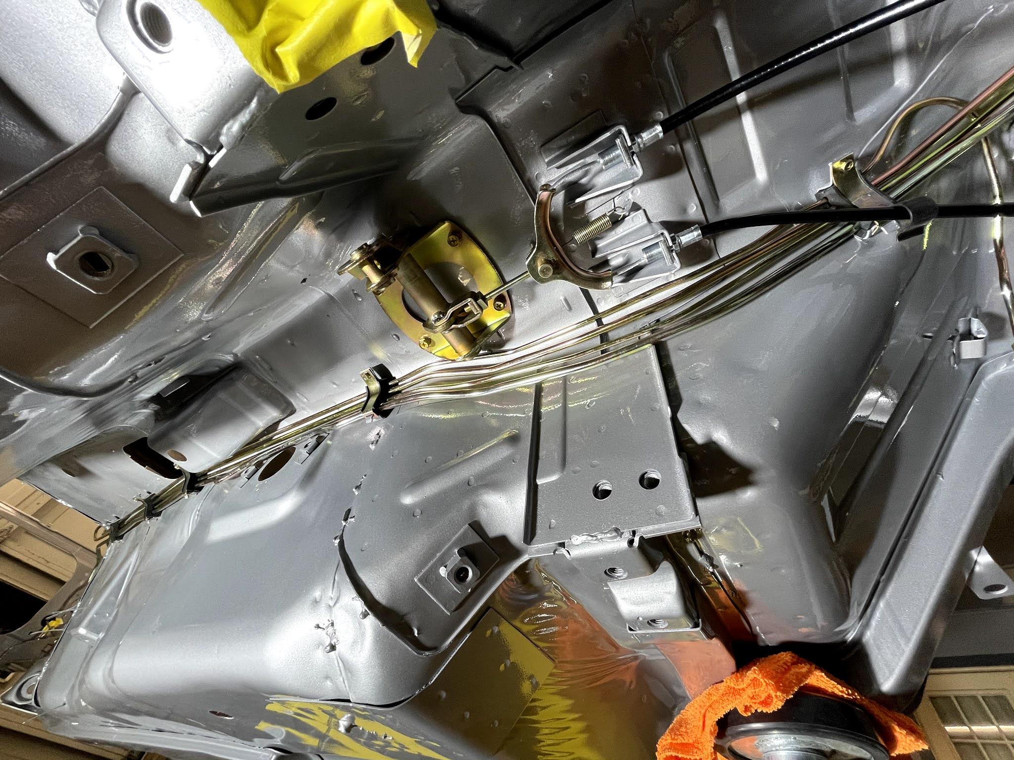

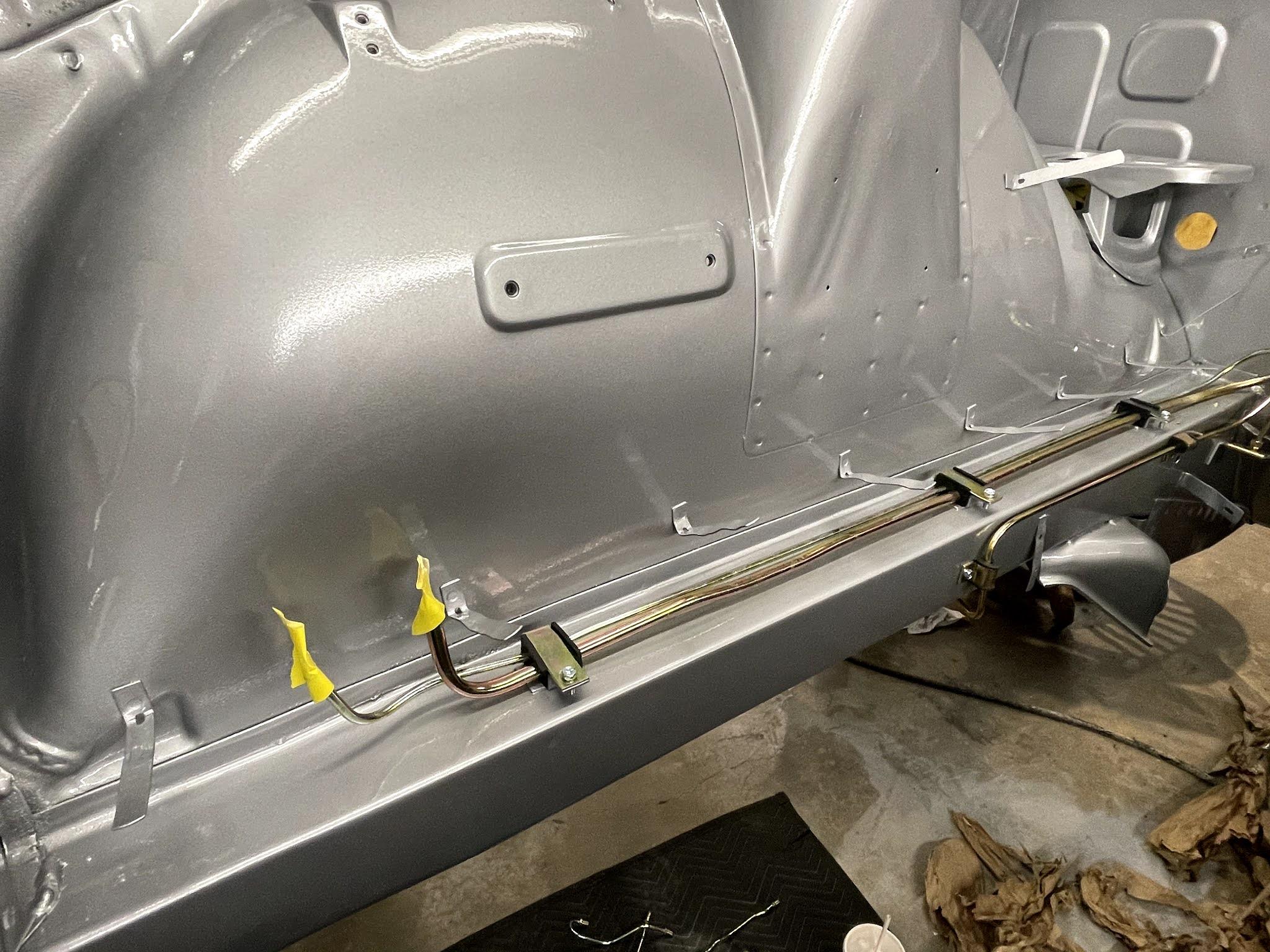

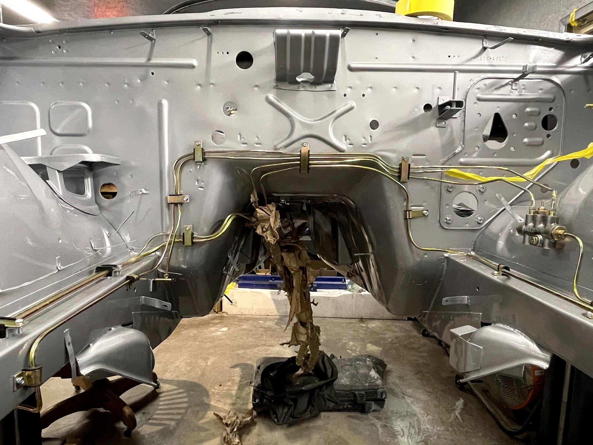

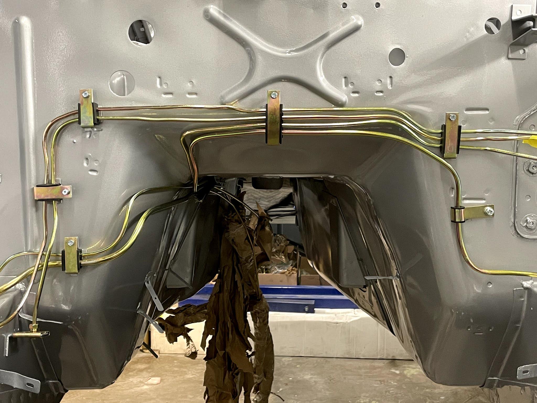

The quality of work you are doing is fantastic, it's a pleasure watch but the brake lines really stand out as not up to the same level as the rest of your work.  Sheet metal ViseGrips wrapped in a few layers of masking or electrical tape will make a big difference in their appearance.
I don't mean to criticize but just thought I would mention an easy fix.
Great idea, I appreciate the tip. That’s one reason why I like having this restoration thread. People can provide ways to improve the build process along the way, and it also keeps me accountable for posting updates.
I’ve got a set of vise grips like that I can use. The shot looking down the trans tunnel only had the lines fastened down up to the shifter cutout. The rest of the length was free hanging and in twist. Since then they’re all installed, but have a few irregularities in the lines I can fix. Will be working on that next.

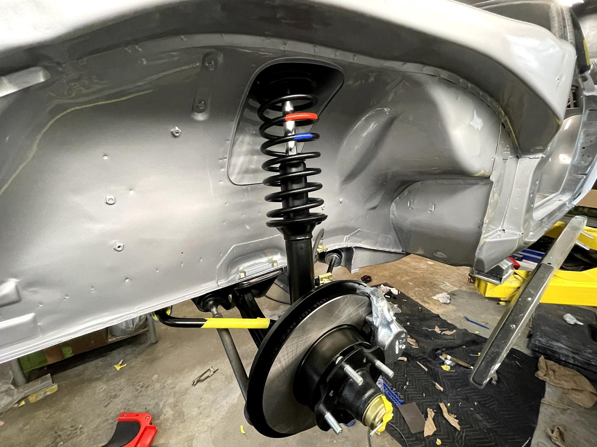

Few additional pictures of updates made on the Z.

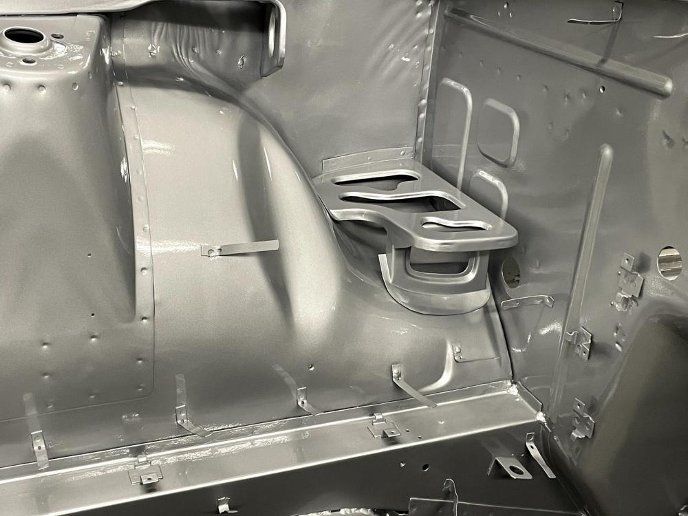

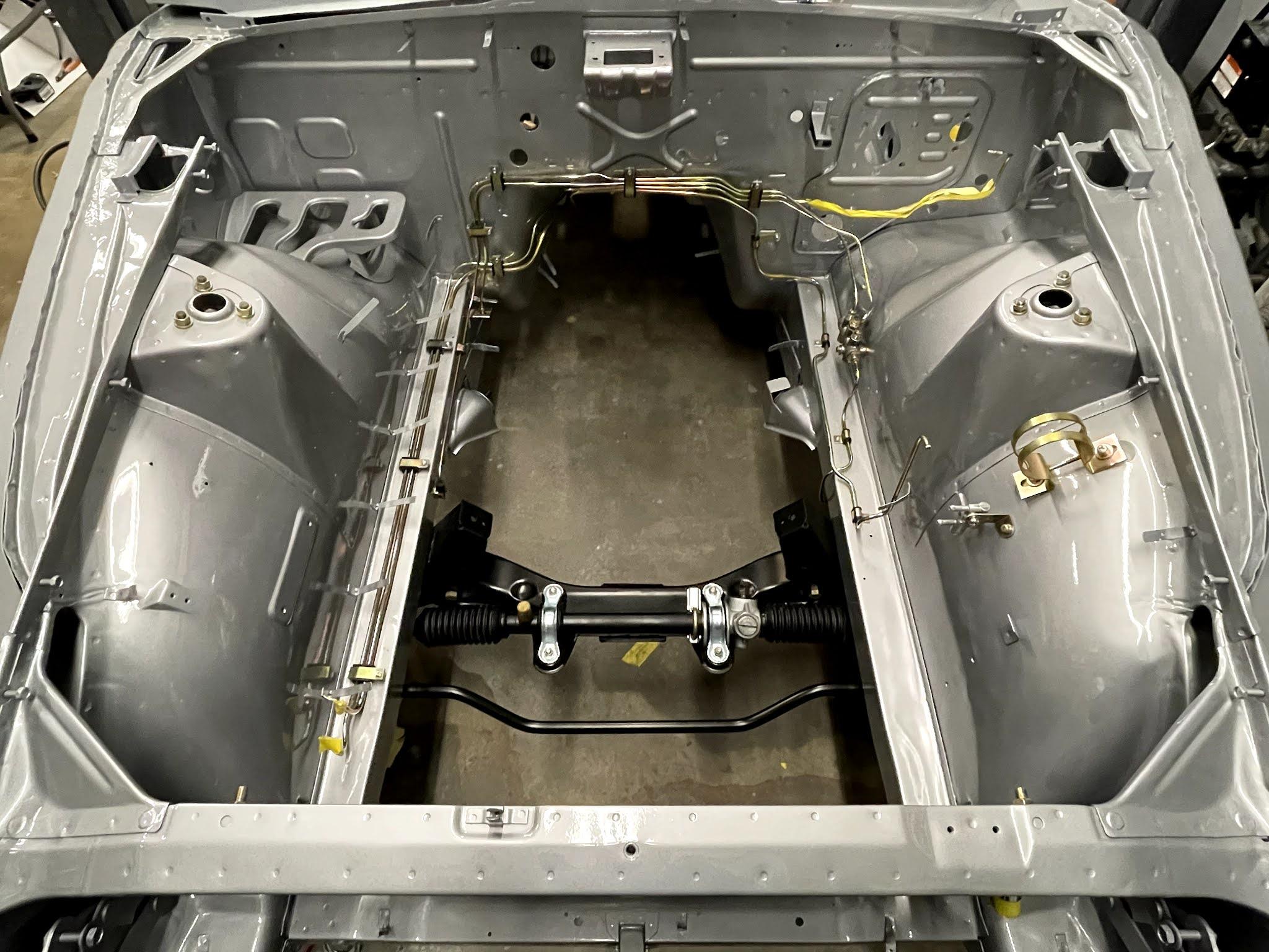

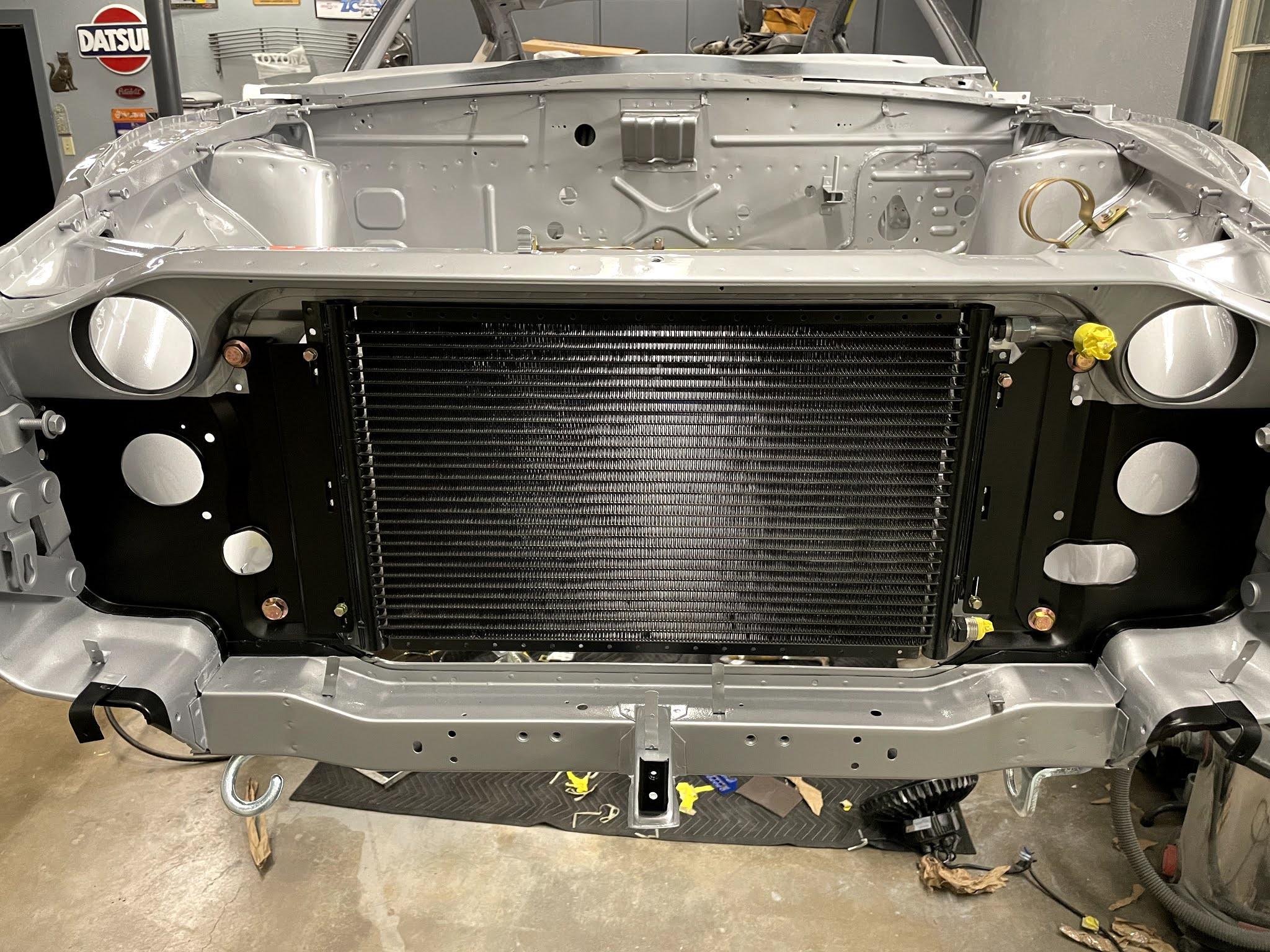

We blacked out the core support and grill mounting tabs (thanks to @jfa.series1 for his excellent build for references) and installed the condenser mounting brackets built just for this car. Really like how that turned out. Should all disappear behind the grill and keep the AC system eye sore down to a minimum.

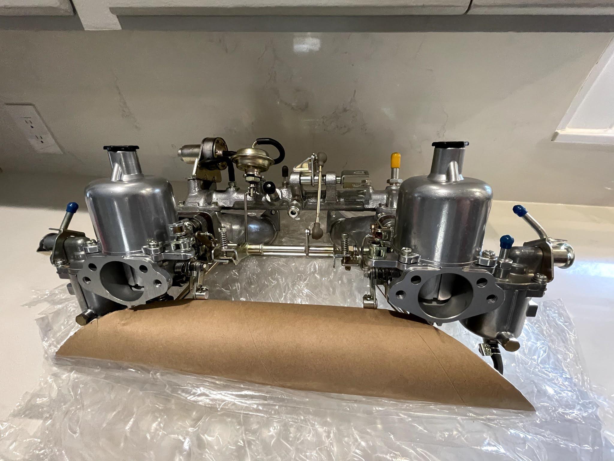

The Z Therapy carbs also showed up this week. Another excellent job by Bruce on these.

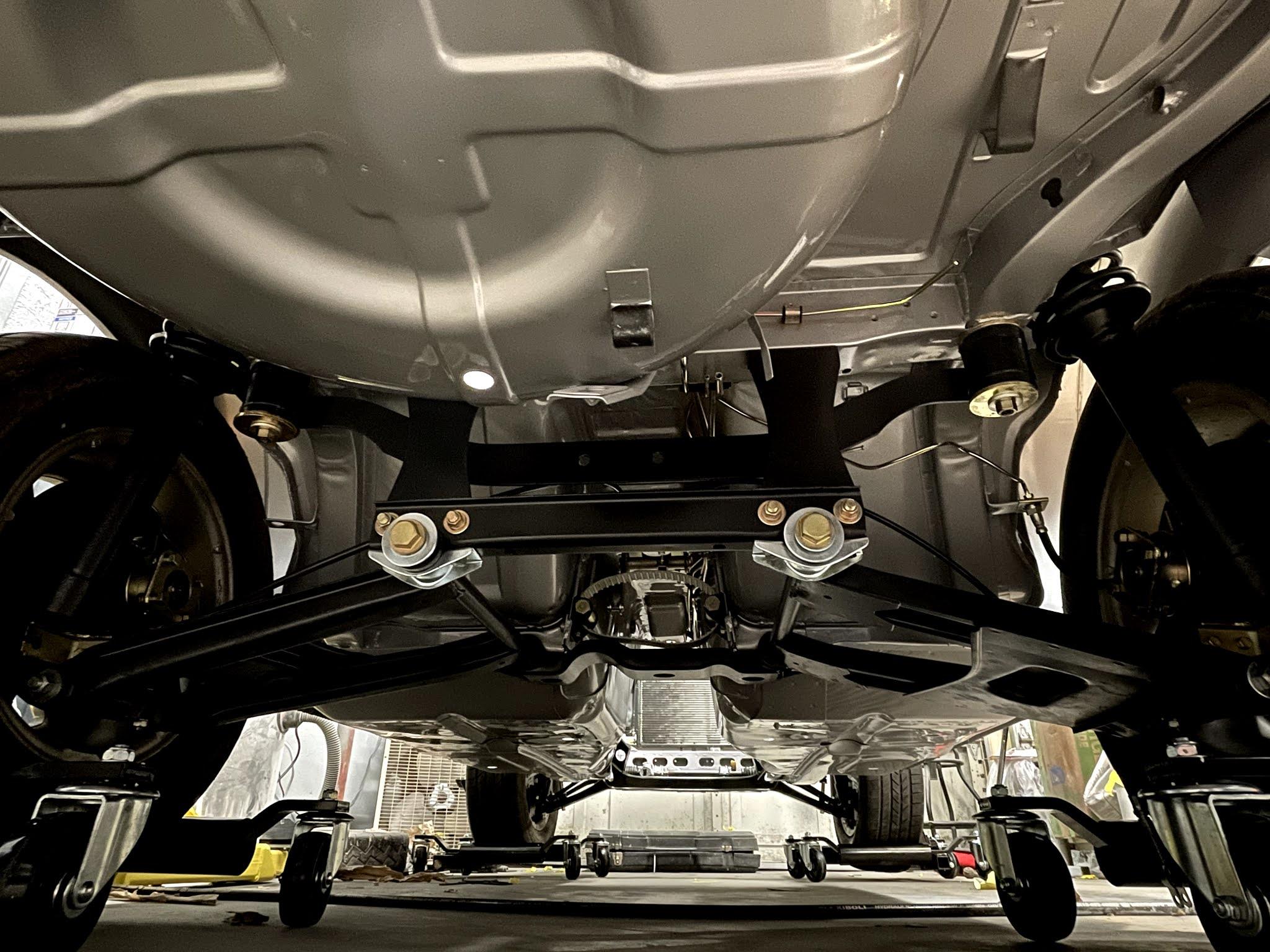

And finally the hand brake and differential strap were installed. Thanks to @grannyknot I can straighten them out even more.
