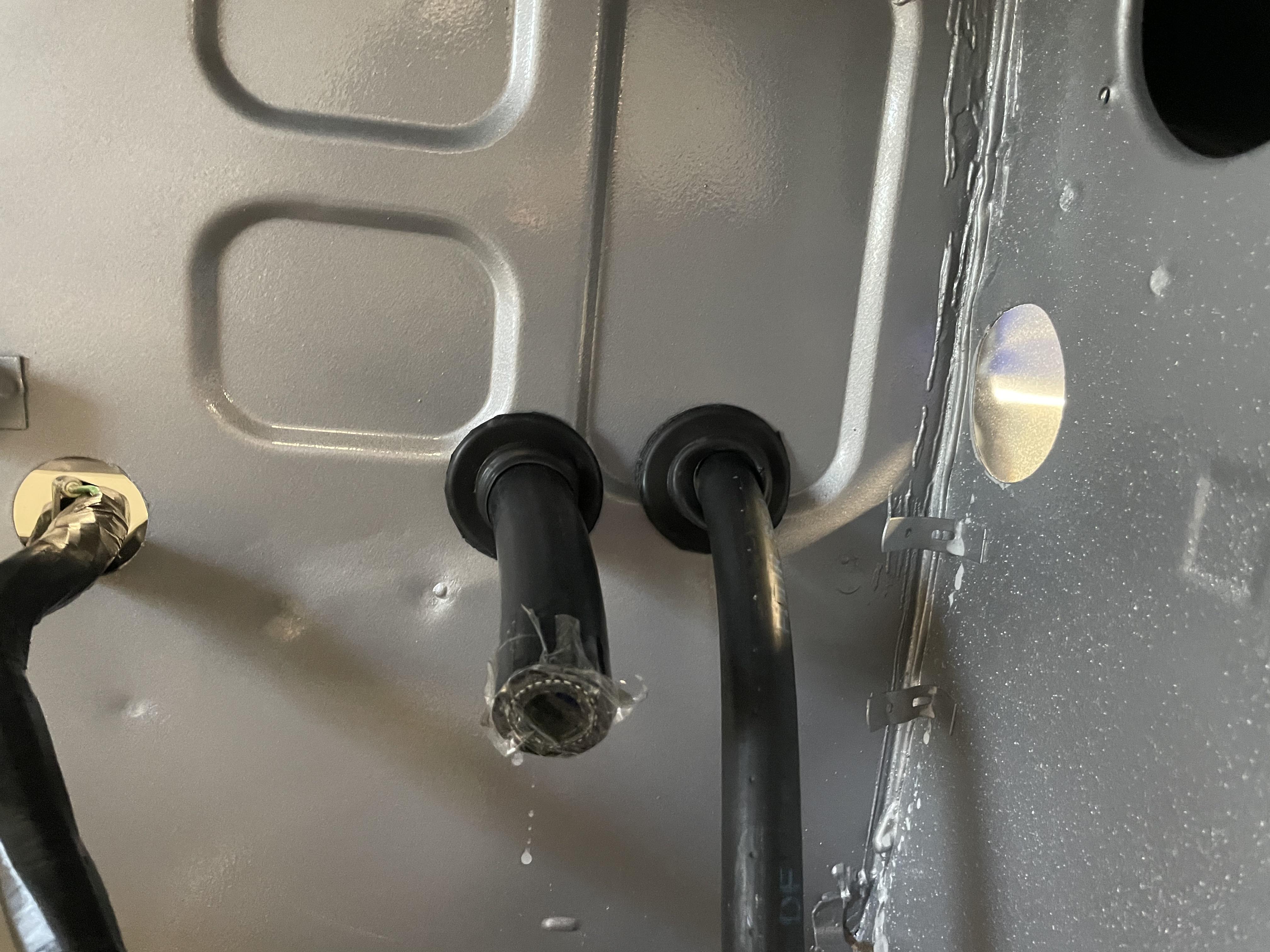

2 hours ago, Dens240 said:
Can you show a photo of your A/C hose penetration through the firewall? Are you using bulkhead connectors in that location?
I'd still like to get up there and see this build in person!
Welcome anytime. Right now I am using the holes previously drilled into the firewall for the AC lines. I’m using the same evaporator that came out of the car, since whoever installed this system previously did a good job routing the lines. Of course, the lines that came in the kit I bought are too short, but you can get an idea for how they’ll look once installed. I’ll add edge trim on some of the battery tray flanges prevent rubbing too.

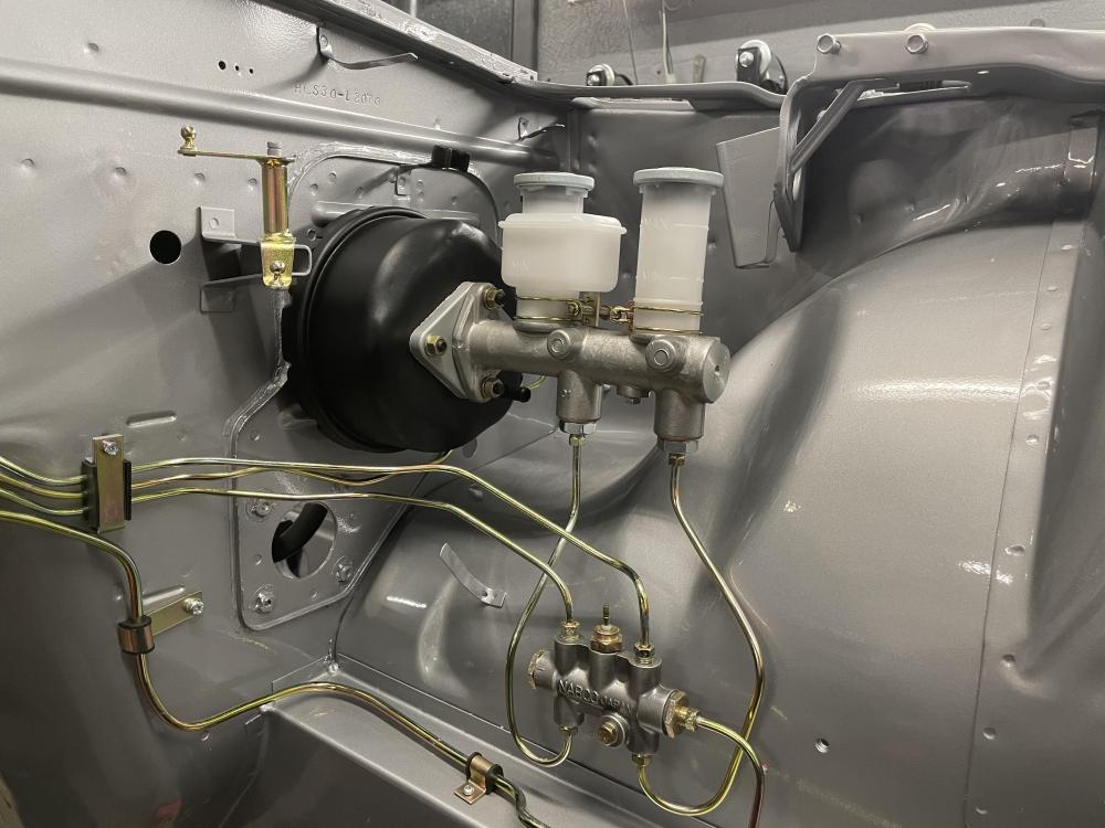

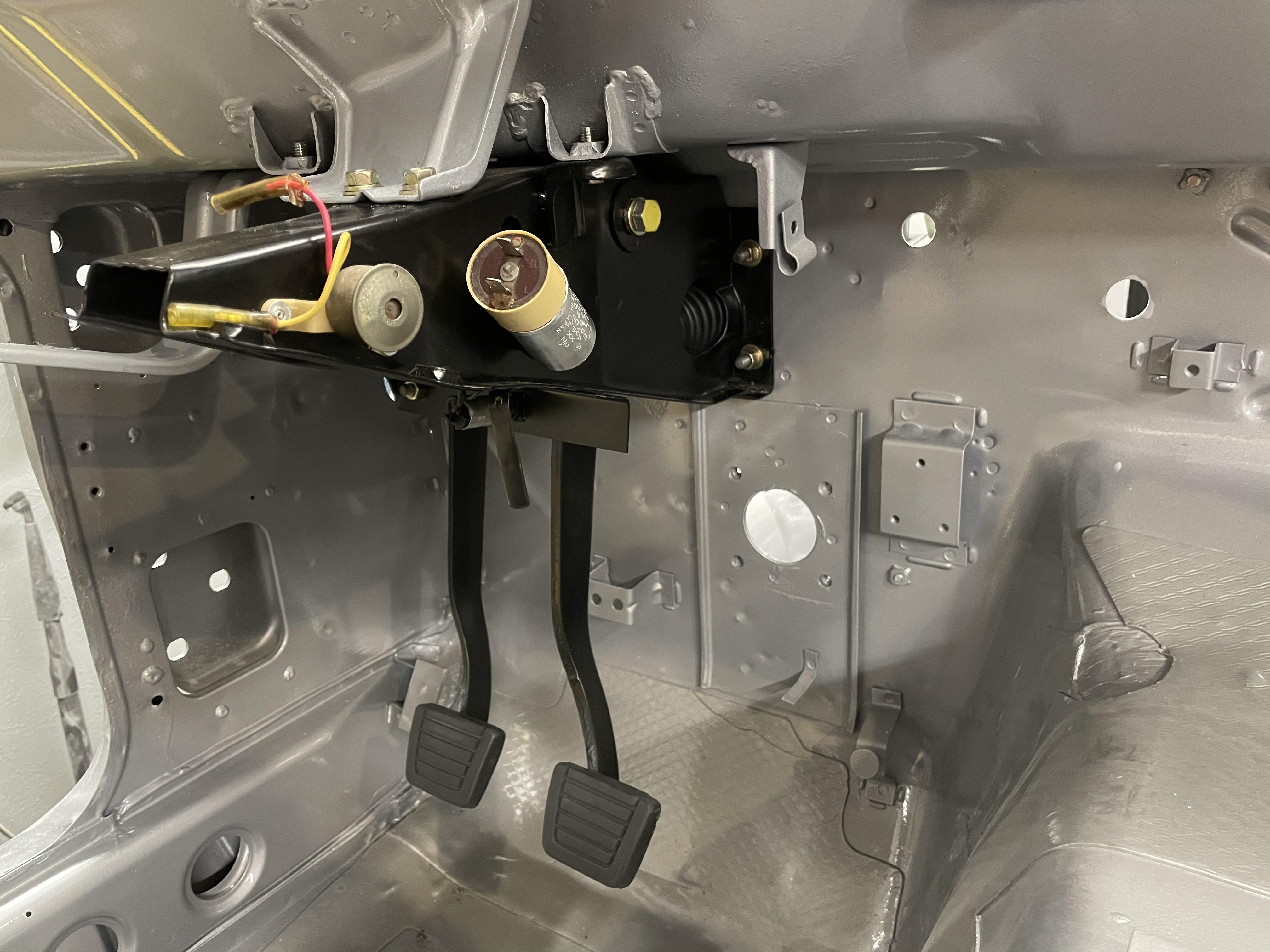

6 minutes ago, CW240Z72 said:
Few updates on the Z. Tonight’s progress includes mounting the rebuilt pedal box assembly, brake booster, master cylinders, and last of the hard lines.
