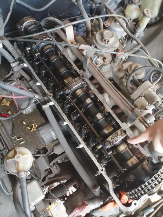

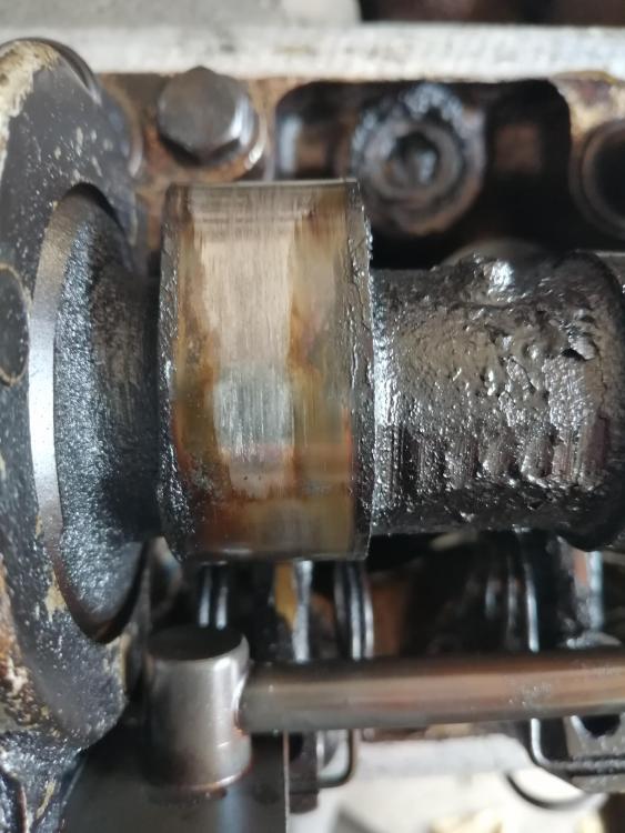

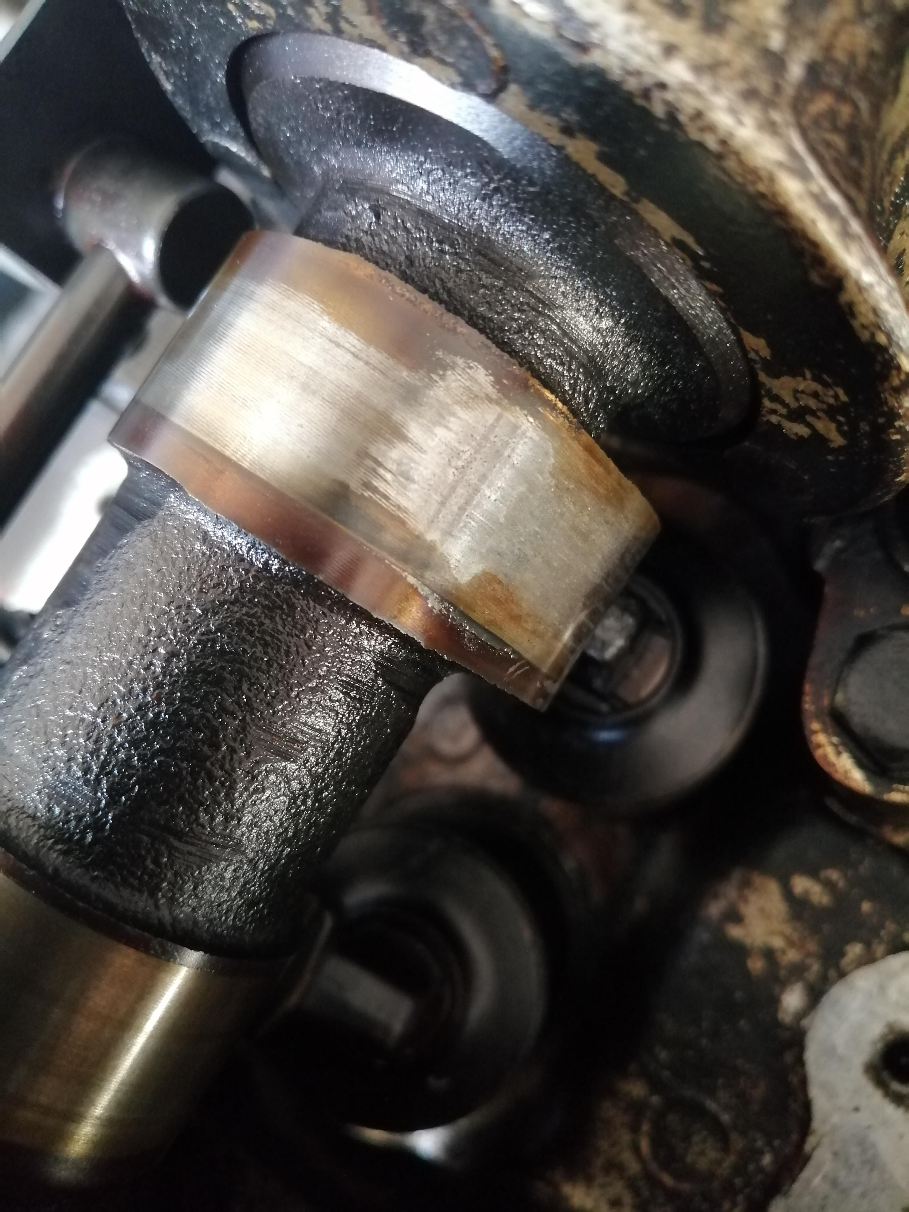

Hello,

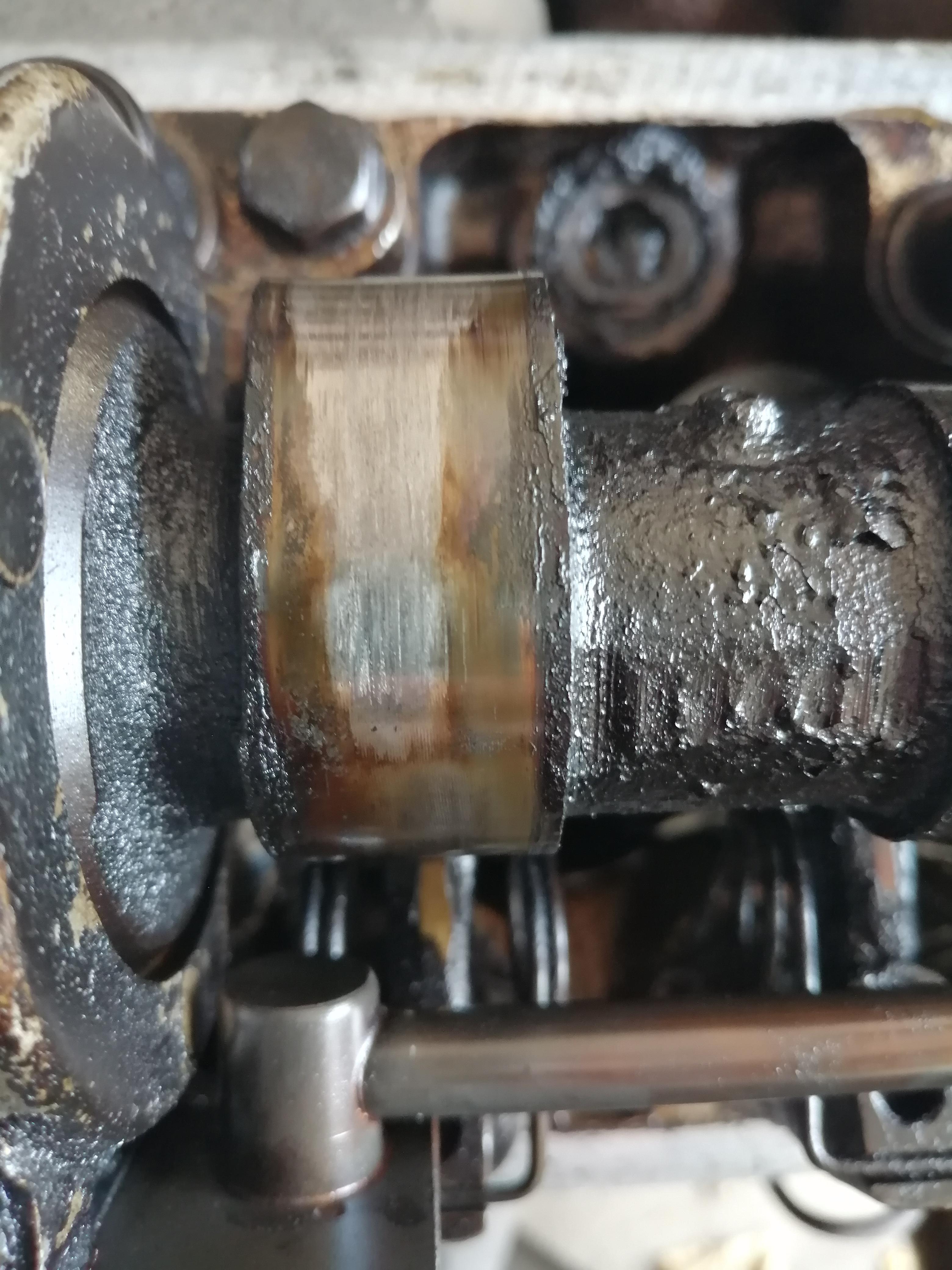

A few days ago I removed my valve cover to see how things are looking under there (currently restoring the car) and found that my camshaft looks really bad.
Can it be saved? the oil also smells like fuel quiet bad and since I live in Germany It would be hard to get another engine if the bottom end was also bad because the car was run without oil pressure or something.
I bought a 2.4 motor with e88 head and 3 screw SUs. When I removed the valve cover the smell of gas was strong. Oil pan was like a gas can. One of the carbs was flooding the head with fuel which mixed with the oil through the opening up front on the head. That may be what your's is doing? Is the the oil level high and thinner, smell gassy?
Yes the Oil smells gassy and the level is above the max.
when I find the time I am going to check if the cam has a lip and I will prabably pull the cylinder head of to take it apart and look at the condition of the rockers.

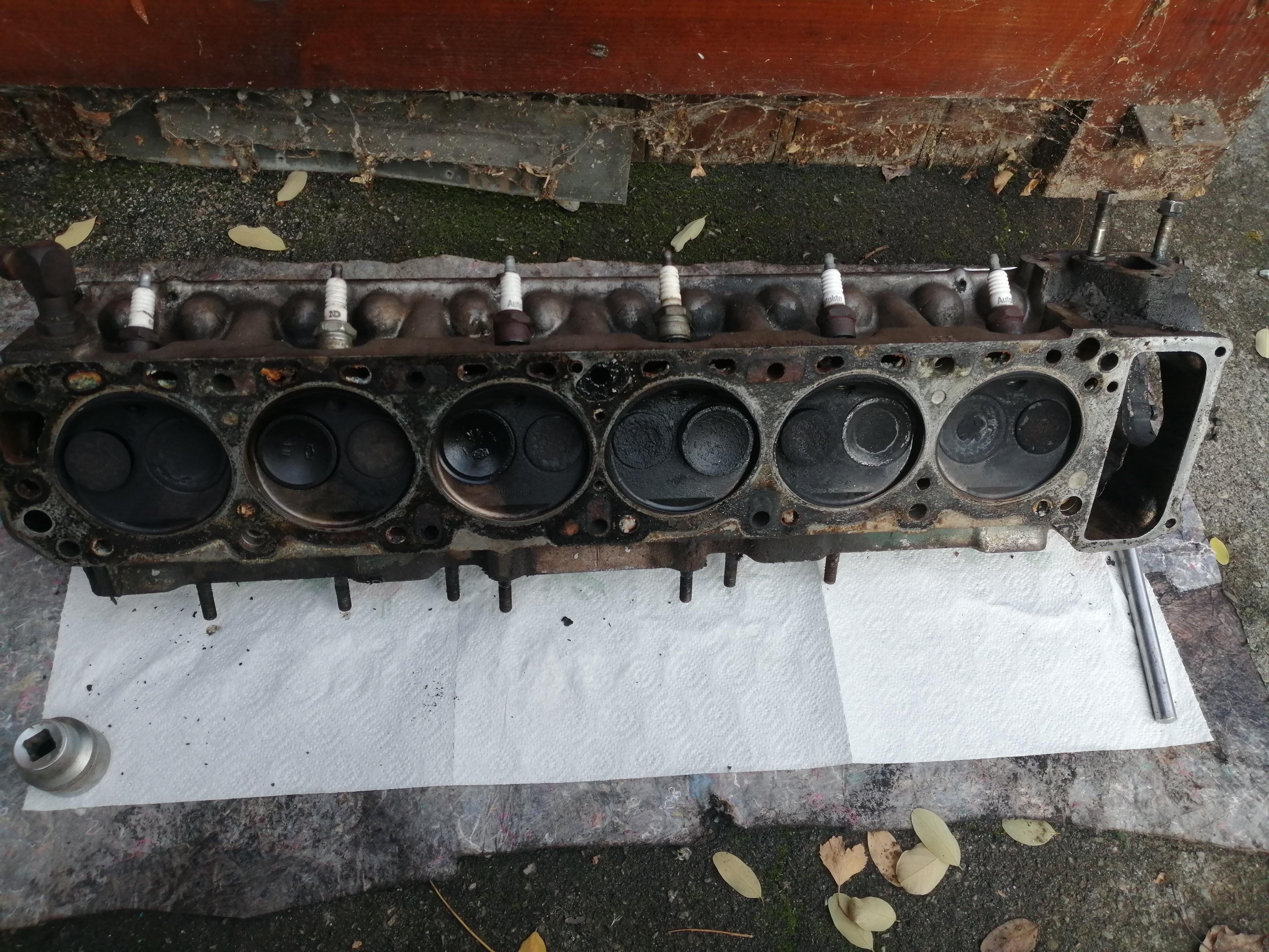

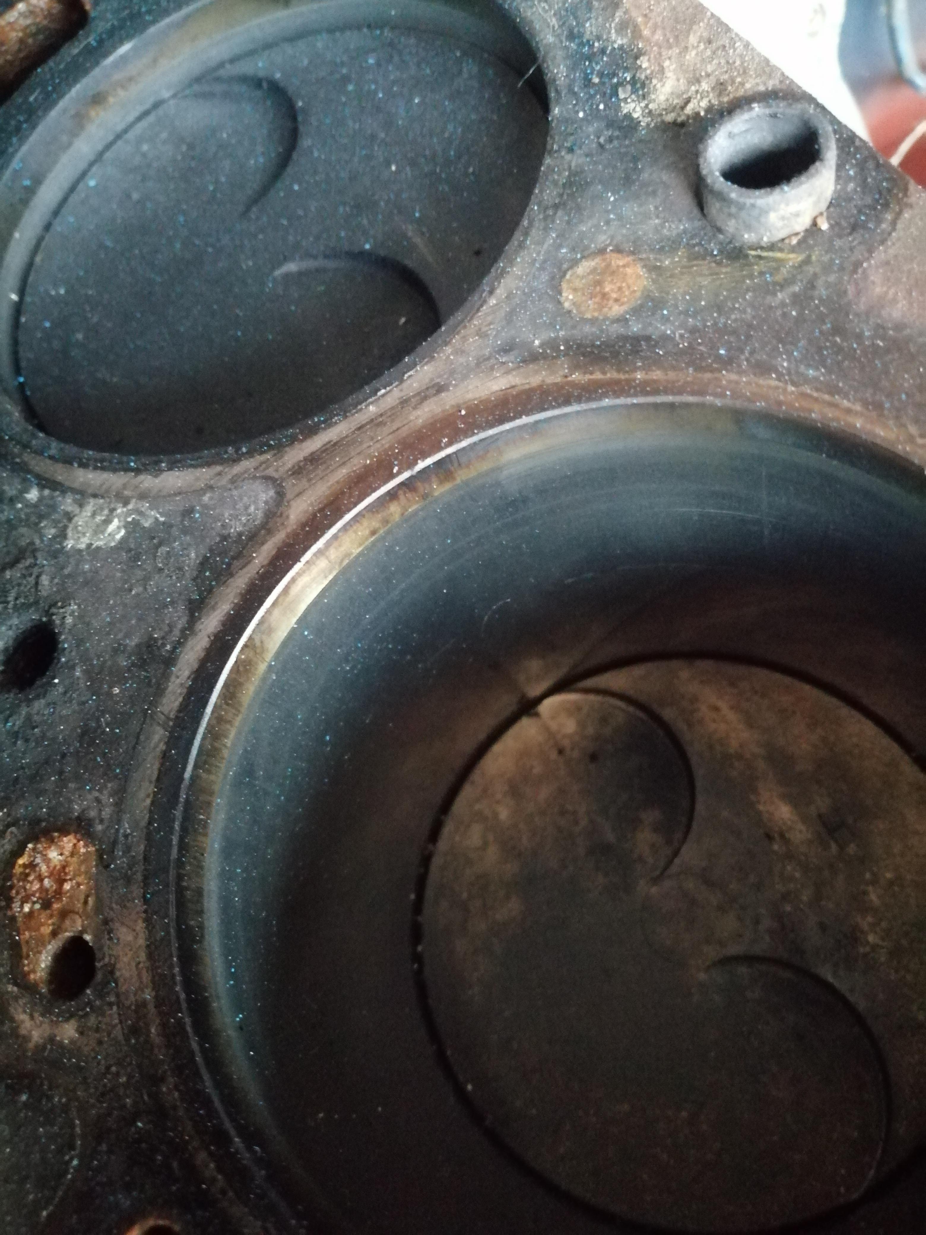

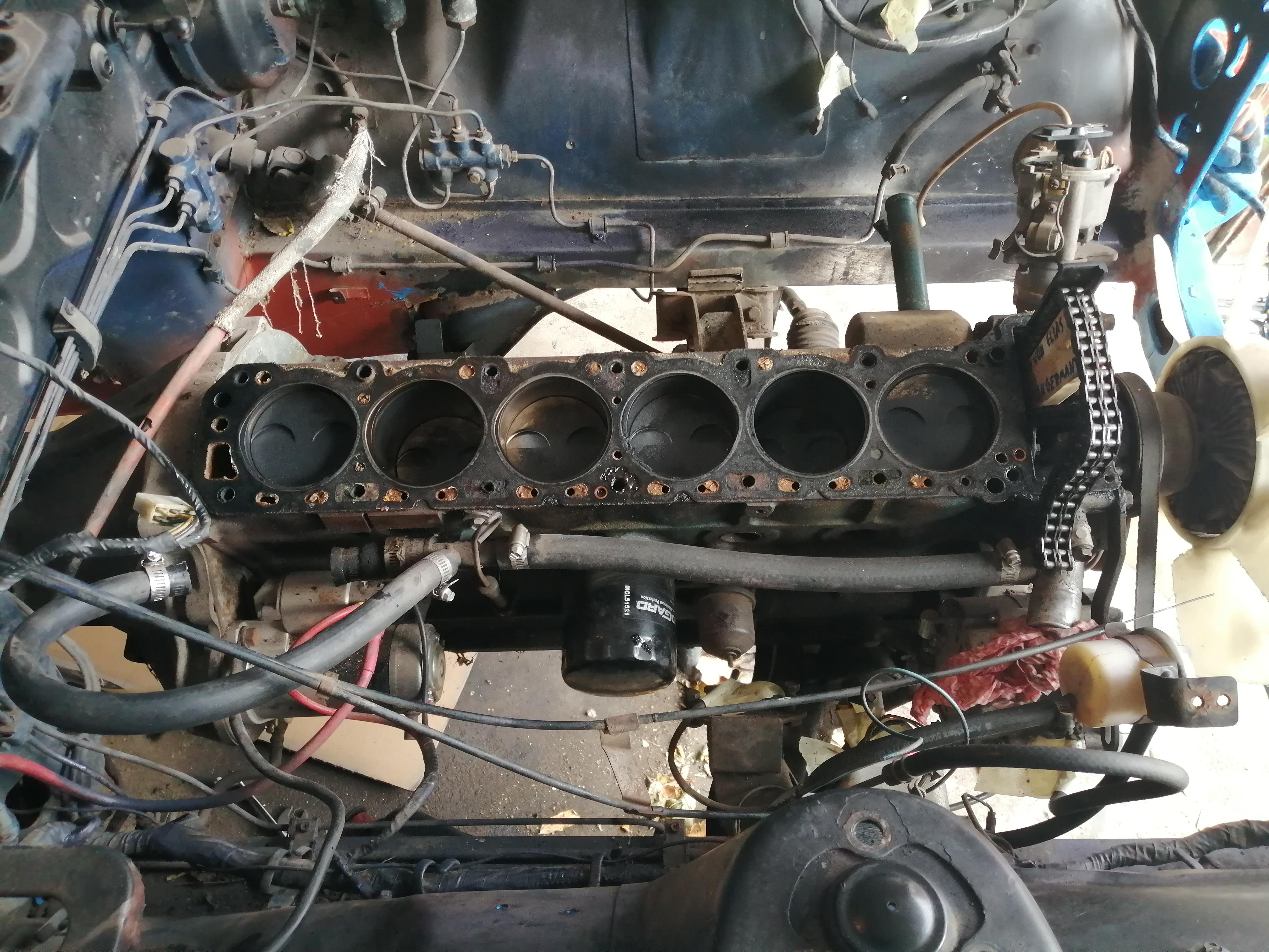

8I finally got around to taking the cylinder head off today and the cylinder walls are not scored but have a little step just above TDC the cylinder head also looks kind of crusty.

Your bores look normal to me. Mine had that unused top grunge. The rings don't go that far up.
Looks to me like your front carb was out of adjustment and carboned up #1 #2 and #3 cylinders, bores and valves, maybe from over fueling?
