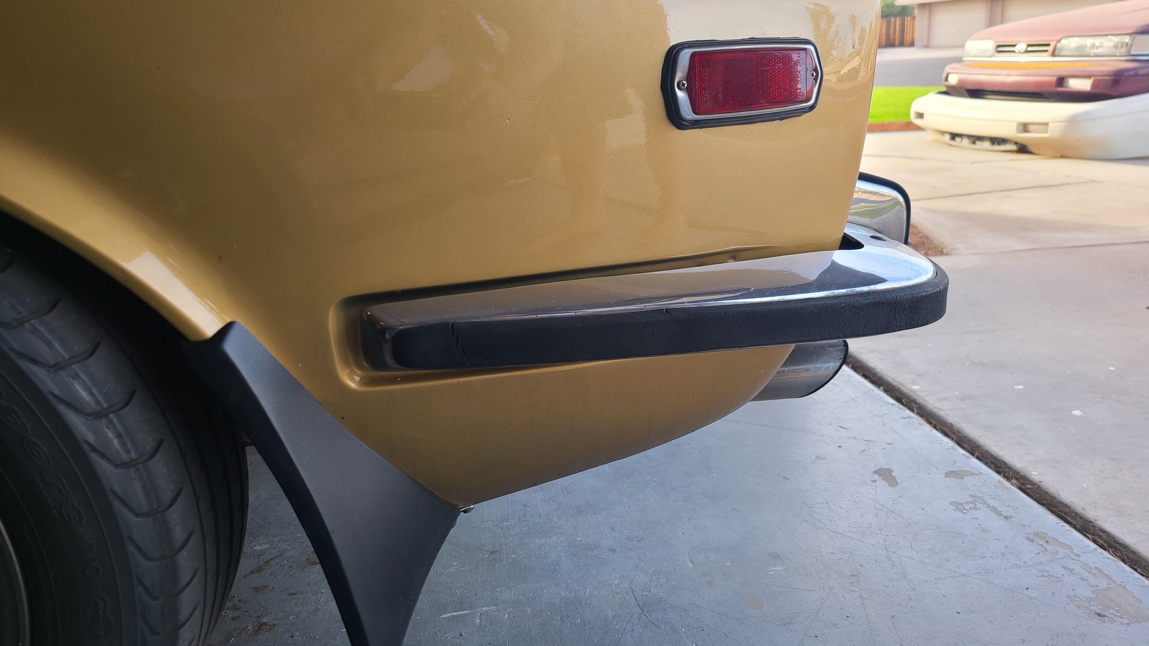

November 22, 20204 yr comment_610955 I hope these aren't huge - Galaxy S20, best camera I've ever had. See, my chopped off bumper strut is still there... Link to comment https://www.classiczcars.com/forums/topic/64753-depressing-early-260z-bumper-struts/?&page=3#findComment-610955 Share on other sites More sharing options...

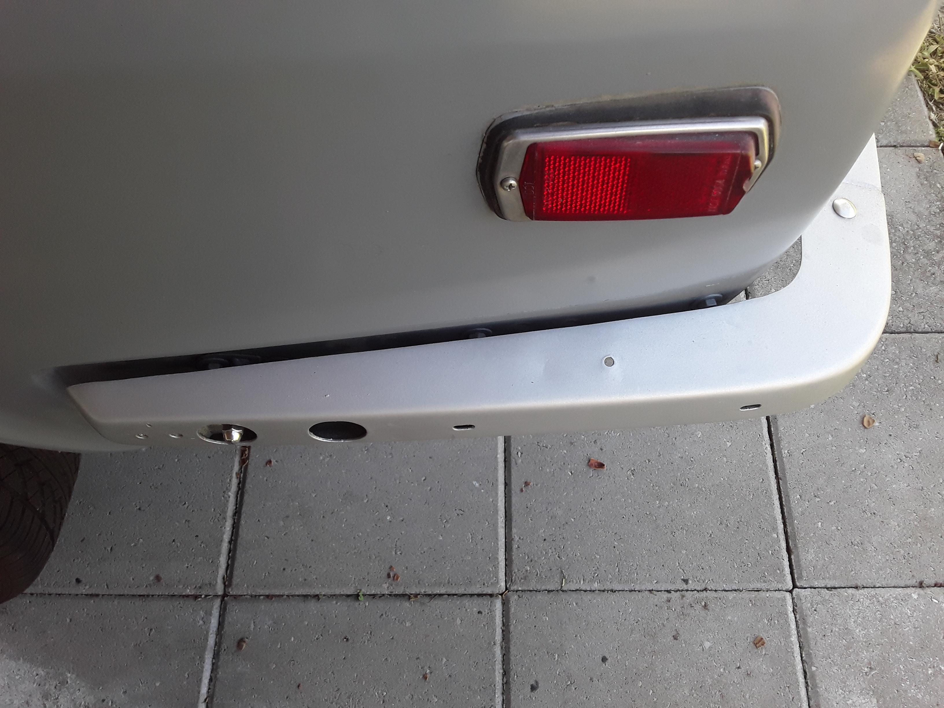

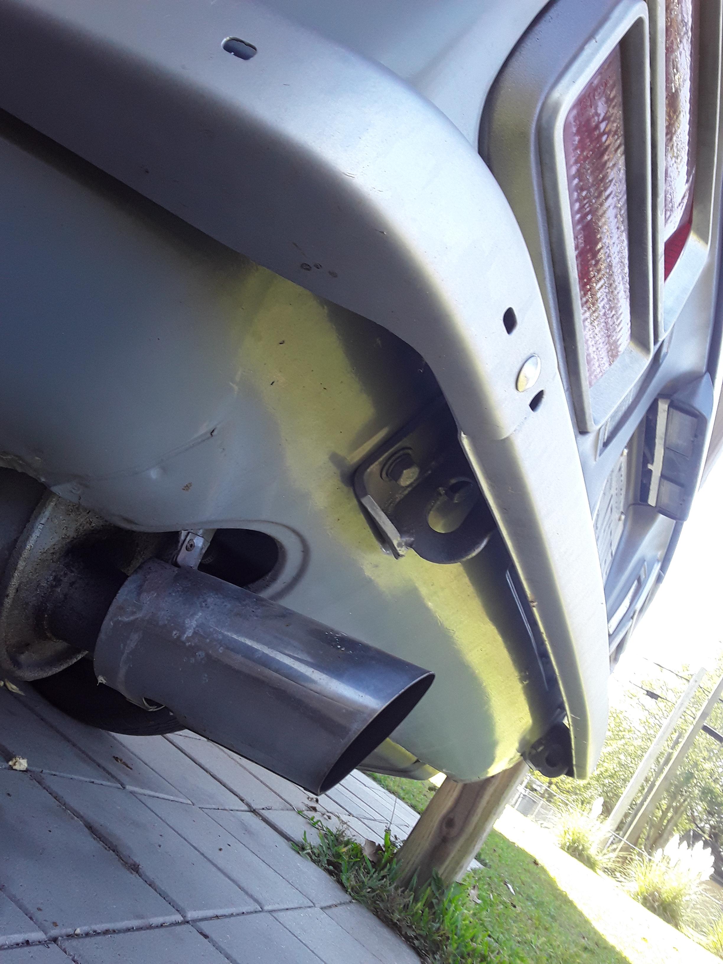

November 22, 20204 yr Author comment_610956 It looks like there is a small dimple that needs to be pulled out of the bumper.... does the chrome finish not like betting beat on with a hammer? Maybe can push it from the backside? The mount points seem to be way off ~7in to where the actual supports are. the strut faces are visible from the bottom, if you are laying down in the street looking at the car 😂 Link to comment https://www.classiczcars.com/forums/topic/64753-depressing-early-260z-bumper-struts/?&page=3#findComment-610956 Share on other sites More sharing options...
November 22, 20204 yr comment_610961 You're correct, chrome doesn't like to be hit - not with a metal hammer. That indent would need to be pushed (pressed - from the backside). Someone skilled might hammer that out but not the way you'd think. I'd advise against trying it yourself (if you need to ask the question, you probably can't complete the task...) Most formed metal likes to go back to it's formed shape unless it's stretched too much. Link to comment https://www.classiczcars.com/forums/topic/64753-depressing-early-260z-bumper-struts/?&page=3#findComment-610961 Share on other sites More sharing options...

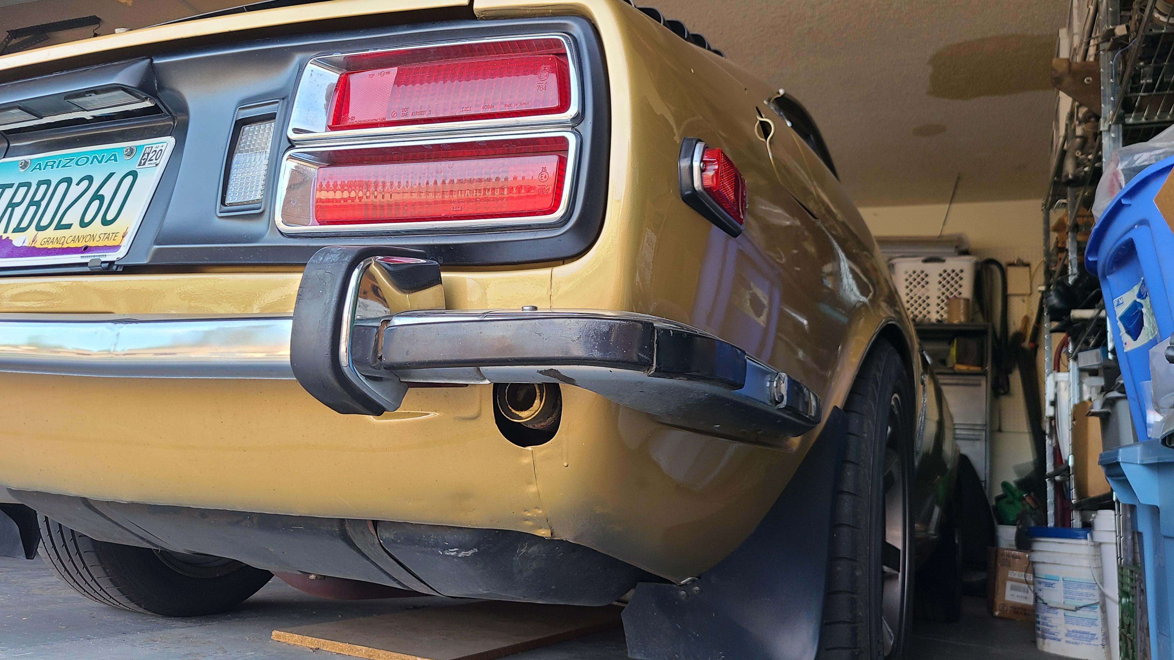

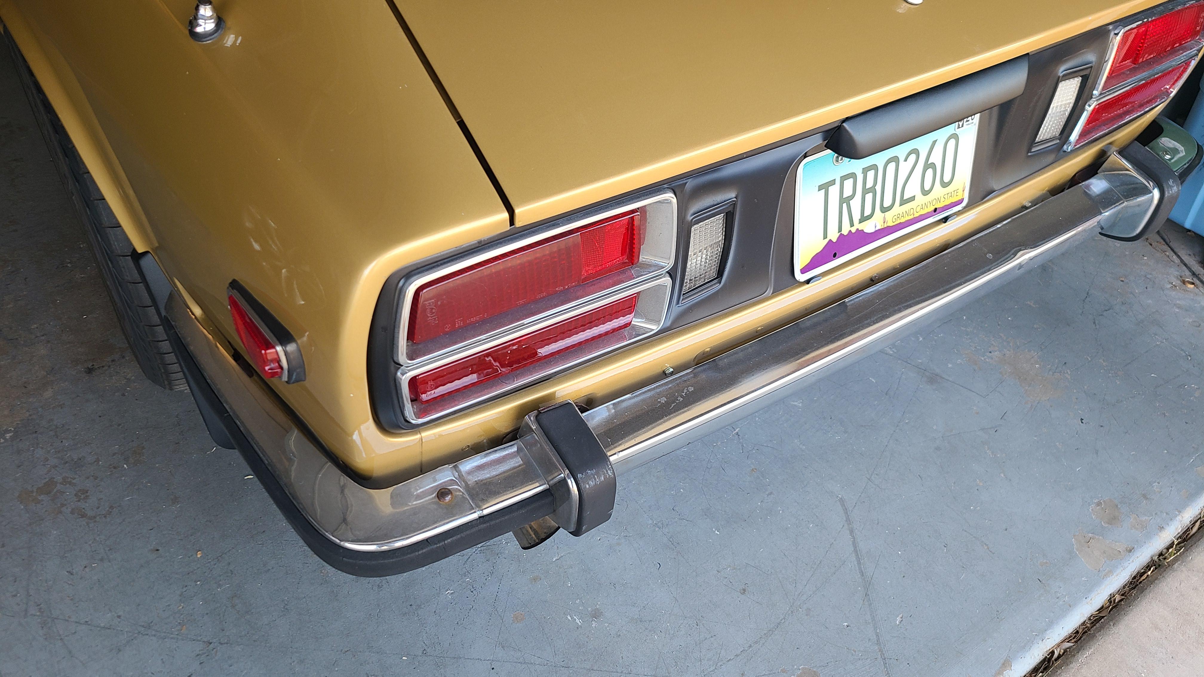

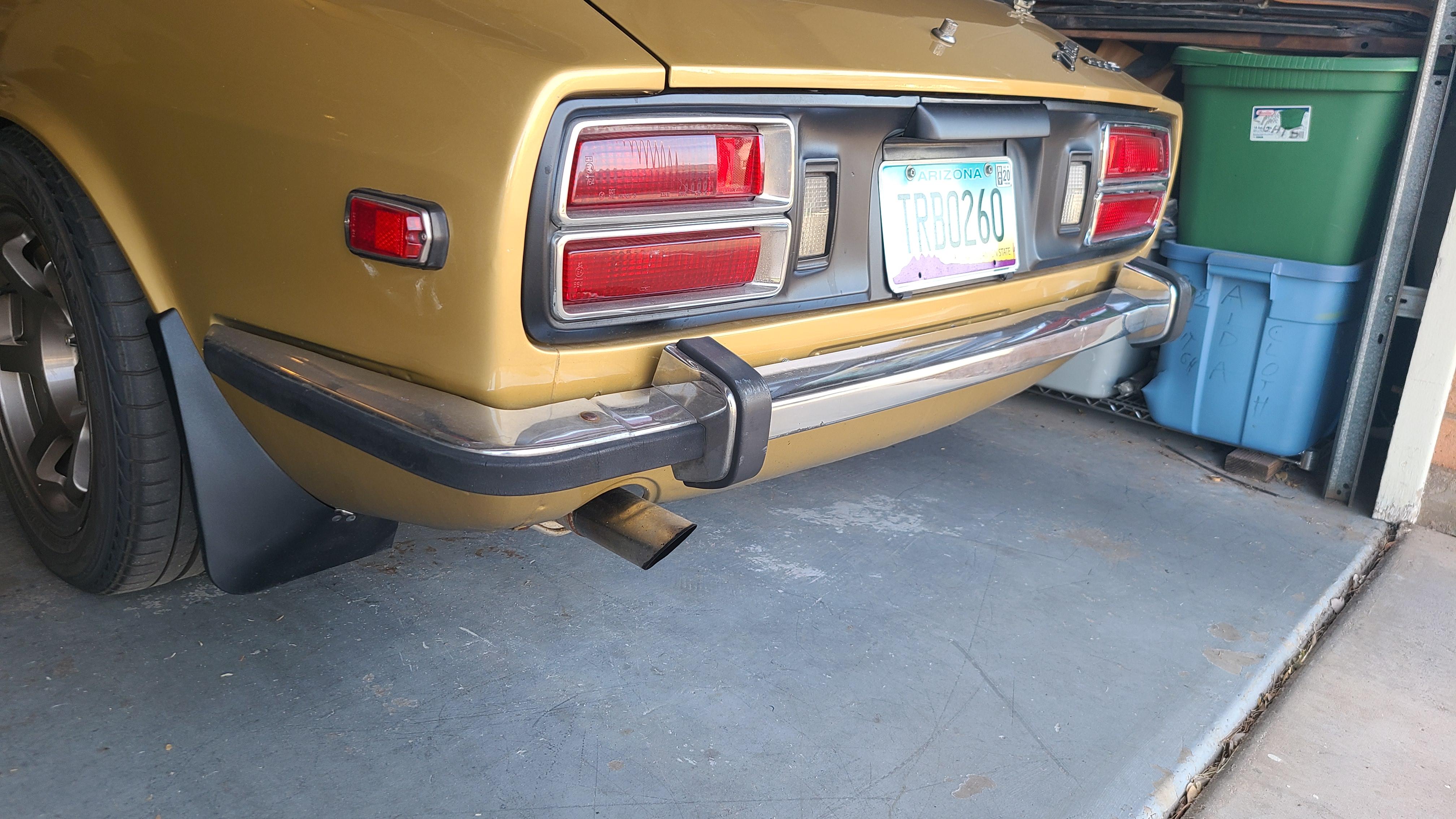

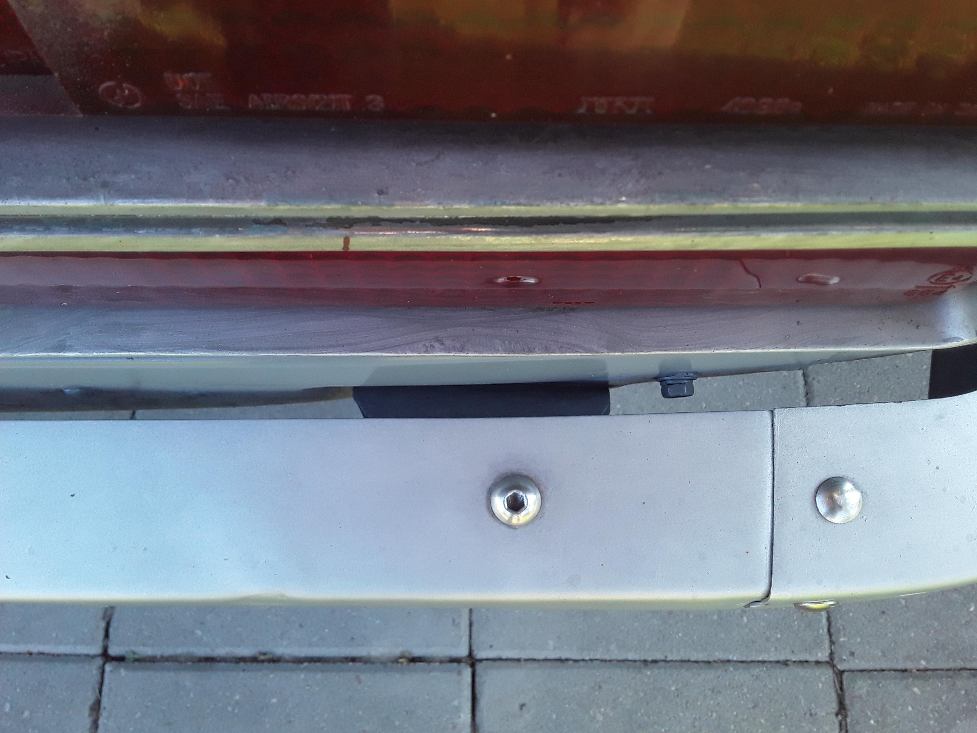

November 23, 20204 yr comment_611004 Amar, this is what I did with mine. Link to comment https://www.classiczcars.com/forums/topic/64753-depressing-early-260z-bumper-struts/?&page=3#findComment-611004 Share on other sites More sharing options...
November 23, 20204 yr Author comment_611025 @Freez74 is that Allen bolt on the top of the bumper through a hole that you added to the bumper? Link to comment https://www.classiczcars.com/forums/topic/64753-depressing-early-260z-bumper-struts/?&page=3#findComment-611025 Share on other sites More sharing options...
November 23, 20204 yr comment_611028 On 11/23/2020 at 9:37 PM, heyitsrama said: @Freez74 is that Allen bolt on the top of the bumper through a hole that you added to the bumper? Yes, I drilled a hole in the top of the bumper and attached it to the tie-down with a spacer. I thought it was the simplest way to mount the bumper. The ends are secured to one of the threaded holes in the body. Link to comment https://www.classiczcars.com/forums/topic/64753-depressing-early-260z-bumper-struts/?&page=3#findComment-611028 Share on other sites More sharing options...
