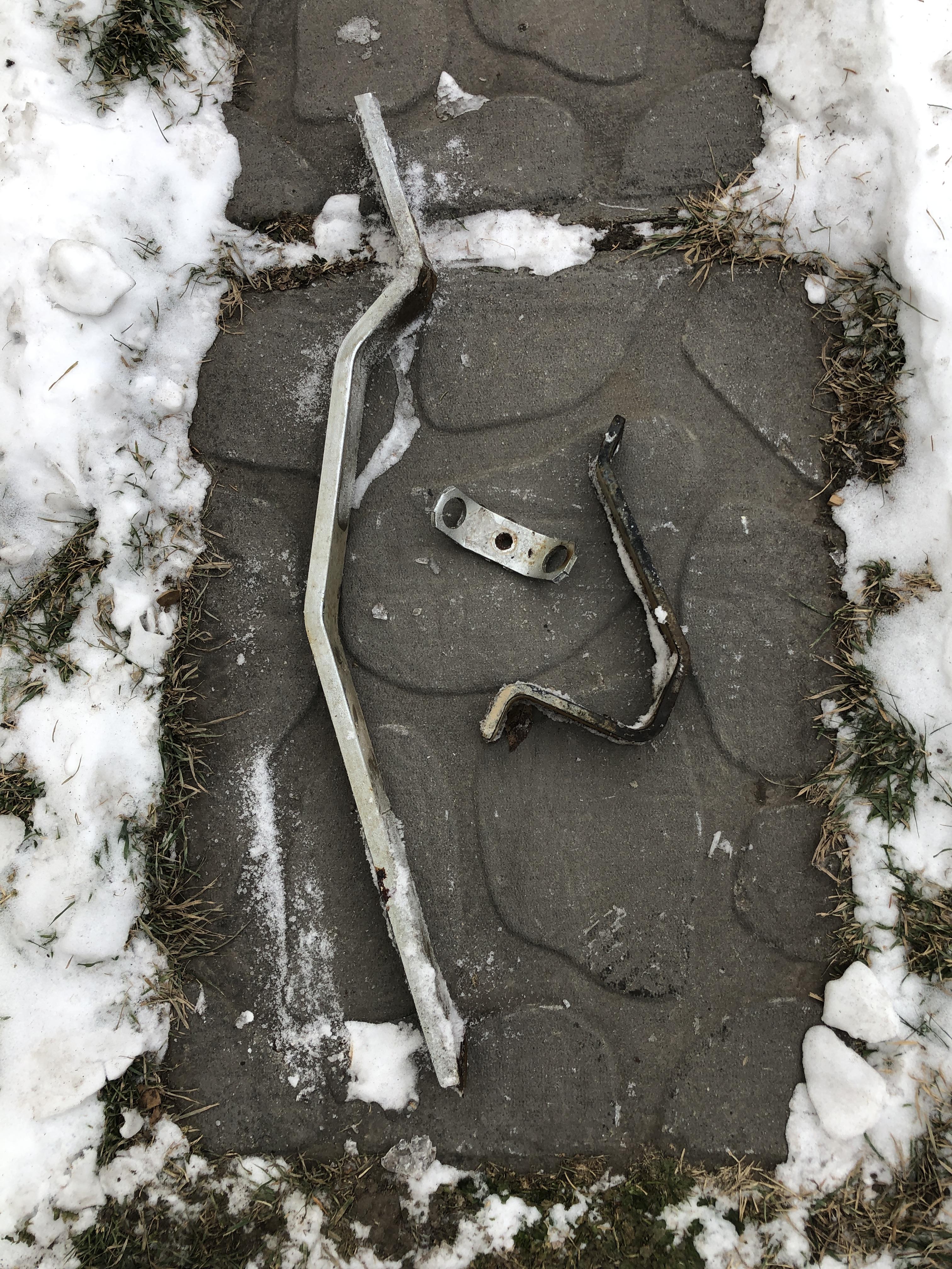

This is what I had on my 240Z.  Bolted to the bumper mounting locations.  Main bar is 2"x2" and 1/4" thick, weighs a lot.   Used to tow a 4x8 trailer rated for 1000 lbs.
I also used it as part of my rotisserie, that's what the parts welded to the top of the bar are.  With slight trimming the bumper fit over this, leaving just the hitch and the shorter 2" bar in the center visible.

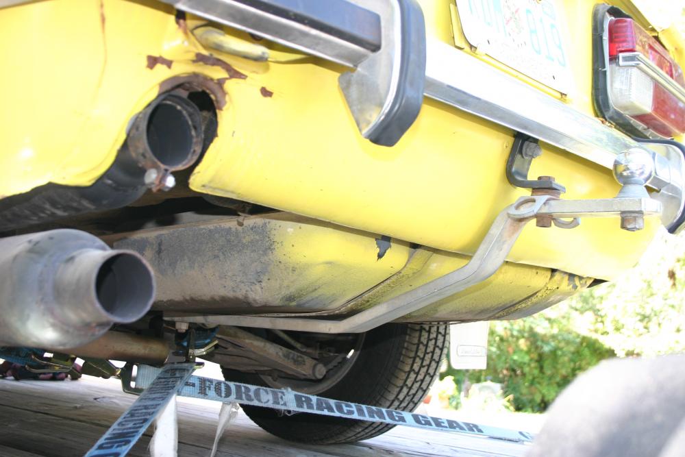

Yes it did!..  But the hitch had also 2 tubes of 1 1/4 " steel tubing going to the floor just in front of the fueltank and was bolted with 2 12mm bolts to the floor of the 240z.  These pieces of steel tubing were going under the tank, not over the tank. They had a sort of Y shape, the lower part beiing the hitch.
I would not use a hitch that only connects on the bumper bolts on the back..  you need also the two tubes going to the front..  The one on my pics did have that, only not visible. I looked for pics of the demontaged hitch.. none found sadly.

It went under the fuel tank then down the rear valance, and then it came out onto the horizontal tube to the bumper mounts? Pretty strong.
