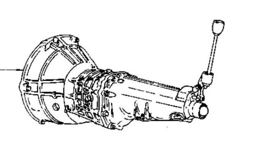

Not if it is a 70-71 4 speed.  Is there a picture?  The early 4 speeds had the shift lever that hangs off the back of the transmission.  Like the image below.
http://www.carpartsmanual.com/datsun/Z-1969-1978/power-train/transmission-case
http://www.carpartsmanual.com/datsun/Z-1969-1978/power-train/transmission-control
The shifter may interfere with you trans tunnel and console. It does when you go the other way and add a 5 speed to an early car.

I think that he wants to use the bellhousing only.  Sounded like it has a hole in the front case.

Note to Z with a Z, these cars combine the bellhousing with the front case in the later years.  So no separate bellhousing like a Chevy might have.

Correct! From what I can tell the bell housing in mine can be separated there appears to be like a spacer or something between it and the back part of the trans, I wouldn’t be messing with the half with the shifter on it, the dark lit photos are my trans, the shot of the whole one is the 4 speed. Thanks for the replies!
Wow never mind i misunderstood what you meant by, the bell housing being one unit, it doesn’t look like it’s going to fit, thanks for the help
