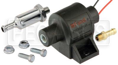

I like the idea of the K&N and it’s small foot print. What I’ve read says it’s quiet in operation too:
https://www.knfilters.co.uk/81-0401-fuel-pump
317b4189fdd6caaee18a91561fc3e241.jpg&key=dea722a1a25a83f86d32c261d00a467e19581ae0224984d6bfd7fdacf3e678f5

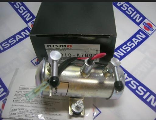

The NISMO was a nice option a few months ago when it was £80 on amazon but has now shot up to £180+ with import duties. So no longer as interesting.
f2f9d20d999a2cd61caeee6565629264.jpg&key=36165de034a9d12ba64cb33f83795c50e03aff9d8bbd7a885e50163a8d42796e

The Facet Silver top: relatively low pressure and time honoured use on Zs makes it an attractive option. I also like the Malpalsi fuel filter / regulator that would fit well where the current fuel filter resides - this eBay listing seems like a good combo - do you agree? Or shall I be going red top and pressure regulator? Wouldn’t it be a waste to have more pressure that I can’t realistically use with carbs?

I would hazard a guess that all 4 of those pumps were made in China, the only one I wouldn't buy is the K&N, it looks like a fish tank pump.

What amazes me about many of these aftermarket pumps is how often they undershoot their rated pressure. I put a fuel pressure gauge on a 240Z with the Facet labelled version of the K&N pump. The mechanical fuel pump was bypassed.spacer.pngspacer.png My gauge was reading about 2 PSI. (0-15 scale)
