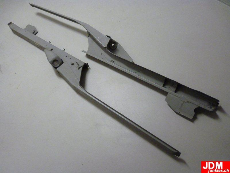

You may want to check out the lower rail repro that's now available c/o KlassicFab Vintage JDM...
https://kfvintagejdm.com/product-category/datsun/?swoof=1&paged=1&really_curr_tax=37-product_cat
If you haven't seen the KF Vintage catalog, It's well worth a look.  Prices are reasonable, payment is straightforward, and shipping was prompt (at least in my experience, anyway).  The pieces I received look really good.  I haven't done a trial-install yet, so I can't offer any first-person comments about the quality of fit.  All I can say is that I have yet to see any complaints surface from other customers.

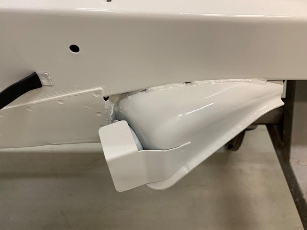

My connector pieces were built to match what was already there. Not perfect I’m sure, it is very close. The jack plates are my own design as far as I know. I don’t remember seeing them done before. But I’m sure someone else had the same idea. The TC bucket was removed by drilling out the spot welds and careful grinding. I just welded back through the spot welds to put it back on.
