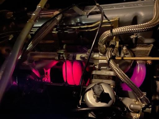

It can’t be your cam as it’s only affecting 3 cyls not all six. So IMHO it’s definitely fuelling / carb / intake related.
The only time my headers have been visibly glowing is when I’ve been heating the car up at night on choke at around 2-2.5k rpm with an AFR of around 12 (so read very rich). The camera does make it look 10x hotter than it was to the naked eye!!!

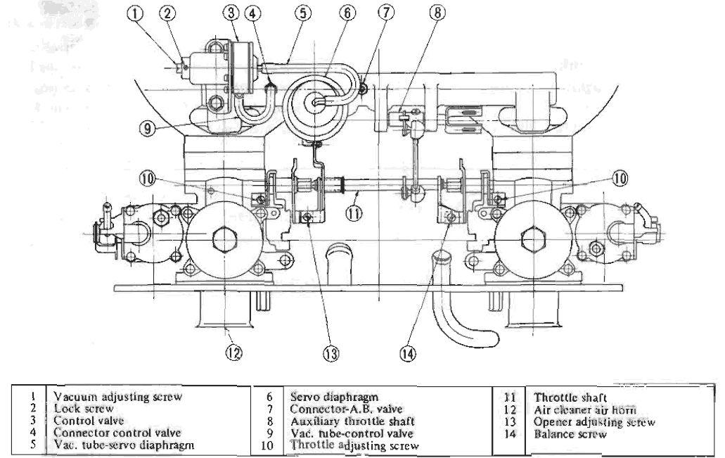

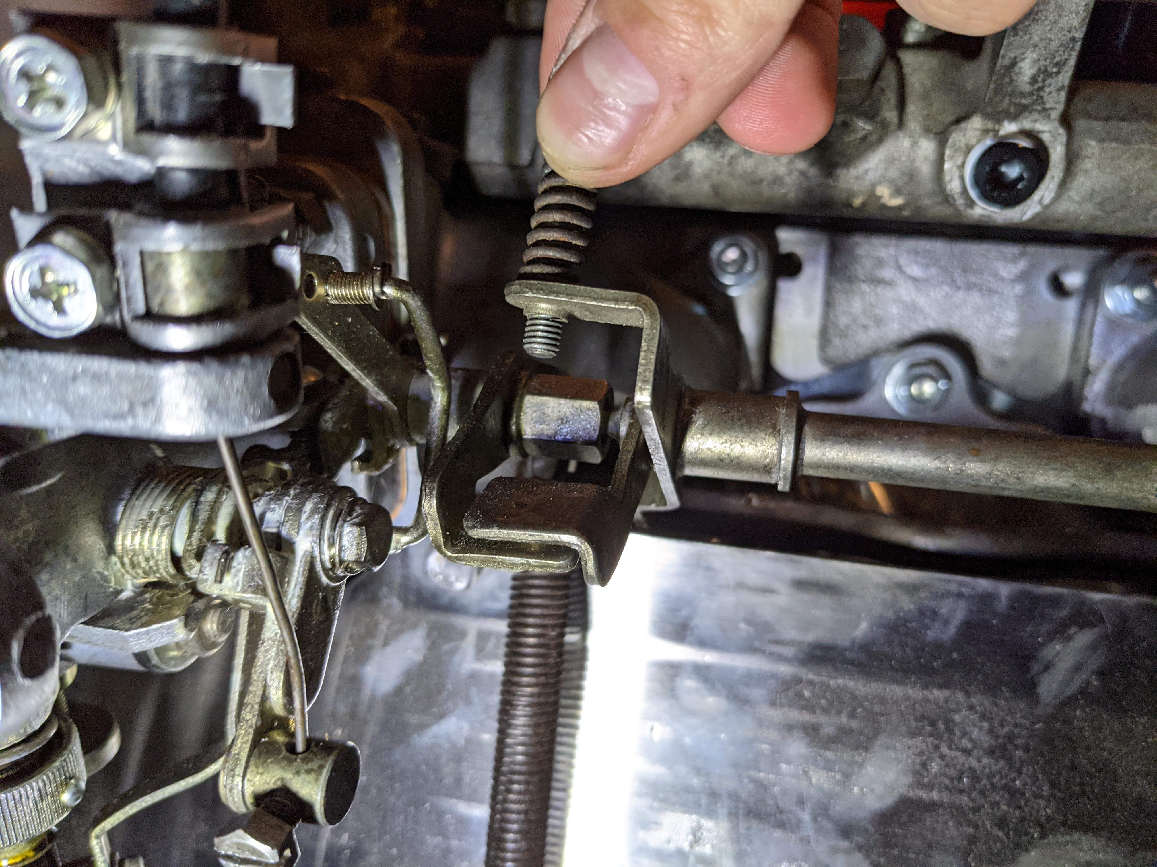

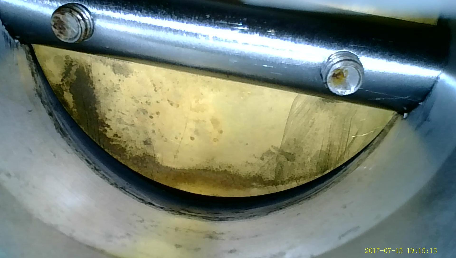

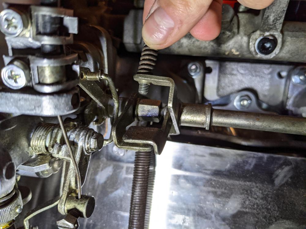

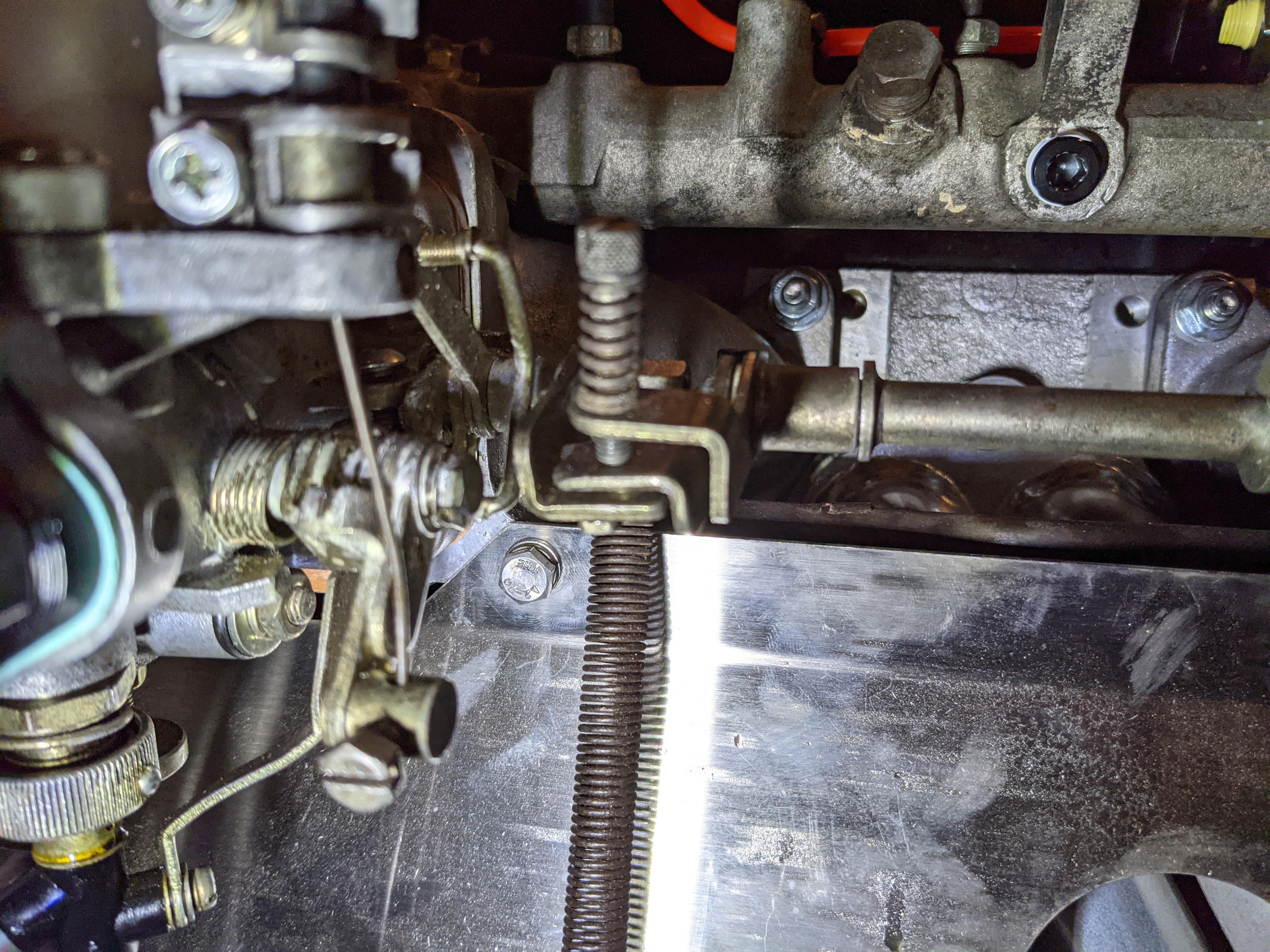

@Awk34 can you post pictures of the throttle shaft? Part number 13 and 14 in this diagram.

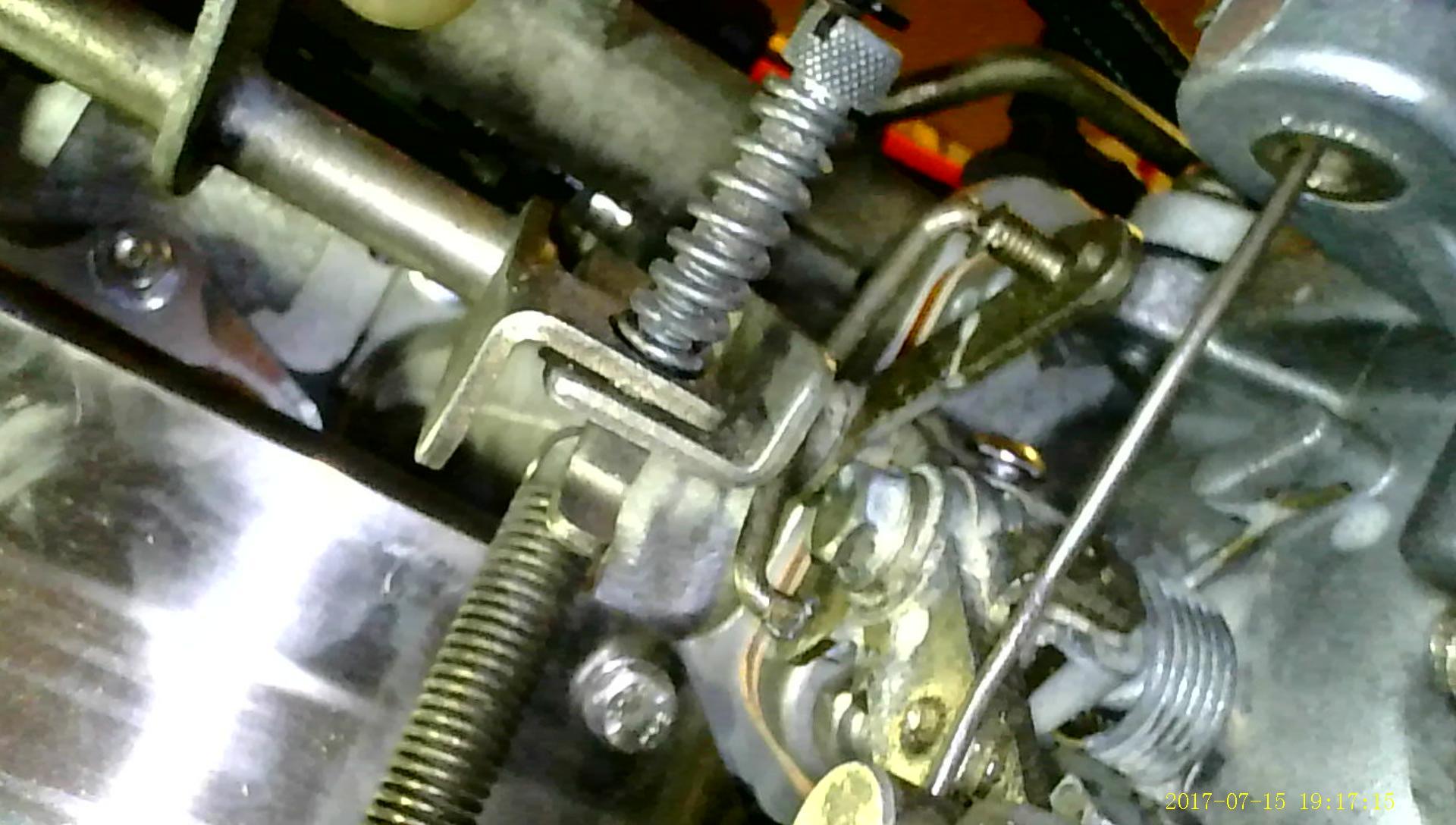

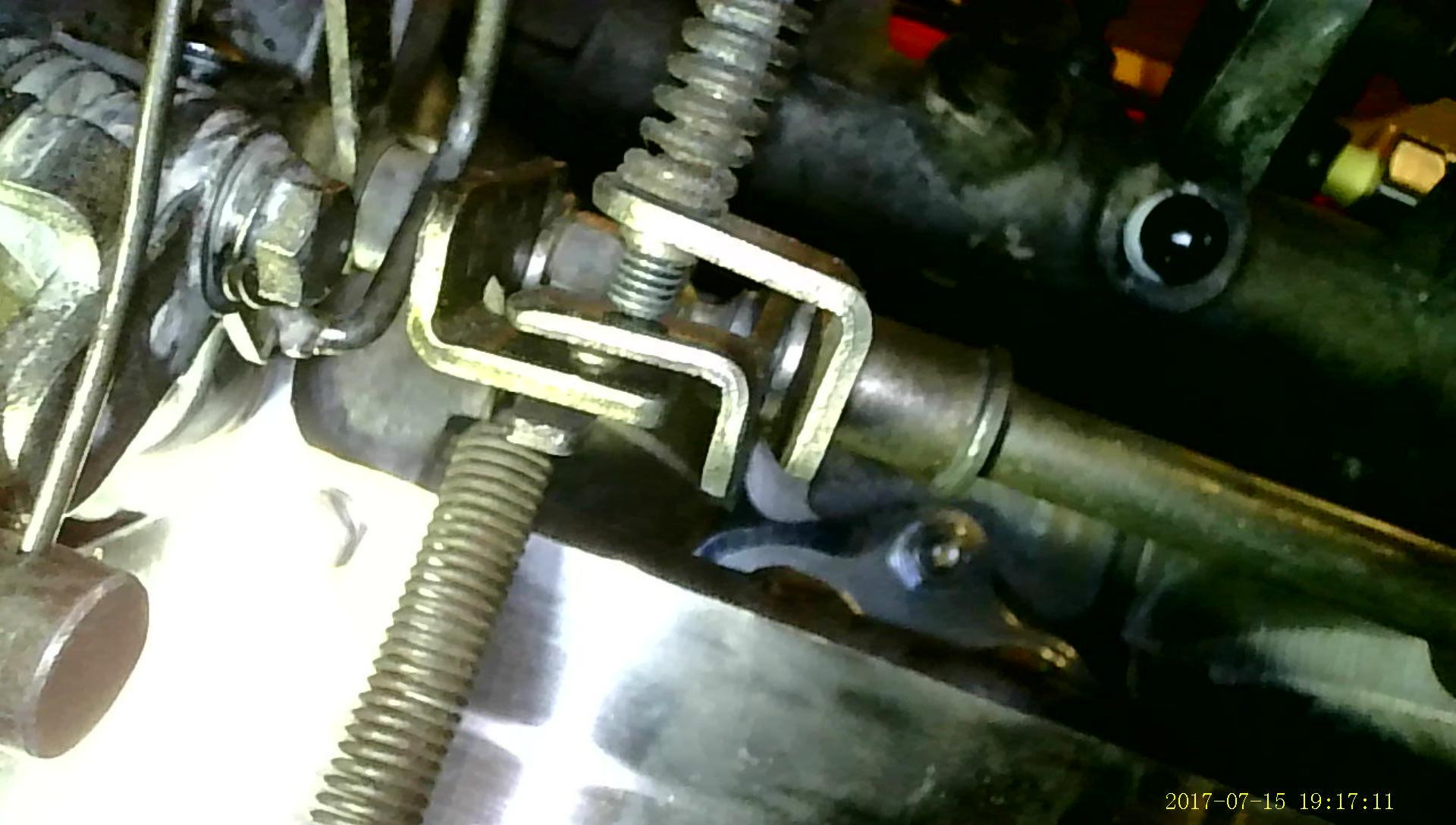

Here's some photos. As you can see I don't have any of the vacuum diaphragm / valve stuff on the balance tube, and all the barbs are blocked off with caps.
Here's a video to help:

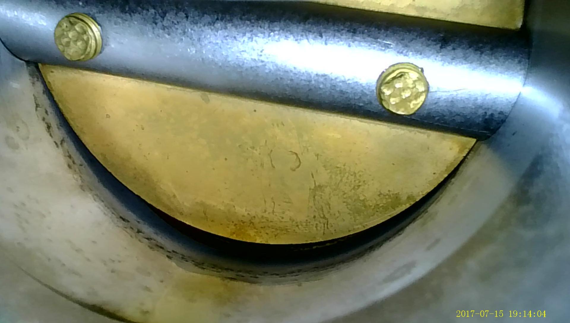

It shows the front carb when the engine "idles" at 4000 / 3000 RPM. The piston is definitely shooting up, so there has to be a vacuum leak somewhere between the cylinder and the carb, right? I've attached photos of the front (0007) & rear (0010) butterflies.
OK, MEGA dumb question - are you certain both carbs have the depression springs installed on top of their pistons?
Also that gap looks a little wide to me - could be just a trick of the camera. I will take a photo of mine later today for comparison. If memory serves, mine look almost completely shut.
A vac leak between carb and intake does not make the piston rise - in fact quite the opposite. Air flow THROUGH the carb does.
[mention=23570]siteunseen[/mention] - no tricks just the iPhone camera. The CCD being infrared sensitive picks up the hot manifold and makes it look way hotter. To the naked eye it was just a very slight dark red glow / barely visible but enough to make me want to take a photo!
