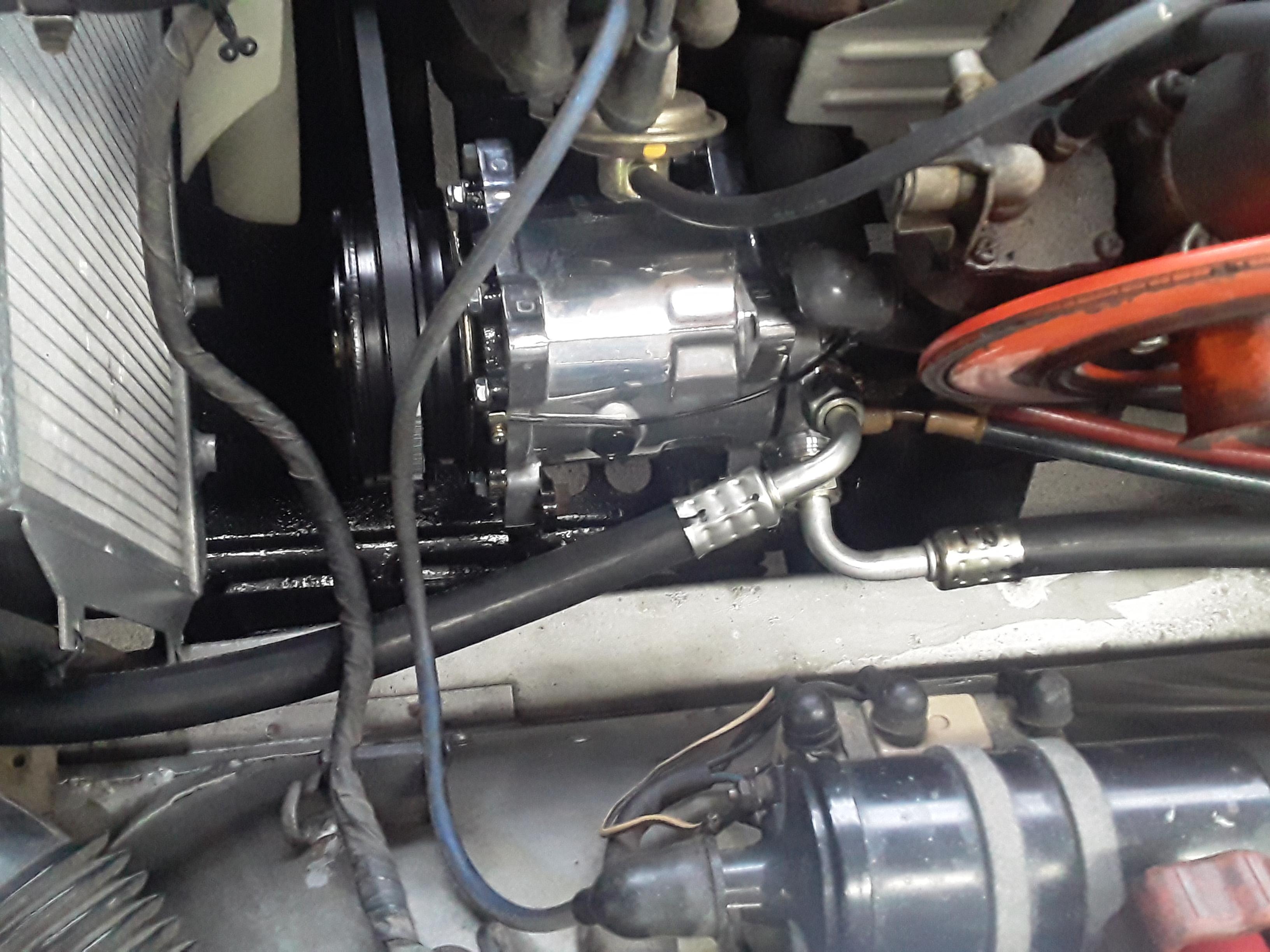

Fabricated Sanden compressor bracket for driver's side

If my memory serves me correctly I got the adjuster brackets from summit and welded the flat plate that mounts to the block on to the adjuster brackets. It was not that hard to do but time consuming. I made the bracket several years ago. It looks very close to yours Freez74
