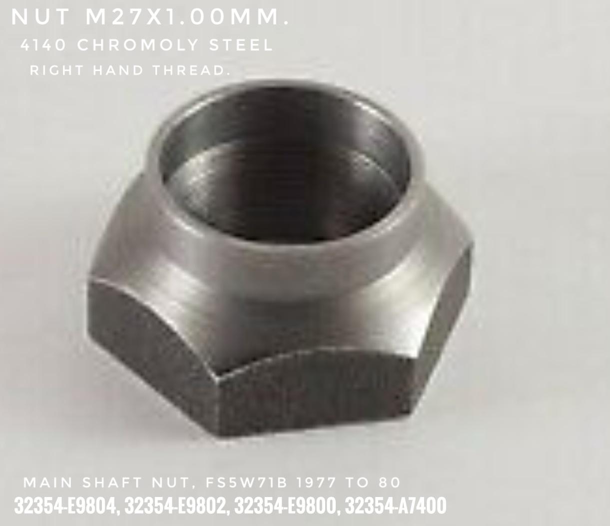

X Main Shaft Nut Datsun Nissan FS5W71B FS5C71B Overdrive & F5C71B Direct Drive 5-Speed 32354-A7400 32354-E9800 32354-E9802 32354-E9804
I think I'm gonna need to find one of these or get it made. Can someone provide a cross reference for what vehicles these would have been in. Do the 4 speeds have this nut? they don't do they?
That is the correct nut for your main shaft. It is an M27x1.00mm right hand thread nut. It fits all the 5 speeds FS5W71B from 1977 to 1980.
After 1980 the nut changed to left hand thread. I think that is when they also changed the 5th synchro. I think fibre synchro is right hand thread and brass synchro is left hand thread.
You don't need to replace it. There is a trick to recover an old nut and safely reuse it. The section that is hammered down to lock it in place doesn't have any thread inside. It doesn't add any strength to the nut, just a way to lock it in place.
Remove the nut using a small srewdriver or similar, you can drive it in between the nut and shaft to open it enough to remove it without too much damage. Side the nut over something like a socket in a bench vice and use a small hammer to peen around the burred section. You want to get it to point where it doesn't bind too much when you screw it on.
When you rebuild the transmission and fit the nut. Tighten the nut and check where the burred section lines up. It probably won't line up with the groove, but if it does then have the face contacting the gear hub washer machined 0.5mm. This will turn the nut 180 degrees to the groove. Every 0.25mm will move the nut 90 degrees around the shaft, 1mm being the pitch.
You can do this with the overdrive nut as well.

The 4speed nut is an M30x1.00mm. Right hand thread. Well it should be iirc.

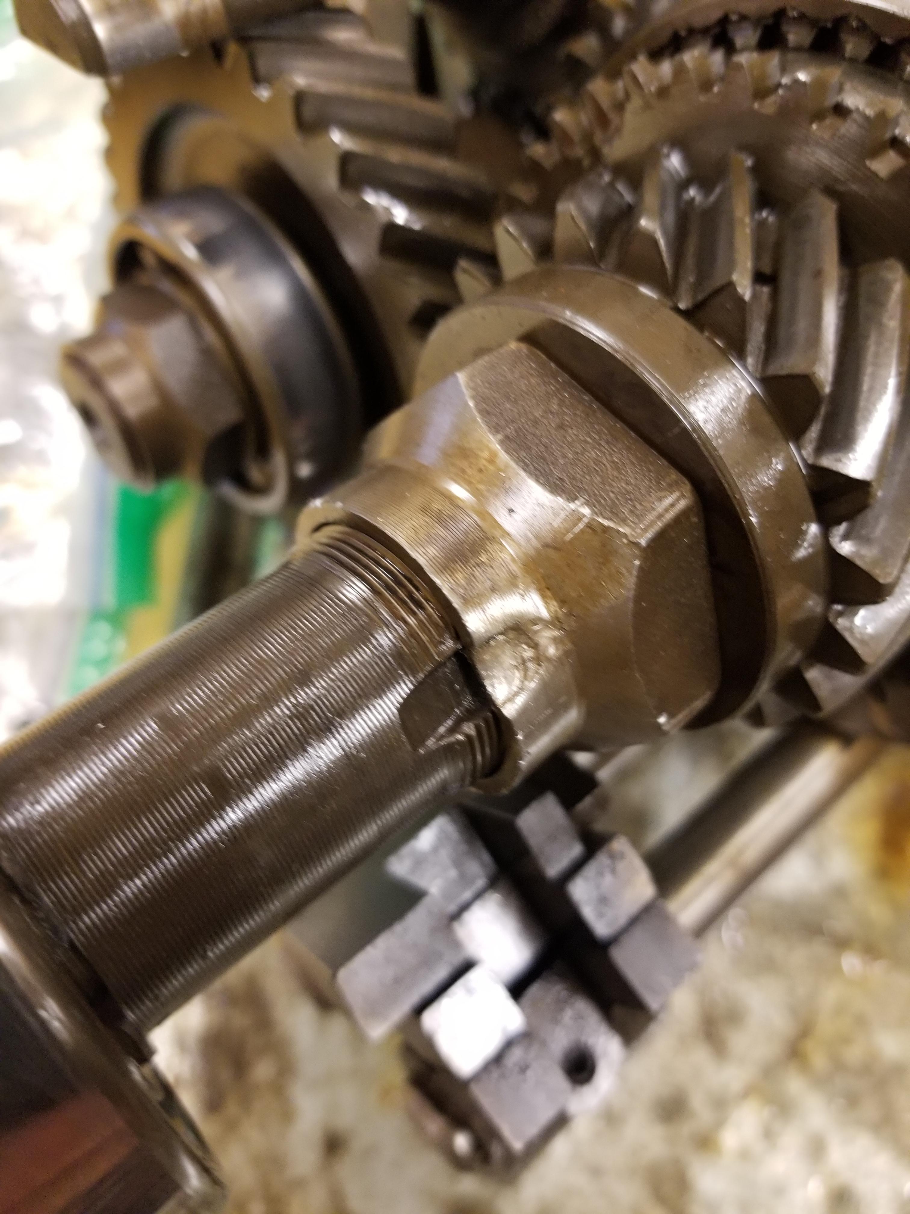

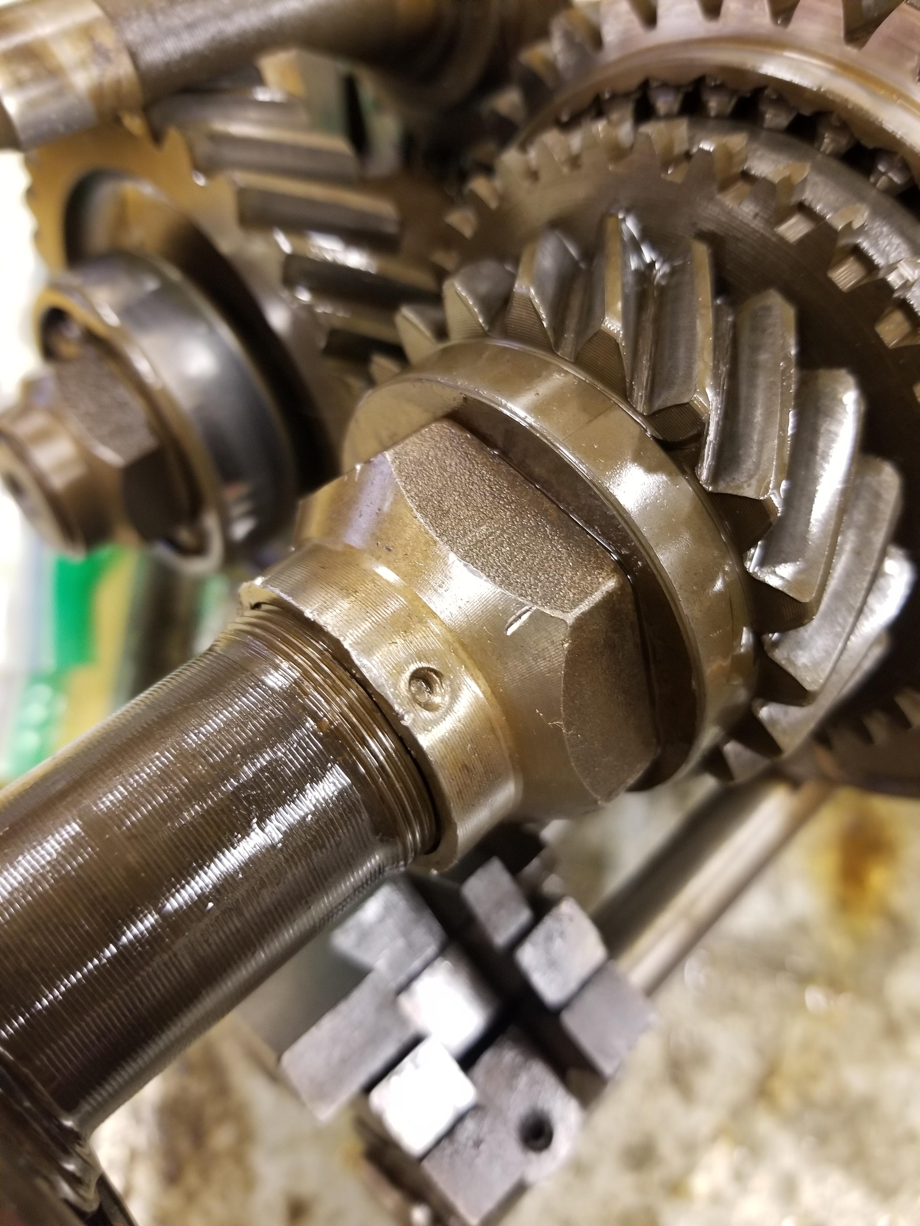

How would deal with the punched spot? I thought I would drill it out some to make it thin and then try to thread it off...
The punch spot is from a previous rebuild and not doing anything. The only spot you can lock the nut is where the groove is on the shaft.
Someone has already reused the nut.
I would rebuild the transmission and if the nut lines up where it is aready used, then take action the move it to new metal by facing the nut or adding and extra shim.
