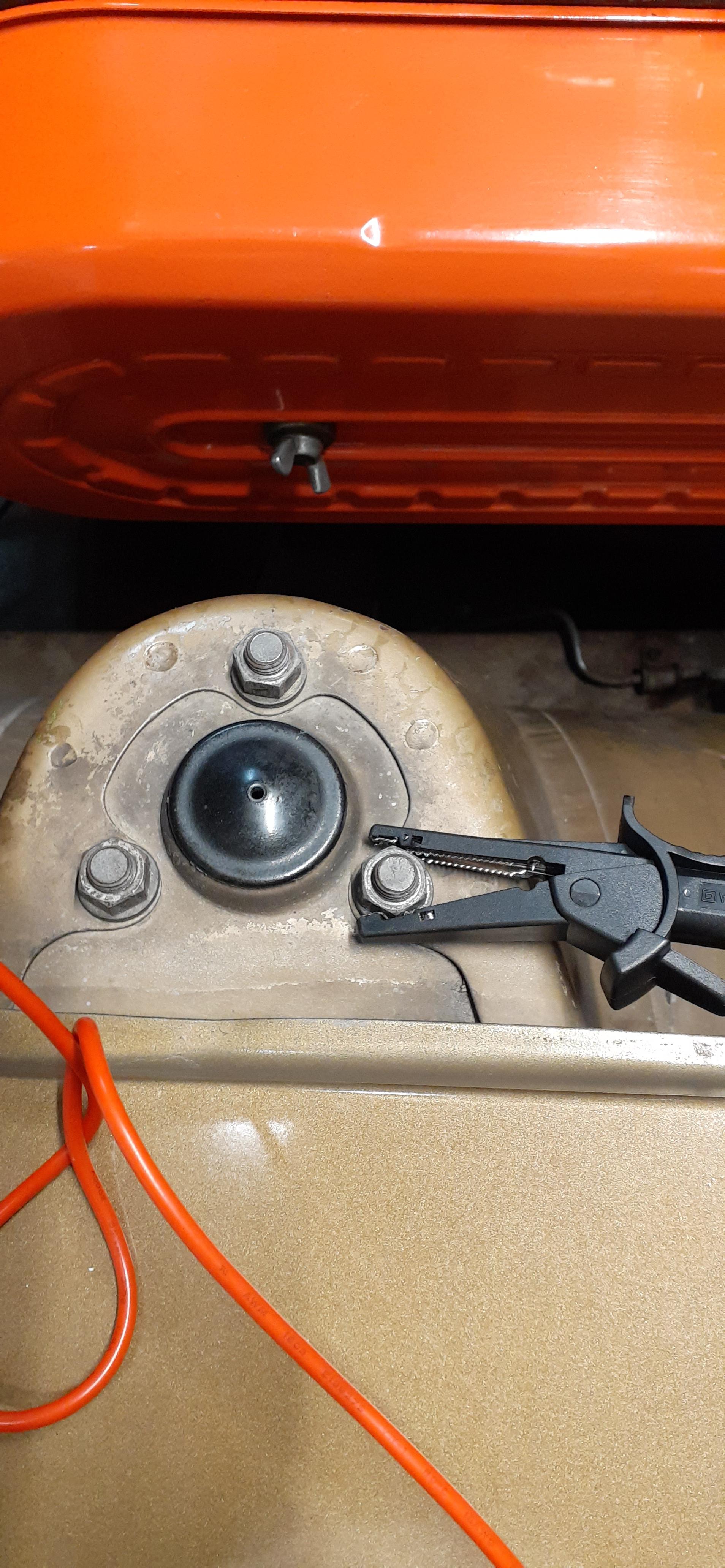

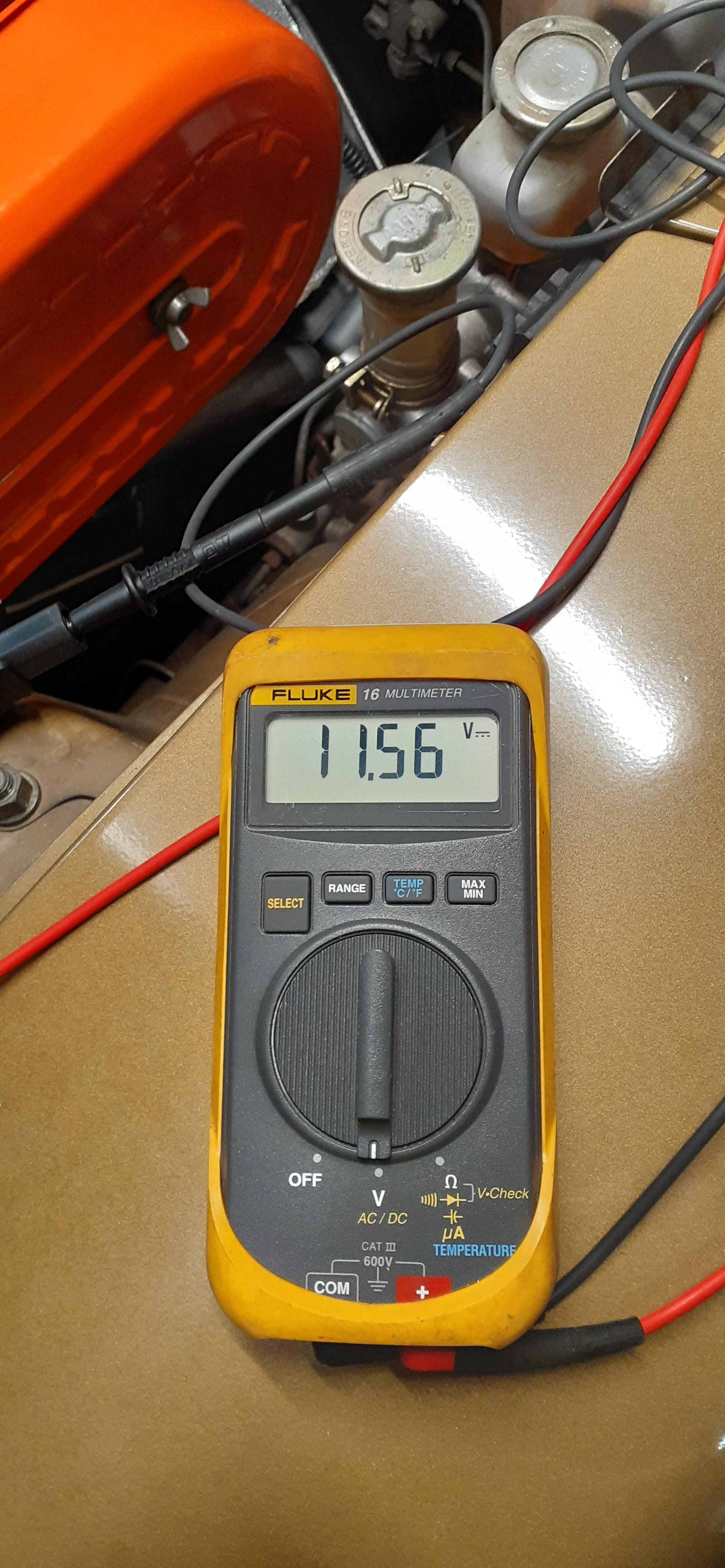

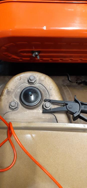

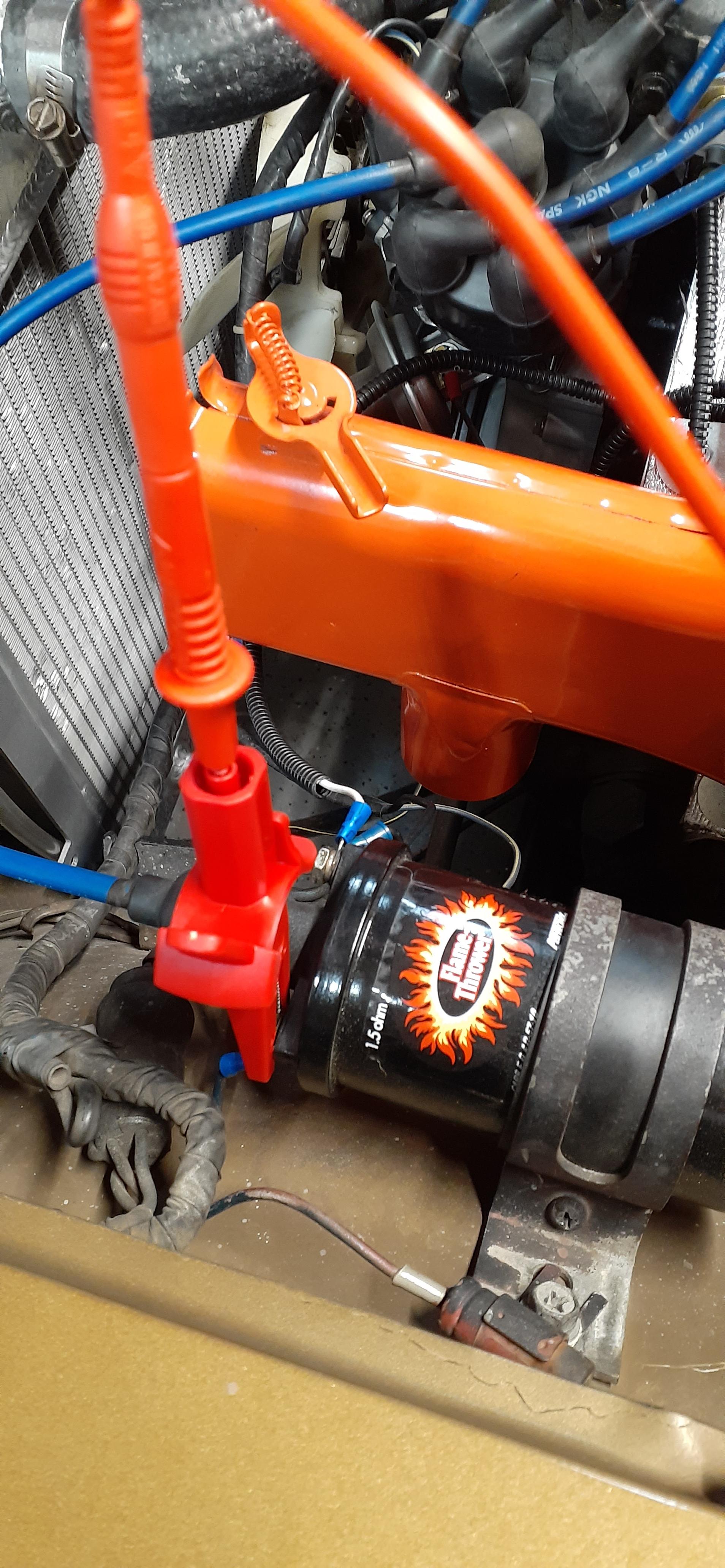

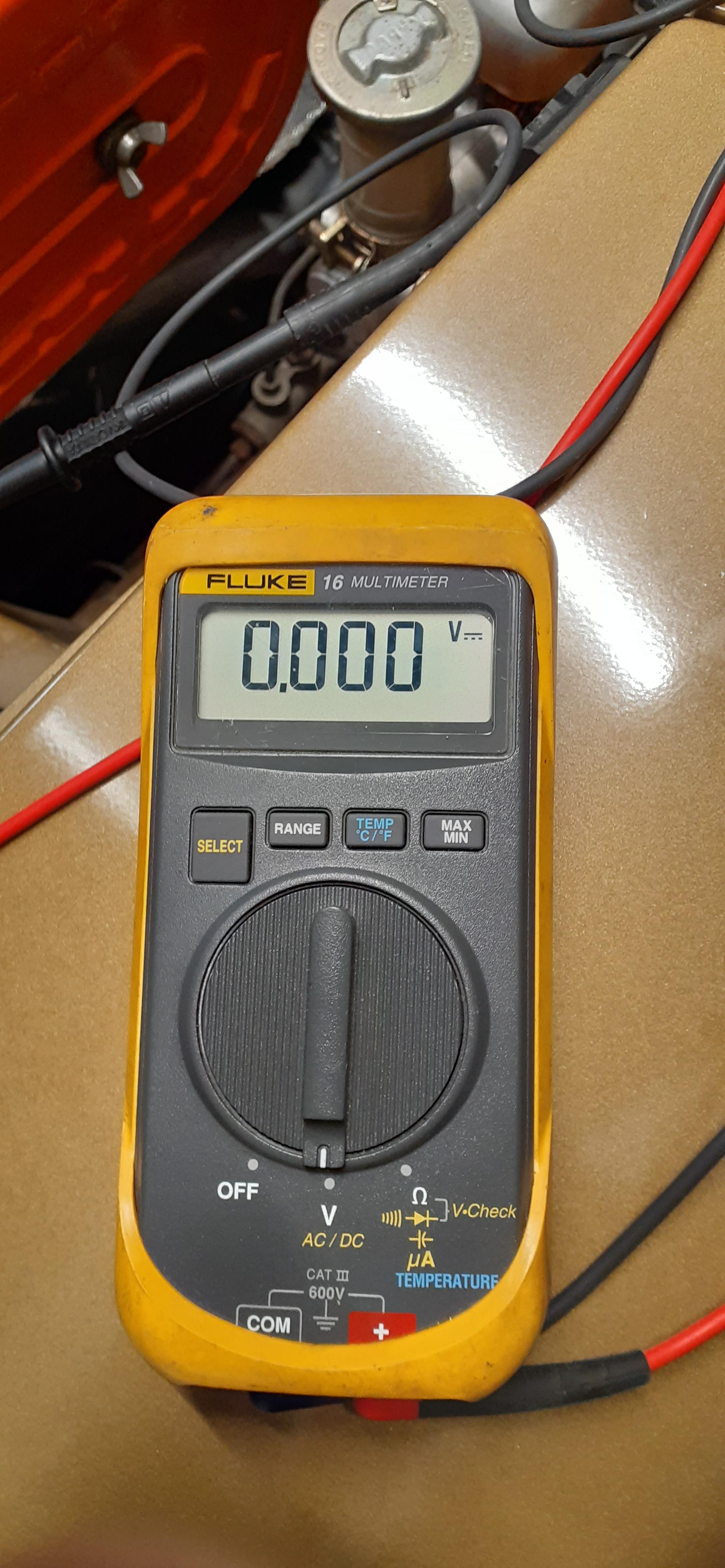

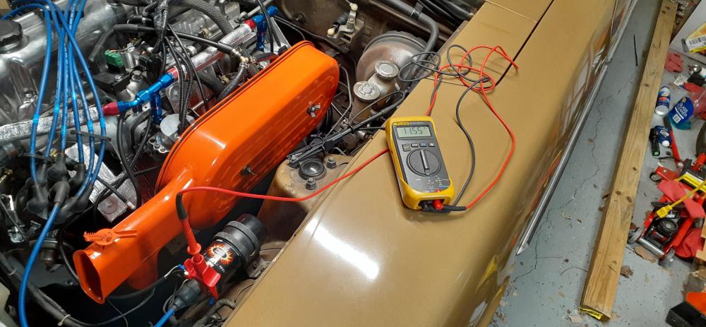

Um, you still aren't reporting good data. I asked for voltage, and you gave a resistance reading. This is how things should be configured:
1. Connect one lead to coil positive.
2. Connect the other lead to ground (strut tower is good for this).
It should look like this all together.
3. Have the meter on voltage.
4. Turn the key on. You should see around 9 volts. I have my ballast resistor jumpered out, so my reading is higher.
So, you have voltage at the coil, though if you are measuring it where I asked, the wiring is not going through the ballast resistor.
