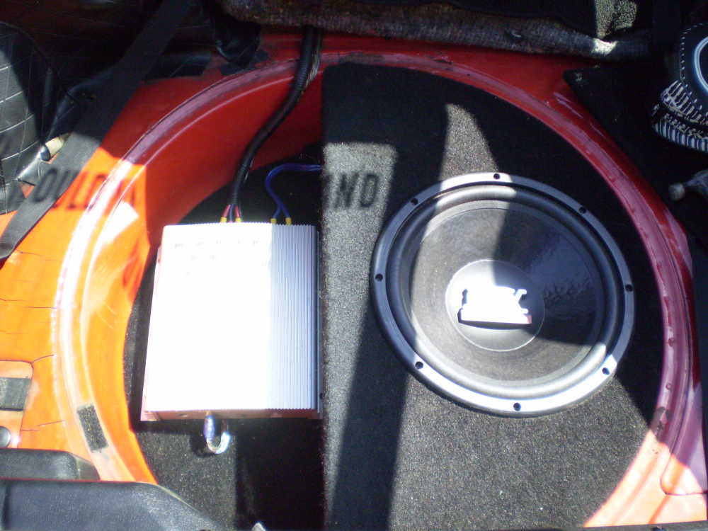

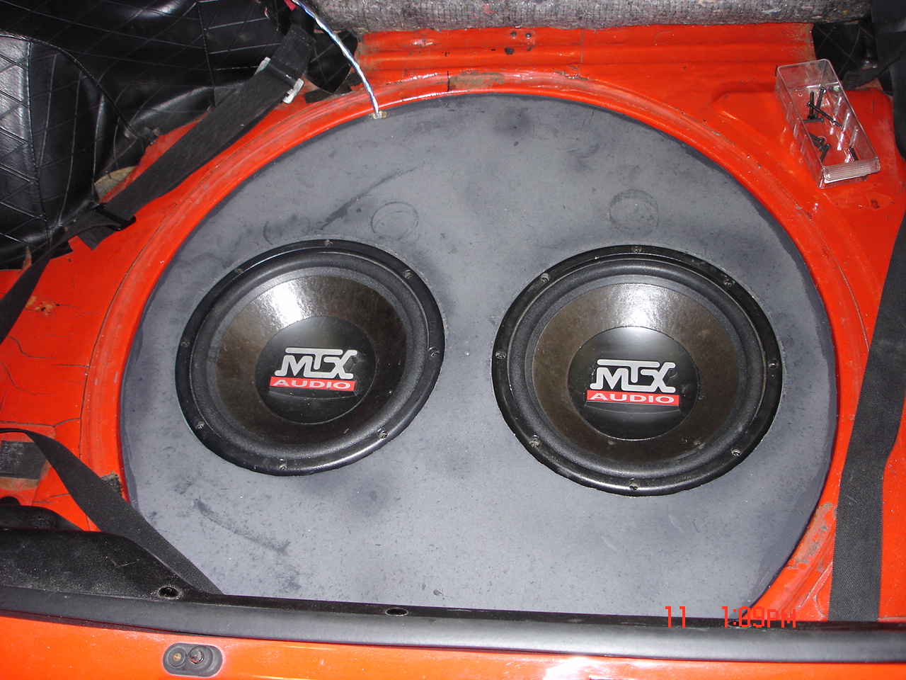

Well if you aren't going to store any spare at all, that recess makes a great storage area. Or you could put a big sub-woofer speaker into the wood over it.  LOL

Yeah, perfect. Just like that.
I'm pretty sure you could hit the brown note with that much woofer!!     :excl:
