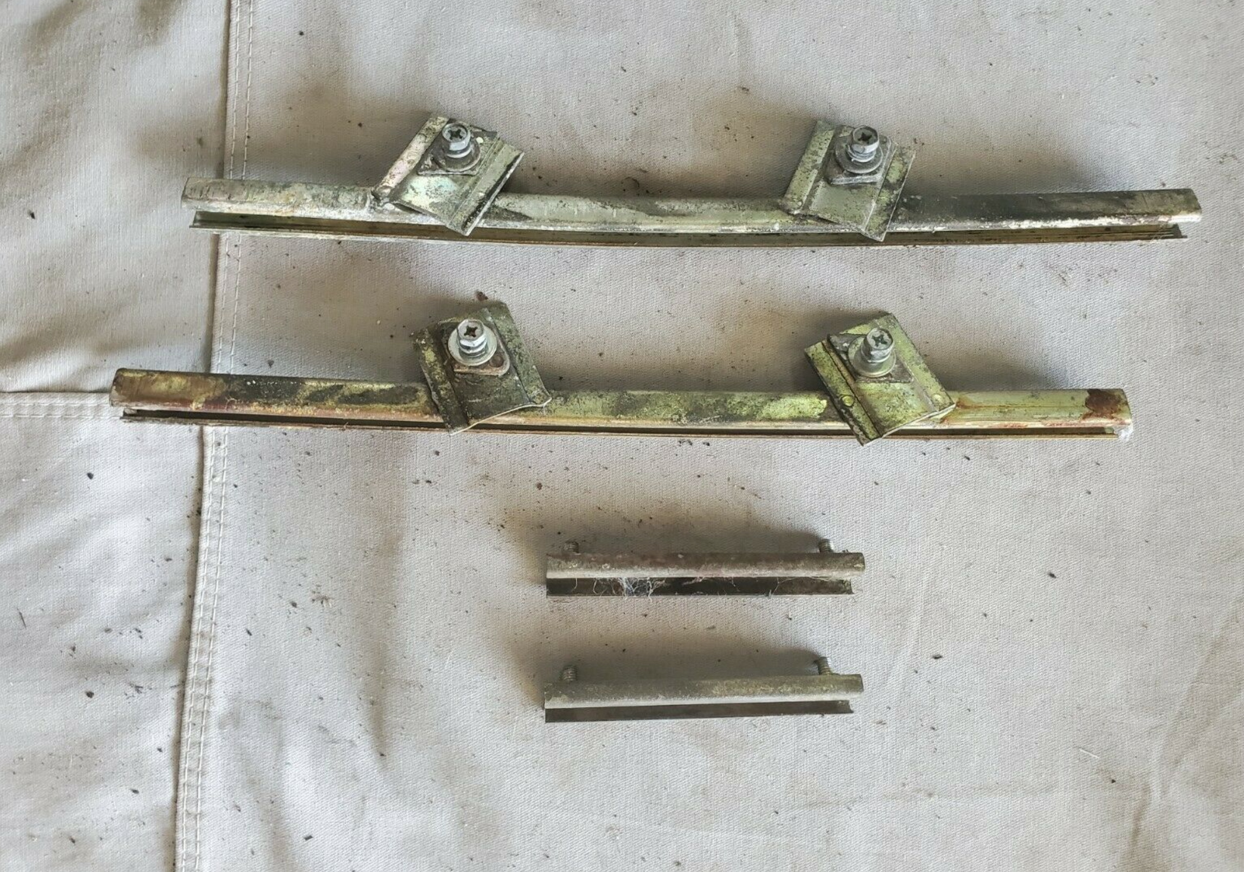

still having issues getting windows up properly. do the tracks below or the bottom of the chrome frame have any felt or rubber in them. none i have seen do just thought its worth asking.
https://www.classiczcars.com/forums/topic/64859-window-tracks/
The lower rear part of the frame has a insert, here's a link to MSA's repro part. The OE Nissan part is also still available at MSA.
https://www.thezstore.com/page/TZS/PROD/classic03a05/34-1052A
