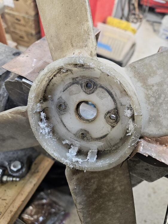

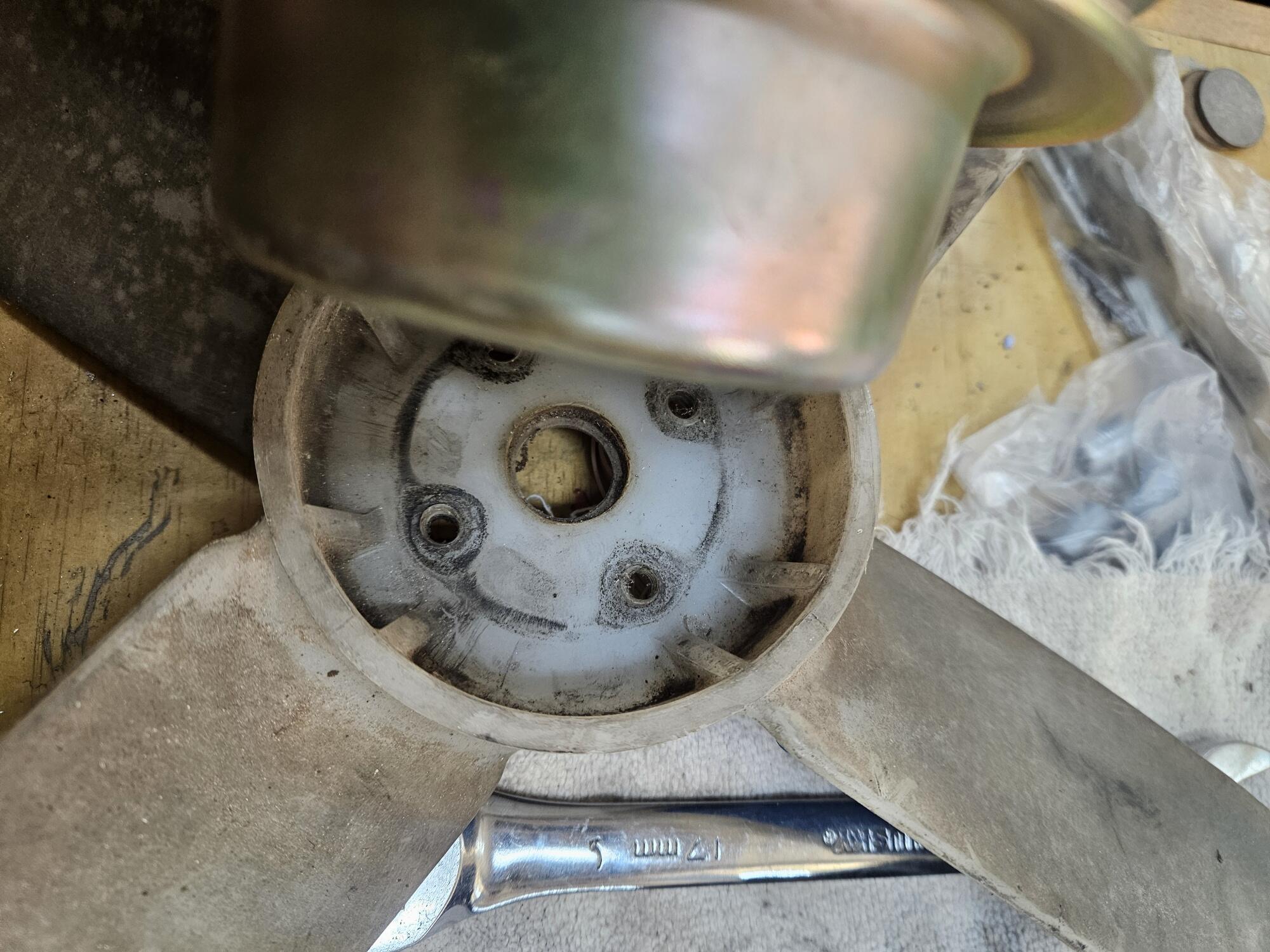

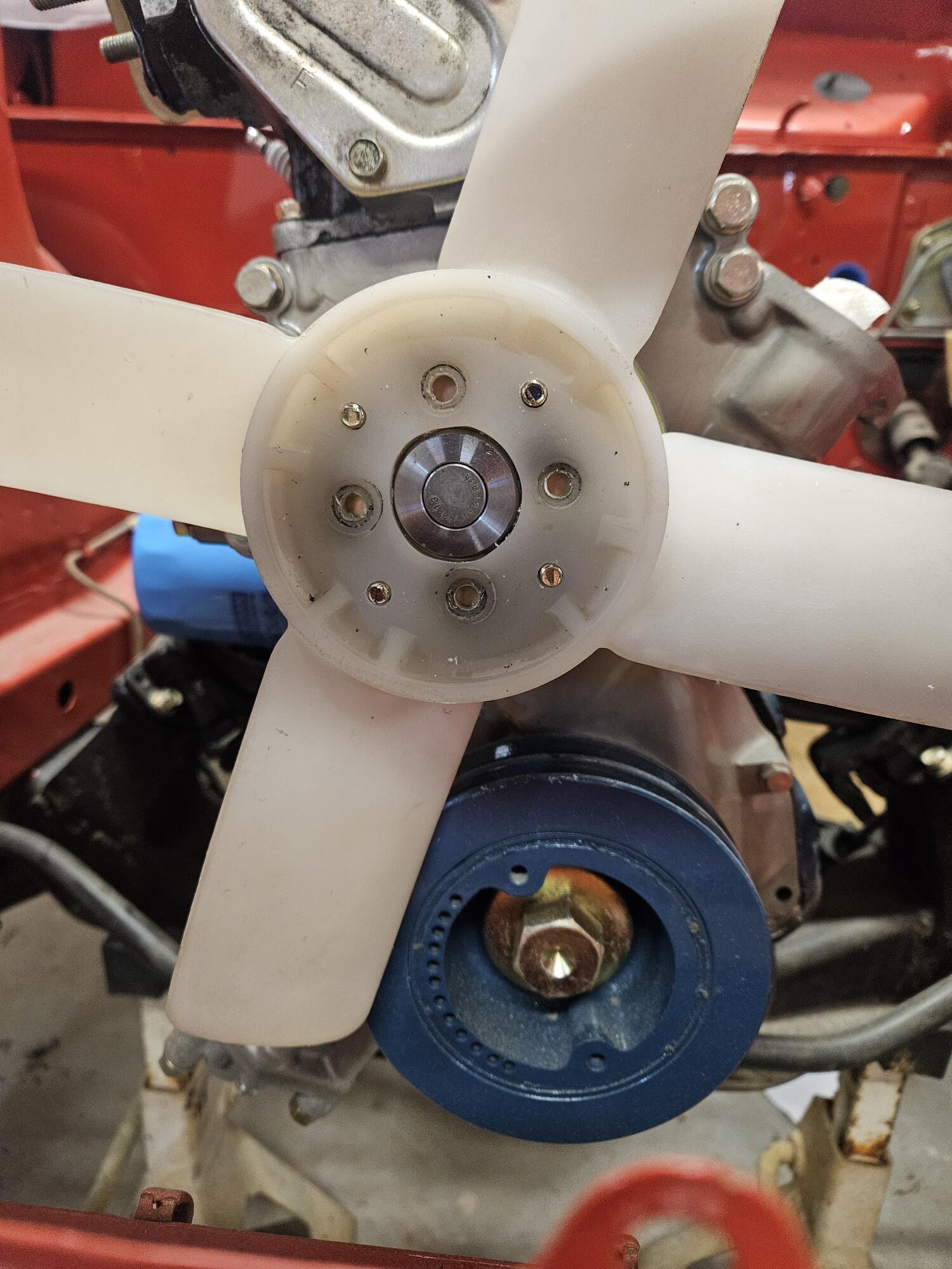

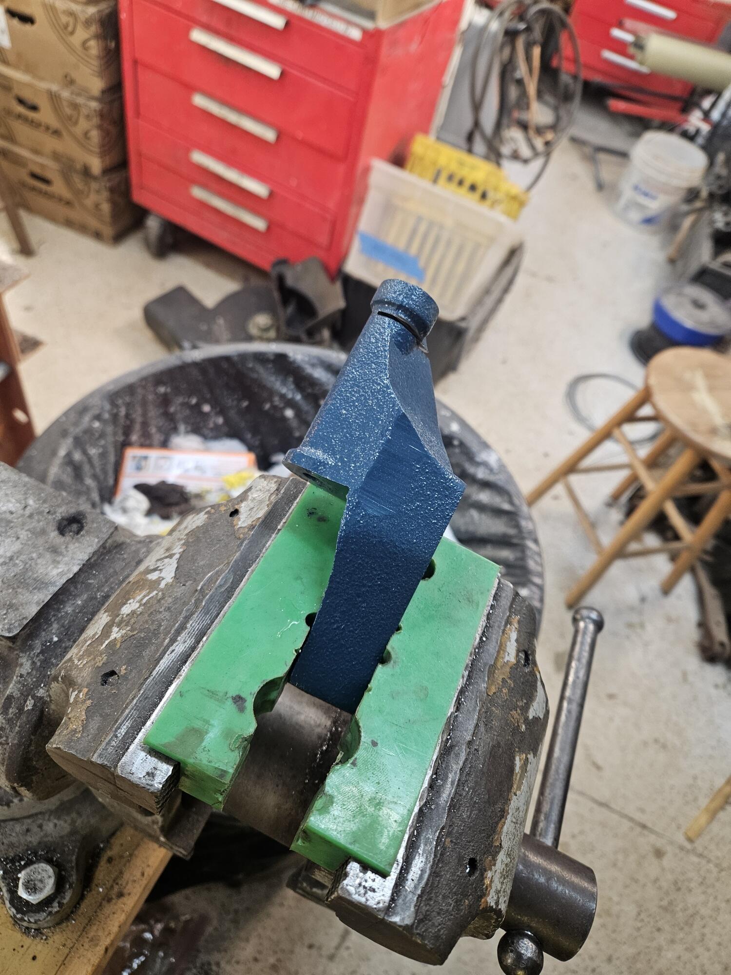

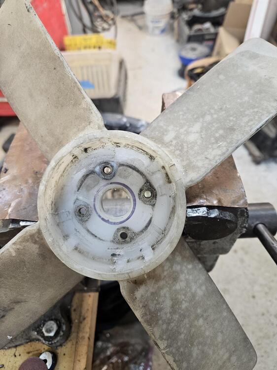

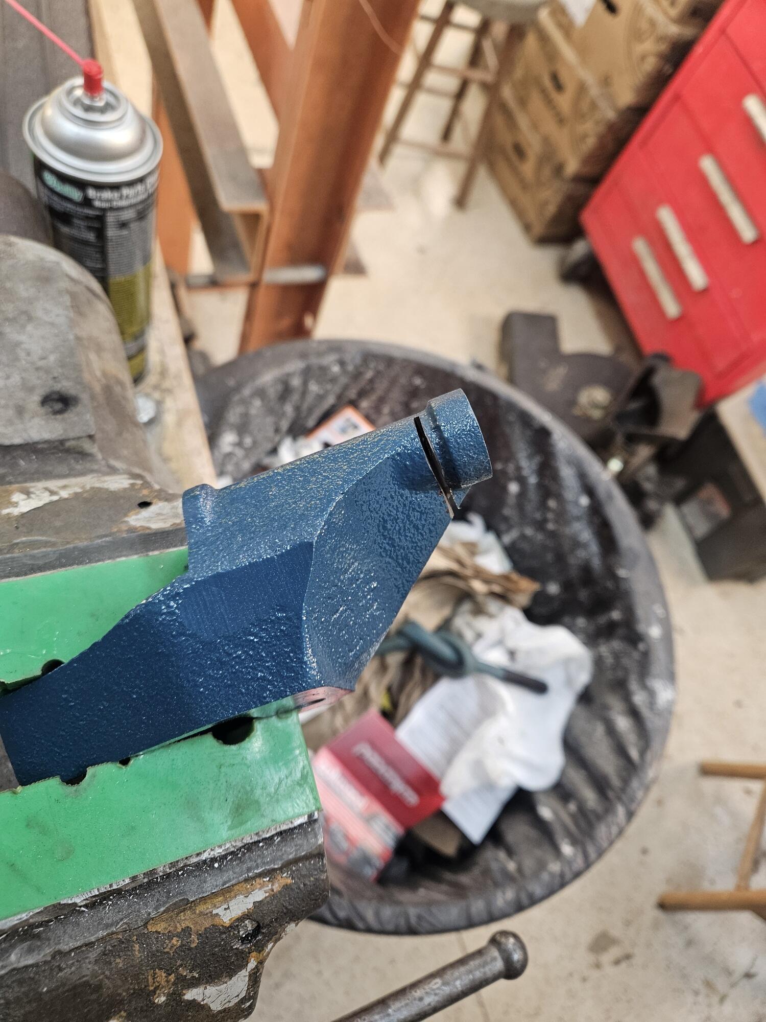

December 10, 2024Dec 10 Author comment_672208 So over Thanksgiving when Cody and I were working on the car. We were trying to get it ready for startup. Maybe Christmas, we'll see. We were working on getting the alternator on. Well when you change to the 240z water pump and damper that means the alternator doesn't line up anymore... 😞 So we got out the cut off wheels I cut this off the front and dressed it out and move d it to the rear with a washer. In the future we might make a more elegant solution, but for now it works Another problem we created with the 240z water pump is the 510 fan doesn't fit anymore and there's not enough room for a 240z setup. So these ribs inside the fan prevent it from fitting down against the pulley So more air tools I dressed them up nicely and lightly bead blasted it. I had to make the center hole larger by free-handing it. I also had to add 4 new bolts holes because the bolt pattern is different I had to order longer studs from BelMetric too... Two forward, one back... 😉 Link to comment https://www.classiczcars.com/forums/topic/64870-l20b-codys-goon/?&page=10#findComment-672208 Share on other sites More sharing options...
December 17, 2024Dec 17 Author comment_672291 I worked on the engine some more today. My baby orangutan put the oil filter on so tight I couldn't get it off without pliers and I didn't want to mark up the pretty blue filter. So I dropped the oil pump out and filled it about 75% full. It was totally dry even after all the attempts to prime. Rotated it a little to make sure the air was out. Put it back on and hooked it up to my truck again. It primed pretty quick after that. You could tell when it started to prime because it started turning faster and the pitch changed. I blacked out the cowl area Put the fan on after some longer 4mm studs came in from Belmetric I tried to bleed the clutch, but it wouldn't prime. I will check the push rod length next time I work on it Link to comment https://www.classiczcars.com/forums/topic/64870-l20b-codys-goon/?&page=10#findComment-672291 Share on other sites More sharing options...
