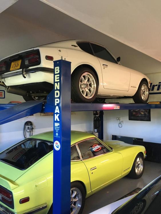

I have a BendPak 4-poster, and I love it!
https://www.bendpak.com/car-lifts/four-post-lifts/

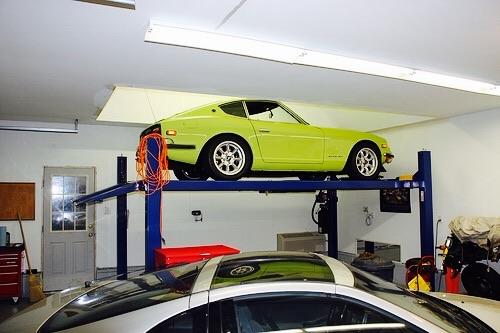

My shop ceiling is 12'-6" height, and I can put a full size van on top with room for the Z underneath if I choose.
I got the lift with the optional casters, so I can move the lift where I please. I have even moved it outside in the driveway to power wash the underside of my cars.
The lift takes 220 volts for the hydraulics and a source of compressed air for the safety mechanisms. I just use a long 220v extension cord and an air hose to allow for moving the lift around.
Get a couple of the fixed sliding jack trays and some short bottle jacks, and you are good to go.

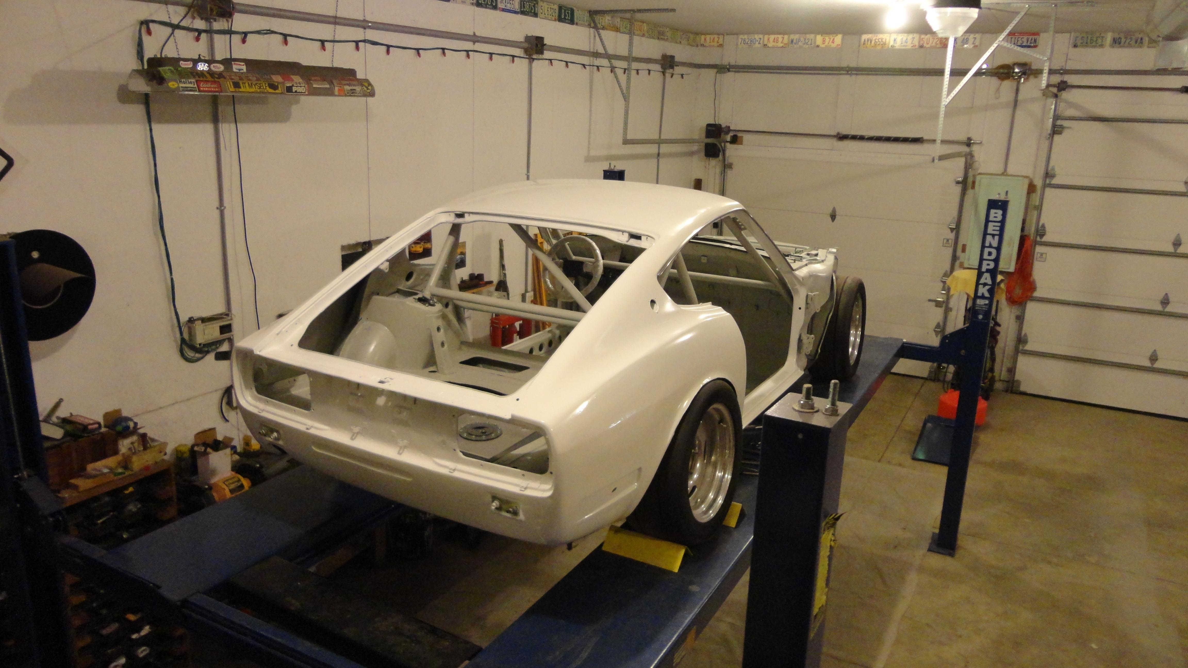

FYI, I have a Bendpak. Great lift but just to correct an above comment, they come with steel ramps. The aluminum ramps are an option that have a longer approach making it ideal for cars with low air dams. If you are planning on doing work on your car, consider getting the bridge jack if it's within your budget. I ended up building a stationary bridge and use bottle jacks to get the same effect. I have the wheel kit to move the lift but other than making it easy to move the lift to its final position after assembly, I've not had to use them. The plastic trays are a must to protect the car underneath. I have two of them and then cut a piece of plywood to get a third when I discovered a slow leak from the differential. I also had to turn my garage door to a high lift which means that a "normal" garage-door opener won't work.
One more comment, if you are planning on installing it yourself, get help. The components are heavy.

I ended up using an "A" frame made from 2x8's along with a chain hoist to aid in assembly. Two of us put the lift together in about 4 hours.
