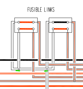

Check the wires at the starter.  The power supply wire to the car uses the starter lug as a connection point to the fusible links which lead to the ignition switch.  Check the fusible links also, it's common for them to have a poor connections at the terminal block.  Plus, since your battery was connected backward, some of them might be burnt.  Basically, you need to use your meter to follow the path and confirm continuity to the right areas.  It won't be easy, sounds like you had a mess when you started.
Battery > starter lug > fusible links > electrical components.
There's something not quite right with that wiring diagram I had here.  Deleted it.
1976 makes more sense and should be the same.  Shows lights, etc. fed from main link and battery.
Edited by Zed Head

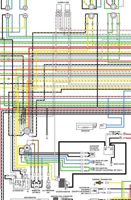

http://www.atlanticz.ca/zclub/techtips/wiringdiagrams/F77ZCAR-WIRING1.pdf
This is the wiring diagram I have been using for 1977 280z
I figured out what they did.  They just didn't use very big marks to show the connections. So tiny.
You'll find that 77 is kind of a transition year for several things, and for whatever reason many of the documents out there are incomplete or are actually 1976 documents.
Can you explain more about what you mean? I didn’t get it with the pic.
Just be careful with what you find on the internet.  Members have been collecting what they can and uploading it here but I've found mislabeled material around the internet.
As for 1977, 77 was the first year of the new door style.  And the raised deck in the back with the space saver tire.  There are also some odd cylinder heads out there too, apparently.  It's a change year.
My picture was just showing why I thought the diagram was wrong.  I just couldn't see the connections.  It should be fine.
