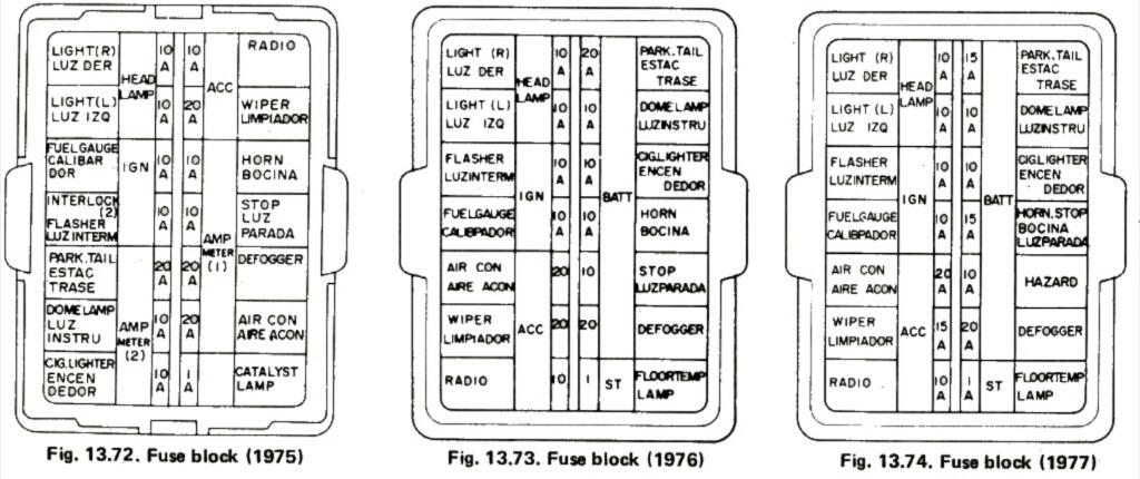

I can’t find a wiring diagram for the fuse box and the cover is missing does anyone have a picture for the 77 model I found the 88 model one but it seems a bit more updated than what the 77 had

The Body Electrical chapter shows where all of the relays are and has a drawing of the fuse box.  Also has many small wiring diagrams that are very detailed.  Spend some time there, and in Engine Electrical and in Engine Fuel.
