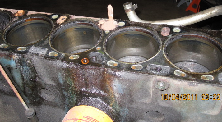

December 26, 20204 yr comment_613338 Here's my old 1976 N42 block. Nada. Link to comment https://www.classiczcars.com/forums/topic/64899-odd-bolt-holes-on-an-l28-block/#findComment-613338 Share on other sites More sharing options...

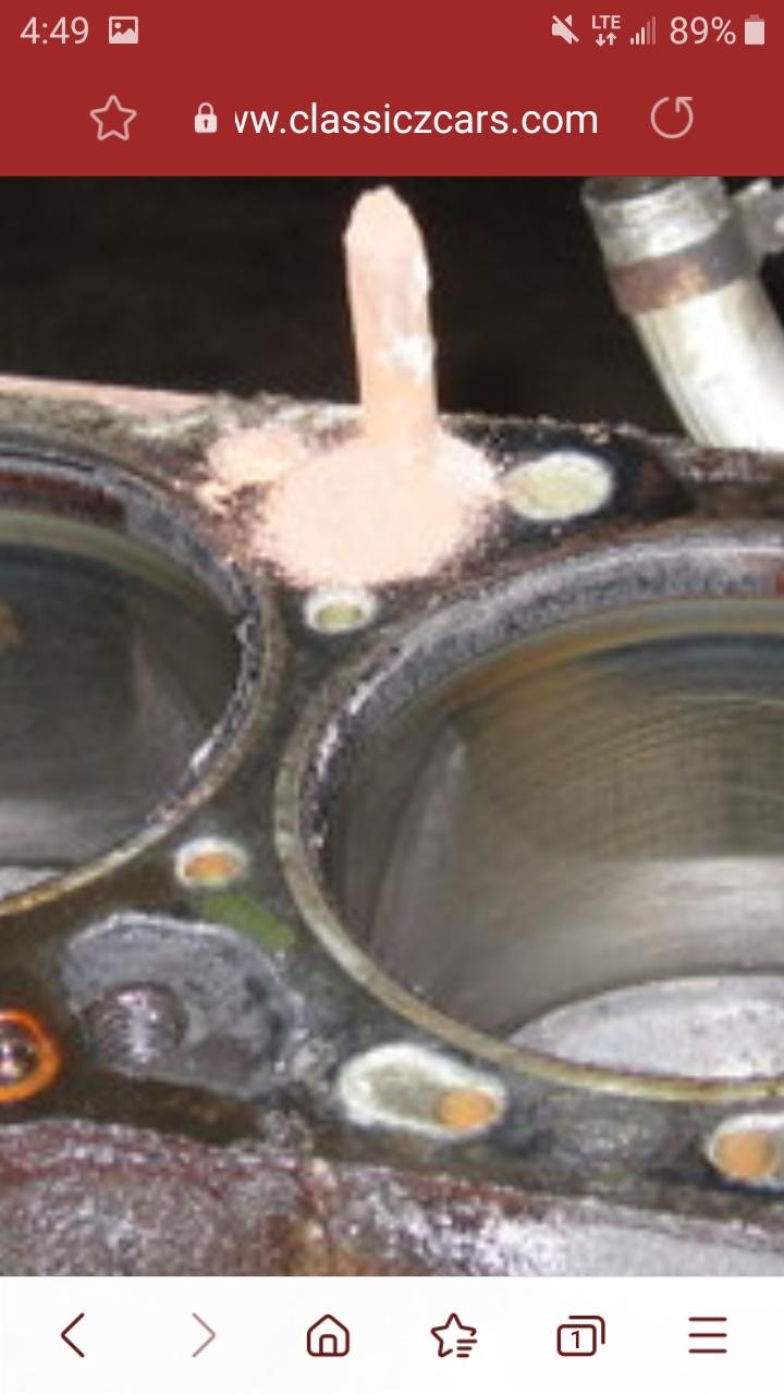

December 26, 20204 yr comment_613340 What the hell is this phallus looking thing on your block? Link to comment https://www.classiczcars.com/forums/topic/64899-odd-bolt-holes-on-an-l28-block/#findComment-613340 Share on other sites More sharing options...
December 27, 20204 yr comment_613346 59 minutes ago, siteunseen said: What the hell is this phallus looking thing on your block? Head bolt remnant. That pile of rust was in there also. Link to comment https://www.classiczcars.com/forums/topic/64899-odd-bolt-holes-on-an-l28-block/#findComment-613346 Share on other sites More sharing options...
