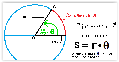

It alters both actually. they all interplay.  The diameter of the steering wheel determines the amount of circumferential movement of your hand required to turn the wheels a set amount.  Basically the ARC LENGTH S that is swept is the variable that changes with diameter.
pizza!
1. To turn the wheel a certain amount on a small wheel to take a corner is say 4" of circumference travel (S).
2. If you use a bigger wheel that is twice the diameter, you will have to turn 8" of circumference travel (S) to take the corner.
The larger diameter wheel has more mechanical advantage and a perception of finer control for the same steering input.
