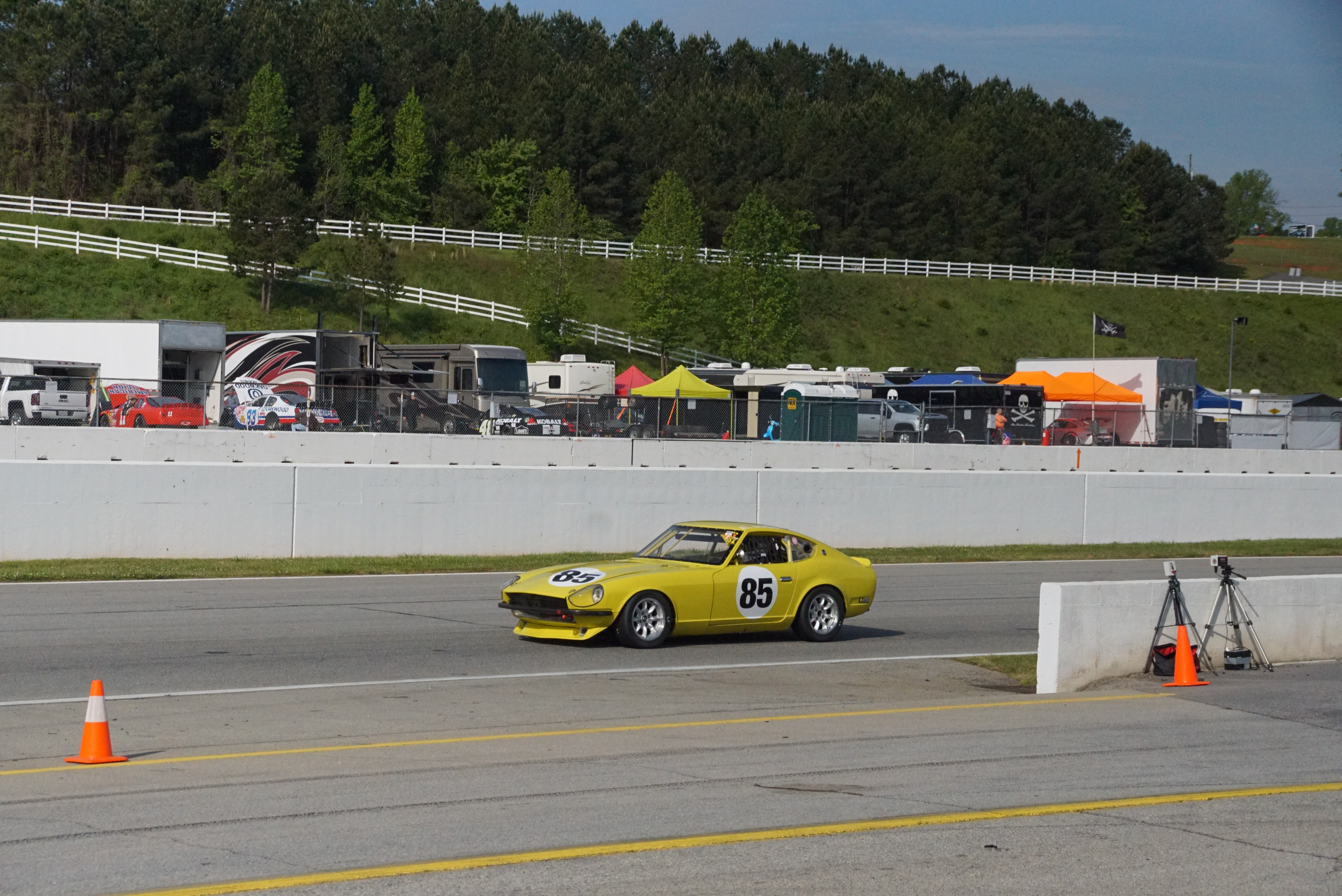

April 24, 20213 yr comment_620343 I finally got out to Road Atlanta for the first time since the 2019 Mitty. It was good to be back at the track. The Z car count was down, probably due to Covid and the 100% chance of rain on Saturday. Greg Ira kicked @$$ today in his sprint race over some fast competition in his Dan Parkinson tribute car. Woody Staub, a friend of @Diseazd, went from 11th to 6th in the same race in the #85 car. Edited April 24, 20213 yr by SteveJ Link to comment https://www.classiczcars.com/forums/topic/64911-2021-what-did-you-do-towith-your-z-today/?&page=2#findComment-620343 Share on other sites More sharing options...

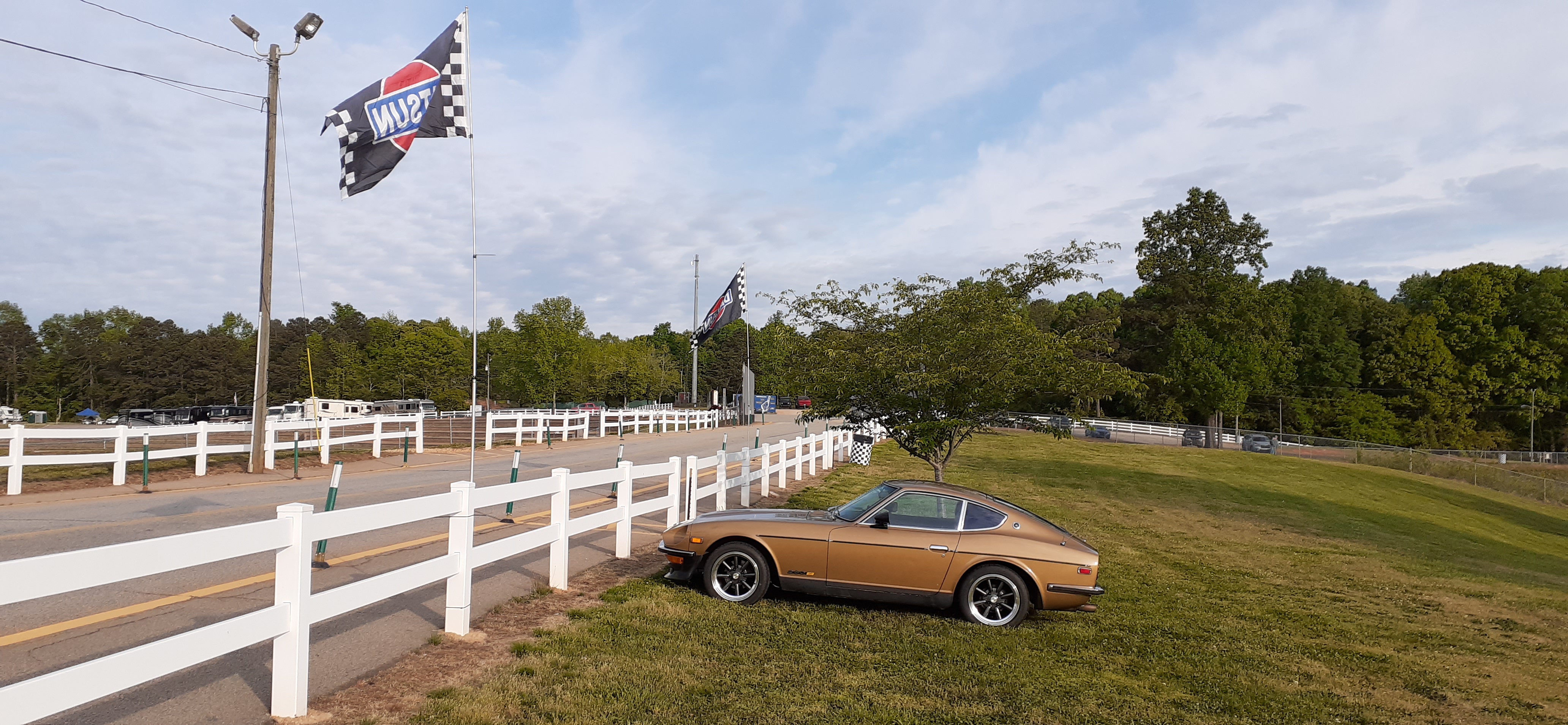

April 24, 20213 yr comment_620358 What a beatiful sight to see a lonely Z, it's not out to pasture, it's resting waiting... Link to comment https://www.classiczcars.com/forums/topic/64911-2021-what-did-you-do-towith-your-z-today/?&page=2#findComment-620358 Share on other sites More sharing options...
April 24, 20213 yr comment_620362 On 4/24/2021 at 2:25 AM, siteunseen said: What a beatiful sight to see a lonely Z, it's not out to pasture, it's resting waiting... It had a couple of friends join it. My Mitty buddies who aren't racing don't get to the track at 8AM like this nutcase does. Link to comment https://www.classiczcars.com/forums/topic/64911-2021-what-did-you-do-towith-your-z-today/?&page=2#findComment-620362 Share on other sites More sharing options...

April 26, 20213 yr comment_620520 Hi Steve.....Your Z gets better looking every year. Hope you and Randy are getting number 46 back in shape. BTW the number 22 car of Woody’s is probably the best looking Z race car I’ve ever seen....not so much his 85 car LOL. Link to comment https://www.classiczcars.com/forums/topic/64911-2021-what-did-you-do-towith-your-z-today/?&page=2#findComment-620520 Share on other sites More sharing options...
April 26, 20213 yr comment_620525 Thanks, Guy. The 46 is still out at the Z Car Garage, but the repaint is complete, and the hardware is getting installed. I think Randy is more focused on getting the LSR Z ready for Amelia. Yes, the 22 is prettier than the 85, but Guy seemed to be doing a pretty good job of moving around the track in the 85. I'm sure it didn't hurt for Guy to get some laps in Greg's car during the enduro race on Sunday. Link to comment https://www.classiczcars.com/forums/topic/64911-2021-what-did-you-do-towith-your-z-today/?&page=2#findComment-620525 Share on other sites More sharing options...

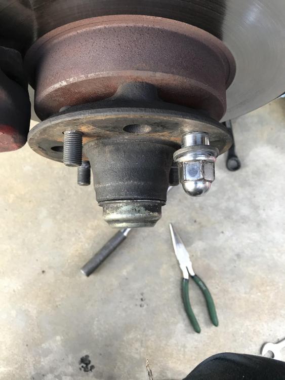

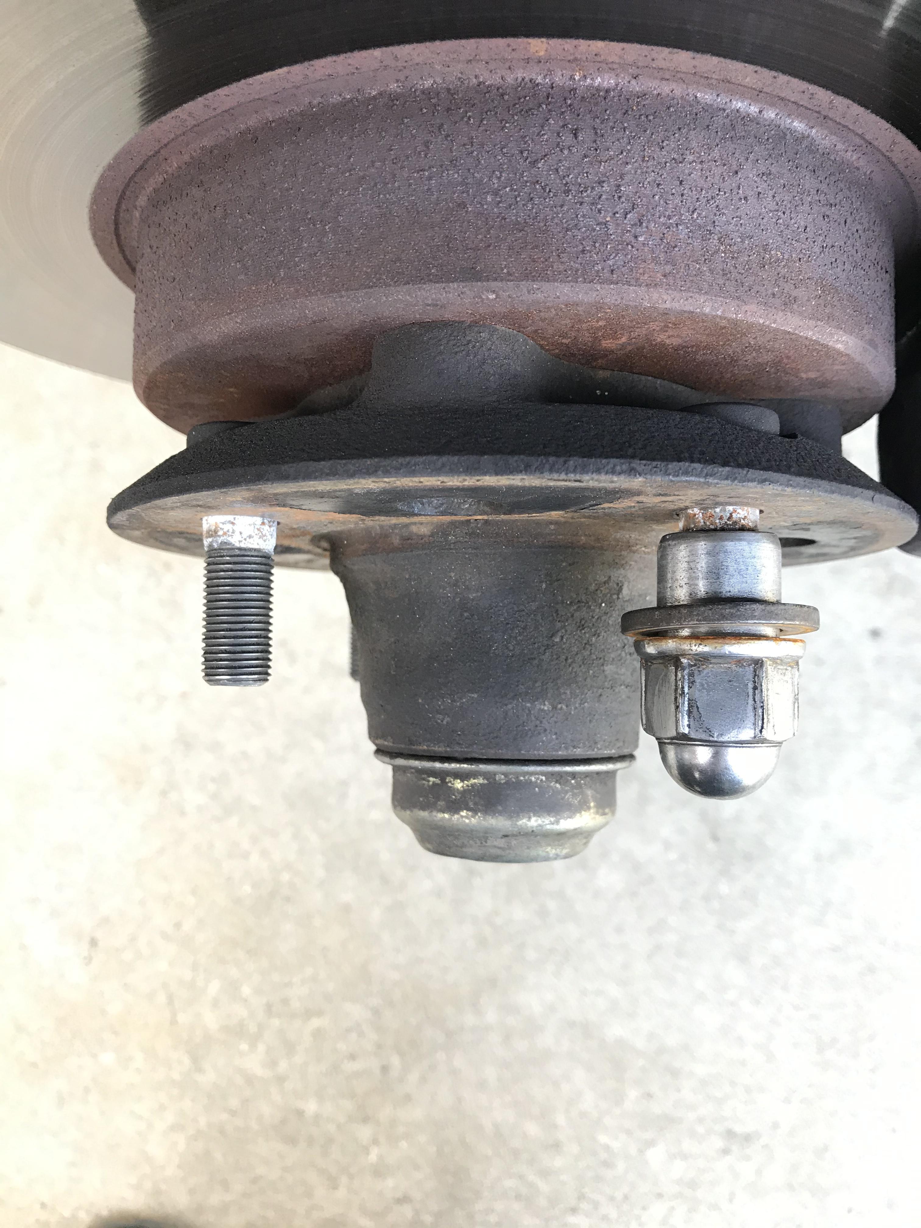

May 3, 20213 yr comment_620983 I think I found the stupid shimmy in the steering wheel after a LONG time looking for the source. Stupid driver side nuts never sat flush. I think there was always play between the wheel and hub. I even had replacement studs in my parts bin. jeeeeeeeeeez Link to comment https://www.classiczcars.com/forums/topic/64911-2021-what-did-you-do-towith-your-z-today/?&page=2#findComment-620983 Share on other sites More sharing options...
May 3, 20213 yr comment_620985 Well that all depends on the thickness of the mounting flange on the wheel itself as compared to the length of the lug nut shank. You never want the lug nuts to bottom out against the rotor. All that matters is that there is still some thread left once the lug nut bottoms out against the wheel and pinches the wheel against the rotor. Link to comment https://www.classiczcars.com/forums/topic/64911-2021-what-did-you-do-towith-your-z-today/?&page=2#findComment-620985 Share on other sites More sharing options...
