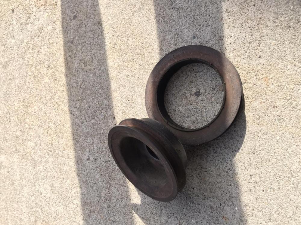

I’ll double check for the lash pad, I also found that the harmonic balancer separated. Can these be rebuilt? Or better off getting a new one? I like having 2 pulley options, finally got the heater sorted, wanted the AC fixed next ha.
Looks like you found the clicking noise. And yes, dampers can be rebuilt. There is a guy in Snohomish, WA that used to be the local Z guy. He has a bunch of L series dampers that he had rebuilt, and he sells them with exchange of your old damper.
