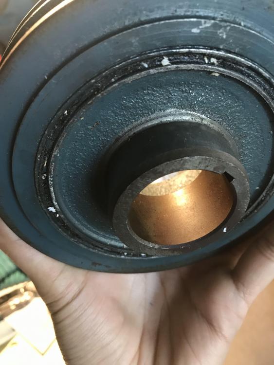

Replacement crank pully is here, the inside where it fits onto the crank looks like it could be cleaned up a bit, shall probably a scotchbride pad to it to just get it shiny. Is there anything else I should do to prep the balancer for install? Antisieze? Threadlocker :rolleyes:?
These balancers are not bad @Zup not sure about `NOS` they seem like they are new used. LOL
You could use scotchbrite, or a strip of fine emery cloth to polish it up. Do the inside too.
Be sure there aren't any burrs, don't overlook the keyway.
Clean it with a mild detergent, and install. I like to put a thin film of antisieze on the bore, and in the keyway (use a q-tip). A little goes a long way, just be sure it is even.

If they were used, the pulley v-grooves would show wear from the belts. Easy to check, a 6" steel scale laid against the bevel, shine a flashlight at the backside. As the grooves wear, the surface will become concave.

Do the flat mating surface on the backside also.  That's the part that clamps it to the crankshaft.  And be careful with the key in the keyway, I've read stories of them getting cokced and/or pushed out of place during installation.
Many people use red loctite, just to the be extra safe.  But Nissan doesn't call for any threadlocker.  I'd just use blue.  Nissan instructions make it "no big deal".
Racer X and Zup know more, I'm just talking about the basics and things I've read.
p.s. I would avoid getting any antiseize on the mating surface at the back.  The bolt clamps that surface to the crankshaft and making it slippery will put extra load on the key, which is supposed to be mainly for locating, as most keys are.  You want that friction.
p.s. 2 check that the hub length is the same as the old one and make sure the bolt doesn't bottom out before clamping.  More stuff I've read. Problems people have had...
