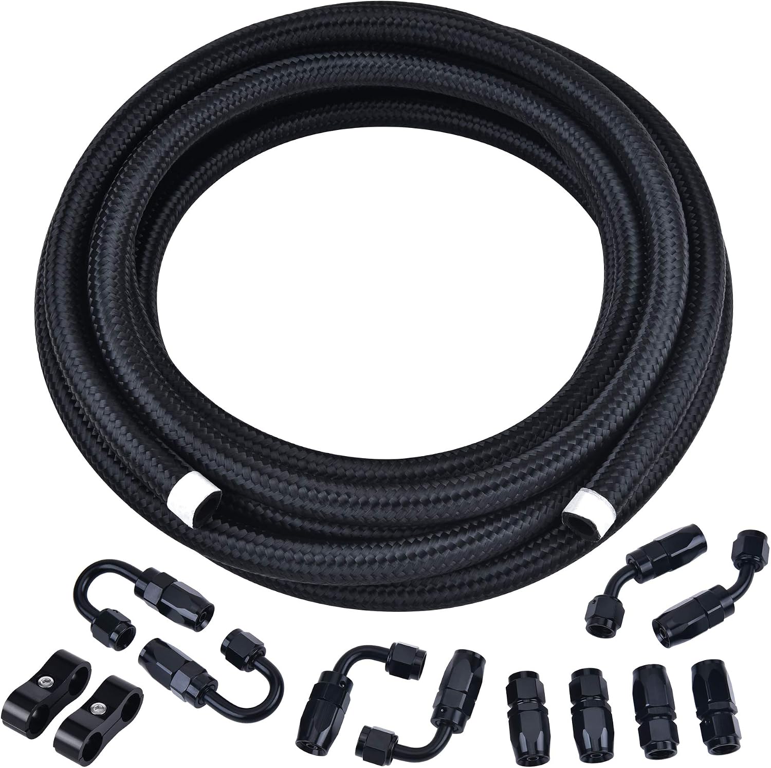

The wiring and fuel line are not cleaned up and definitive as I am still expecting some looms, braided hose and AN fittings. I will also remove the useless temperature sensors and thermo-contact used prior the ECU control of the fans. As much as I love the air horns on the ITBs, too much sand in the area, cannot risk the engine, so big monster filter for runner, and naked for showing...

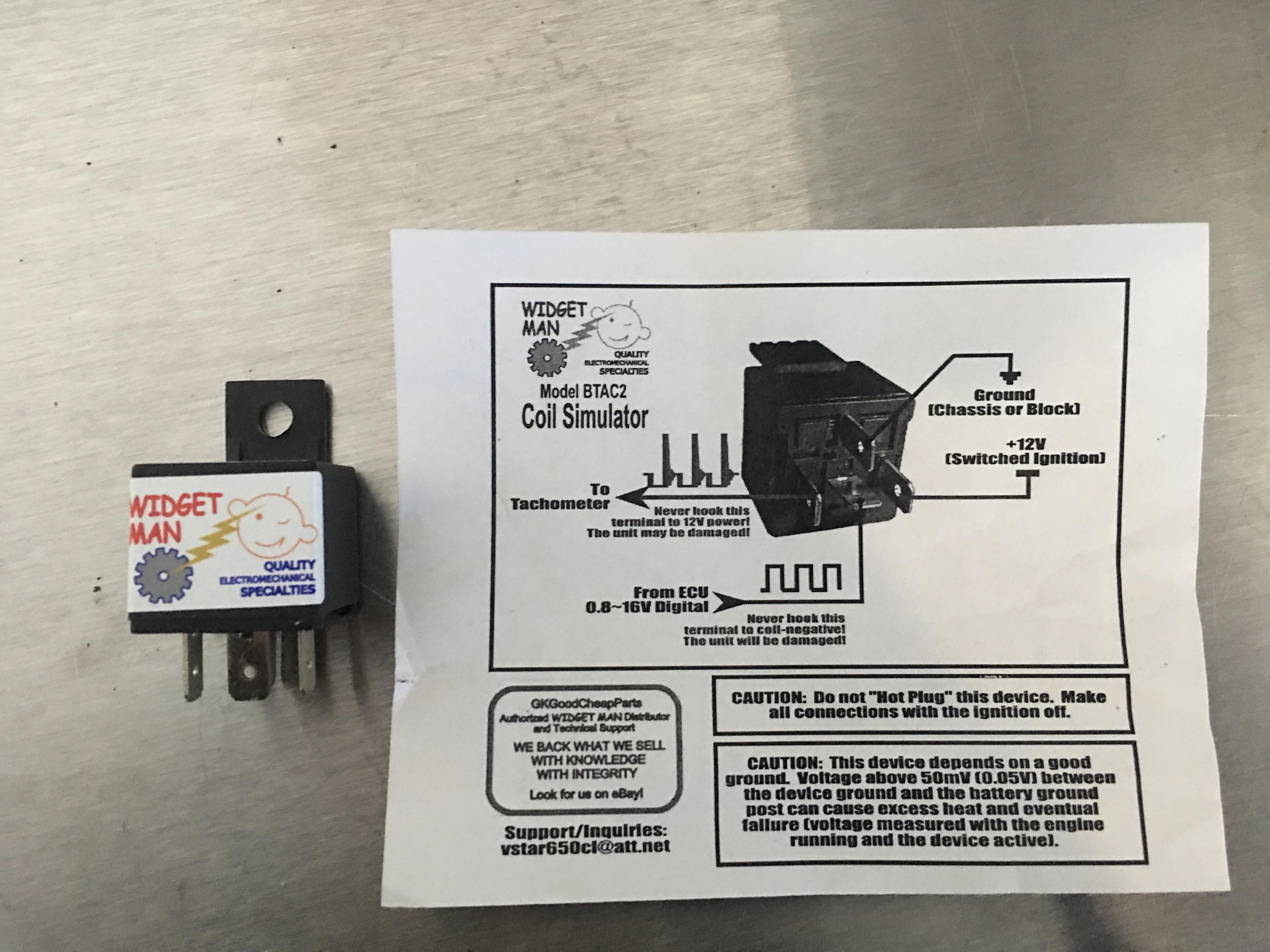

On 1/15/2021 at 1:58 AM, wheee! said:
Finally received my digital to analogue tachometer converter. The Haltech sends a digital signal that needs to be converted into the old school coil signal for the tach to work properly.
Pretty simple solution using one of these converters made by Gene. He’s on eBay and sells cool little gadgets like this for a reasonable price.
https://www.ebay.ca/itm/142171581596
@wheee! always got great findings, and I ordered the same Tachy converter from Gene, UAE was not in his destination list for shipping but he agreed to give it a shot, so let's cross fingers so it doesn't get confiscated as it apparently happened in the past.
I am also ordering the mechanical to Electrical VSS converter (metric) from Protuners, as I already converted my speedo dial to kmh + electric pump for 60psi as my FPR is set at 3.0bar and my fuel pump seems to be a little weak (needle bouncing 42-50 psi on the gauge).
Already received my wire loom and expecting the fuel lines today.
