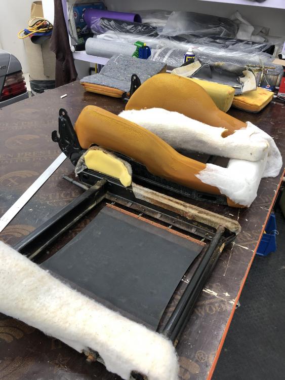

The restoration work has already started and I should get them finished by mid January.

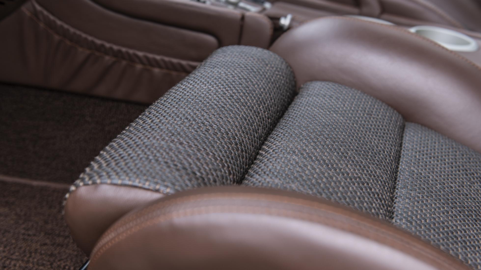

Below is the selected fabric and leather - question: gold or black rivet ?
The inspiration for the seat is from Robert Downey Junior BMW E9:

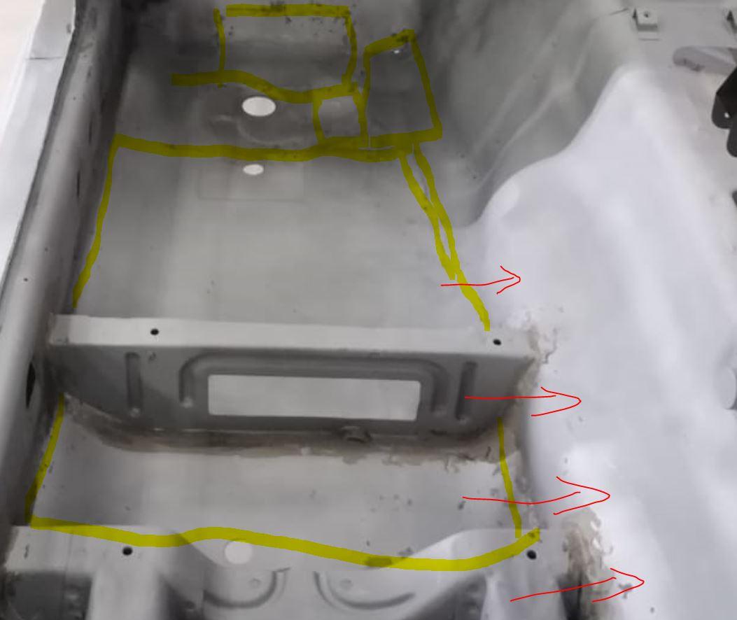

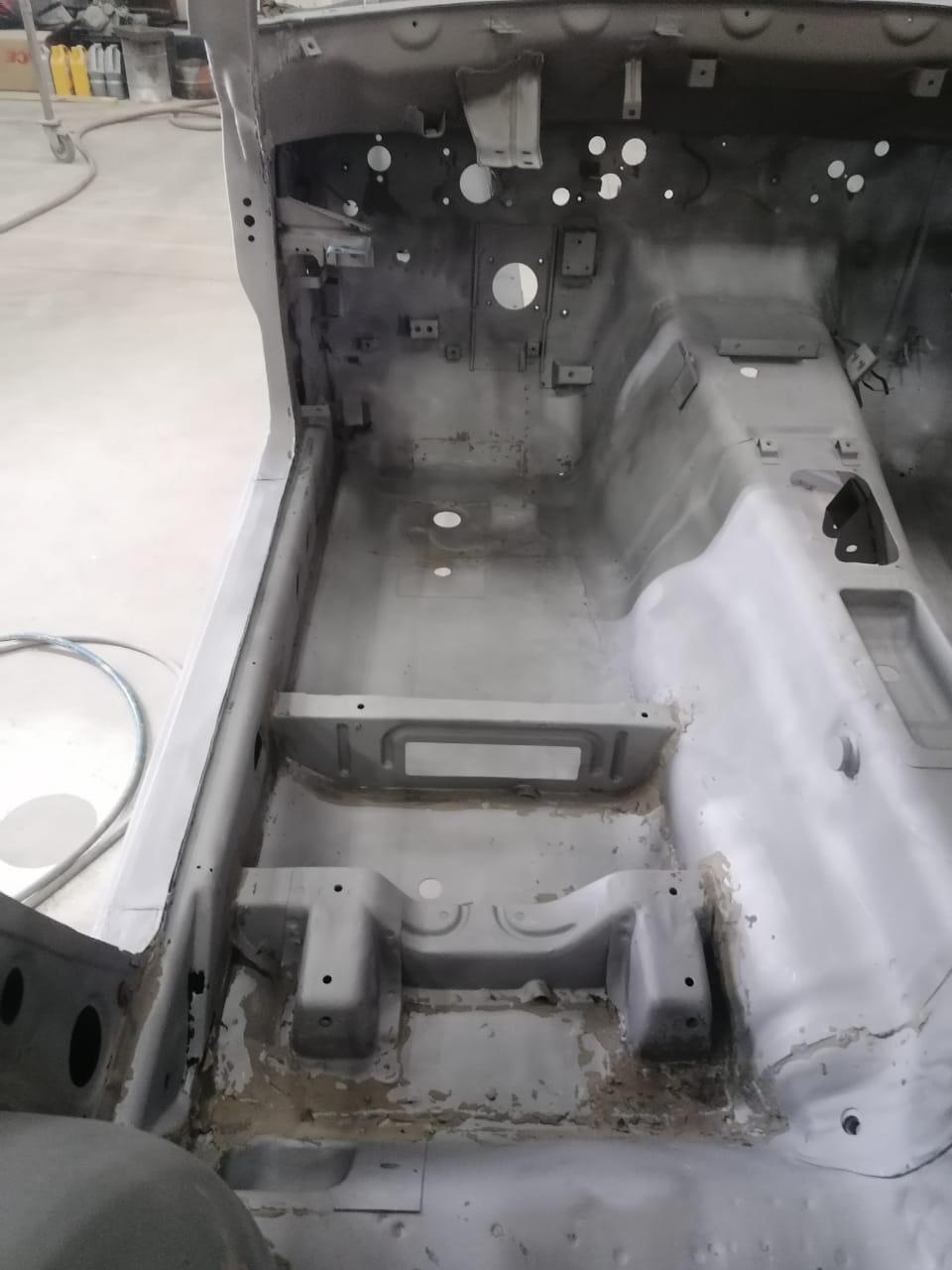

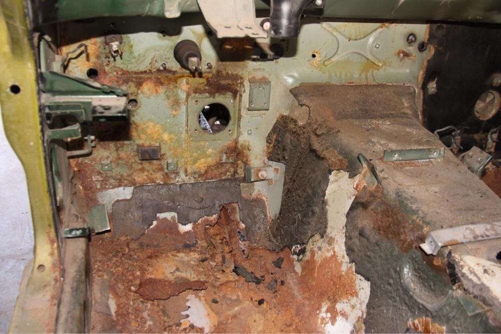

11 hours ago, wheee! said:
My floors were much worse than yours. I would not even replace those!
It's difficult to see on the picture but the floor was already "fixed" with several patches and the same bad quality welding work (yellow highlight) on both side and the rails underneath are also in bad shape...
So the bump with the red arrows pointed should be leveled to the seat rails correct, to gain a bit of width ?
Thank you @wheee! for all these inputs, definitely helping a lot !

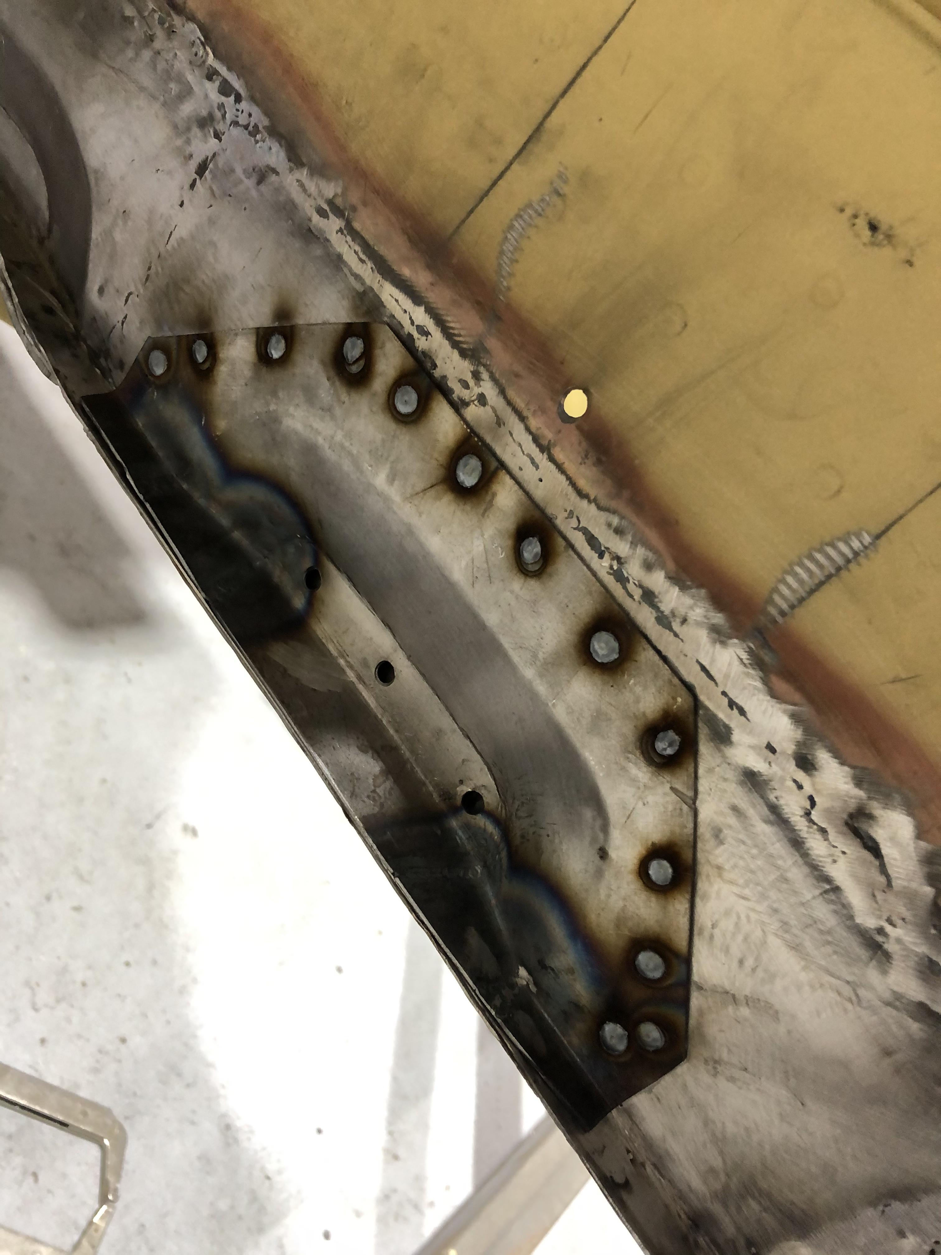

The last strengthening piece on the left front end is now welded:
