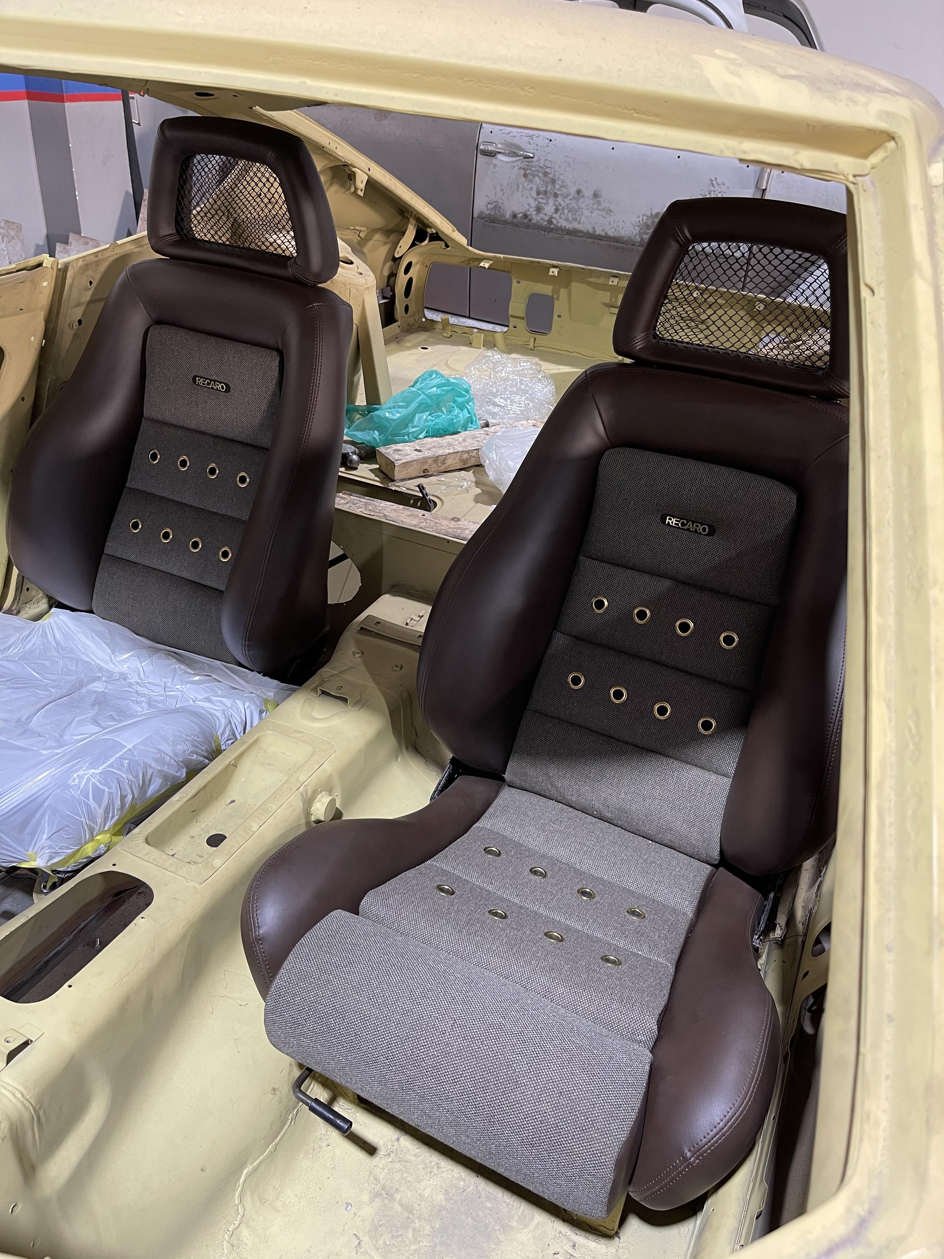

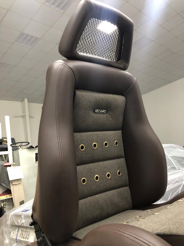

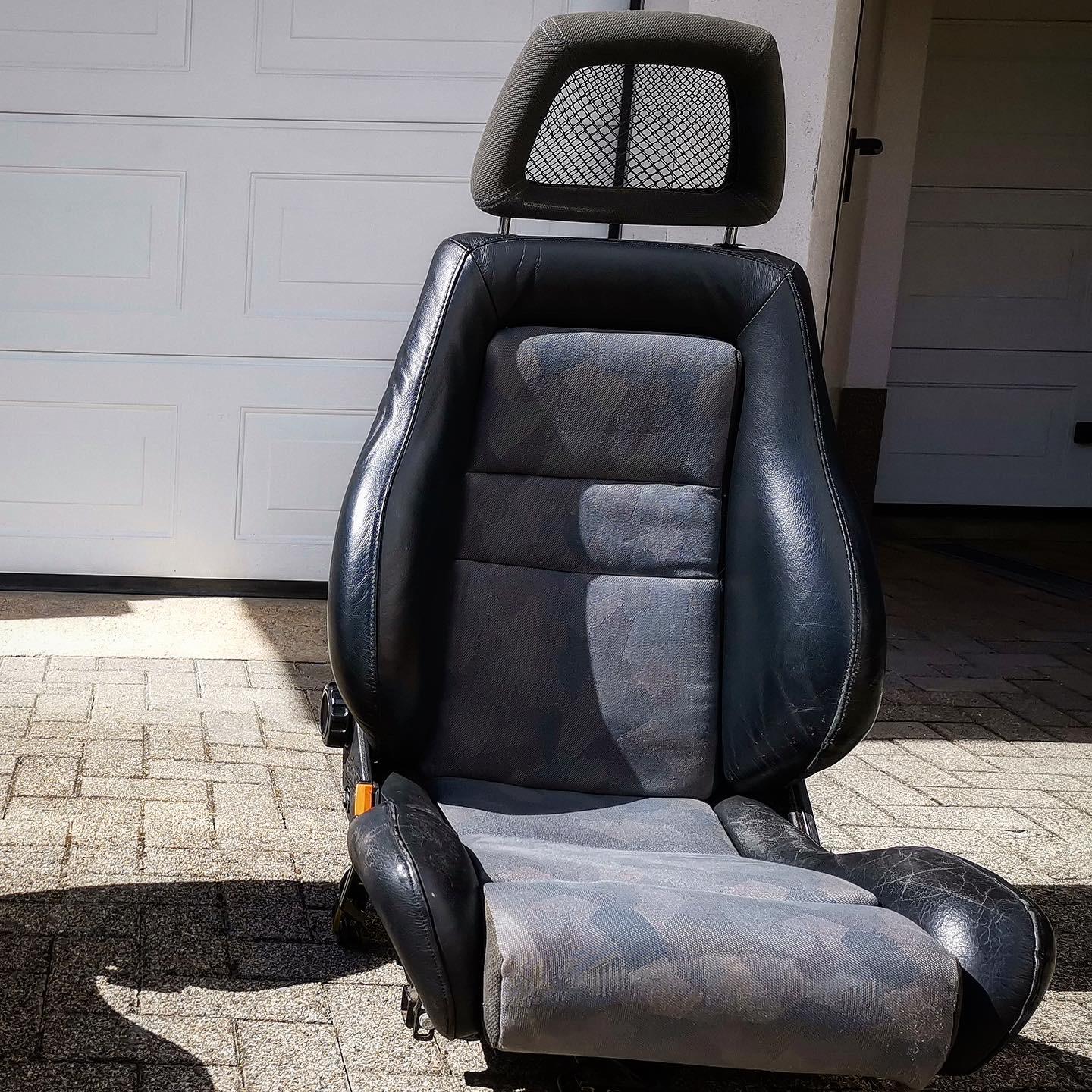

First seat finished and handed over for the fitting and the adjustment of the new floor/support/transmission tunnel (Thanks @wheee! for your advice on this one !)

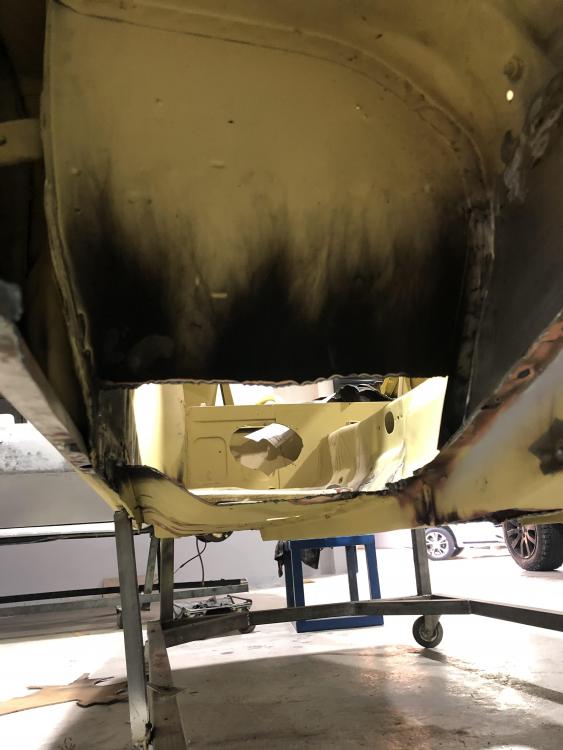

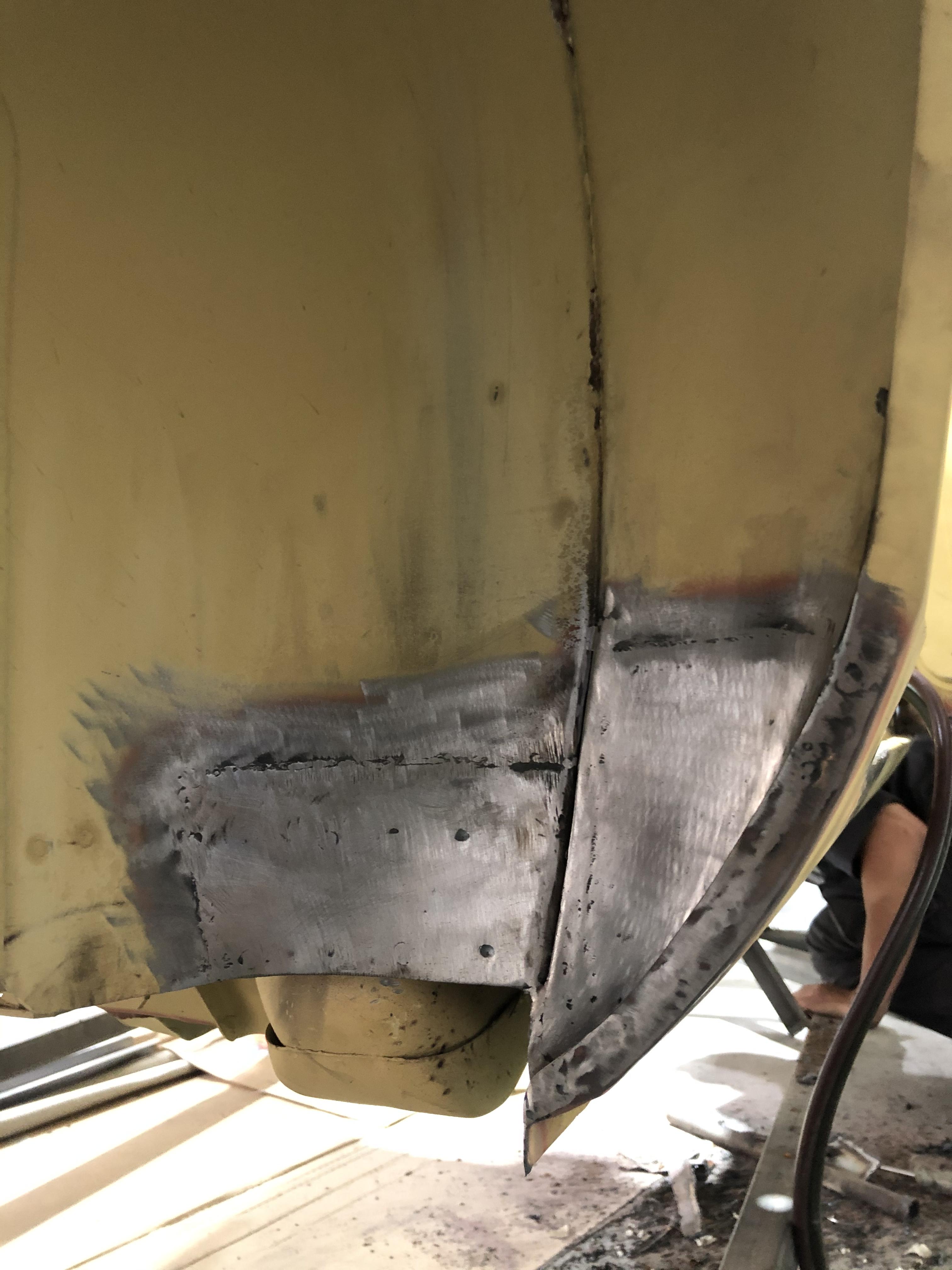

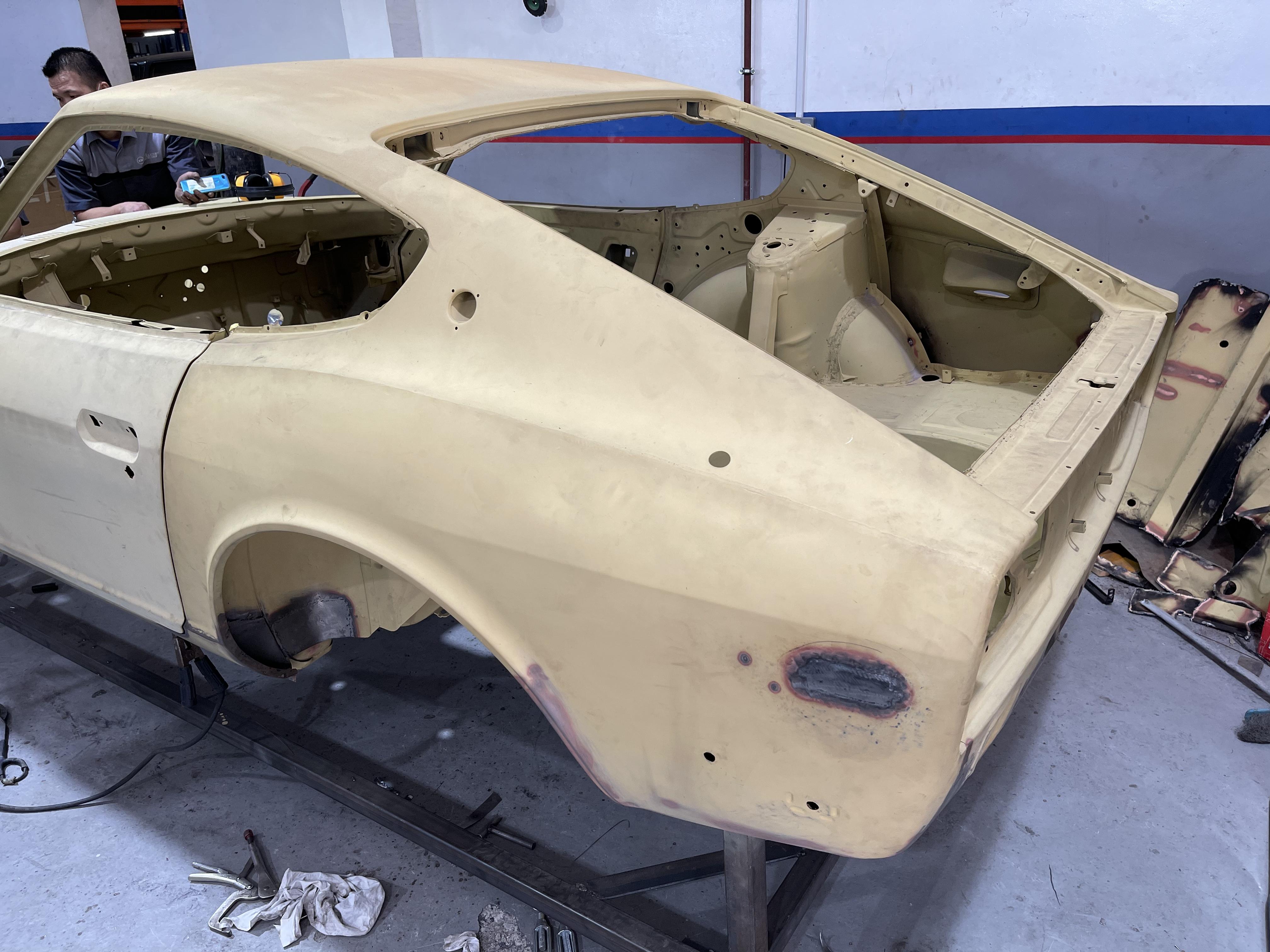

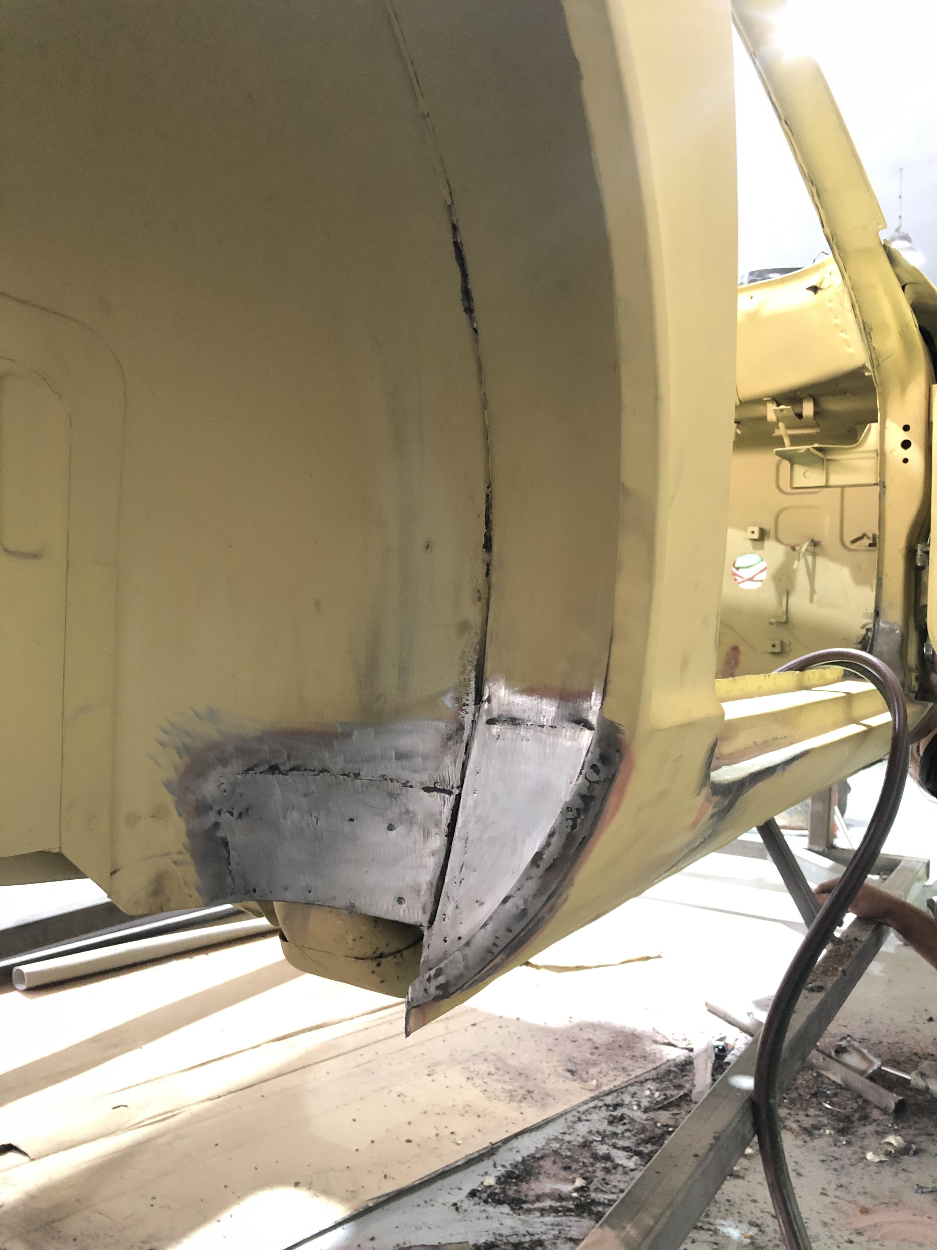

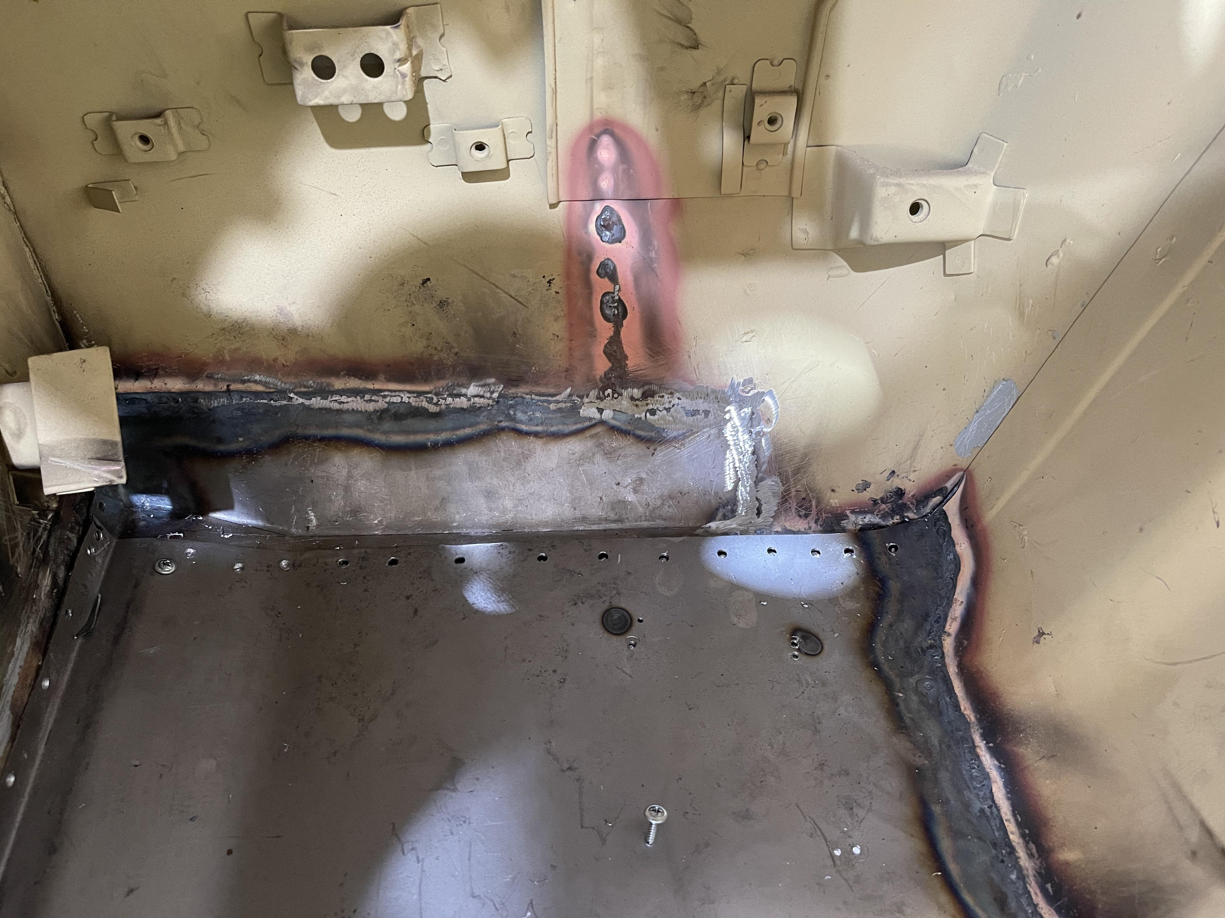

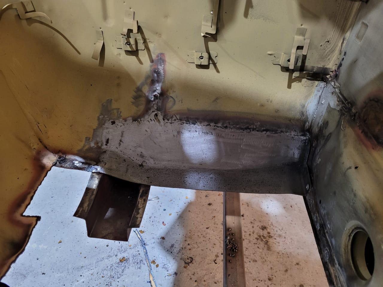

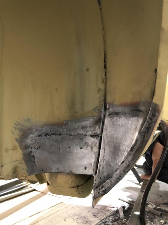

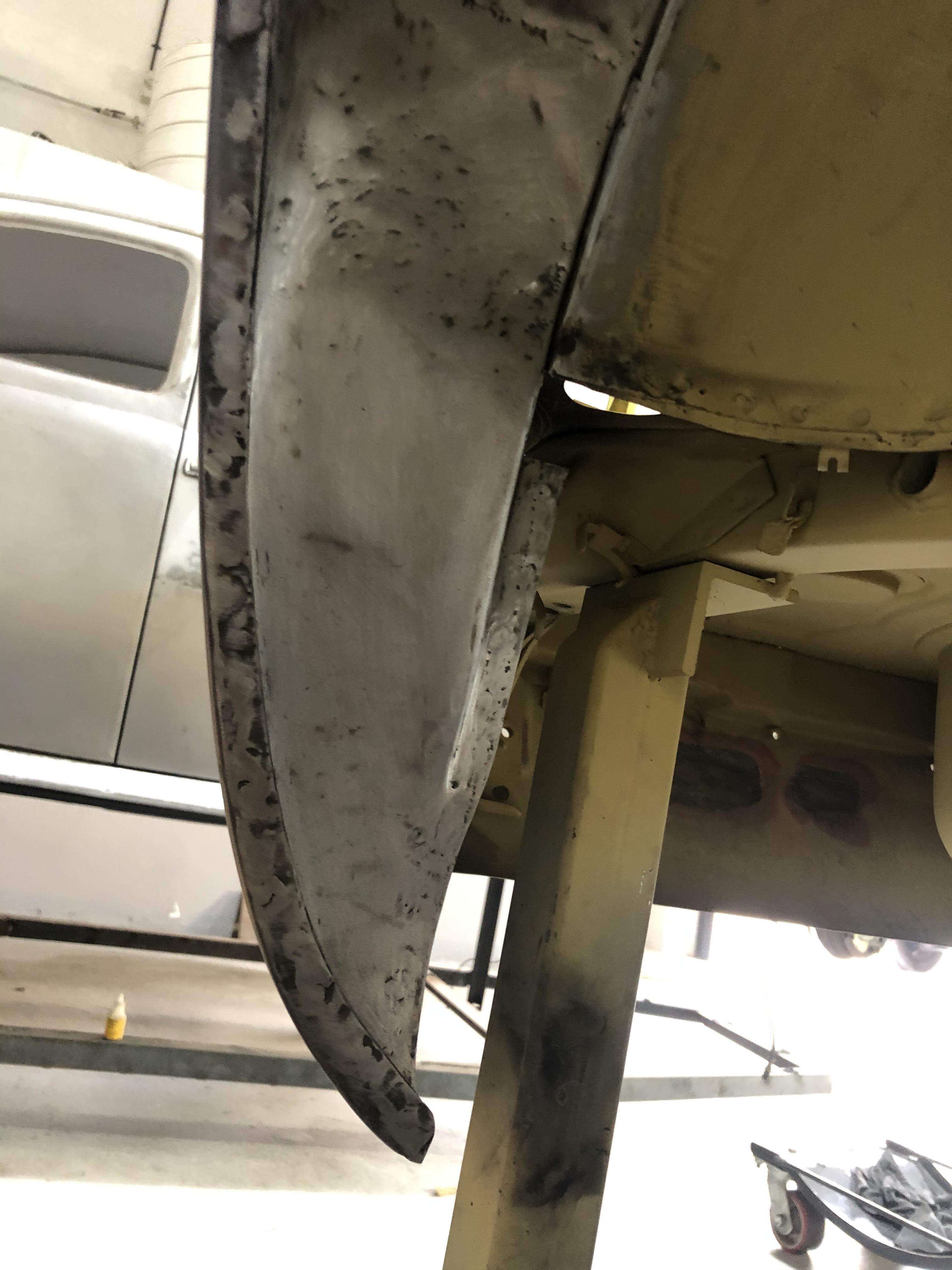

The rear left wheel arch completed, so now its "only" the floor area 😂
Photo 17-01-2021, 5 06 38 PM.jpgPhoto 17-01-2021, 5 06 32 PM.jpgPhoto 17-01-2021, 5 06 22 PM.jpg

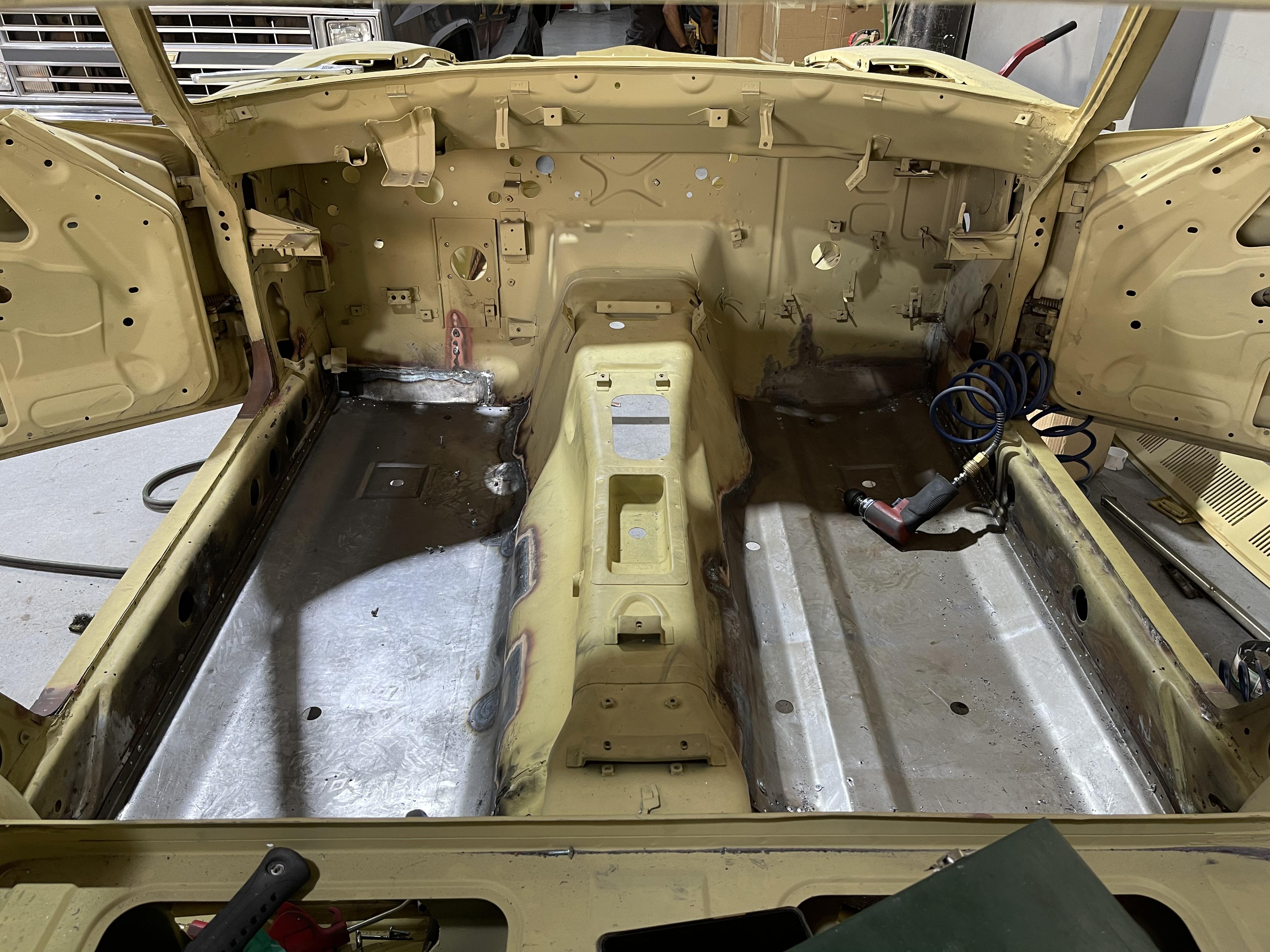

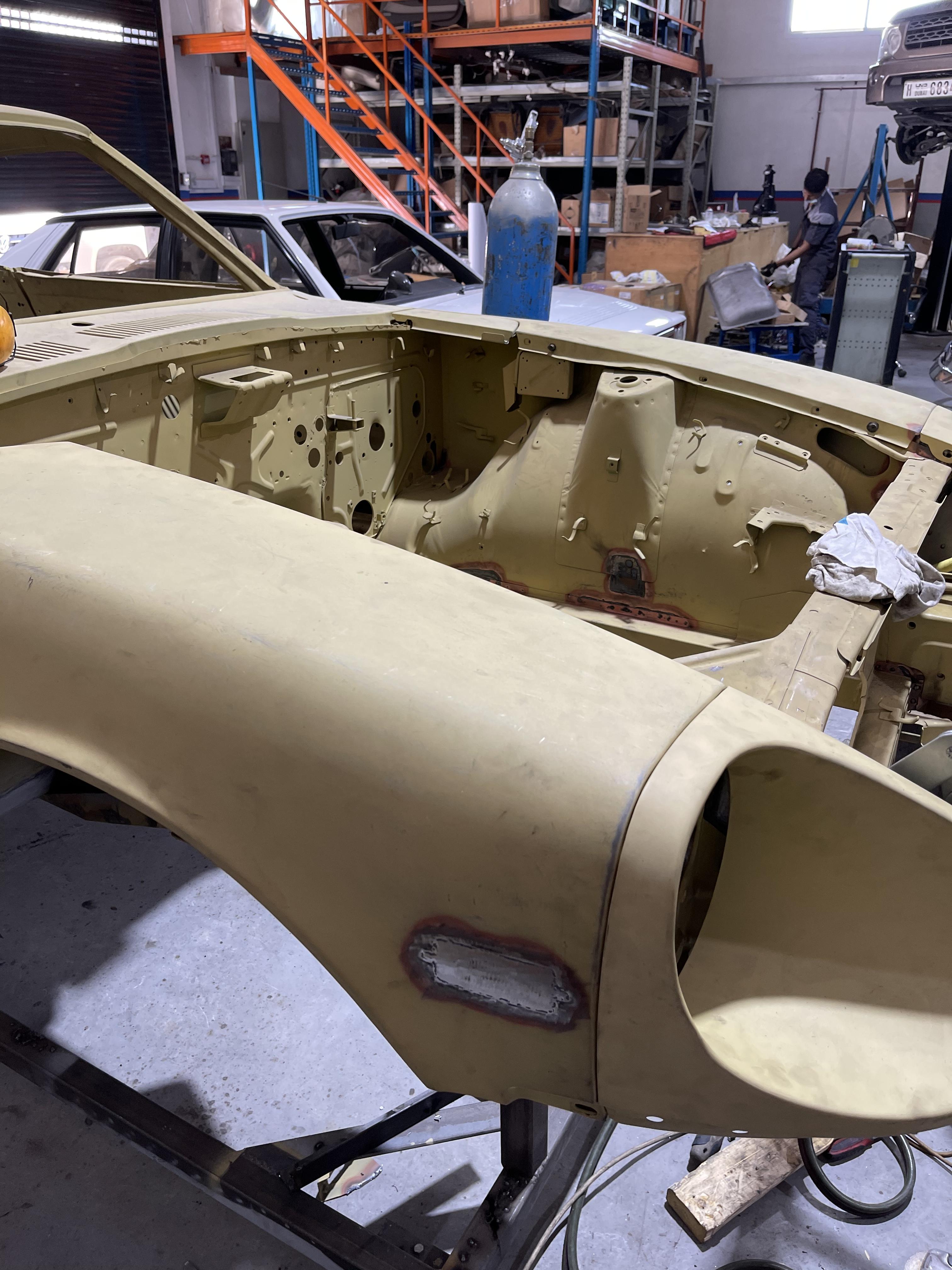

Spare tire well done, floor cutting started yesterday.
Photo 17-01-2021, 5 14 57 PM.jpgPhoto 17-01-2021, 5 07 47 PM.jpgPhoto 17-01-2021, 5 29 23 PM.jpg

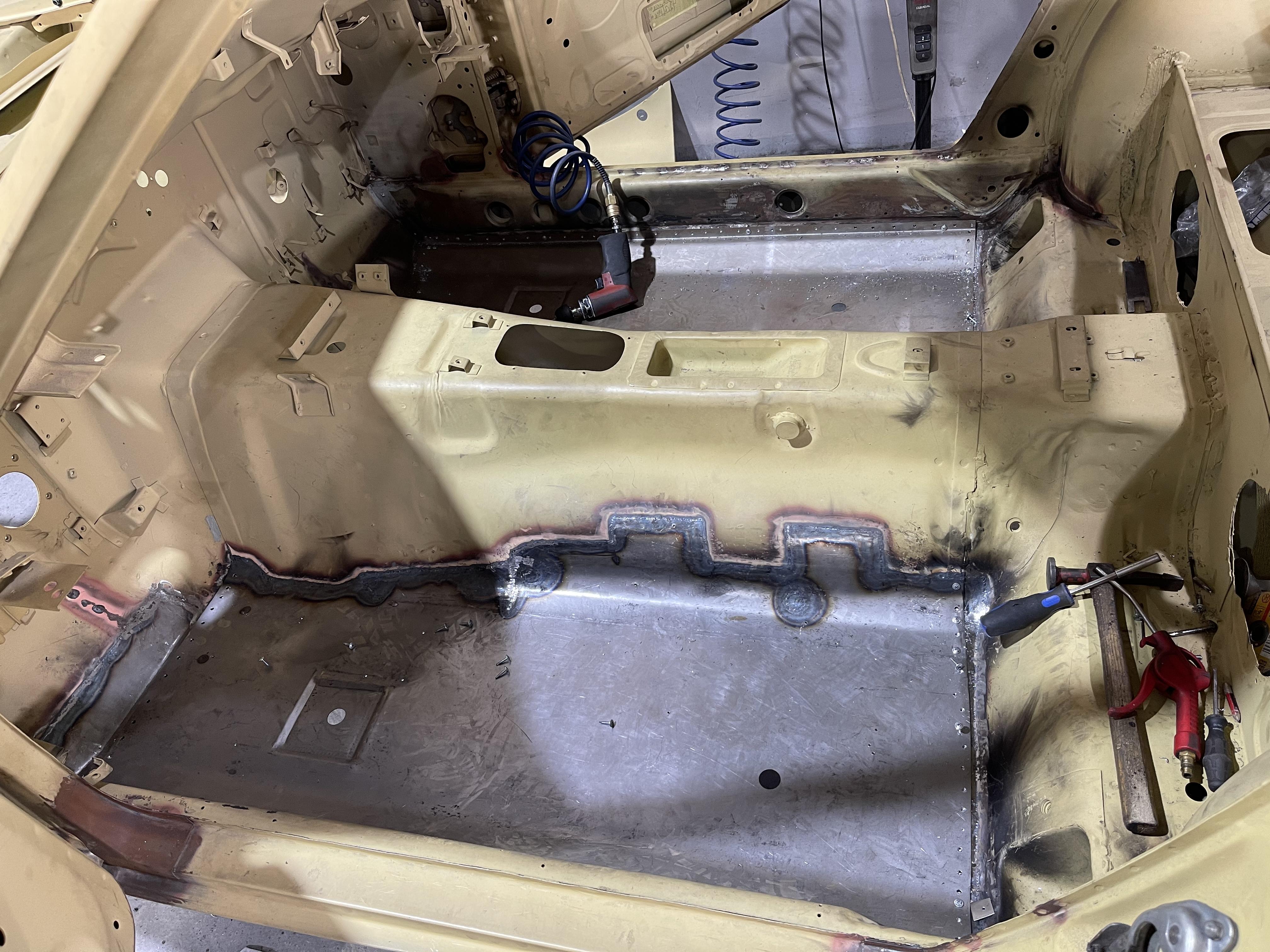

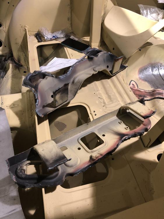

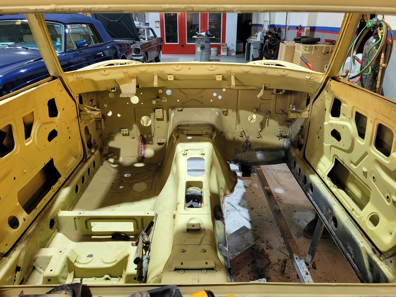

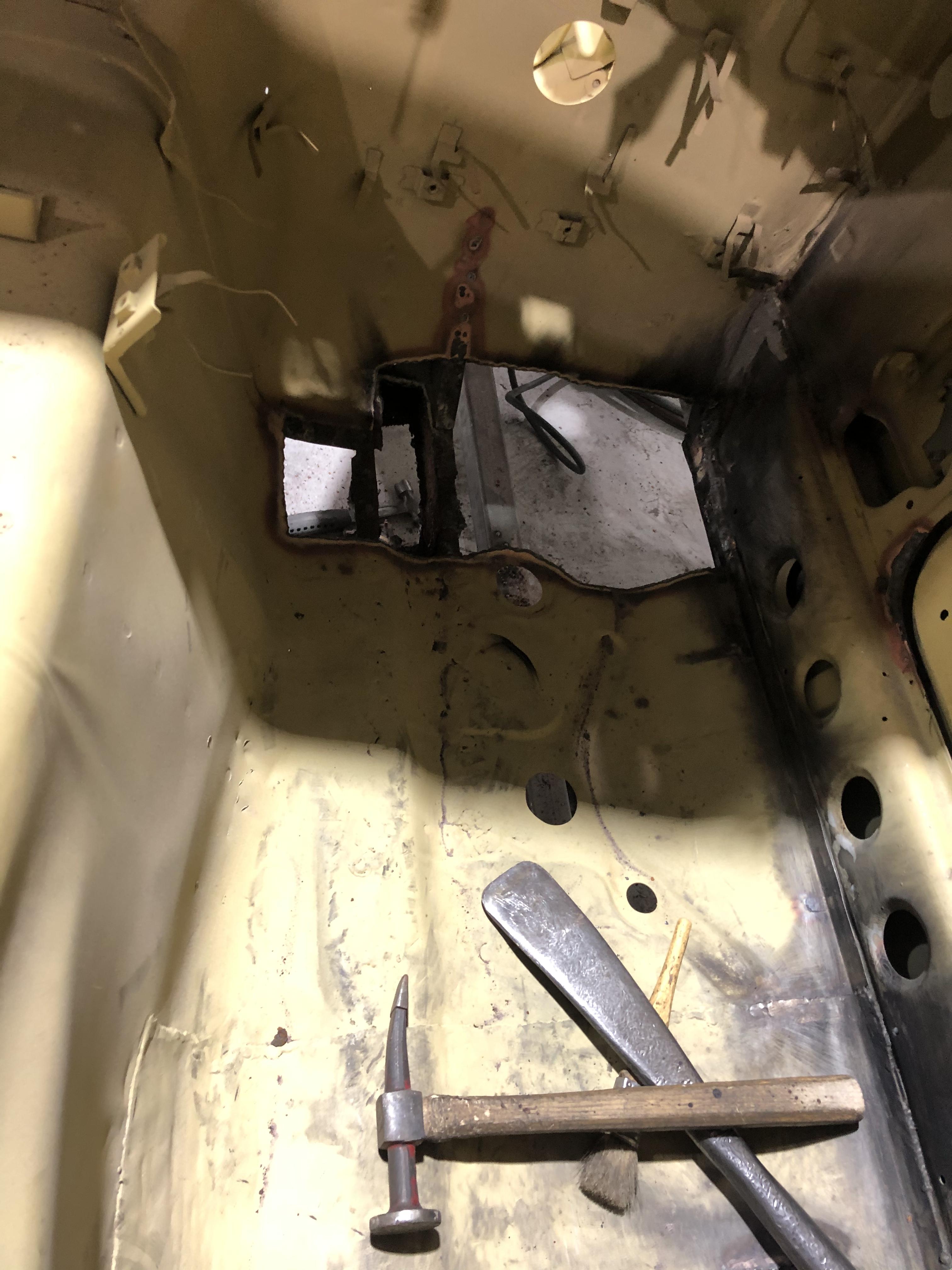

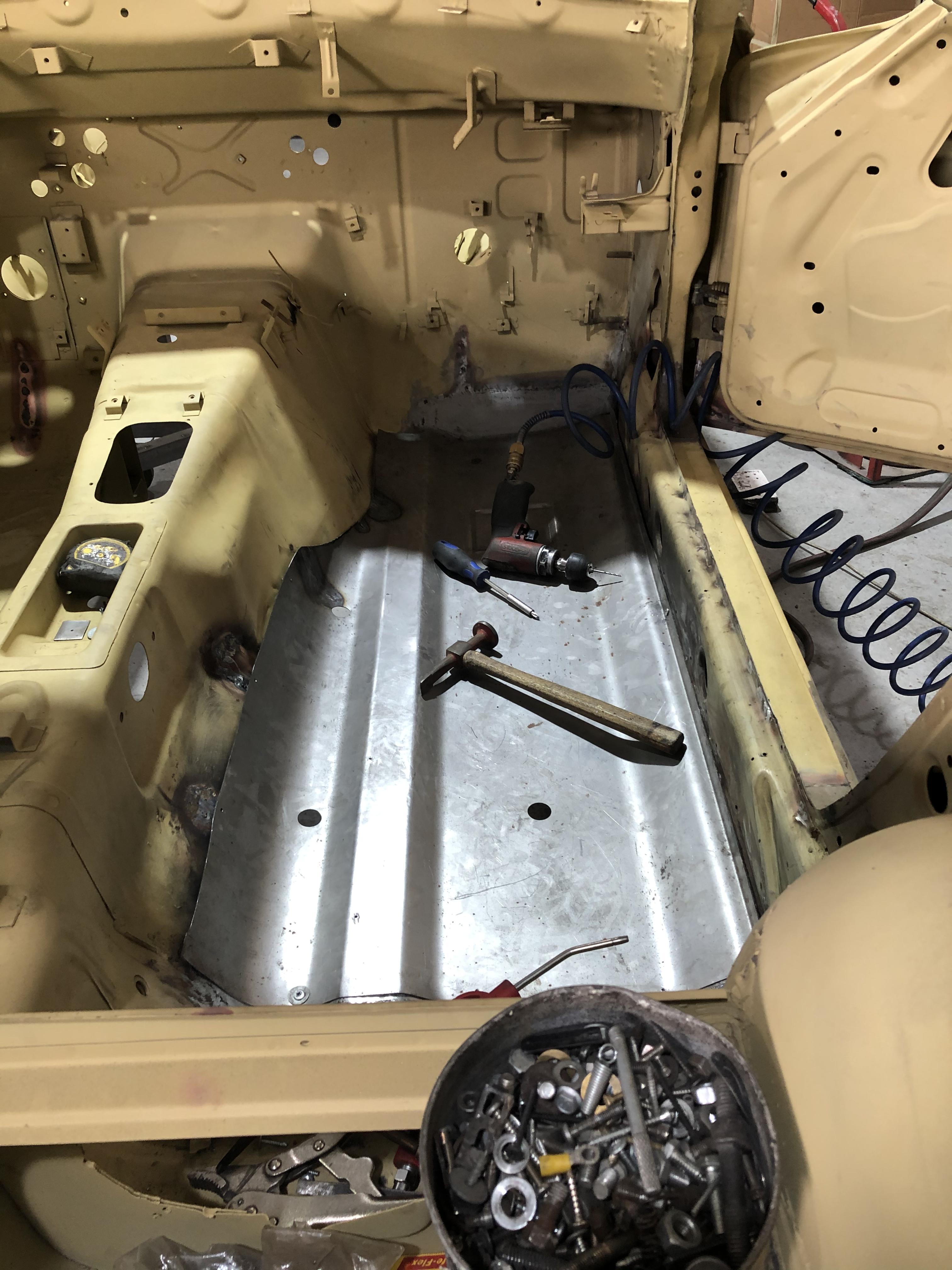

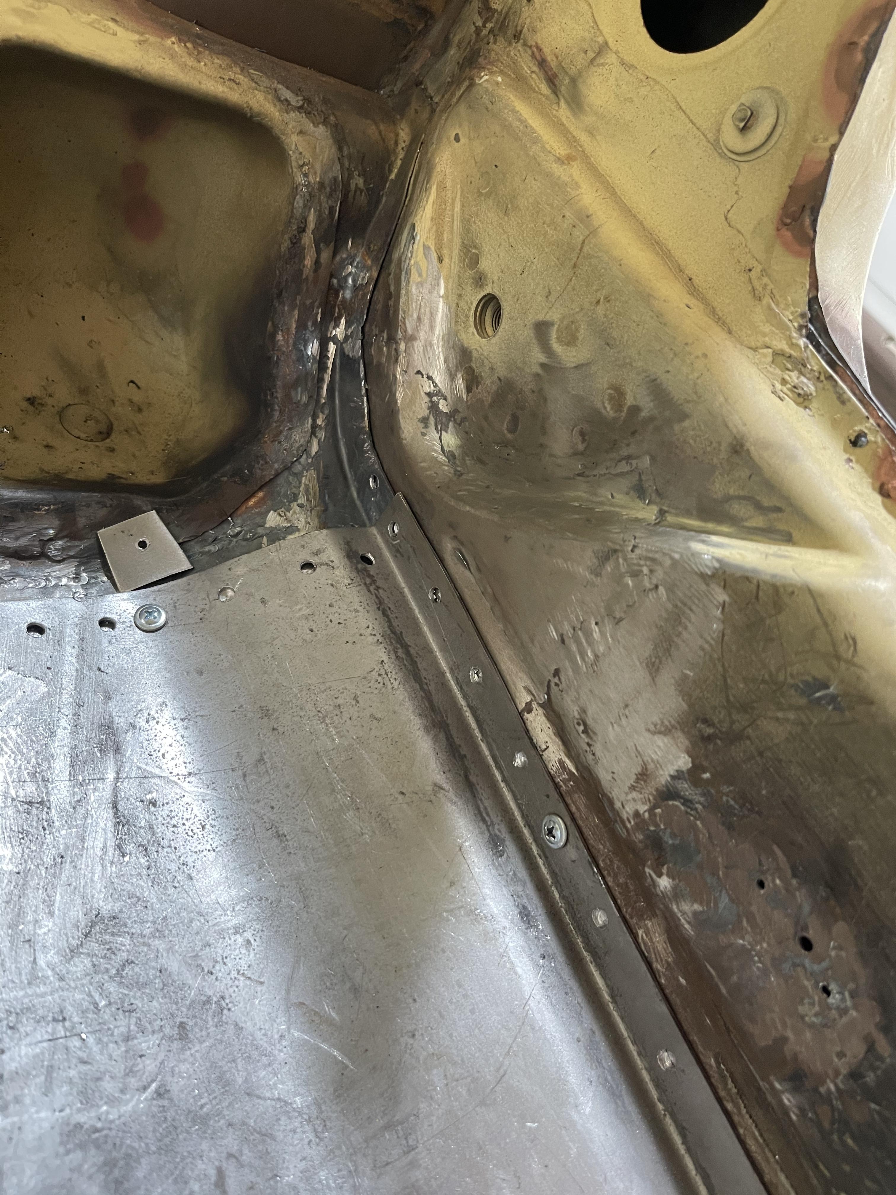

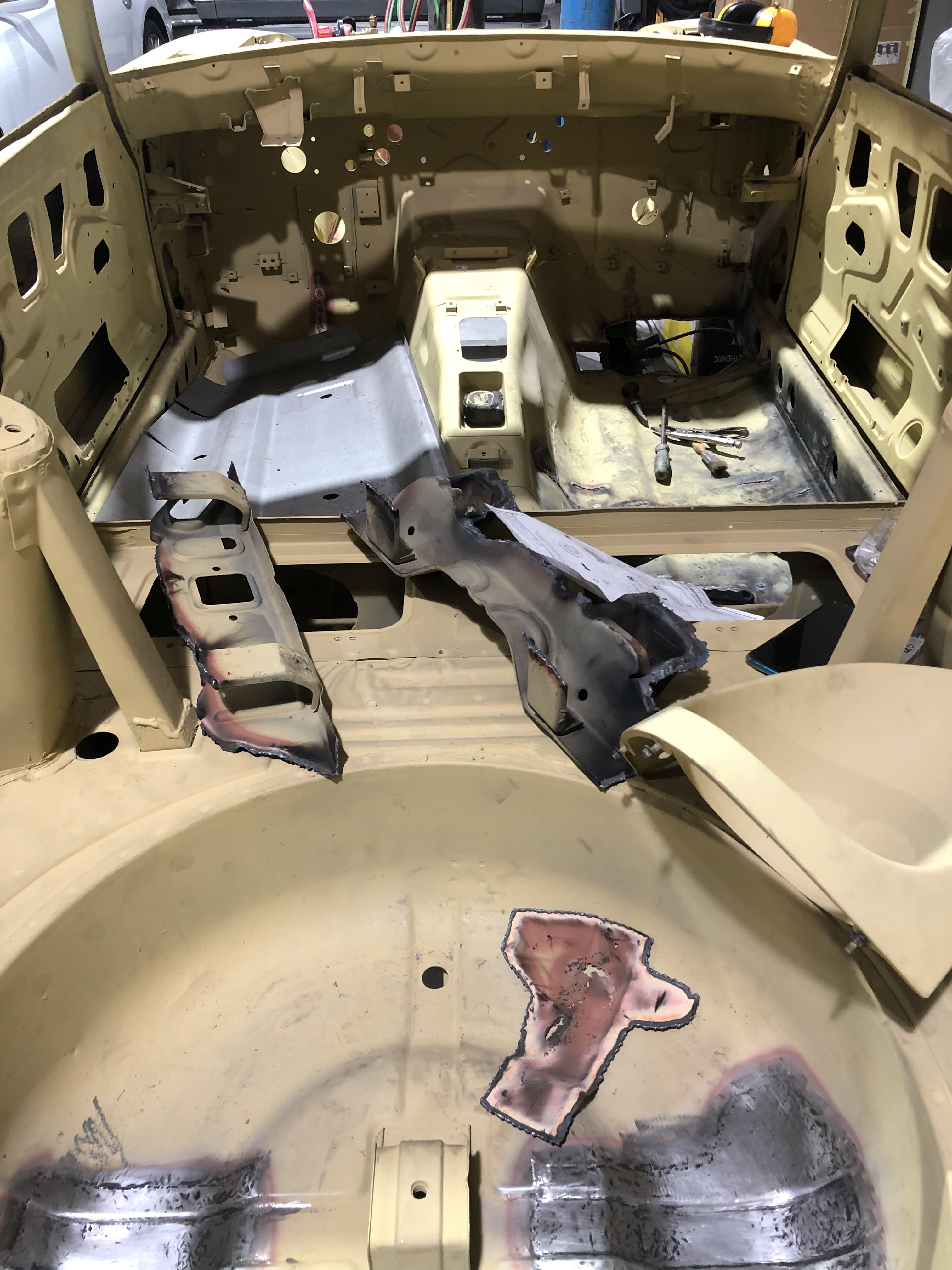

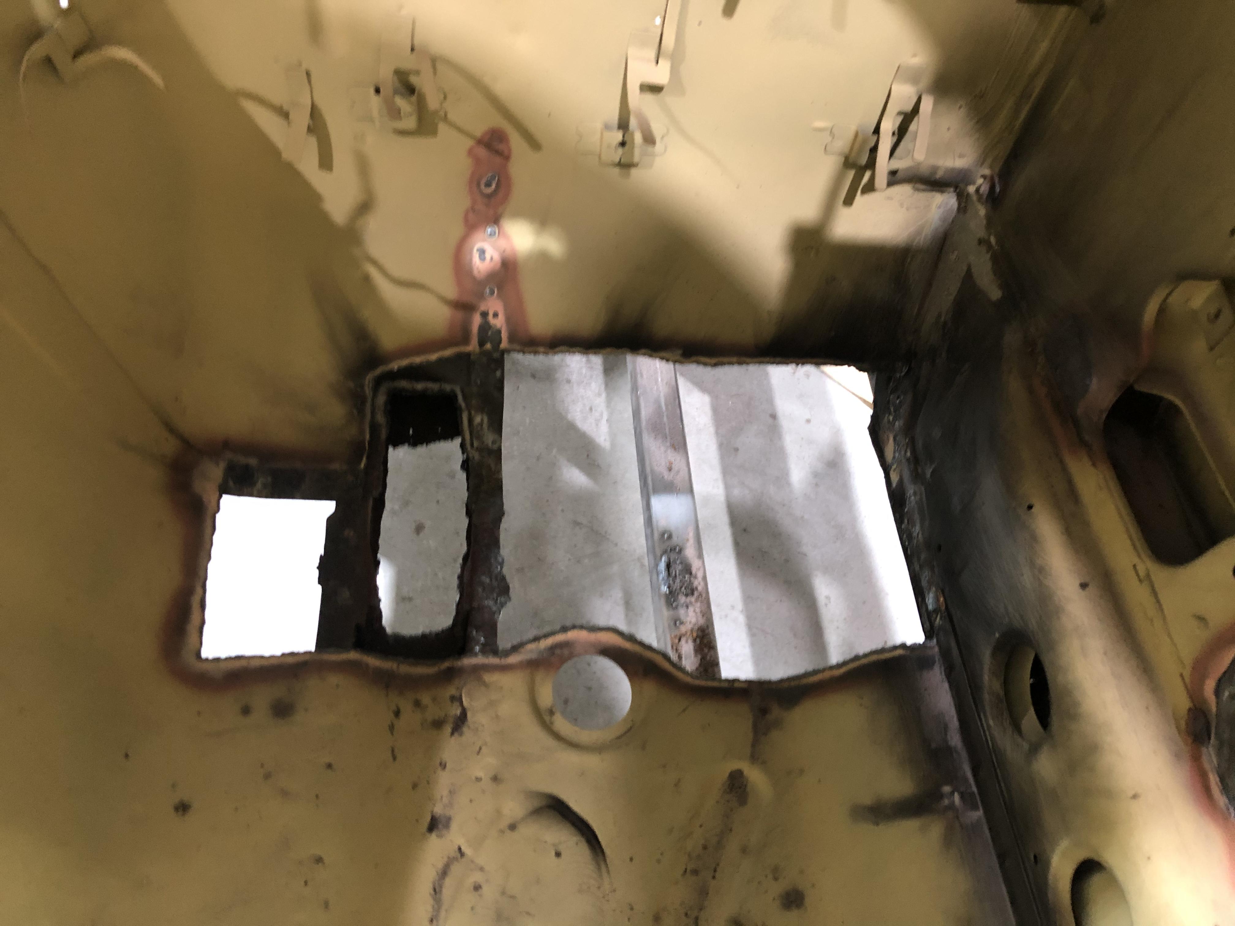

Some progress on the floor passenger side, from the "small" hole and underneath rusted rail, to the cleaned up area and the new floor being adjusted.
Photo 17-01-2021, 5 31 03 PM.jpgPhoto 17-01-2021, 5 30 40 PM.jpgPhoto 20-01-2021, 5 26 40 PM.jpgPhoto 20-01-2021, 5 26 39 PM.jpgPhoto 21-01-2021, 2 52 34 PM.jpg
You can also notice the patches on driver side above, mix and match of original floor (the water drain in X shape), a part of Zeddfindings floor with the square area, and some metal sheets.

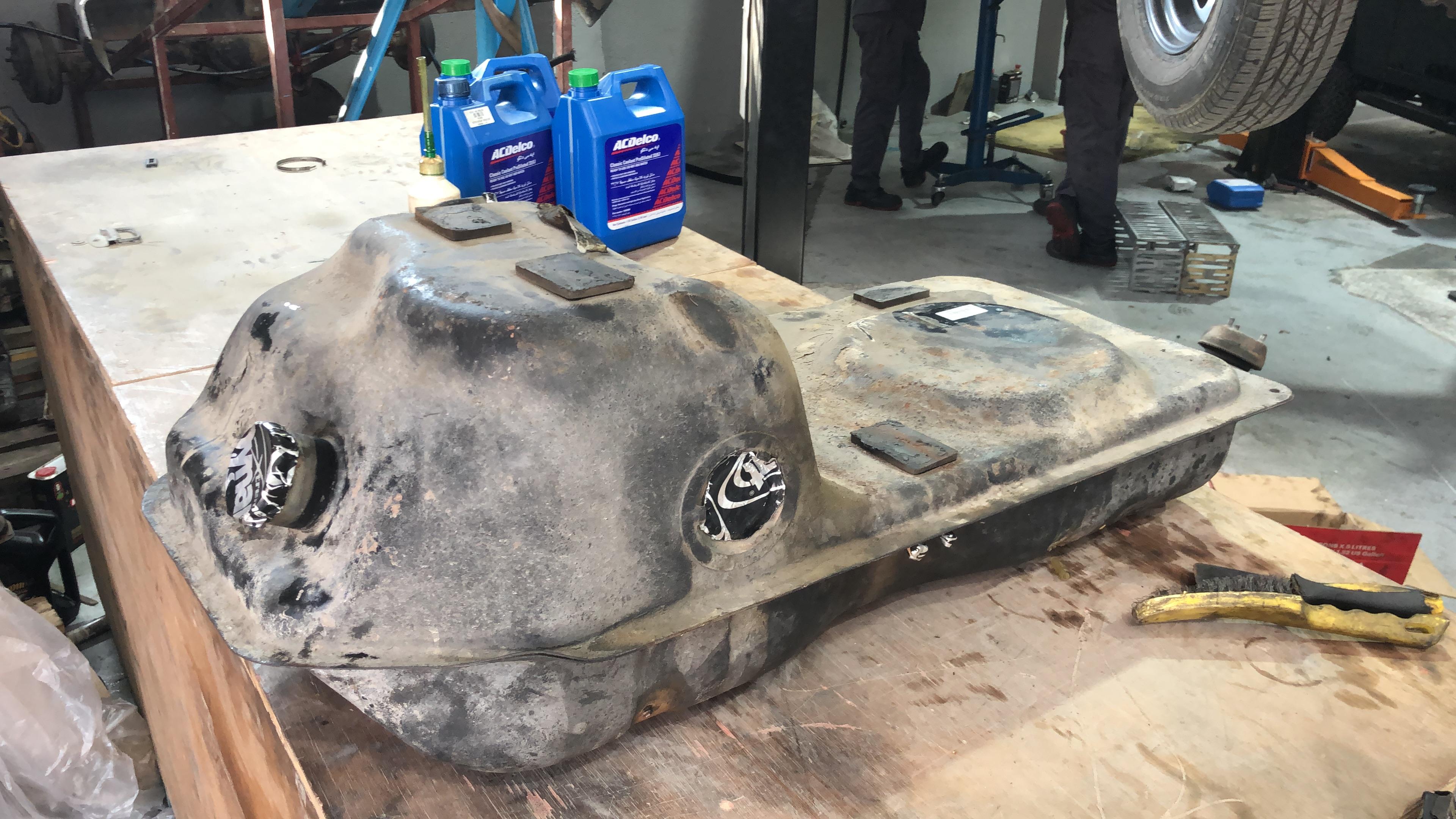

The gas tank as several rust spot, some pin holes, but I believe can be saved, let's see after sandblasting.

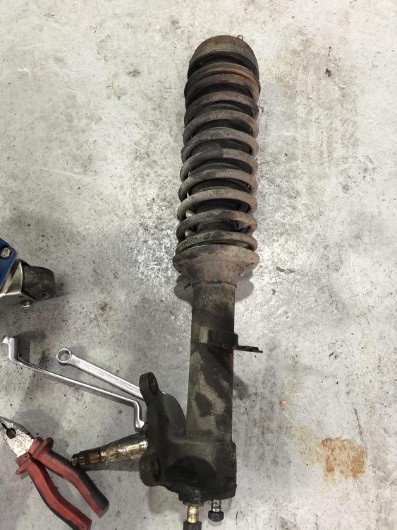

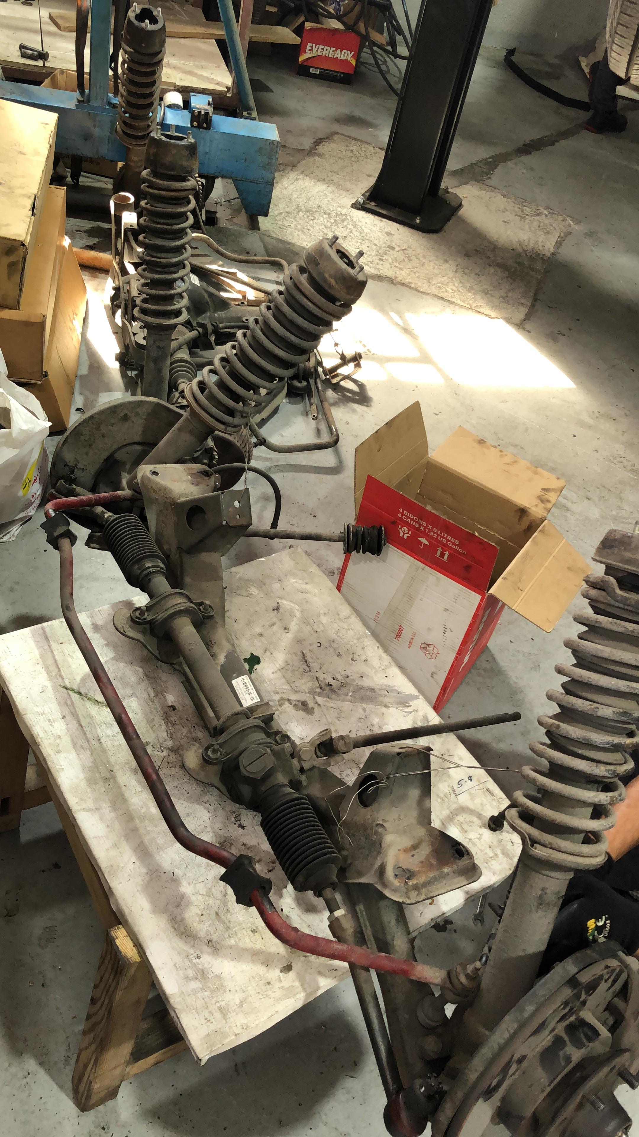

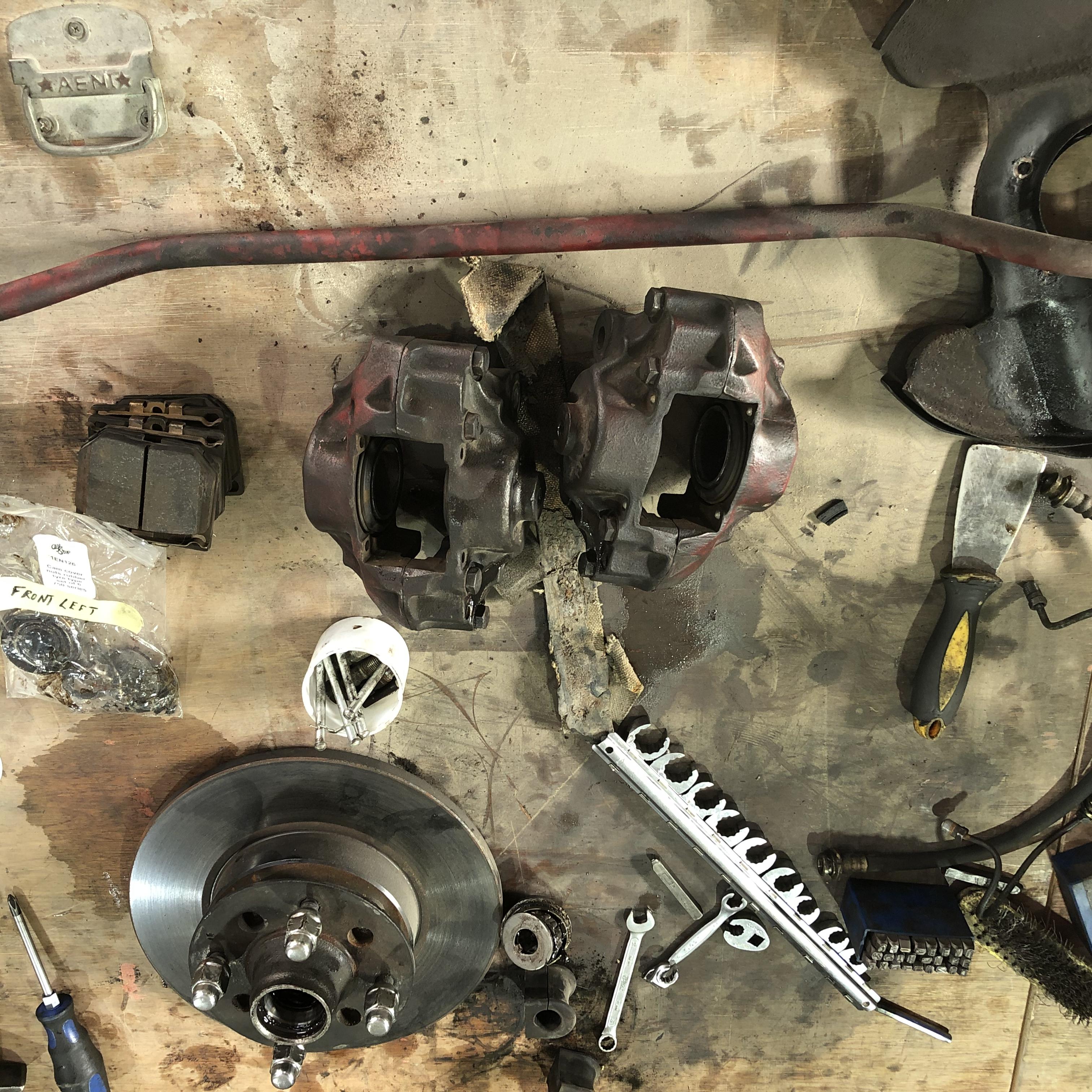

Shocks/springs will be changed with the KYB Excel G I got in the auction with the car and the T3 coil over conversion kit. The front brake calipers will be refurbished (disks and pads are still new), rear drum refurbished as well. Everything going for sandblasting and will be repainted in black, except the sway bars to remain red, matching with the Prothane bushing kit.

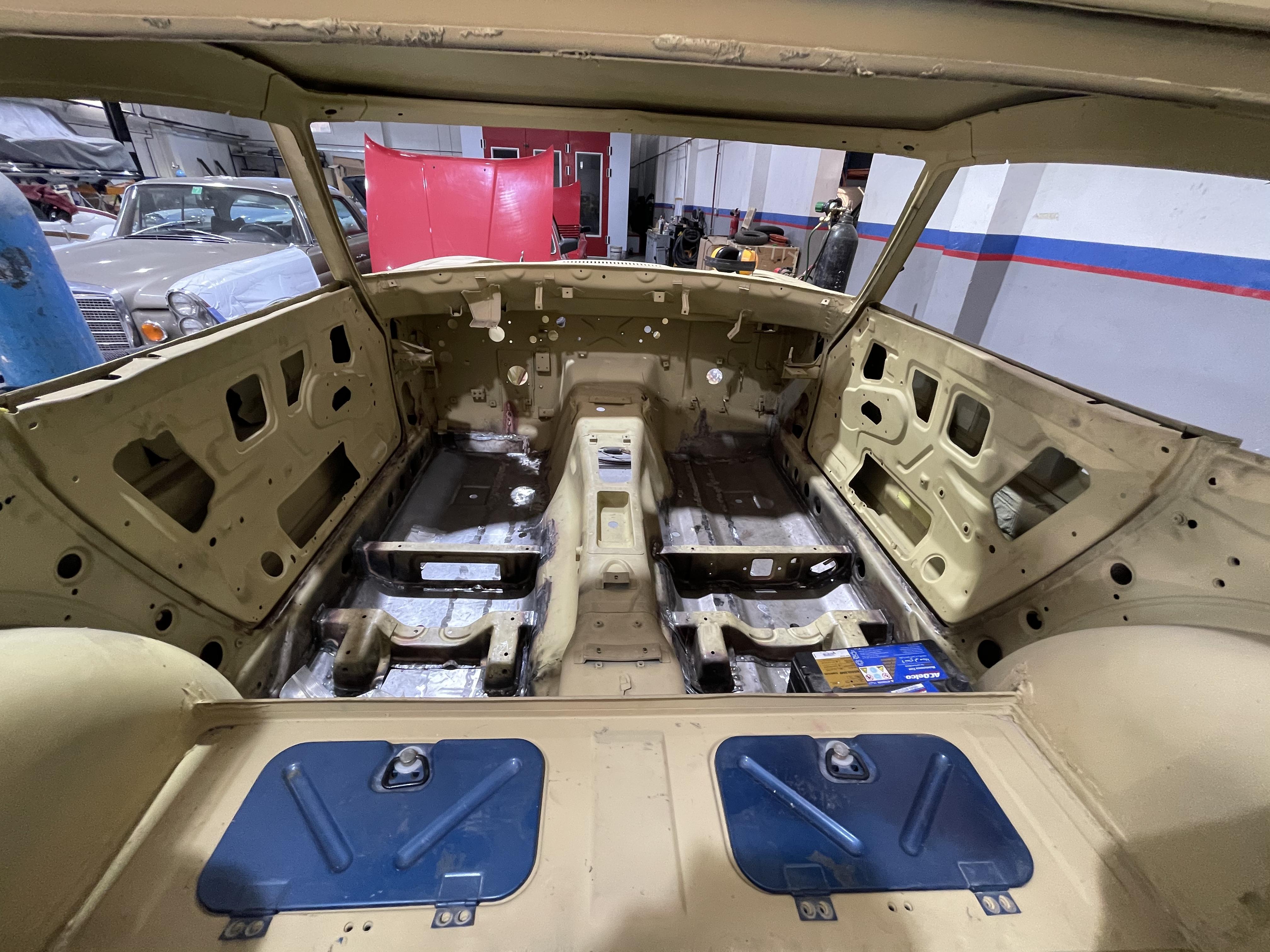

Further development on the floor, both sides were ready for spot welding yesterday afternoon, it does feel closer to the denting and painting.🤩
Photo 31-01-2021, 4 52 23 PM.jpgPhoto 31-01-2021, 5 15 12 PM.jpgPhoto 31-01-2021, 5 14 49 PM.jpg
After seat adjustment on the transmission tunnel the water drain holes and the bend had to be deleted, so 2 new drain will be created. Still need to close the speaker holes cuts into the tool box.
I reused the original seat sliders & brackets and adapted them for the Recaro, using the same fixation points on the body. Also, had a guest quite unhappy to remain in the passenger seat 🤣

On 2/1/2021 at 5:10 PM, wheee! said:
Great work on the driver side trans hump! That will be so much easier to fit modern seats.
Reusing the original sliders from the 280z and doing a first fitting before removing everything was the way to go. Again, thank you loads for the warning @wheee!
The Recaro are slightly larger, but now there is enough space for the noise/heat proofing mat, the carpet and the seat belt.

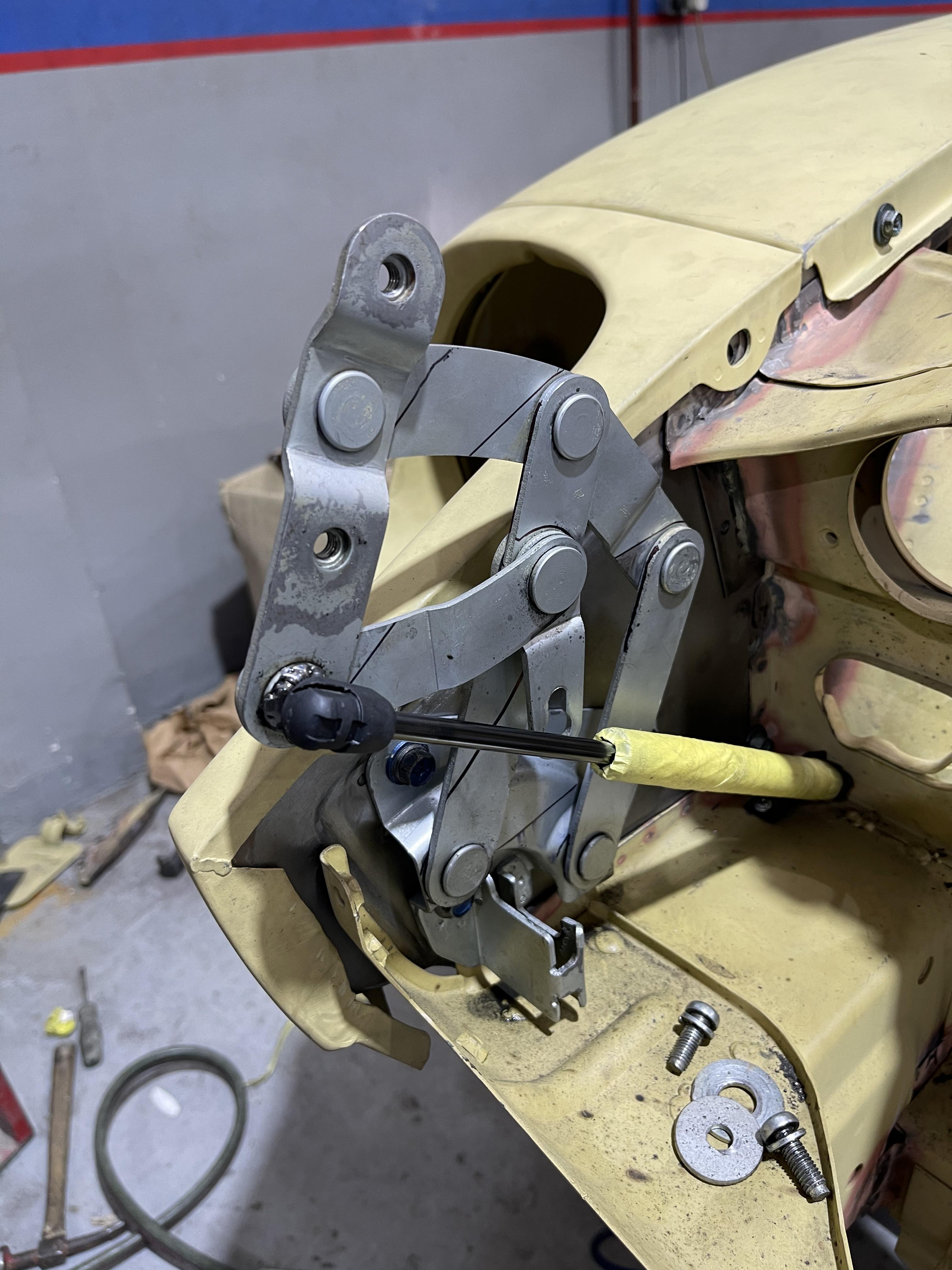

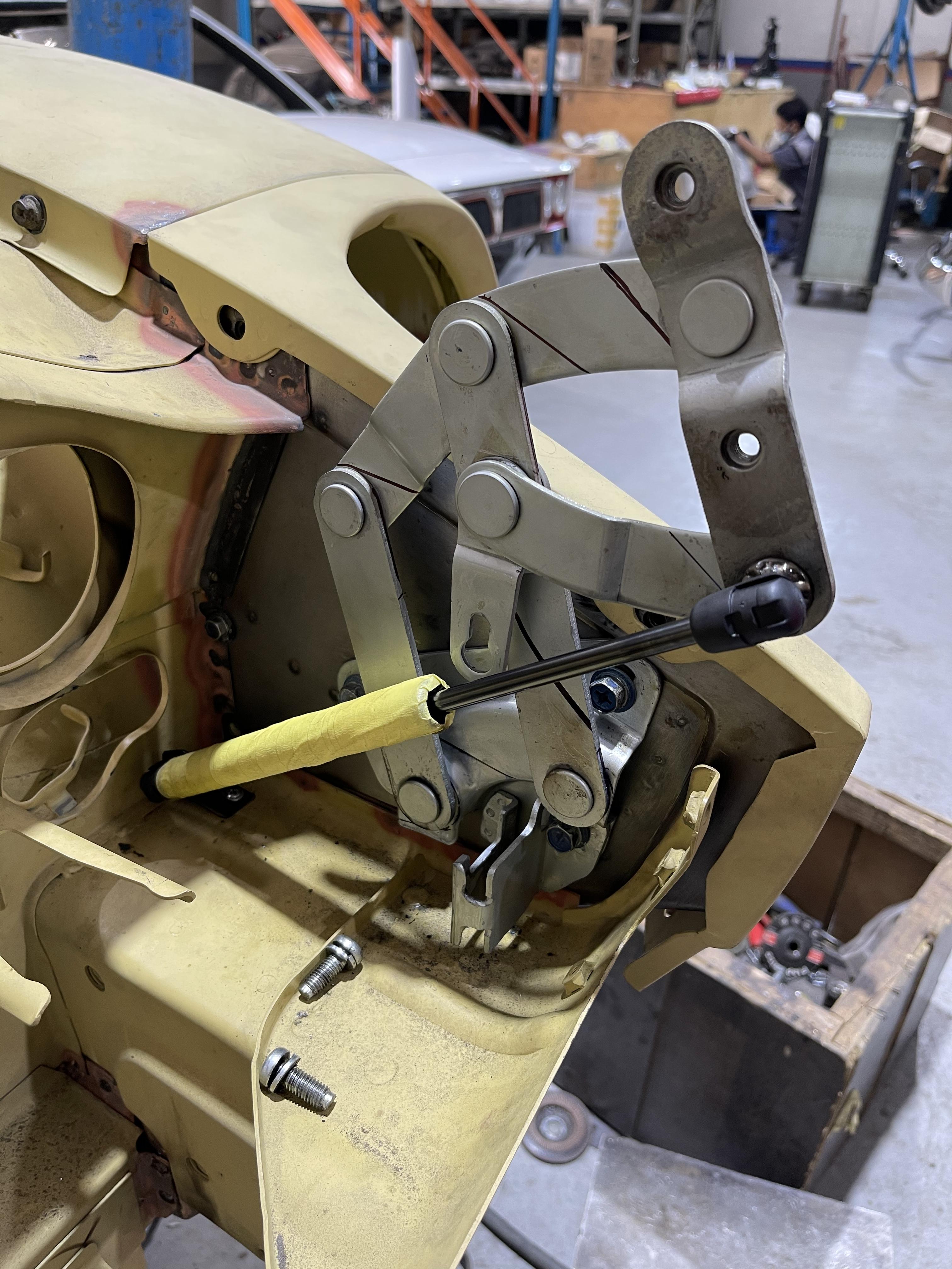

Inspired again by @grannyknot and @wheee! I added the hood gas strut, so much slicker than the big spring bar crossing and visible behind the front grille.
Photo 03-02-2021, 12 15 33 PM.jpgPhoto 03-02-2021, 12 20 10 PM.jpgPhoto 03-02-2021, 12 19 49 PM.jpgPhoto 03-02-2021, 12 19 38 PM.jpg

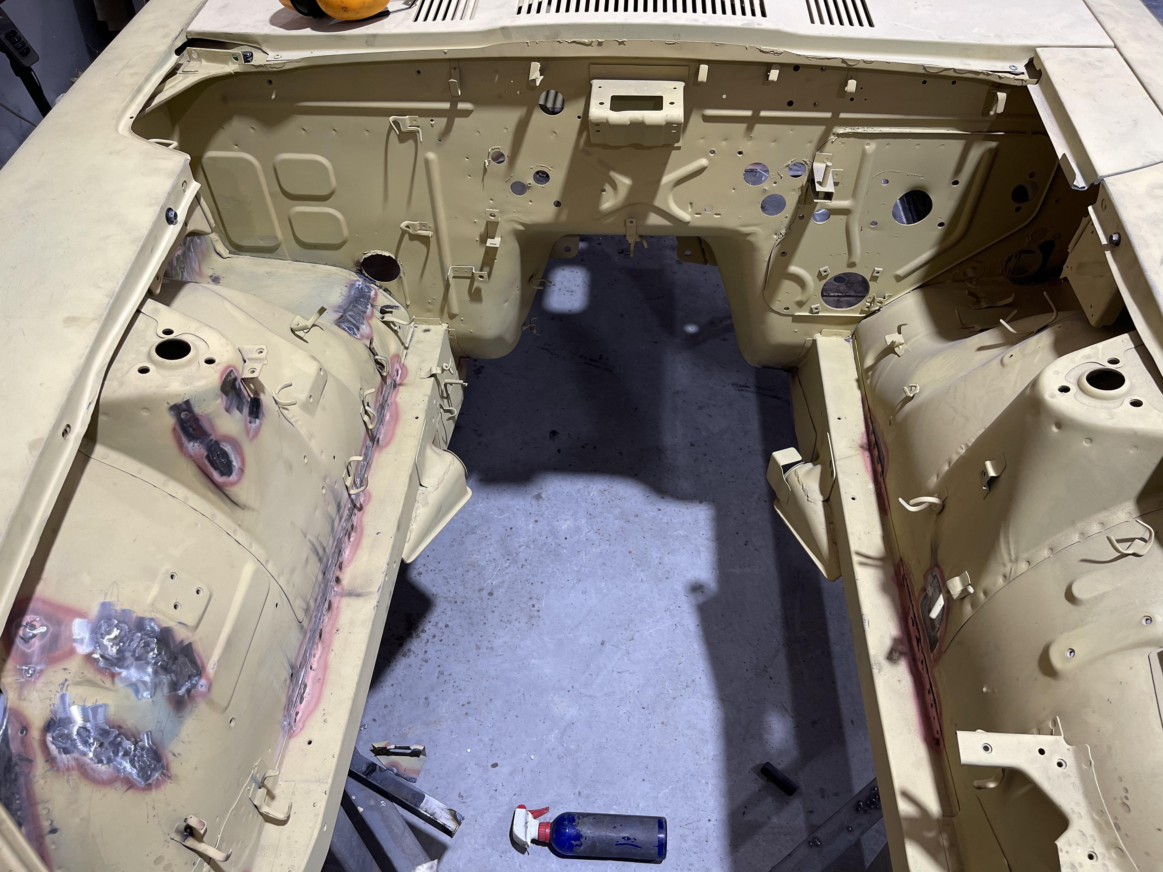

And we are now doing some cleanup in the engine bay, as battery is relocated, and the air intake and manifold are replaced by ITBs, we can get rid of a lot of useless stuff 😅 Next step starting on Saturday is denting and panels adjustment with the new weatherstrip, should take the week or so, before painting prep to start ! My excitement is through the roof !

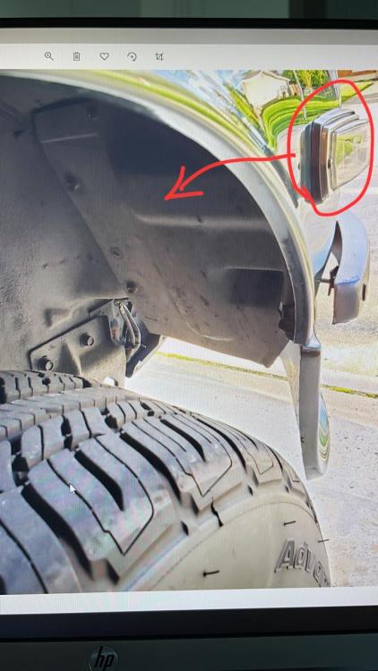

Open question regarding the front side markers, as I deleted them from the fenders to have smoother body lines, I am thinking about putting them in the wheel wells, see below:
No need to extend cables, just some plastic cutting actually...

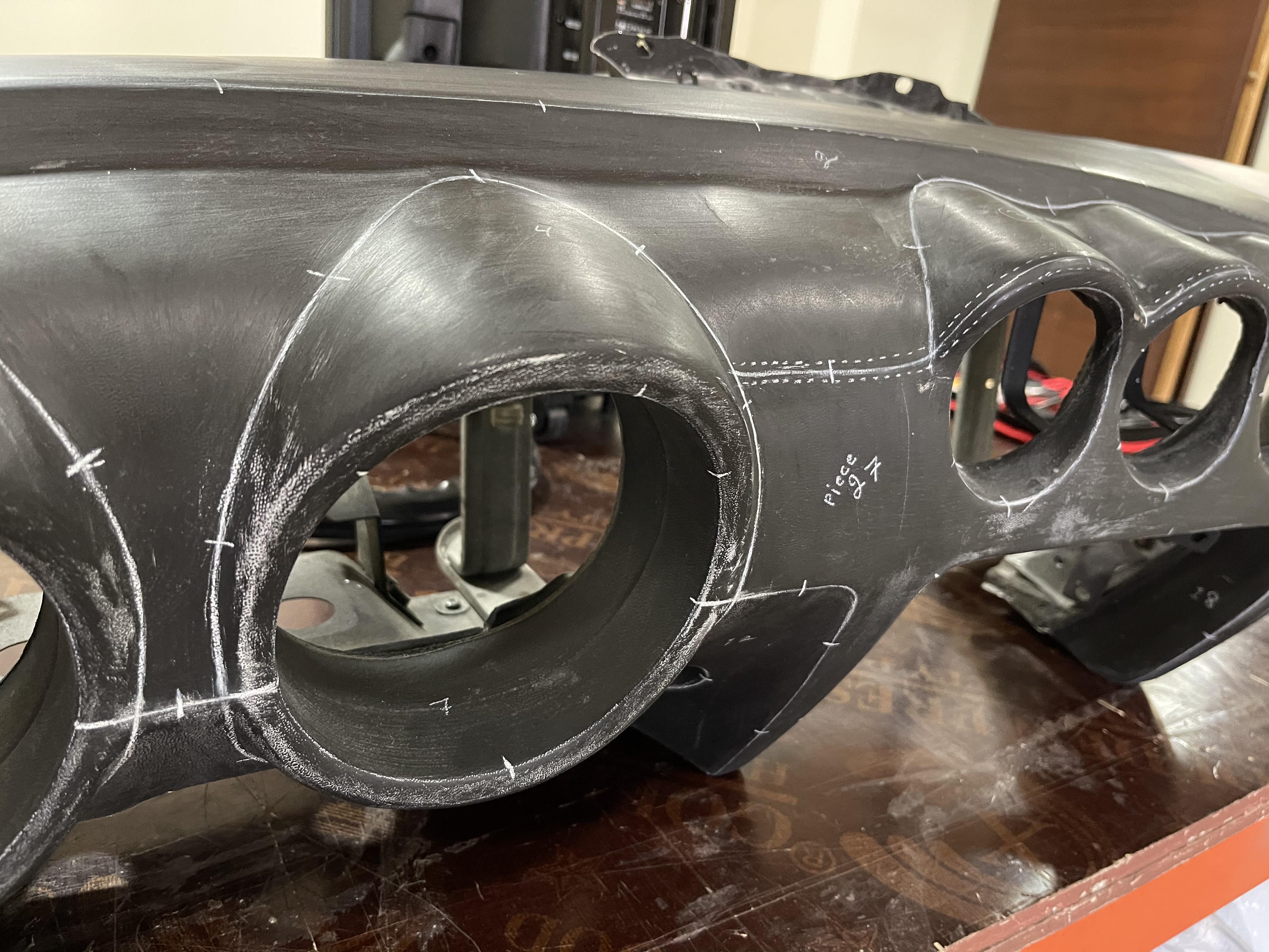

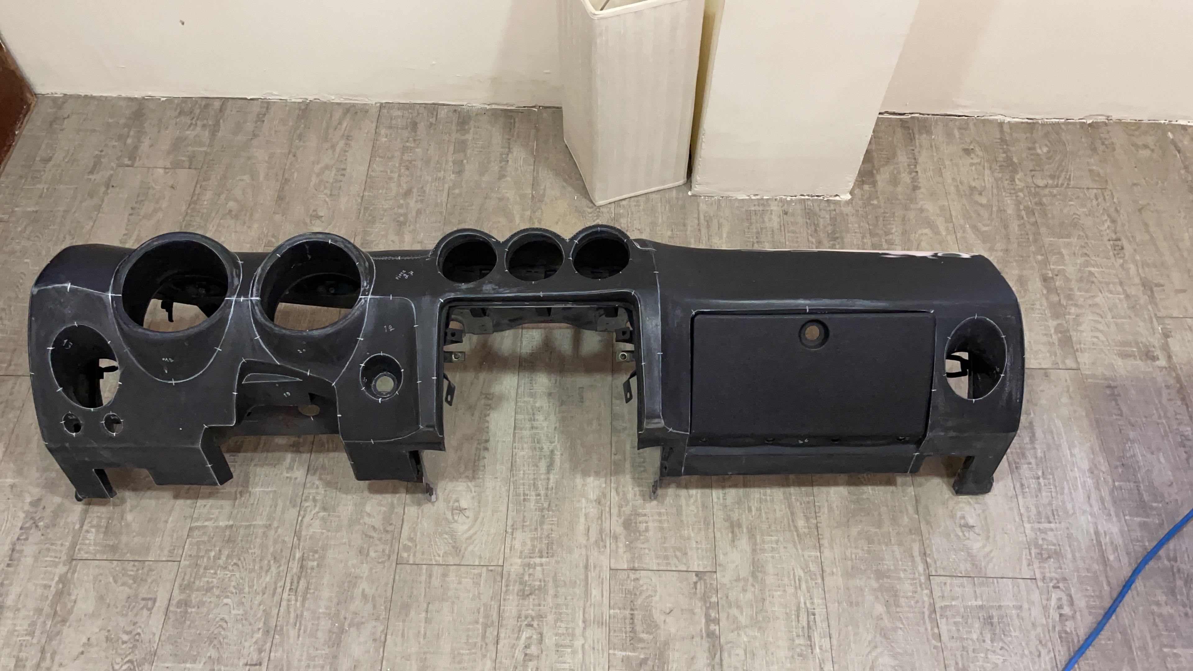

Finally some work started on the dashboard, marking is done and the alcantara is being cut (29 pieces in total):
