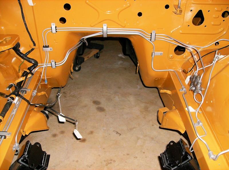

I don't know for the early z's but later 70's datsuns had olive green brakelines for sure!  Last year i restored a 280zx (1979) and it has still the original olive green brakelines
Here a pic taken from the internet (from this site!) ðŸ˜Š
De bronafbeelding bekijken

I am leaning toward the Japanese Imperial Army green as being the correct color. None of the several Z cars I have owned and / or dismantled over the years has shown evidence of yellow zinc or cadmium plating.
The color is the same as the seat slider mechanisms. I've never seen or heard a definitively sourced statement as to what is actually correct.

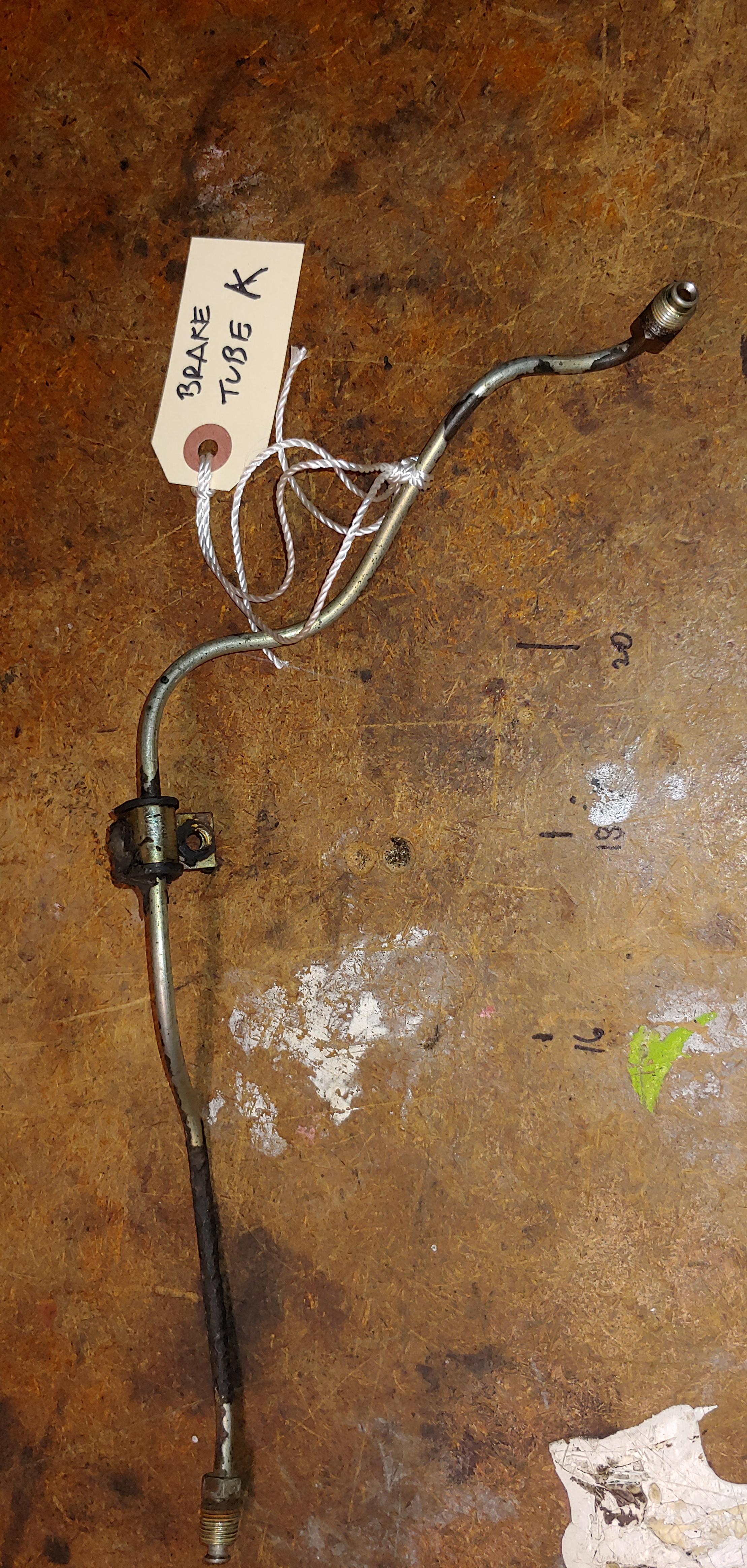

There were no traces of green paint on any of my lines when I stripped my car some years ago, but there was lots of evidence of yellow plating as it was flaking off.

I was on a strict budget for my restomod years ago, no allowance for getting the lines plated. I thoroughly stripped them and painted in metallic silver topped with clear. - it worked out pretty well. Everything is still fresh and bright 10 years later.
I agree with @grannyknot and @jfa.series1 that the brake tubes originally were yellow cad or zinc plated. Here is a picture of one of the original tubes that I have recently removed from my 7/70 car. They were covered with under coating and as I scrape it off there is lots of evidence of yellow colored plating.
