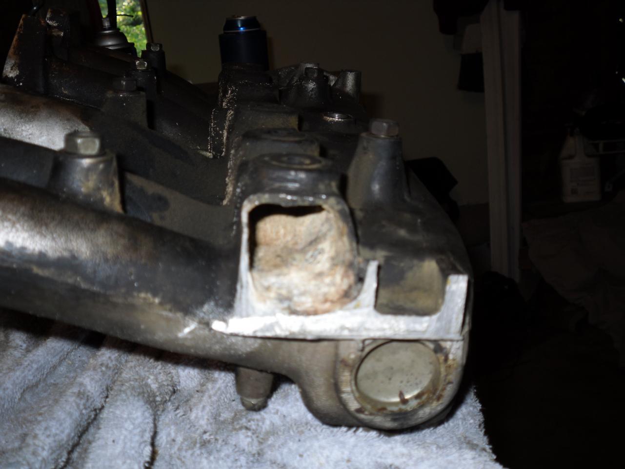

I had a rotted out egr tunnel on my '77. There was a recall and you should find a sticker under the hood on the passenger's side if it was done. Mine was not and caused a huge vacuum leak. I got the Z for $1,400. Put a N42 non egr intake on and it runs fine.
Here's my rotted out egr where it connected to the tunnel. I tried to sawz-all it off and have it welded up but my welder suggested a replacement. It was much cheaper than him building up that hole.
