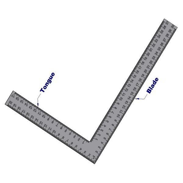

February 8, 20214 yr comment_615769 On 2/7/2021 at 4:26 PM, 280zdude said: Do I need to resurface the head I’ve read in forms people tell others to do When the head is off, you have to check if everything is strait as an arrow.. use a ruler and some feeler gauge.. (or shine a light under the ruler and look for light on the other side ) Reading about how it's done is always good.. Also many vid's on youtube about it. Link to comment https://www.classiczcars.com/forums/topic/64992-highest-compression-ratio-with-stock-fuel-injections/?&page=3#findComment-615769 Share on other sites More sharing options...
February 8, 20214 yr comment_615791 A framing square works good too. Long side against the bottom of the head. Link to comment https://www.classiczcars.com/forums/topic/64992-highest-compression-ratio-with-stock-fuel-injections/?&page=3#findComment-615791 Share on other sites More sharing options...
