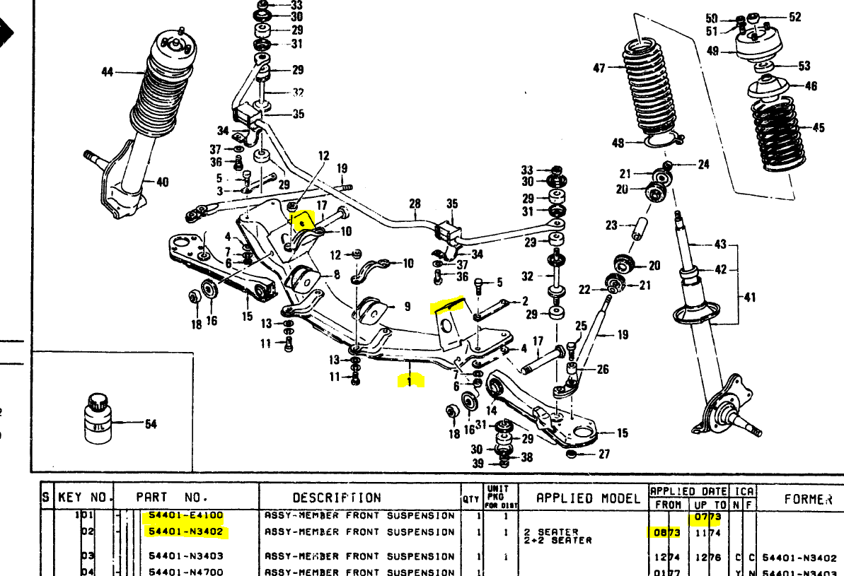

You need  2 of the11220s cantech shows above but only one tunnel mount 11320. You have 2 for quantity, am I missing something?
Just for clarity, I was trying to show that 11220-E4100 would be the correct prior to 08/73. And that 11220-E3300 is for 08/73 forward and is not backwards compatible.  @z8987 has a 1970 car show, so he would need to use the 11220-E4100 mount to avoid grinding the dowel pin (based on what I have read on this site). I just checked the parts book and can confirm that the front crossmember, which has the brackets that these mounts mate with, also shows a new part number also effective from 08/73. Strangely there is no mention of compatibility issues. It would be interesting to get measurements of the dowel pin location (center to center of mount hole to dowel pin hole) on the older and newer crossmembers.
Has anyone been able to purchase the 11220-E4100 mounts from Nissan, or do they now only have 11220-E3300 available?
If anybody is missing anything, it's me.  Thank you.
From this is does look like E4100.  Has anybody put these on a 70?  Which ones did you use ?

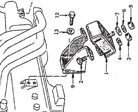

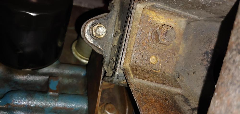

Here's a little more to add to the confusion. I'm starting to think that the 11220-E4100 mounts don't have the dowel pin. When I check my 7/70 car, I can't feel anything protruding thru the hole in the bracket on the crossmember. I will be pulling my engine, hopefully soon, and will report back.
Edit >>>> Looks like i was incorrect there definitely is a dowel pin, see the last pic where I loosened the mount and pried the mount up a little. The pin is short but it is there.
Here is an image from the JDM parts book of 11220-E4100 and It doesn't seem to show a dowel pin.

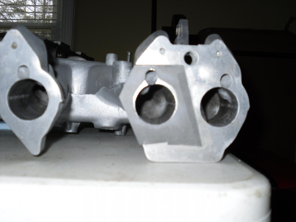

I'll say plus one one the manifold port matching. Get some gasket paper and tap out the holes, transfer with a scribe and open them up to match. I did a bugle type flow with mine. When the head flows more you can get a bigger, 2.5" exhaust for me, to get all that incoming to outgoing flow. Breathe better is what you want.
