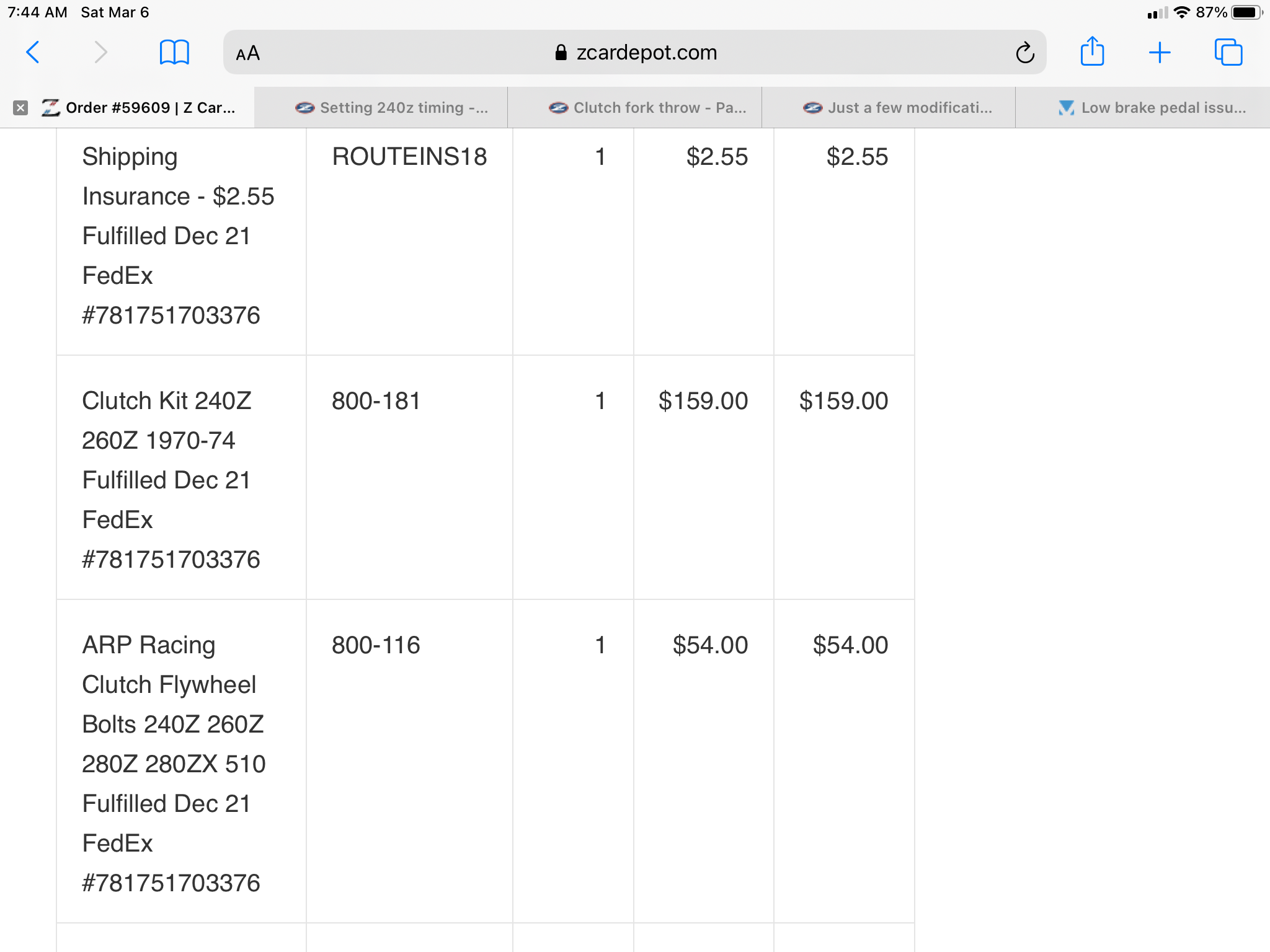

I have installed the following parts and 100 miles in everything is working well, I have the shortest collar that goes with the “Type A” 4 speed

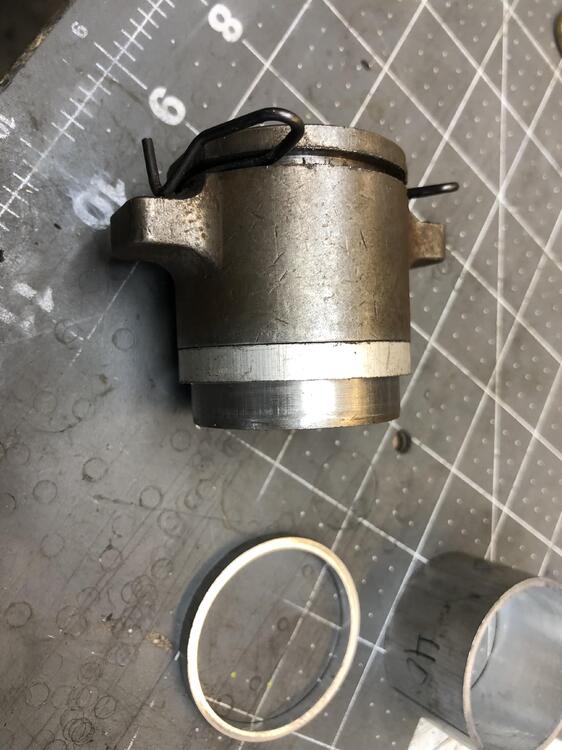

Working on another engine the other day, assembling a new transmission to the engine, and I checked the throwout bearing collar tab height off the flywheel face to see how close it was to the 92mm ideal. Clutch was working fine when we took it apart. It was short by a good 10-12mm!!!
Ok, so I go to the well as it were to look for a longer collar to get it closer to the ideal and low and behold, mother Hubbard’s cupboard is bare. Of longer collars at least. So what’s a guy to do?
I’ve been dreaming of making adjustable length collars at some point so I never have to suffer this “no stock” indignity again, but haven’t quite gotten there yet, but I starred at the collar wondering how to make it longer. Cut it in half, machine and weld in a new ring of steel to lengthen it? Sure, I have all day to play that game, not….
Then an idea struck me. I wonder…..

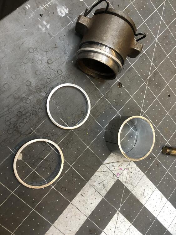

I could just make a few spacers and put them underneath the throw out and gain a bit of length.
The mounting collar is 14mm high, the bearings are a bit thicker, all the force is on-axis, I bet I could space that bearing out by 6mm (1/4”) and not cause any problems. So.
Off the lathe I go. I have some 1.75 OD / 1.5” ID aluminum pipe, need to turn the inside to 40mm ID. The OD is perfect at 1.75mm (45mm)
Edited by zKars
Got the 4mm thickness ring in there now, bearing pressed on just fine. engines in the car, we’ll see how it goes.
