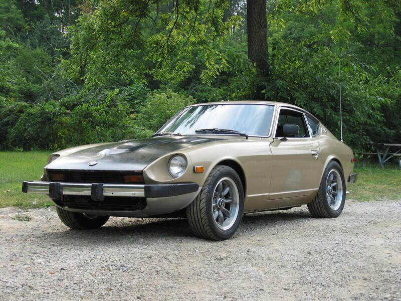

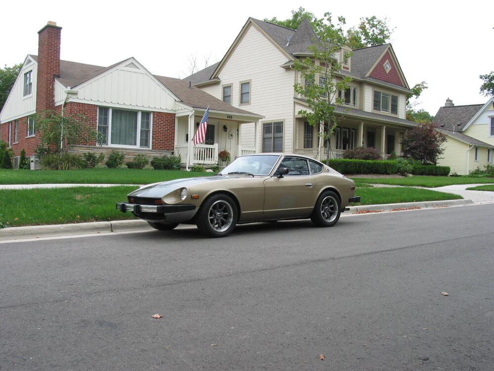

Can you post a few pics on the car?  I'm curious to see how they look compared to the 225/50R16.  That's what I run and I want to drop to 225/45R16 the next time I buy tires.
Sure! This is the car as it sits on the 225/45/16s. It's also sitting in Eibach progressive springs, so that is supposed to lower the stance about 1". I don't think I'd have room if I went to the 225/50/16 as I don't have flares.
Hope this helps!
P.S. The second picture is an older one--you'll notice that the rear hatch vent covers weren't installed! ;-D
Edited by z boy mn
I like it!  I think the 45 aspect ratio tires look better and should fit better than the 50 series.  Mine rub a bit still in the front, but I trimmed and rolled the rear quarters to fit the tires.  Mine is lowered about 1" using Tokico springs.
Hope this helps!
Any rubbing or scrubbing in that size tire? Are your wheels 16x7; 0 offset?
