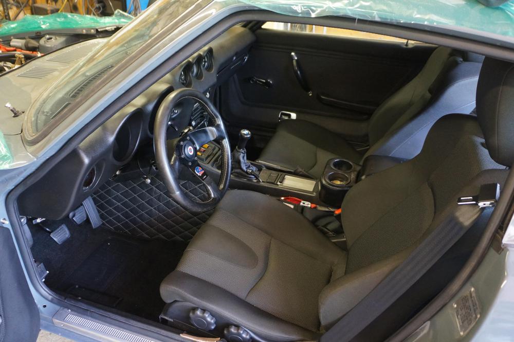

February 4, 20214 yr comment_615561 There is no section that just deals with interior mods that I am aware of but changing the seats out for something more comfortable or with better bolsters is not uncommon. This Hybridz thread has some ideas, https://forums.hybridz.org/topic/88301-seat-swap-list-for-s30s/ Most guys have it as part of their build thread, popular seat swaps include early Miata seats, Honda Integra seats, BMW e30 seats, Mazda RX8 seats, I put 350Z seats in my car and they are great but in all cases you have to fabricate the adapters to mount them. Link to comment https://www.classiczcars.com/forums/topic/65023-looking-for-threads-about-seat-upgrades/#findComment-615561 Share on other sites More sharing options...
