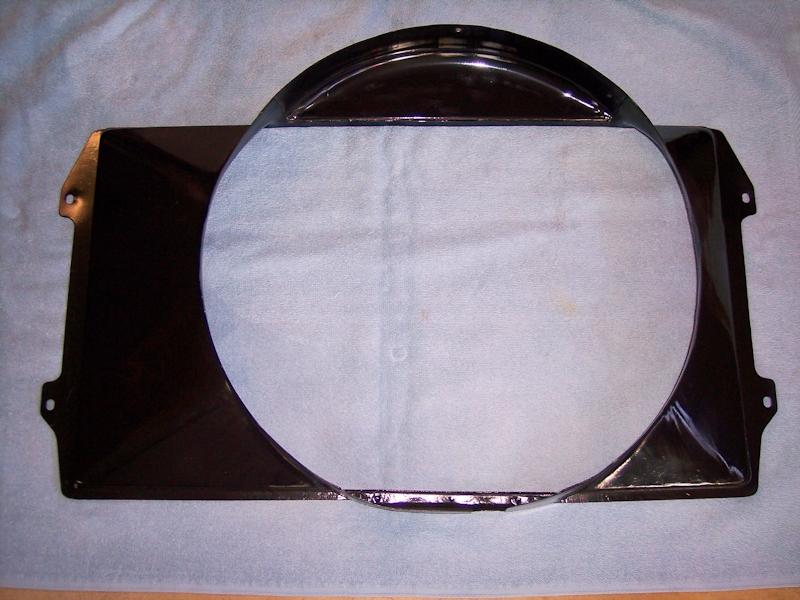

Posted February 10, 20214 yr comment_615876 I have a question concerning the metal radiator fan shroud. It is my understanding that the full metal shroud was added to a 240z when the dealer added optional Air Conditioning. True or untrue...? If true, was the small metal fan guard removed from the top tank of the radiator or was it left on...or was a different radiator fitted altogether...? Thanks for any insight...Ryals Link to comment https://www.classiczcars.com/forums/topic/65045-radiator-fan-shroud/ Share on other sites More sharing options...
February 10, 20214 yr comment_615878 1 hour ago, Tirnipgreen said: I have a question concerning the metal radiator fan shroud. It is my understanding that the full metal shroud was added to a 240z when the dealer added optional Air Conditioning. True or untrue...? If true, was the small metal fan guard removed from the top tank of the radiator or was it left on...or was a different radiator fitted altogether...? Thanks for any insight...Ryals Not True - If the customer wanted it, or if the Service Dept suggested it be added with the A/C Kit - the shroud had to be ordered via the Parts Dept. individually. Yes, you had to remove the finger guard to install the shroud. Link to comment https://www.classiczcars.com/forums/topic/65045-radiator-fan-shroud/#findComment-615878 Share on other sites More sharing options...
February 10, 20214 yr comment_615880 Hah, I knew that pic was familiar - that is a shroud I refurbished and sold about four years ago. As I recall it went to guy in the Philippines. The towel under the piece was the giveaway. Link to comment https://www.classiczcars.com/forums/topic/65045-radiator-fan-shroud/#findComment-615880 Share on other sites More sharing options...

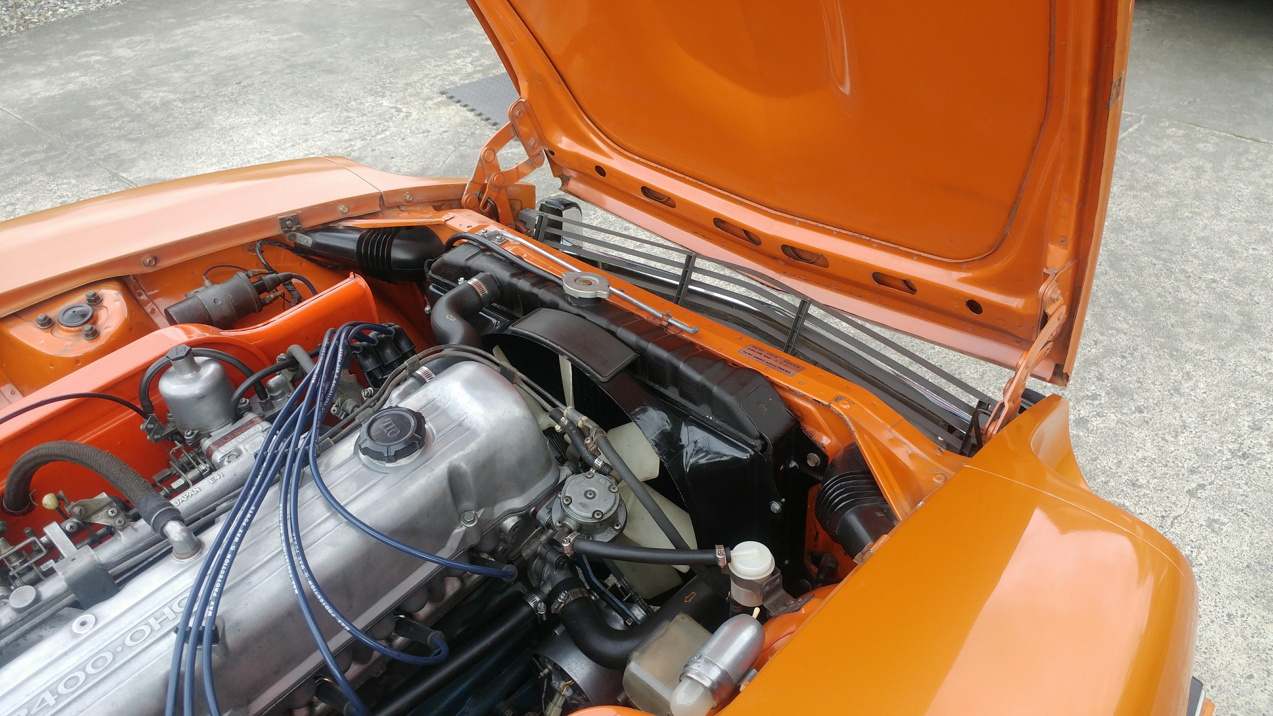

February 10, 20214 yr comment_615888 If the radiator is out you can hang the shroud over the fan and then install the rad with the hand guard in place. Here is a picture of my 7/70 car with the same shroud. Edited February 10, 20214 yr by CanTechZ Link to comment https://www.classiczcars.com/forums/topic/65045-radiator-fan-shroud/#findComment-615888 Share on other sites More sharing options...

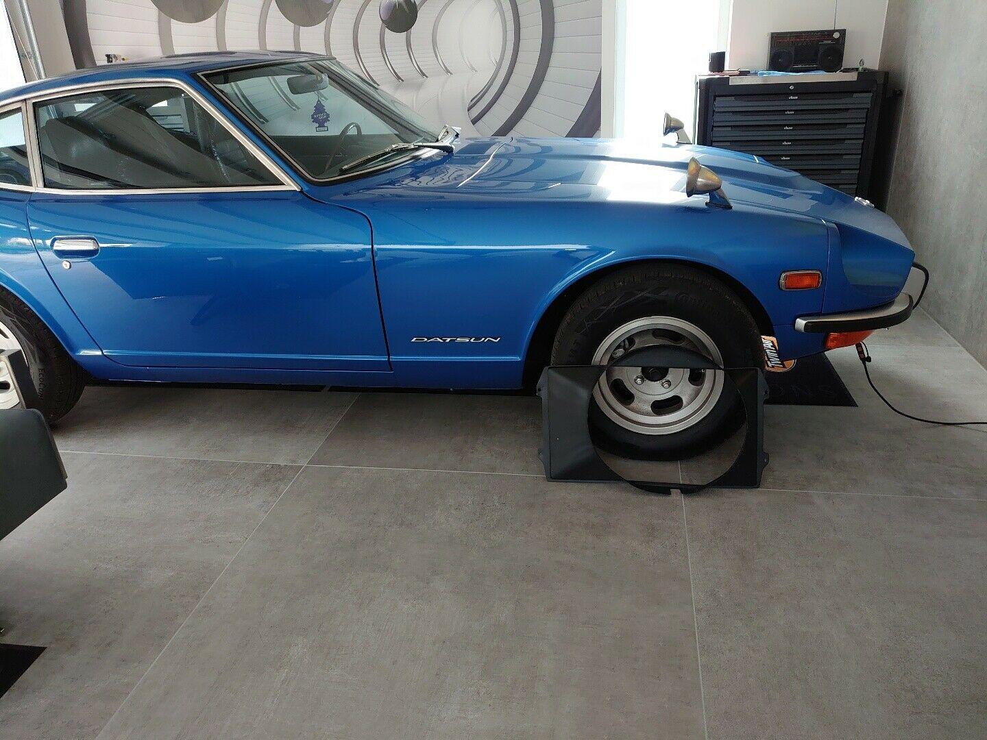

February 10, 20214 yr comment_615892 The metal fan shrouds are tough to come by nowadays. I've owned several of them over the years. Last summer I sold one on eBay to a 240Z owner in Austria named Josef. It took about a month to get there via USPS and the shipping cost to the buyer was only about $80.00 including insurance. The quotes from FedEx and UPS were about 3 times the cost of USPS. He sent me this picture of the fan shroud next to the front wheel of the car. Link to comment https://www.classiczcars.com/forums/topic/65045-radiator-fan-shroud/#findComment-615892 Share on other sites More sharing options...
