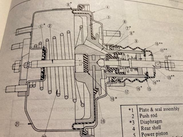

Must be nobody looking because this is - first! - a classic sign of a missing reaction disc.  A rubber disc between the rod and the booster surface that sometimes falls out and ends up in the bottom of the booster.
Search "reaction disc" and you'll find a bunch.
I agree with Zed Head, Reaction disc. Happens a lot and had to tell if you are not looking out for it.
Most gue them back on to the push rod piece. The manual says to use grease, but I didn't think that would hold as well. spacer.pngspacer.pngspacer.png

Yes #18 it sits in the pocket normally but when pulled out even just enough it can fall off and ends up in the bottom of the booster.
Hard to get out with the booster still mounted in the car. Usually have to pull the booster and shake it around until you can grab the little sucker.

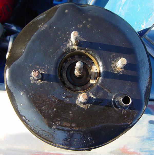

In the 240Z booster there would be a lock washer type plate as seen in the pic here, down in the plunger hole. (not shown in book diagram)
Then the three pieces in my first picture above a disc with the rubber seal (#1), the plunger itself (#2) and the reaction disc (#18)

I pulled the booster out. Mine doesn't look like the factory pic. I don't see a plunger with a rubber disc on the end. The rod is attached to a large disc and it is captured by the spring, won't pull out.
I don't see or hear anything rattling around.
That does look strange, Where did you get the Booster?
Was there a lock washer and seal disc in there? It looks like scrape marks where the lock washer was pulled out.
It almost looks like the spring is in backwards. If you look at my third picture above the spring gets larger toward the back.
Yours looks to me like it gets smaller in the back thus blocking the plunger.
The rod should be attached to the plunger piece and the reaction disc is on the back side of that. They usually come right out with no interference from the spring.
