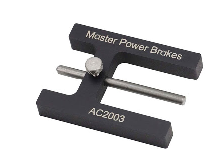

February 13, 20214 yr comment_616044 Somebody on the forum used one of these depth setting tools. They're pretty simple and you get it right the first time. You could probably make your own. https://techtalk.mpbrakes.com/power-brake-booster-depth-gauge-tool Link to comment https://www.classiczcars.com/forums/topic/65048-new-booster-now-sticky-brakes/?&page=2#findComment-616044 Share on other sites More sharing options...
February 13, 20214 yr comment_616063 Conedoger I believe... Link to comment https://www.classiczcars.com/forums/topic/65048-new-booster-now-sticky-brakes/?&page=2#findComment-616063 Share on other sites More sharing options...
