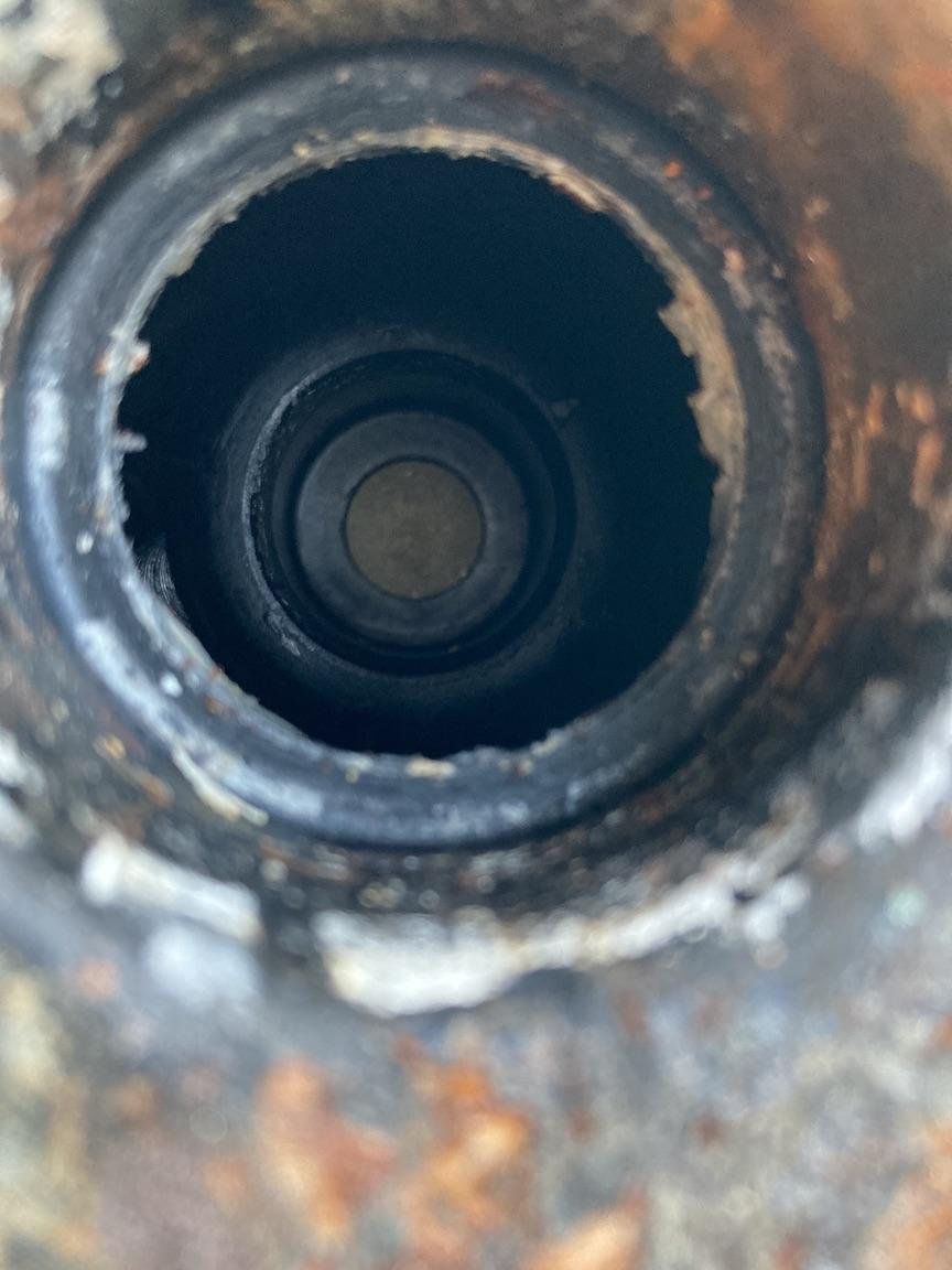

February 17, 20214 yr Author comment_616265 I did not, but the activating rod does not come out through the hole. Link to comment https://www.classiczcars.com/forums/topic/65048-new-booster-now-sticky-brakes/?&page=3#findComment-616265 Share on other sites More sharing options...

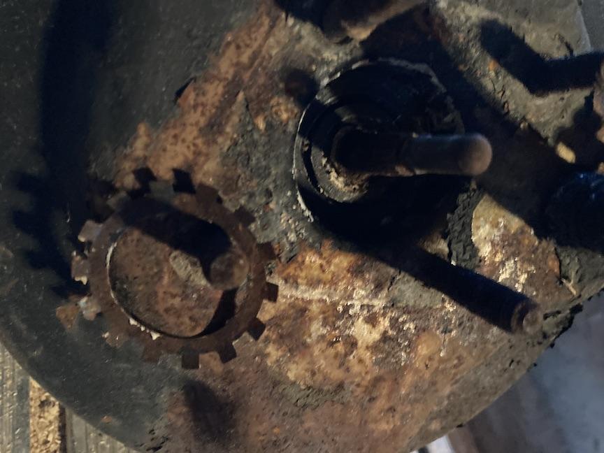

February 17, 20214 yr comment_616267 I am not sure what kind of booster you get from AZ. It does not sound like the correct unit. Perhaps the people that rebuild them are not that good? I can easily remove the lock washer with a small pic. Then easily pull the push rod out. (Mine also had no reaction disc) I have never uploaded a movie here so excuse me if it does not work. I can not see the spring at all in the hole. I can feel it in there, but it is stationary and does not move around at all. Disc Out.mov Edited February 17, 20214 yr by Terrapin Z Not sure about the Movie working text Link to comment https://www.classiczcars.com/forums/topic/65048-new-booster-now-sticky-brakes/?&page=3#findComment-616267 Share on other sites More sharing options...
February 17, 20214 yr Author comment_616268 I am REALLY regretting turning in my original core. Link to comment https://www.classiczcars.com/forums/topic/65048-new-booster-now-sticky-brakes/?&page=3#findComment-616268 Share on other sites More sharing options...

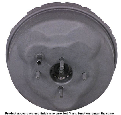

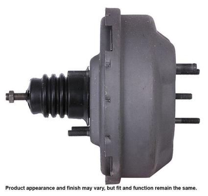

February 17, 20214 yr comment_616271 What brand is it? Give more details. Cardone is the big reman company. Here is Rockauto's picture of a Cardone booster. Link to comment https://www.classiczcars.com/forums/topic/65048-new-booster-now-sticky-brakes/?&page=3#findComment-616271 Share on other sites More sharing options...
February 17, 20214 yr comment_616272 I'll sell you this core in the pic's (it will need a reaction disc, I shook it but did not hear anything. I may have used it in my Booster I bought from MSA. (also had no disc) been a while now. Then send it to these guys. ( I saw this on FB just now, but it is on OfferUp) They have good reviews. https://offerup.com/item/detail/1070491908/?_branch_match_id=857945268714343482 Or I am sure there are other reputable Datsun booster rebuilders. I would stay away from the chain car parts stores though. IMHO Link to comment https://www.classiczcars.com/forums/topic/65048-new-booster-now-sticky-brakes/?&page=3#findComment-616272 Share on other sites More sharing options...

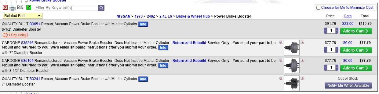

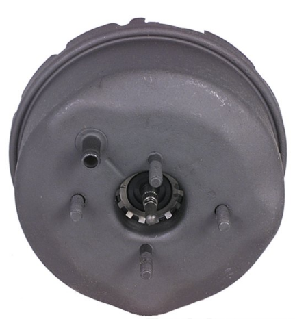

February 17, 20214 yr comment_616273 Here's what Autozone shows for a 73 240Z. And it is weird that the rod is set deep in the booster. AZ might be using the wrong database. https://www.autozone.com/brakes-and-traction-control/brake-power-booster/duralast-remanufactured-brake-power-booster-53-5104/44461_0_0 Link to comment https://www.classiczcars.com/forums/topic/65048-new-booster-now-sticky-brakes/?&page=3#findComment-616273 Share on other sites More sharing options...
February 17, 20214 yr Author comment_616274 According to the receipt it is a Cardone 53-5104. It doesn’t look remanufactured, but rather a newly made piece. I also noticed that the Rockauto piece is not listed as Cardone. I would be interesting in knowing if anyone who has installed a Cardone booster in their car has experienced this problem, and if they have looked inside it to find that the activating rod is built like mine is, in my earlier pictures. I can’t drive the car (too much snow!) but based on the little I can move it in the garage it feels the same. As soon as I can drive it out onto the driveway I am going to mess a little with adjustments. Maybe I’ll see a change that gives me some idea. terrapin, I’ll buy your booster, if only to have a fall-back plan in case i can’t find an aftermarket booster that works. DM or email me please. Edited February 17, 20214 yr by Trimpe.bob@gmail.com Link to comment https://www.classiczcars.com/forums/topic/65048-new-booster-now-sticky-brakes/?&page=3#findComment-616274 Share on other sites More sharing options...
February 17, 20214 yr comment_616279 1 hour ago, Trimpe.bob@gmail.com said: terrapin, I’ll buy your booster, if only to have a fall-back plan in case i can’t find an aftermarket booster that works. DM or email me please. PM sent Link to comment https://www.classiczcars.com/forums/topic/65048-new-booster-now-sticky-brakes/?&page=3#findComment-616279 Share on other sites More sharing options...
February 17, 20214 yr comment_616281 1 hour ago, Trimpe.bob@gmail.com said: According to the receipt it is a Cardone 53-5104. It doesn’t look remanufactured, but rather a newly made piece. I also noticed that the Rockauto piece is not listed as Cardone. Not sure what you're looking at. This is for a 1973 240Z right? I had to go look at some of your other posts, you never said in this one. The Autozone part number you gave is there on Rockauto. That's why this seems extra weird. But it does show the smaller shape, which is what the AZ picture shows. Funny to learn though that Duralast = Cardone, for these reman parts. https://www.rockauto.com/en/catalog/nissan,1973,240z,2.4l+l6,1209170,brake+&+wheel+hub,power+brake+booster,1884 Link to comment https://www.classiczcars.com/forums/topic/65048-new-booster-now-sticky-brakes/?&page=3#findComment-616281 Share on other sites More sharing options...
