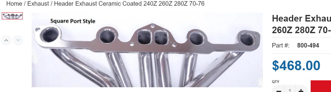

Those ZCD headers don't have matching ports.  Four round, two square.  You want the ports to match the exhaust ports on the heads.
Their website no longer shows that picture.  Can't believe anyone would produce a header with different shaped ports.  You'd have to go out of your way to do that.  So odd.
It's still there.  You have to hover over the picture, then see the little arrow things, then click on an arrow.  These web site designers get so clever that they make their own work useless.
Ahh, I see it now.   I've bought a few things from them lately, but nothing too complicated like a header apparently is 😉

Don’t think you can go wrong with the MSA header - it’s been the same design forever . Thick flange . NOT equal length , but that doesn’t amount to much as far as performance .  My MSA does a good job keeping heat in the header with the ceramic coat . I don’t like this mismatched port shapes either .

They hide the actual ports in their pictures.  Probably the same 4 round, 2 square header.  There's probably an offshore company making thousands of these for cheap, and people are just reselling them.
