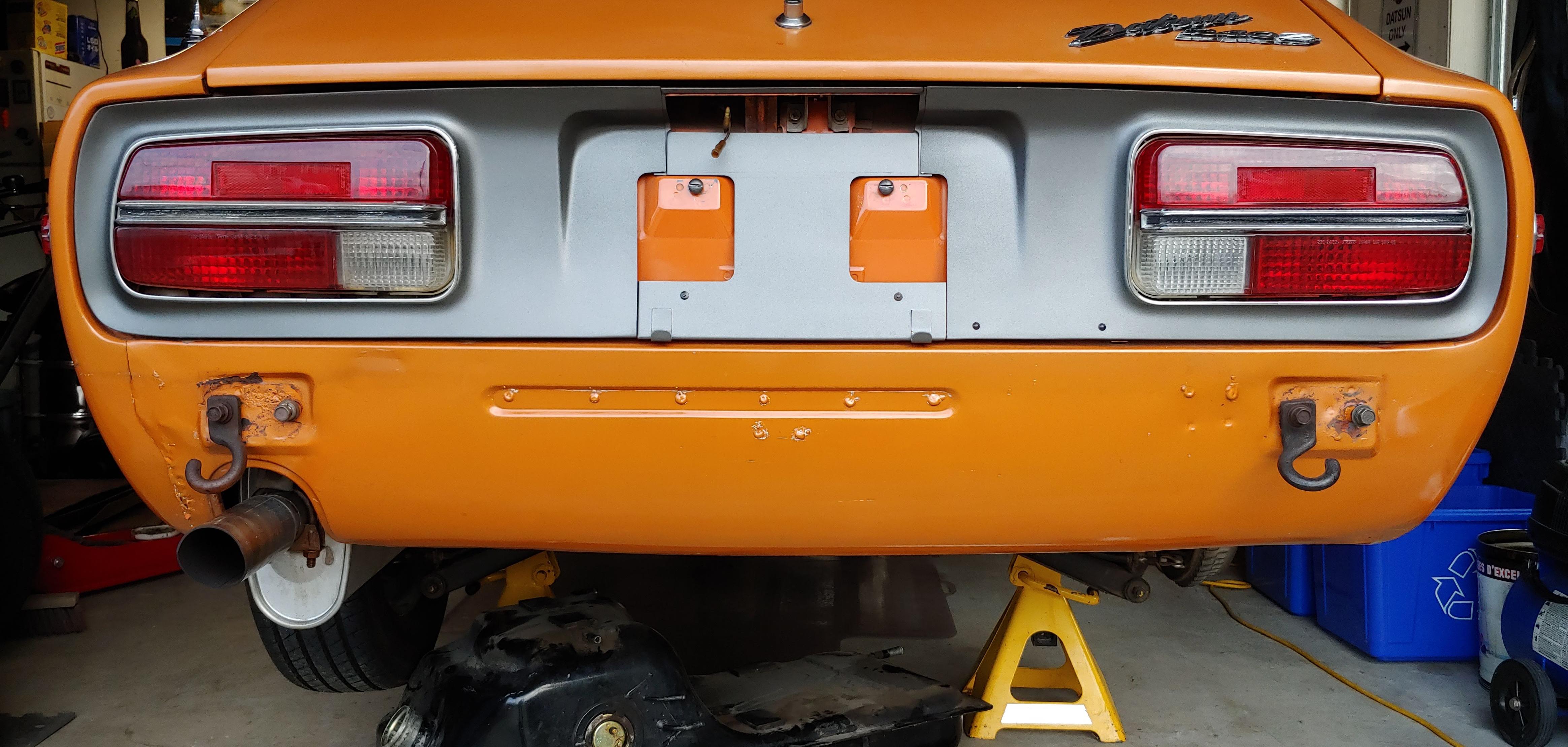

February 12, 20214 yr comment_616008 1 minute ago, AZ-240z said: Jim, are you sure that the center panel uses “hex-head bolts” behind the license plate.? I’ve alway used the same plastic rivets used to secure all of the finisher panels, for a total of eight. Dan I was just looking at that. It seems the early 240s may have used small bolts but my '72 has two smaller plastic rivets behind the tag and the normal sized ones on the hatch lip up top, not sure how many without walking downstairs and taking the cover off. This is @CanTechZ early car. you can see the threads I think. These are the rivets i bought for my '72. Link to comment https://www.classiczcars.com/forums/topic/65059-240-taillight-panel/#findComment-616008 Share on other sites More sharing options...

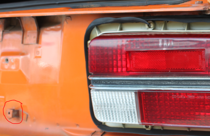

February 12, 20214 yr comment_616020 1 hour ago, siteunseen said: I was just looking at that. It seems the early 240s may have used small bolts but my '72 has two smaller plastic rivets behind the tag and the normal sized ones on the hatch lip up top, not sure how many without walking downstairs and taking the cover off. This is @CanTechZ early car. you can see the threads I think. My car (7/70) uses 8 of the small rivets, the last two go in the circled area below, no threads. Here are my finishers before I removed them. Link to comment https://www.classiczcars.com/forums/topic/65059-240-taillight-panel/#findComment-616020 Share on other sites More sharing options...

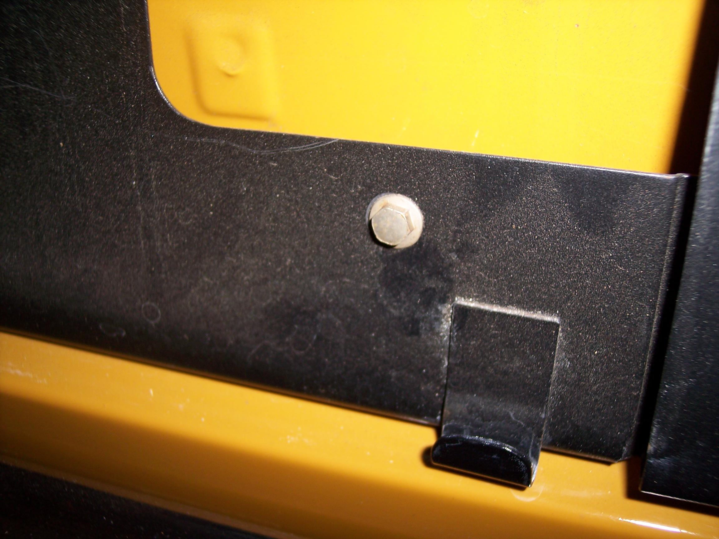

February 12, 20214 yr comment_616026 1 hour ago, AZ-240z said: Jim, are you sure that the center panel uses “hex-head bolts” behind the license plate.? I’ve alway used the same plastic rivets used to secure all of the finisher panels, for a total of eight. Dan Absolutely sure - at least on my car. It is a small flange hex-head sheet metal thread bolt, about 8mm head. These are original to my car. It is not listed in the online parts catalog, so the factory may have switched to rivets at some point, hence the spec for 8. Link to comment https://www.classiczcars.com/forums/topic/65059-240-taillight-panel/#findComment-616026 Share on other sites More sharing options...
