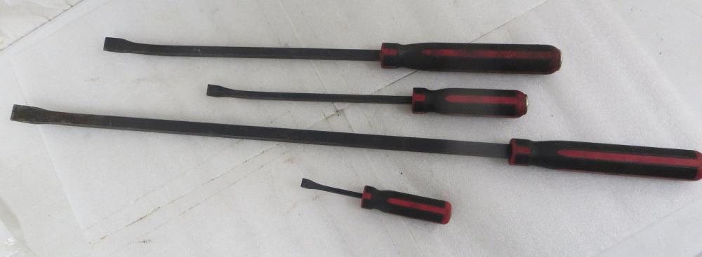

February 13, 20214 yr comment_616069 On 2/13/2021 at 3:29 PM, Wally said: its out of the car. air hose is about 15' long. Gonna Wait and see what SteveJ says but maybe i will go with an electric wrench like https://www.harborfreight.com/85-amp-corded-12-in-heavy-duty-extreme-torque-impact-wrench-64120.html Use a cheater bar on your breaker bar, put two flywheel bolts in the crank hub and use one of these (the big one) to hold the crank from turning: Link to comment https://www.classiczcars.com/forums/topic/65063-crankshaft-wrench-type/?&page=2#findComment-616069 Share on other sites More sharing options...

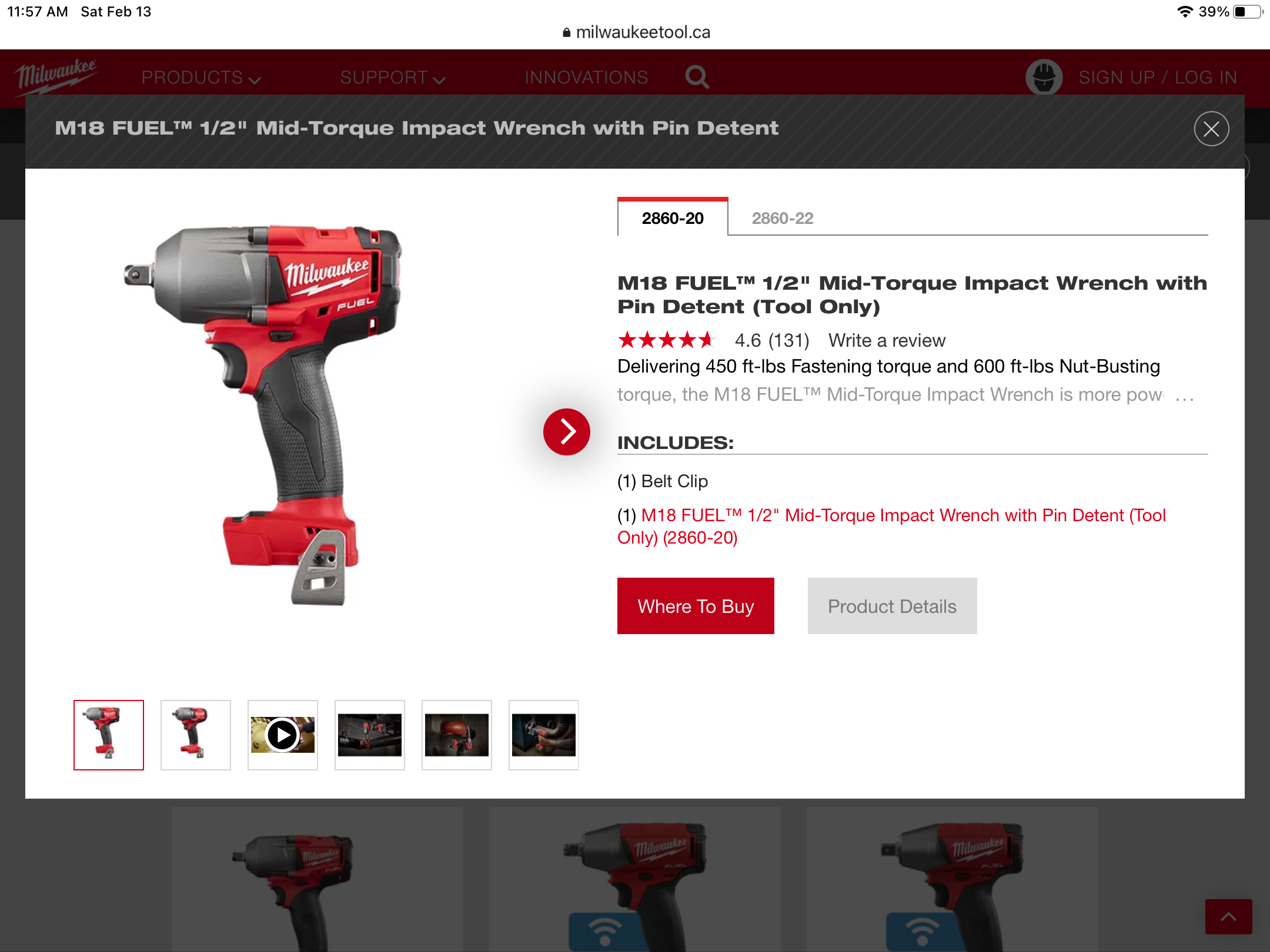

February 13, 20214 yr comment_616074 Bought a 1/2 Titanium Ingersol Rand air impact 10-12 years ago. Used it a couple of times, then discovered Milwaukee tools M18 cordless impacts. Haven’t touched it once since. Actually sold it last month And this is the mid-range model. There is a 1000 ft/lb one that’s only a bit bigger. The only air tools I use now is a air hammer that I use to get (most) spindle pins out with. Edited February 13, 20214 yr by zKars Link to comment https://www.classiczcars.com/forums/topic/65063-crankshaft-wrench-type/?&page=2#findComment-616074 Share on other sites More sharing options...

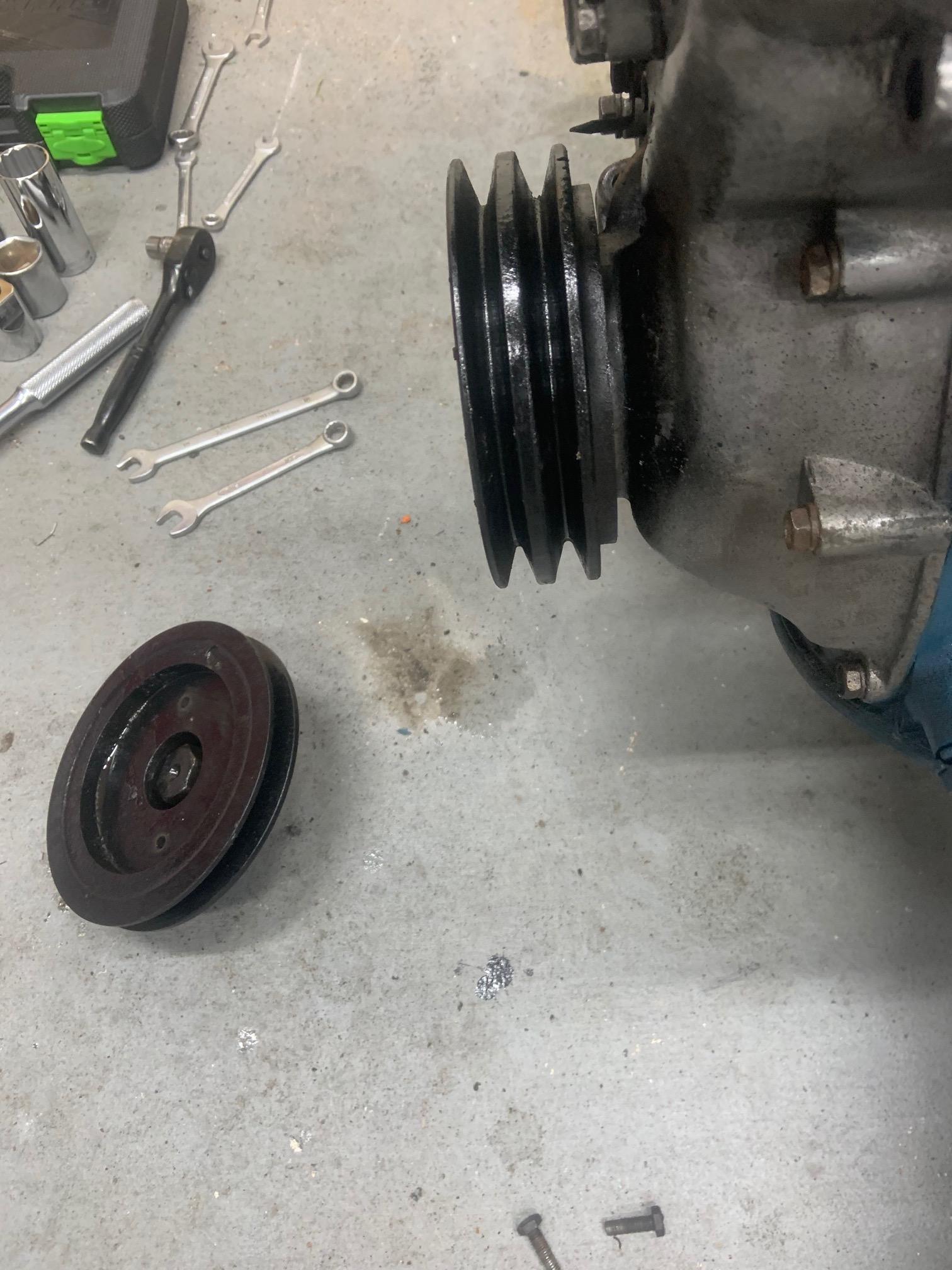

February 14, 20214 yr Author comment_616115 ok went and bought an electric impact wrench that said 1050ft/lbs which should be more than enough. I had a regular, non impact, socket, 1-1/16 that fit. i tried it and it blew apart. I have a 27mm impact like someone here recommended but it wont come close to fitting in the hole to even get to the nut. Is the 27mm the right size? Link to comment https://www.classiczcars.com/forums/topic/65063-crankshaft-wrench-type/?&page=2#findComment-616115 Share on other sites More sharing options...
February 14, 20214 yr comment_616116 Yes, 27mm fits the crank snout bolt on my 2 Zs. 1972 and a 1977. Link to comment https://www.classiczcars.com/forums/topic/65063-crankshaft-wrench-type/?&page=2#findComment-616116 Share on other sites More sharing options...
February 14, 20214 yr comment_616118 Post a picture of your pulley and what you're dealing with. You may have some classic PO work around. Link to comment https://www.classiczcars.com/forums/topic/65063-crankshaft-wrench-type/?&page=2#findComment-616118 Share on other sites More sharing options...
February 14, 20214 yr Author comment_616119 Yahtzee. its off. so you are right. it is 27mm. I got a 27mm "torque" style which apparently has thicker socket walls. Ran to Ace hardware and got a regular 27mm with the new impact wrench i just bought and it came off with no issue at all. Do the remaining pulley come off with the timing cover? or are they just compressed on and will come off now with some elbow grease. thanks guys Link to comment https://www.classiczcars.com/forums/topic/65063-crankshaft-wrench-type/?&page=2#findComment-616119 Share on other sites More sharing options...
