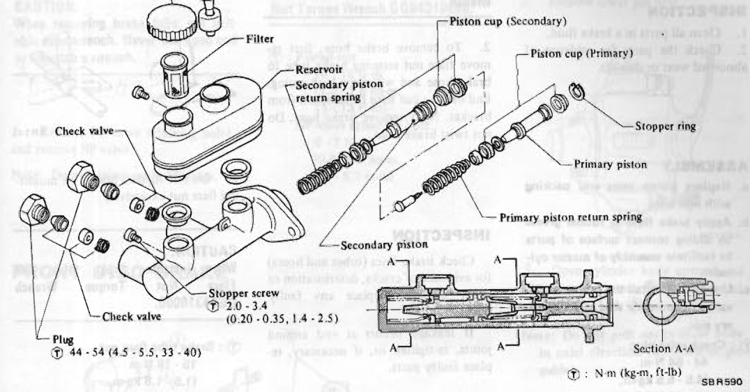

February 14, 20214 yr comment_616151 Is it cold there? I'll bet the seals in the MC hardened up and shrank in the cold. There are two seals to create pressure and and a seal at the back to keep the fluid in the MC. Your pressure seals have failed, I think. A heat gun might bring them back, who knows. That would be a sign. https://forecast.weather.gov/MapClick.php?lat=38.63839000000007&lon=-92.11855999999995#.YCm31WhKiM8 Edited February 14, 20214 yr by Zed Head Link to comment https://www.classiczcars.com/forums/topic/65067-troubleshooting-brakes-odd-situation/#findComment-616151 Share on other sites More sharing options...

February 15, 20214 yr comment_616154 2 hours ago, rogerwilcos said: I checked the brake fluid and it wasn't even up to the minimum line so I added some dot 3. I missed this part. Site was right, but I think he meant master cylinder. The missing fluid is probably in your brake booster. Your master cylinder has failed, maybe due to cold or just high miles or both. Easy fix. You should take the booster off too, and drain it and clean it out before the brake fluid ruins the diaphragm. Don't drip the fluid on your paint it will leave a stain. Link to comment https://www.classiczcars.com/forums/topic/65067-troubleshooting-brakes-odd-situation/#findComment-616154 Share on other sites More sharing options...
February 15, 20214 yr comment_616165 14 hours ago, rogerwilcos said: so I added some dot 3. I Why not dot4.0 ? it's better i always presumed.. And yes zedhead is right, your mastercylinder needs a overhaul.. clean out the mastervac, put after emptying some washing detergent in it and that will soften up the rubbers in it and clean it. Rinse and dry in the sun.. or.. another warm place. 😉 Link to comment https://www.classiczcars.com/forums/topic/65067-troubleshooting-brakes-odd-situation/#findComment-616165 Share on other sites More sharing options...
