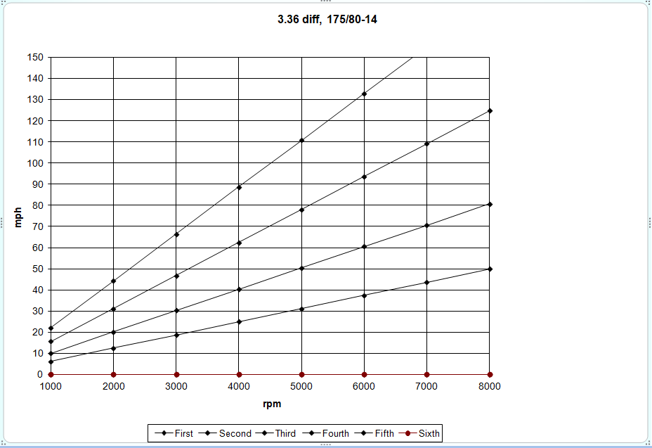

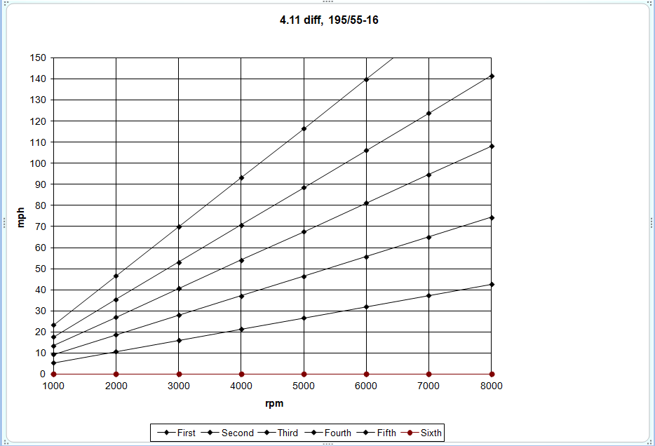

inline6 Posted March 21, 2021 Author Share #34 Posted March 21, 2021 (edited) A comparison of RPMs and speeds in gears between the US spec 4 speed, 3.36 and stock tire size vs. a 240SX 5 speed, 4.11 and 196/55-16 which will go on my car. This tire size is a bit small perhaps. But, I made a slight miscalculation before I bought them, and I am trying to keep the tire from rubbing at all on my stock sheet metal (and the car will have aftermarket springs which will lower it also). Besides the high RPM of the 4 speed for interstate travel, another thing I do not like about the 4 speed is the gap between 2nd and 3rd. Performance is decent in first and second, but then a noticeable lull when then shifted to third. Edited March 21, 2021 by inline6 Link to comment Share on other sites More sharing options...
