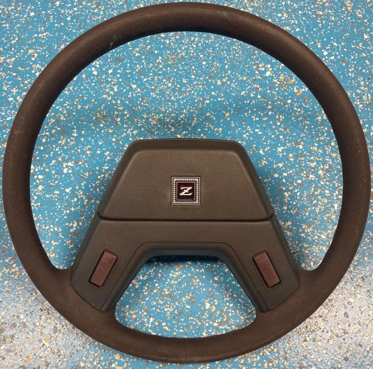

Good evening everyone, I think I have posted about this before but I am in need of help. A little background, my grandfather left my family around 20 cars or so but thanks to the neglect of my dad they have rotted in the warehouse. I am 18 years old and going off to college next year but have successfully restored a 1994 cobra from the same warehouse. I am based near Houston, Texas and want to make this car a drifting machine. I plan on engine swapping this car but I am unsure on where to start. I will include some pictures, I have started by removing the seats and other items from the interior. I want to remove the dash from the Datsun and have downloaded the manual and watched countless YouTube videos but I cannot remove the steering wheel housing from the car. I accidentally broke a steering wheel remover bolt on trying to remove this steering wheel, please let me know what you all think and if there is anyone based near the Houston area I can contact for further instruction, this would be much appreciated. Thank you for reading and I hope you all have a blessed night. - Reece
It is a bit tricky the first time you remove a ZX wheel.
Rule 1. There is a simple push-on cover over the upper half of the wheel, the one with the ZX logo. I guess its the horn button isn’t it? It just kinda of peels off of the center section.
This reveals the 22mm nut. Remove the nut (not quite all the way) the wiggle and pull (hard!) the wheel toward you until it comes off the splines. Done.
I just happen to have a tan wheel from an 81 turbo on a ZX I;m parting out that you can purchase to replace the one you “had a learning experience” on.
Send me a personal message.
Edited by zKars
2 hours ago, zKars said:
Alright sweet, I'll have another go at it tomorrow, thank you so much for replying, I might just have to purchase that wheel off you unless I find another online that I like. Thanks again! - reece
Use a puller ( a pully puller..) when you can't get it off..   NEVER HIT IT WITH A HAMMER YOU WILL DESTROY THE BEARINGS!!   (Like that dumb arse of a painter of mine.. (the first one..)  see my "restoration of a 280zx 2+2 1979 slick roof )  I'm still in need of a new bearing thanks to that unprofessional idiot..

42 minutes ago, Terrapin Z said:
Mine came off pretty easy. It is for sale if you are looking for another stock one.
Thank you very much, if I do end up going the stock route I will contact you 🙂

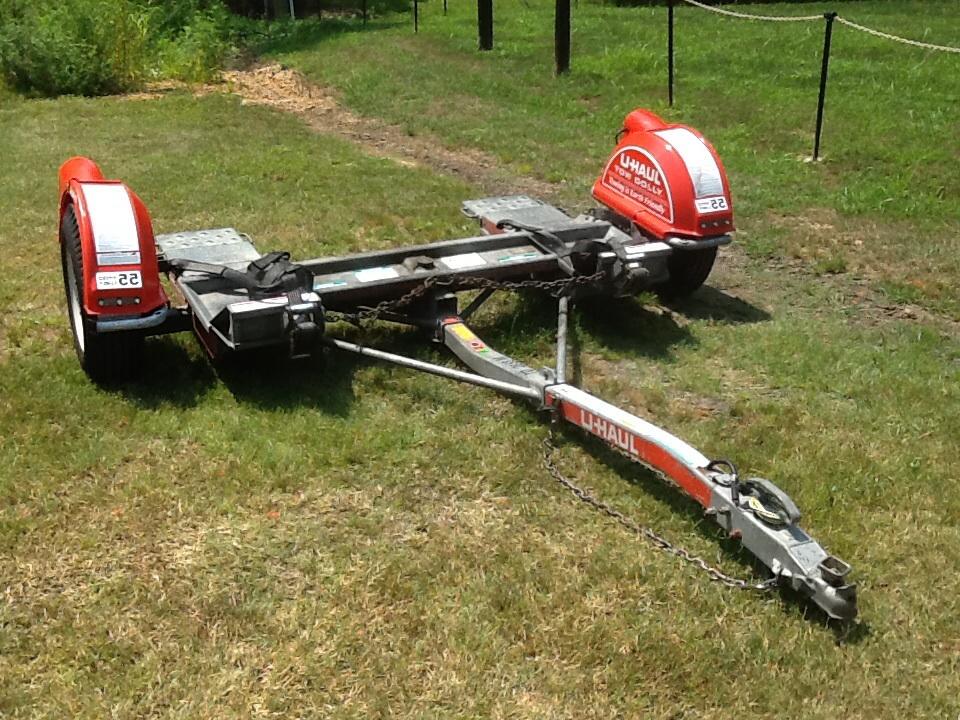

I did try this but to no avail I still was not able to get it off, I think I might just try and find someone near me that can help me with that.. Anyone know where I can get a dirt cheap trailer?
