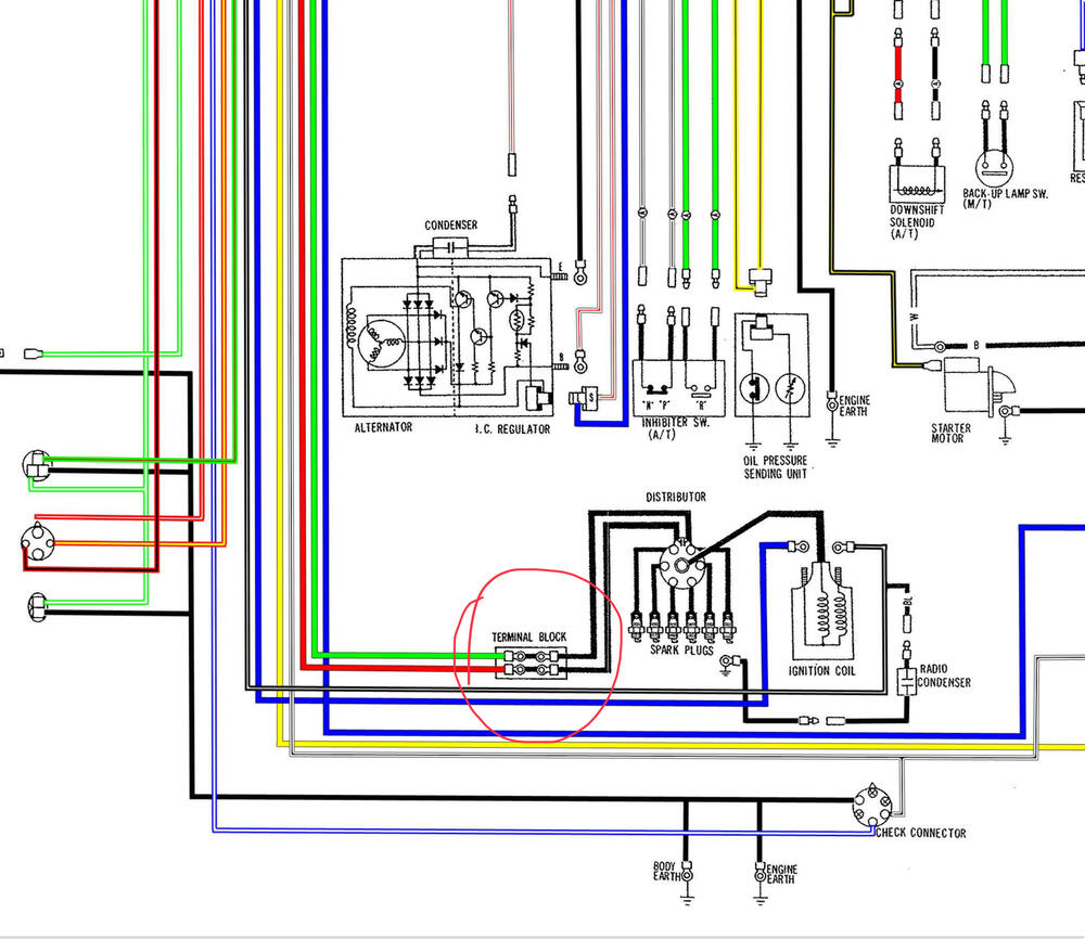

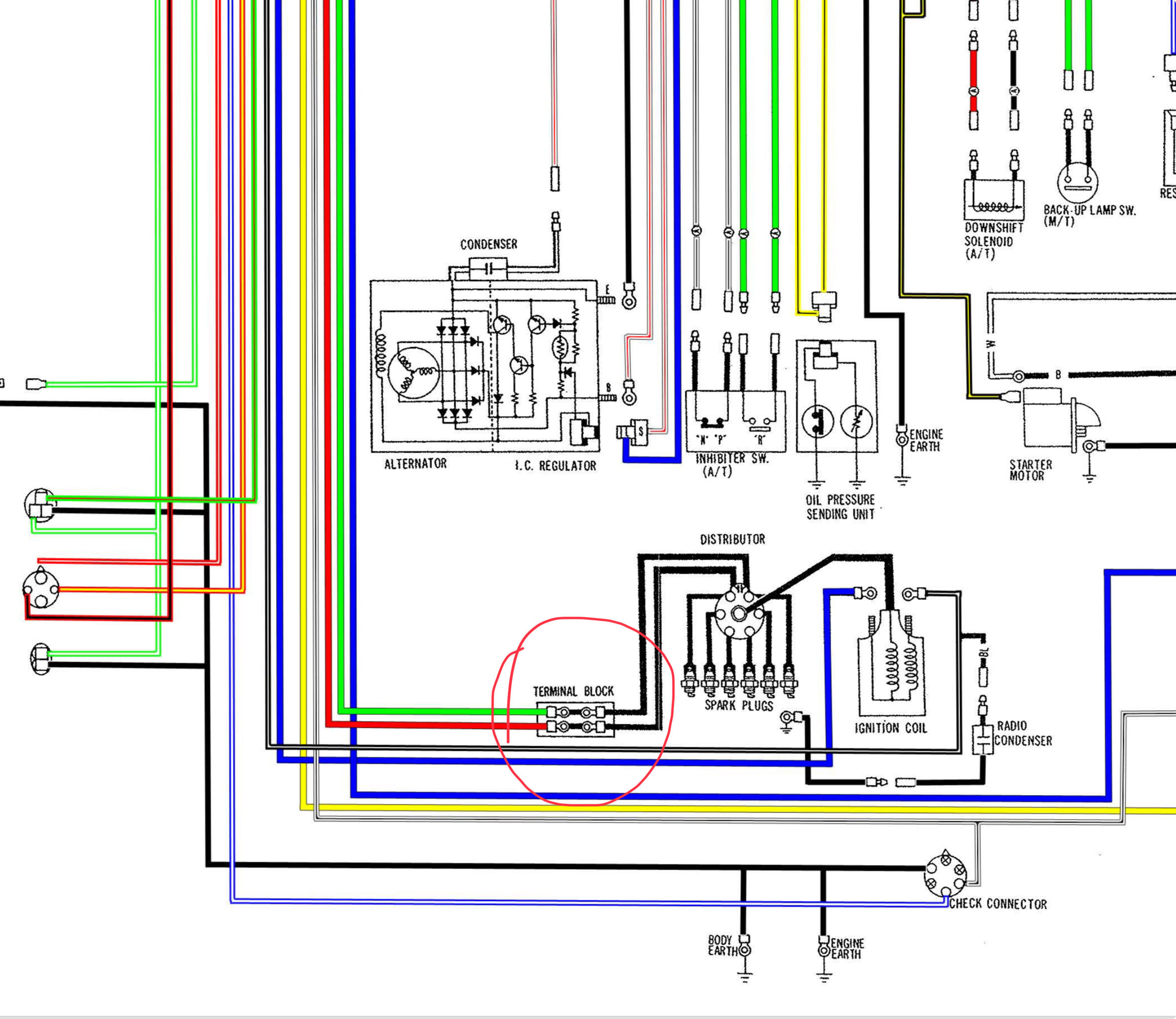

September 3, 2024Sep 3 comment_668900 I will try this fix. may ias what you did with red&green block terminal wires, these used to connect to the distributor? The 123ignition distributor connects directly to the coil and ground, so far leaving these two wires unused. When I connected them to the +- in the coil, nothing happens. Should those be reconnected after the installation of the condenser? See figure Link to comment https://www.classiczcars.com/forums/topic/65113-240z-tach-wiring-after-123ignition-install/?&page=3#findComment-668900 Share on other sites More sharing options...
September 3, 2024Sep 3 comment_668902 Removed them completely, the transistor ignition unit where those come from is obsolete in my setup (123 with Weber Carbs) So I removed all of its cables. But I´m not sure if some signals are needed for the ecu. Better check the FSM for the transistor ignition unit. It has its own chapter. The red and green wire are not needed for sure. Link to comment https://www.classiczcars.com/forums/topic/65113-240z-tach-wiring-after-123ignition-install/?&page=3#findComment-668902 Share on other sites More sharing options...
September 3, 2024Sep 3 comment_668903 Thank you for the hint. I will check the transistor wiring in the FSM. great to be in the same time zone!! Link to comment https://www.classiczcars.com/forums/topic/65113-240z-tach-wiring-after-123ignition-install/?&page=3#findComment-668903 Share on other sites More sharing options...
September 3, 2024Sep 3 comment_668904 The blue wire from the coil (-) terminal supplies the tachometer with the voltage signal. You can leave it connected at the coil, but disconnected at the old igniton module. It's on a branched circuit. You can follow it out on the wiring diagram and see it. Link to comment https://www.classiczcars.com/forums/topic/65113-240z-tach-wiring-after-123ignition-install/?&page=3#findComment-668904 Share on other sites More sharing options...
