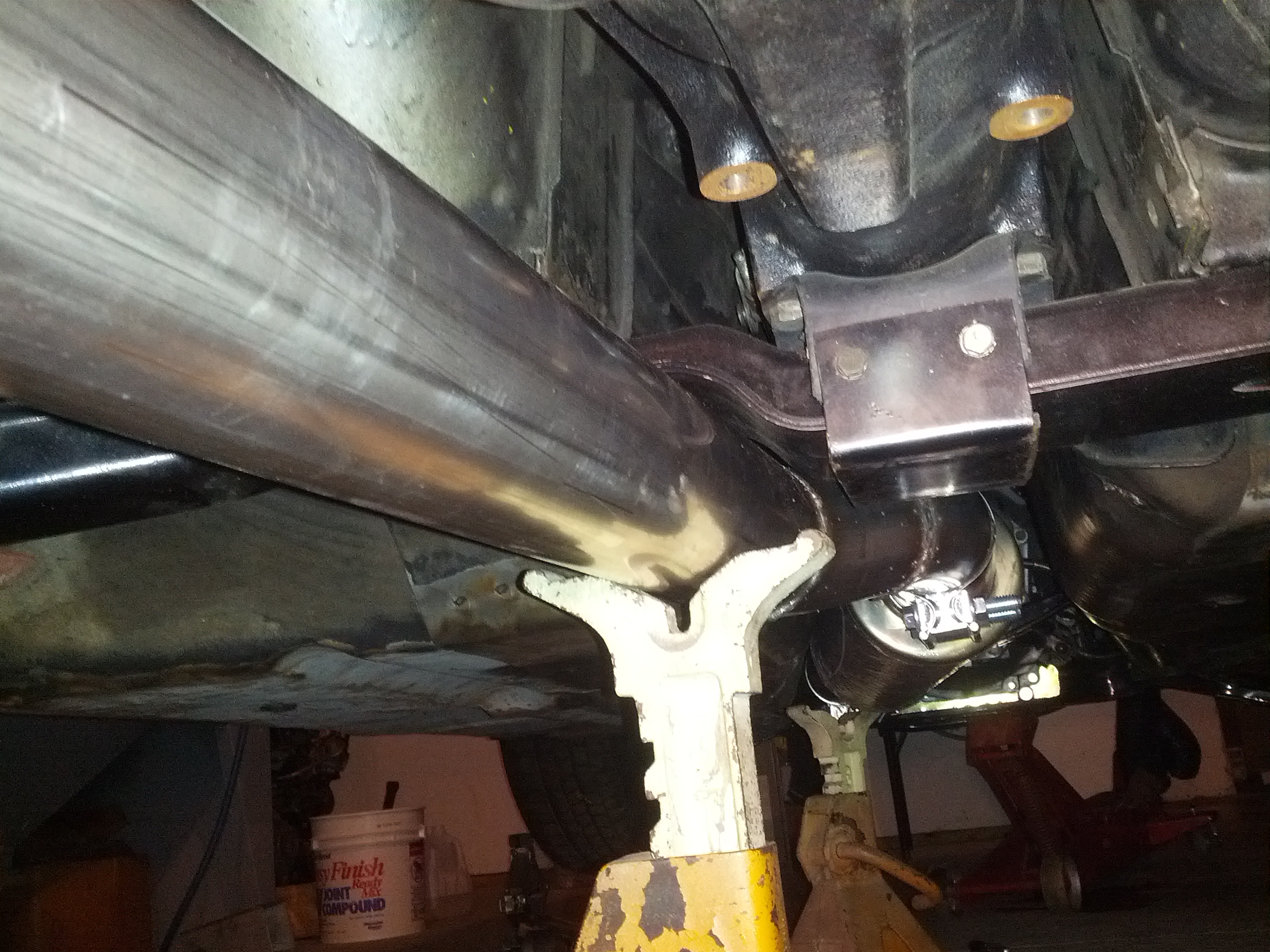

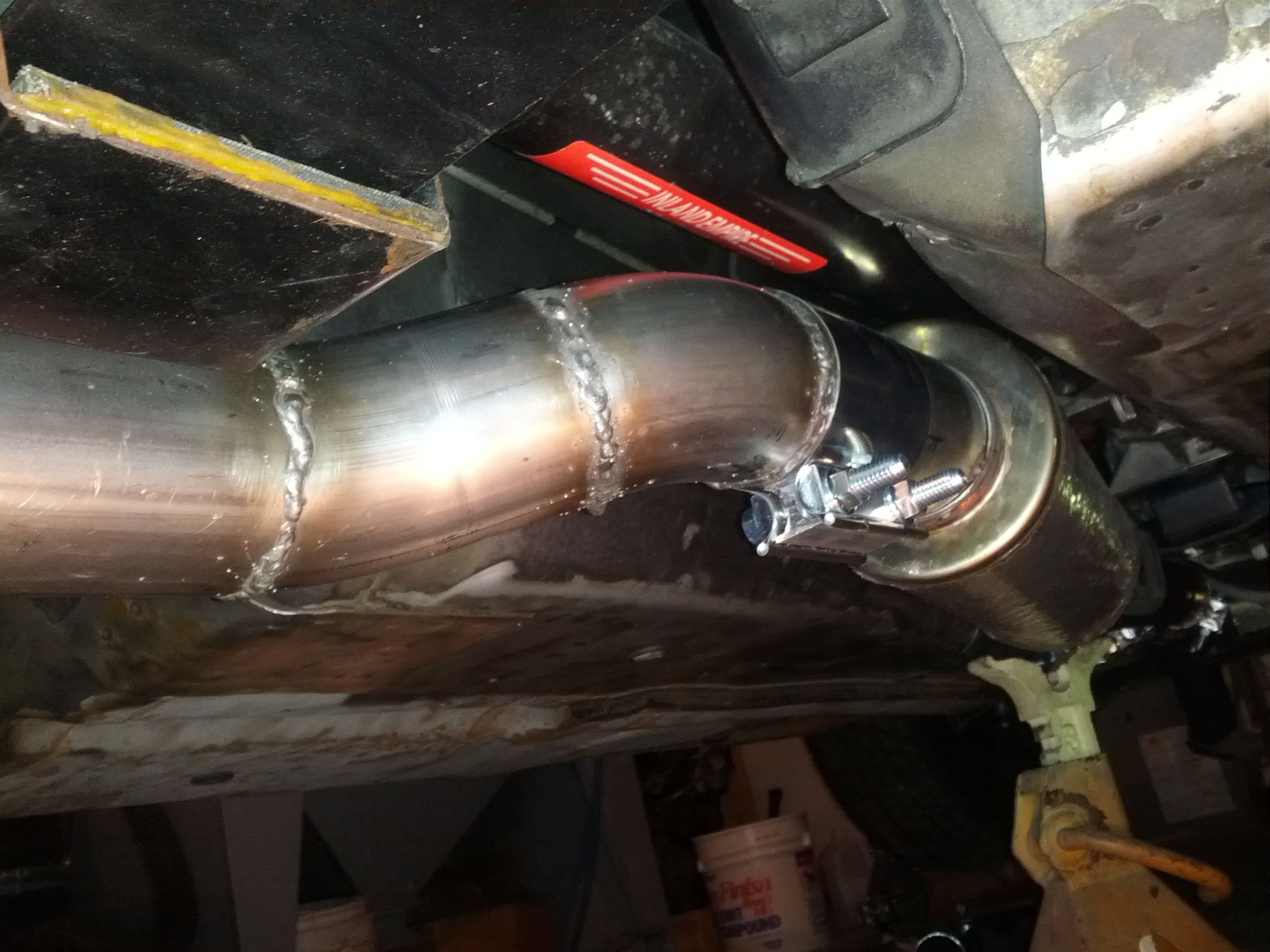

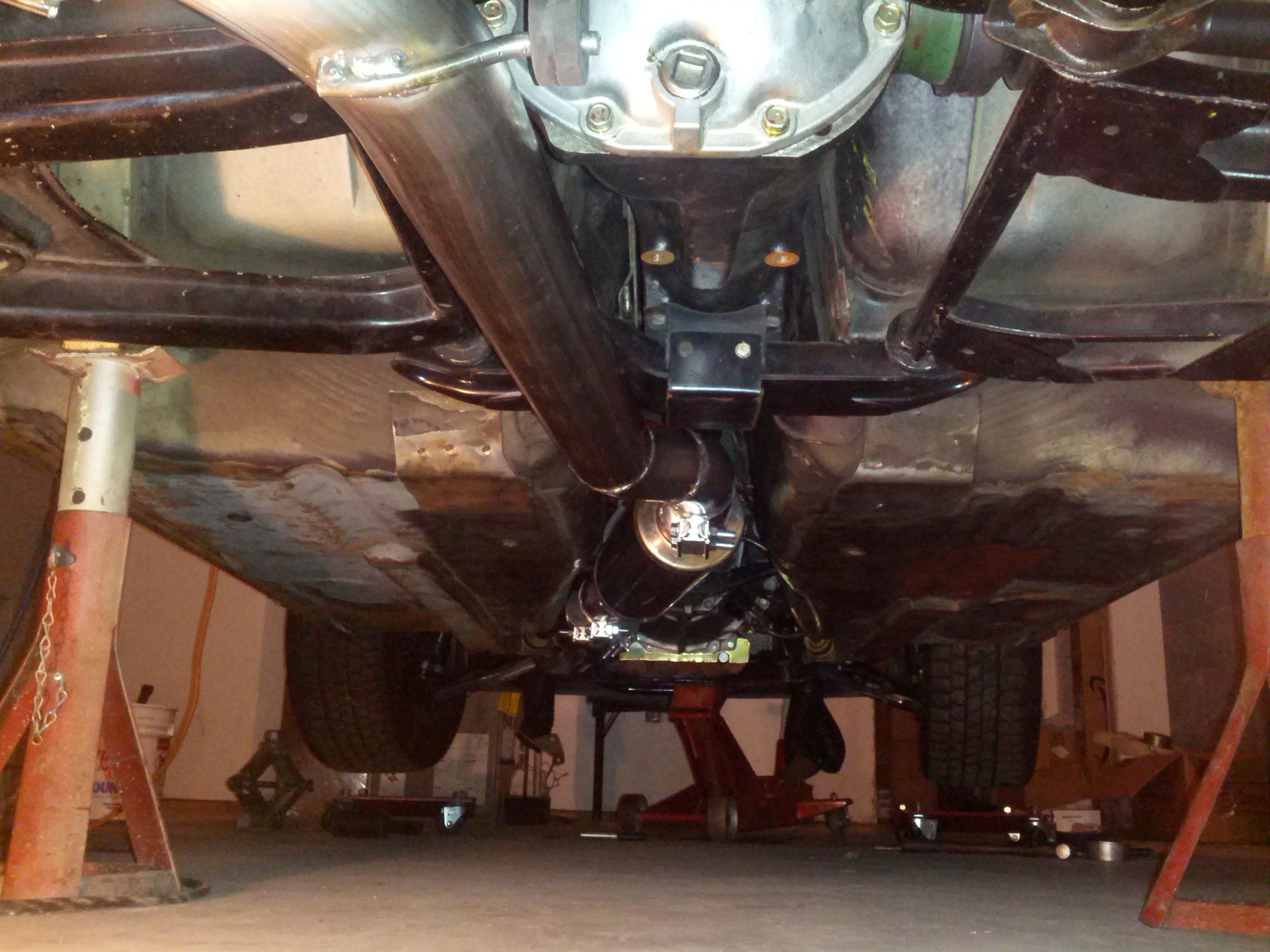

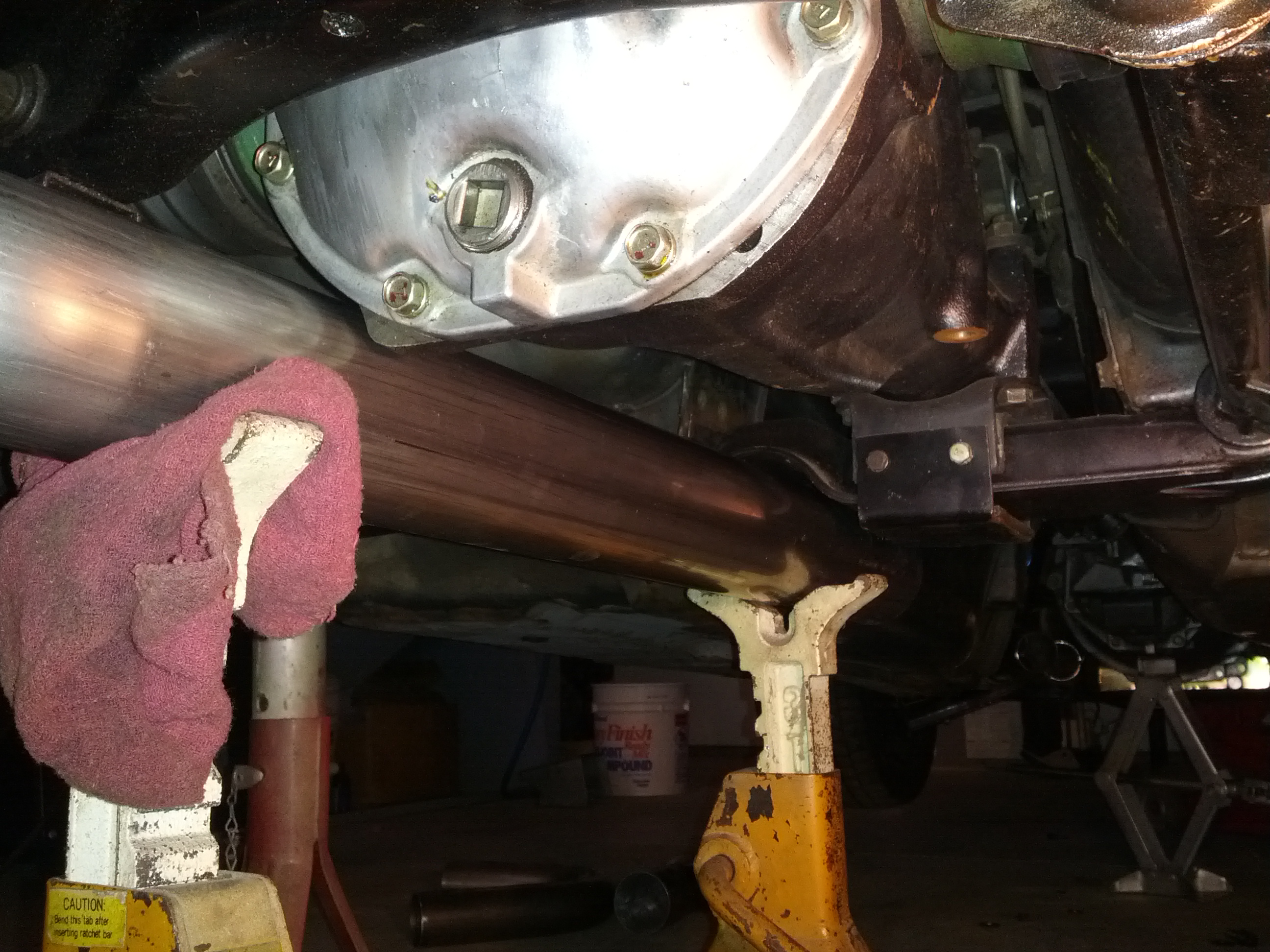

November 7, 20213 yr comment_631113 I found a few relevant pics of the bracket from when I was fabricating a 3" exhaust. Here they are: Looks like my air gap is more like 1/4". In the first pic, you can see the rubber padding glued to the floor of the U bracket: Here is a close up of the bracket going under the crossmember. I used yellow contact cement to glue the reinforced rubber belt material to the floor of the "U". You can see the air gap nicely here (top left of the photo): Edited November 8, 20213 yr by inline6 Link to comment https://www.classiczcars.com/forums/topic/65122-rear-suspension-bushings-and-mounts/?&page=3#findComment-631113 Share on other sites More sharing options...
